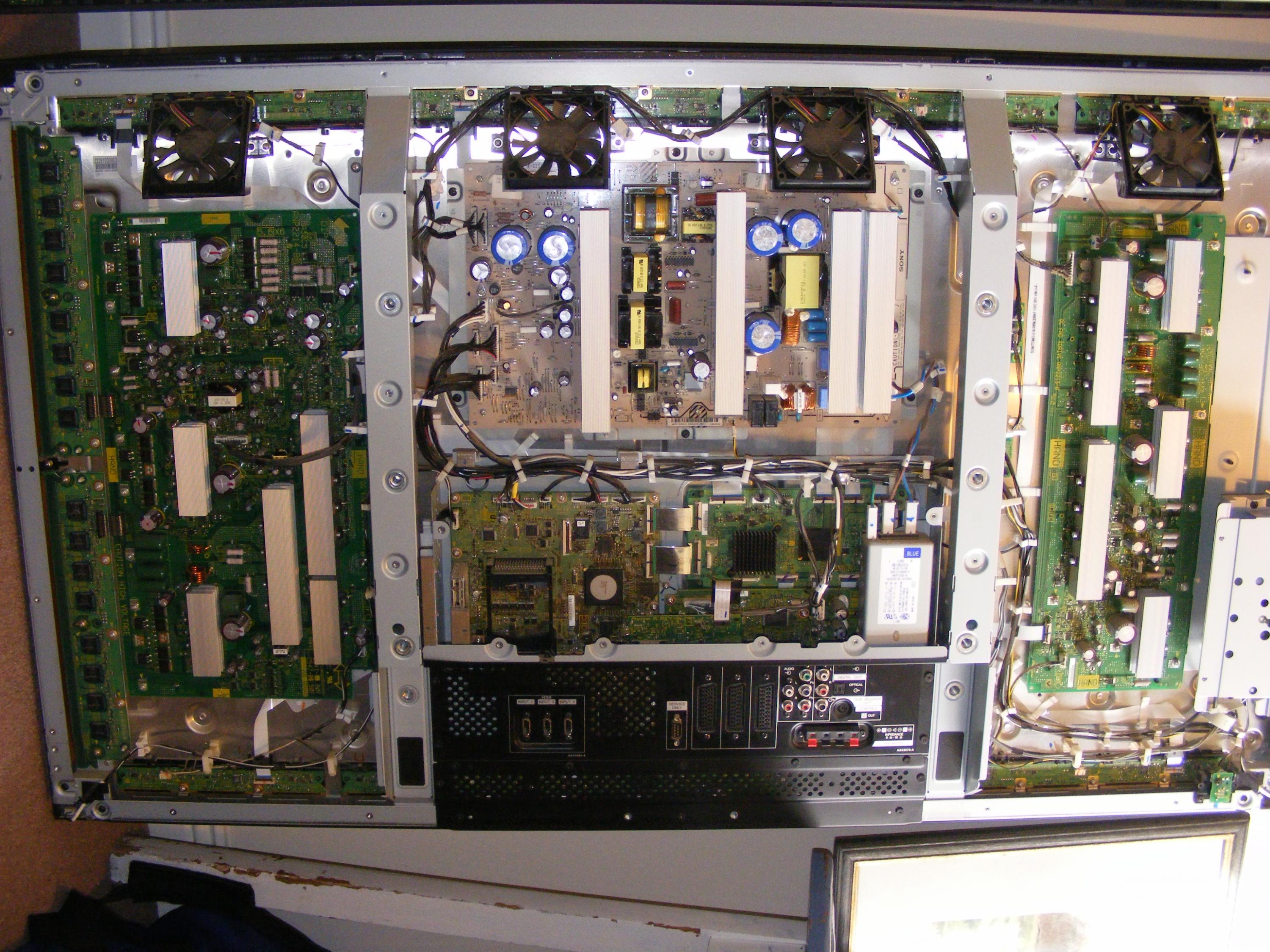

    Hi there. I'm working on a PDP-LX5090. It's otherwise working perfectly but while on and displaying anything on screen it makes a fairly loud buzz, louder than the normal plasma buzz, and quite audible from viewing distance while watching. When just turned on it also makes a slight crackling sound like static electricity I think coming from around the edges of the panel.
    The buzz sound itself seems to come from the power supply or at least in that region of the panel. It is more audible from the back of the TV.
    A video of the sound:
    https://photos.app.goo.gl/Hw67z0S0MmPgRR9U2
    I have another working PDP-LX5090 and I have tried swapping the PSUs and the buzz remains in the original panel and does not transfer with the PSU.
    I have also tried turning down VOL_SUS and ABL as mentioned by tom66 in another thread on a KRP-500 that was making zapping noises but this only had a slight effect on the noise.
    Any suggestions or thoughts?

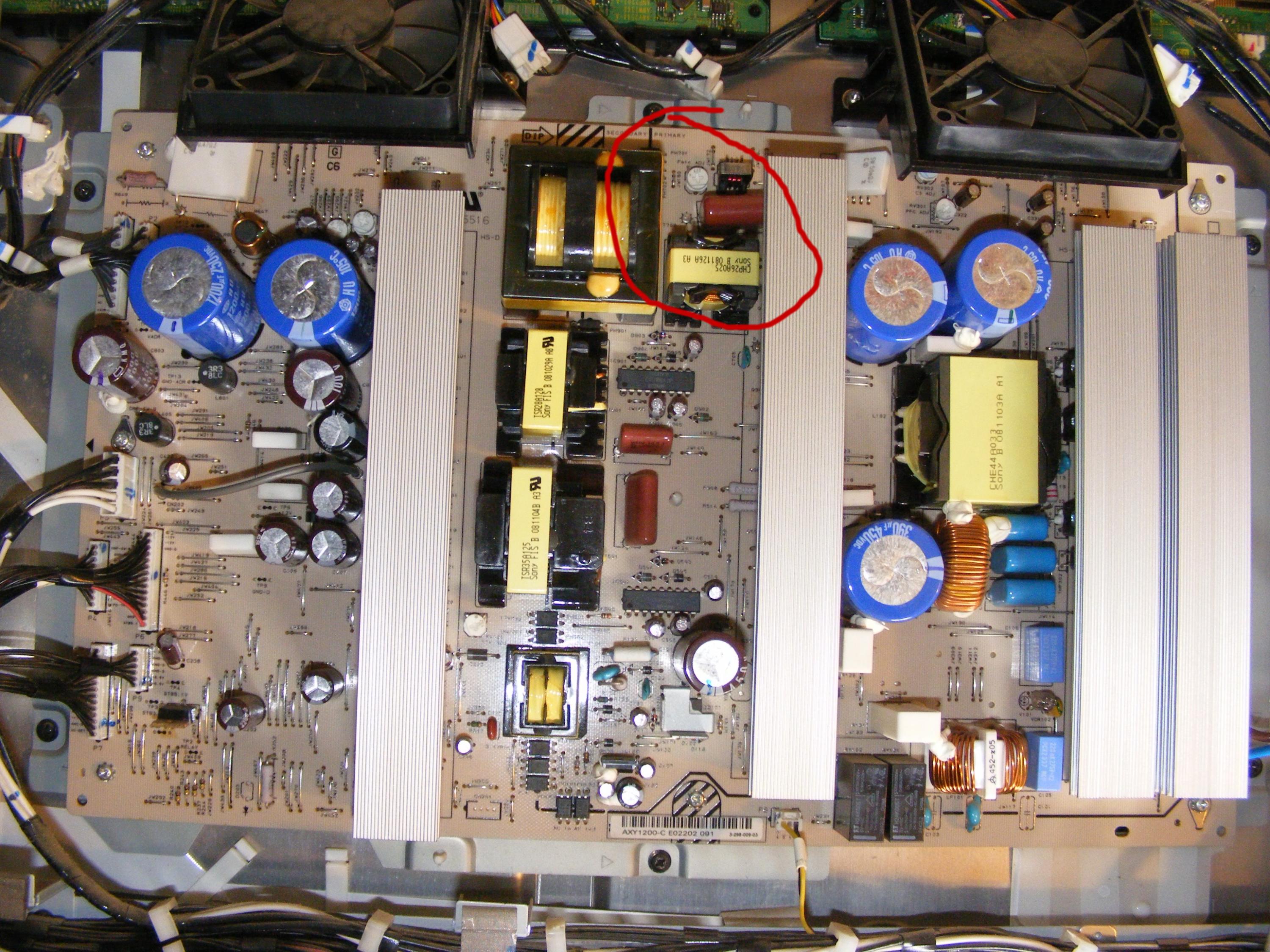

    I've tried to narrow down the source of the buzz. It seems to be mainly around L701/T702 which appear to supply vsus. Vsus voltage is 212V which is almost the same as the other 5090 I have open. The other TV has the same buzz but just not as aggressive and no crackling sounds. I also tried swapping X drive and Y drive boards as well as mentioned the PSU between them with no change.

            That's right. I'm not too worried about the crackling sound - just thought it might be related but now I'm thinking it isn't. Going to check out the caps on the x drive next.

                Thanks Tom. Vsus is 212V. VOL_SUS is 128 in service menu setting. It was already set on Mode 2 energy save. Interestingly the quieter TV had energy save set to off.
                Any idea why swapping the xdrive board would affect the buzz?

                    Wouldn't service menu settings be stored on the main board though? So it wouldn't travel with the xdrive board when swapped between TVs.
                    There are some adjustment pots on the xdrive board for VKOFS1_ADJ, VKOFS2_ADJ and SUS_B_ADJ. Could these be out? There are test points for VKOFS1 and 2 but not sure where to measure for SUS_B.
                      Re: Pioneer Kuro PDP-LX5090 buzzing and crackling
                      It's stored in the control board - but different X-mains could have differing resonant parameters, it's determined by the value/quantity of inductors and capacitors in a certain position of the circuit.
                      Do not adjust the pots on any of the boards, you need to do all of the adjustment through the service menu.

                                Hello tn245,
                                It is possible that what you may be hearing is transformer lamination buzz.
                                In my CRT TV repair days, I came across several sets that had their switching transformers buzzing. I fixed them by soaking the tranny into a can of clear varnish for a day, ensuring total submersion. Removed it and allowed it to dry solid. Re-installed it and the buzz was totally gone.

                                    Thanks Relayer. I was considering this but as I mentioned I swapped the psu board around from another same model but quiet TV and the noise stayed with the TV and did not transfer to the other TV with the psu board. My conclusion is something else is putting more demand on the psu making it buzz louder.
