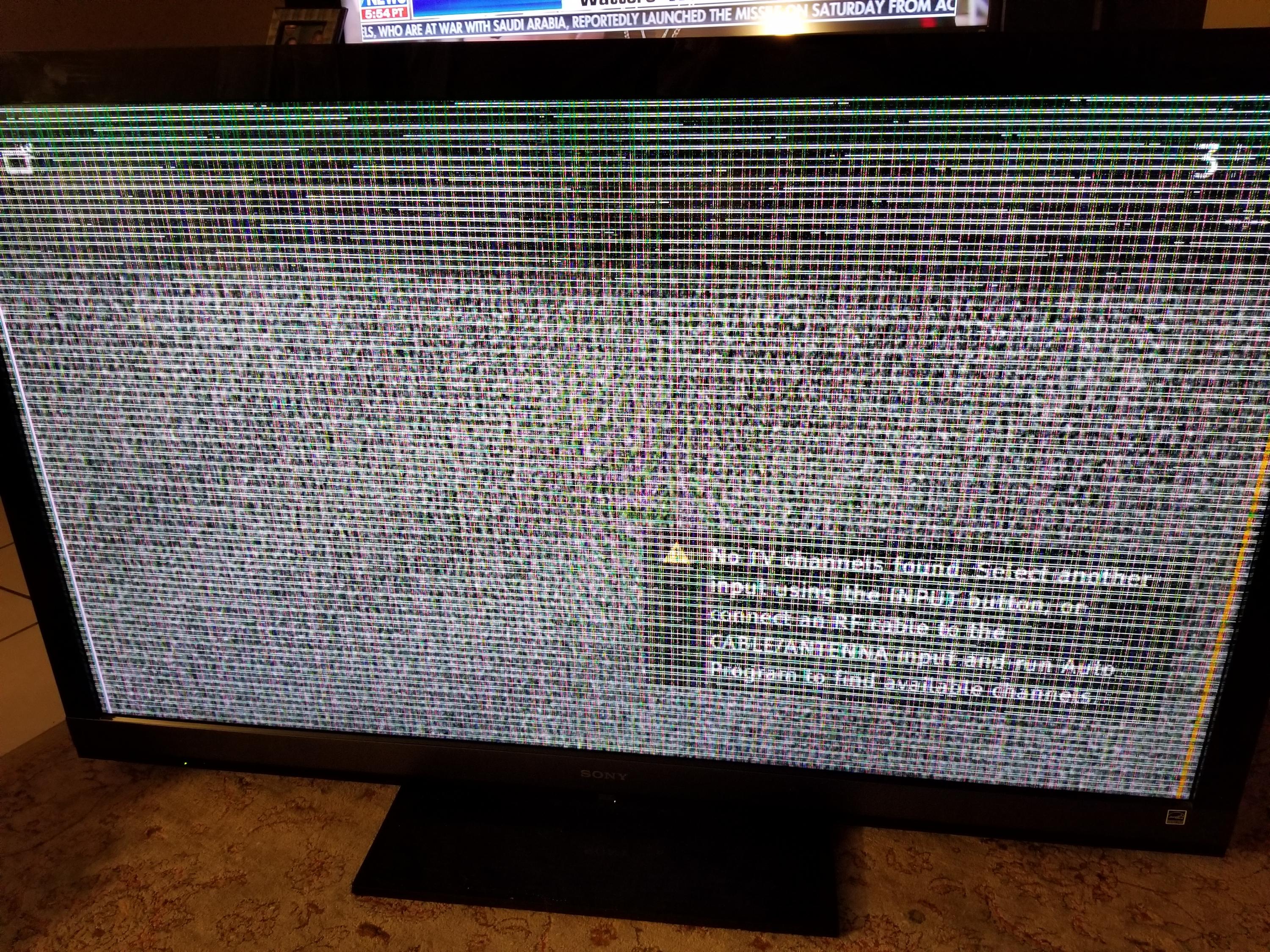

Sony KDL-60EX700 bad panel right?
  • kevinm34232
    • May 2012
    • 1884
    I'm 99.9% this is the panel just wanna verify with some of you experts...

    Re: Sony KDL-60EX700 bad panel right?
    until the experts get here, i'm going to throw a vote in for main. looks too neat to be panel to me. just my thoughts though.
    you can always disconnect one side of the t-con to the panel and check how it effects the pic.

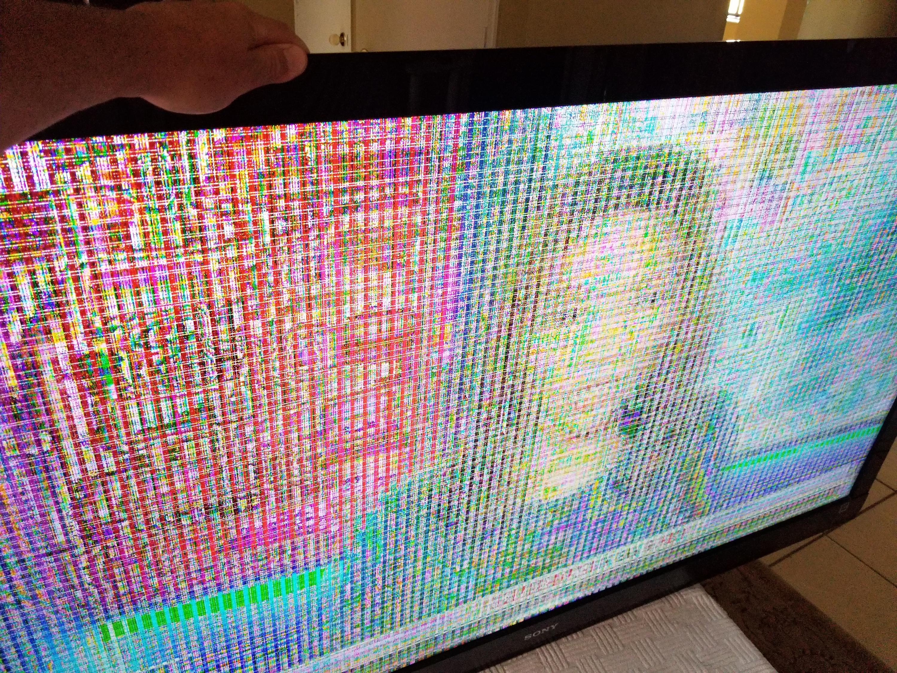

          Try to warm up with hairdryer the mainboard then switch tv on and see if it changes. Also download the service manual and search for an auto test for the panel, in the service menu, usually there's the word Pattern.

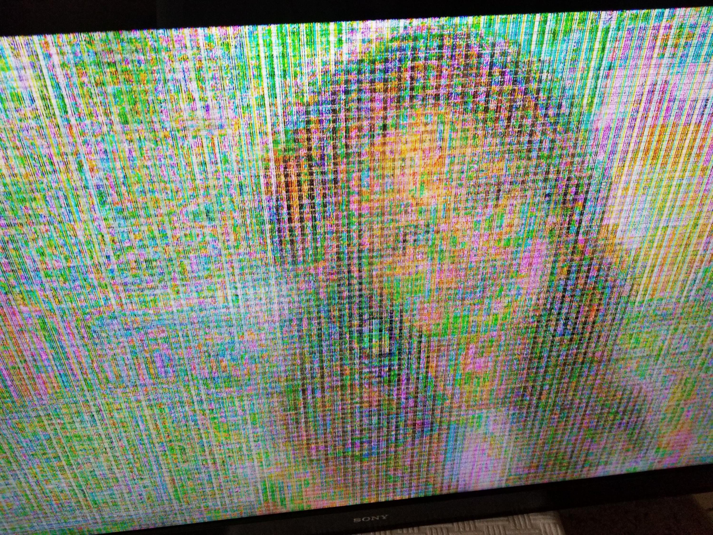

            Here's a couple more pics hooked up to HDMI..
              I don't think this is a bad panel, but I could be wrong.

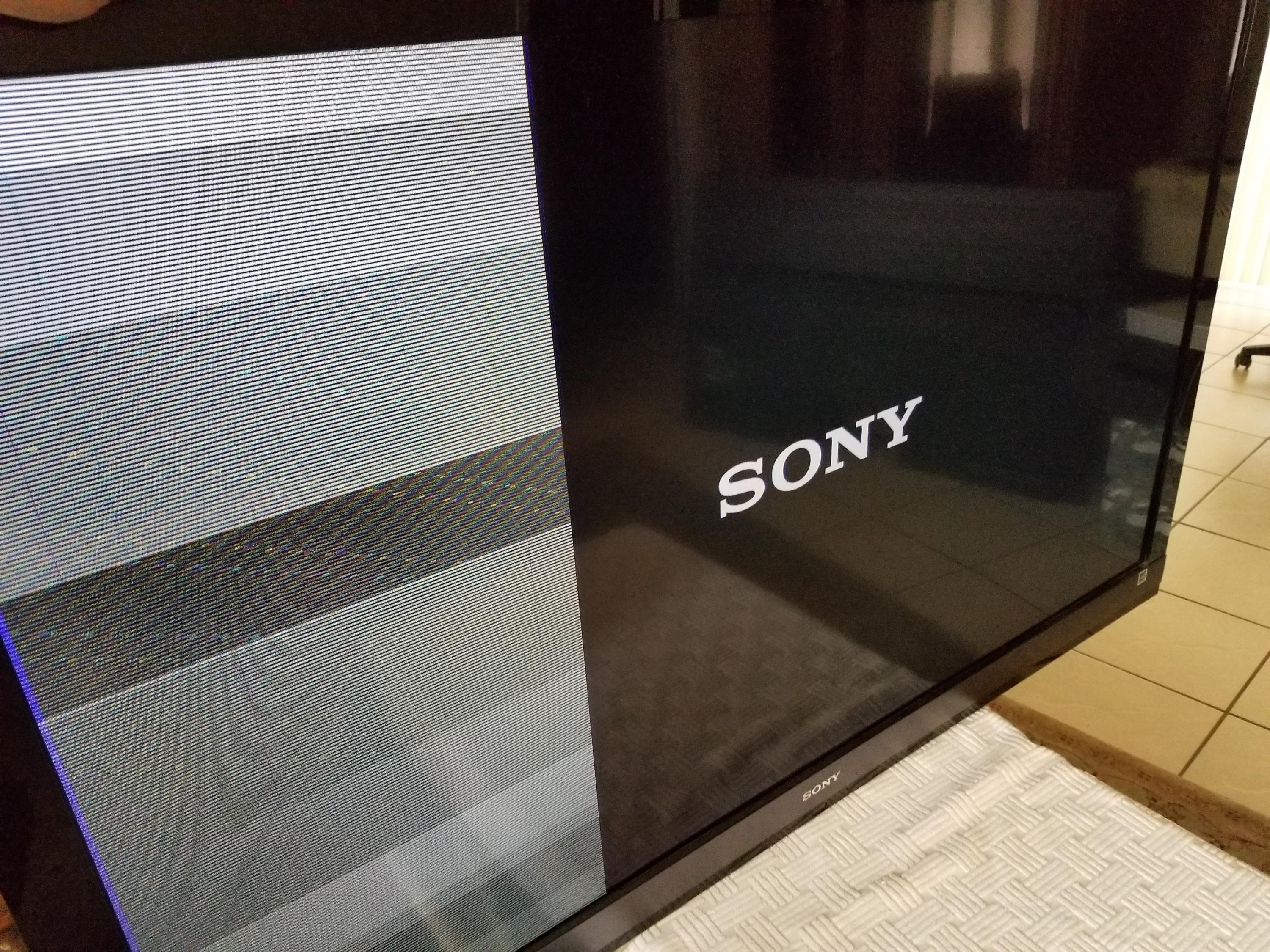

                I just noticed this, when first plugged in to power..
                    Even though at start-up you get that half screen bad image. That is a Main Bd issue. Me I would just replace the Main Bd.

                          Crap same exact problem with new main board..
                          Chance of T-Con?

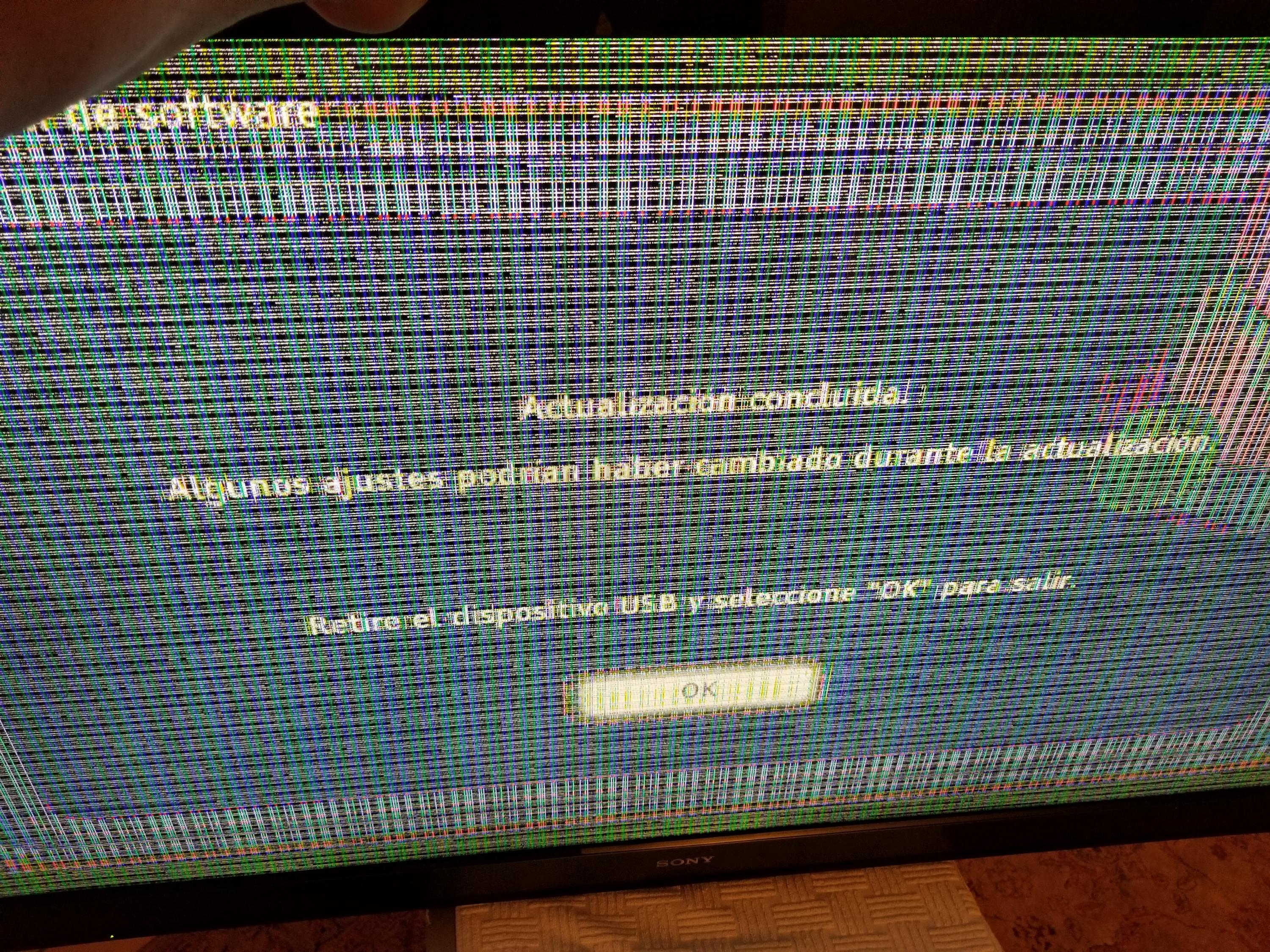

                            BTW for those who stumble across this thread when changing out the main board.. TV flashes green and amber LED together and repeats w/o software update.
                            Following Sony instructions to put .bin firmware in the folder on USB drive didn't work. Firmware .bin needs to be directly in the root directory and not in a folder. Insert USB then connect AC and hit power button and TV will start update.

                                So after discovering main board was not problem, removed T-con to get part #. Reinstalled T-Con and original main board and guess what... Normal picture...
                                Tail between legs, I scurry to next project... Lesson = don't skip the basics...
