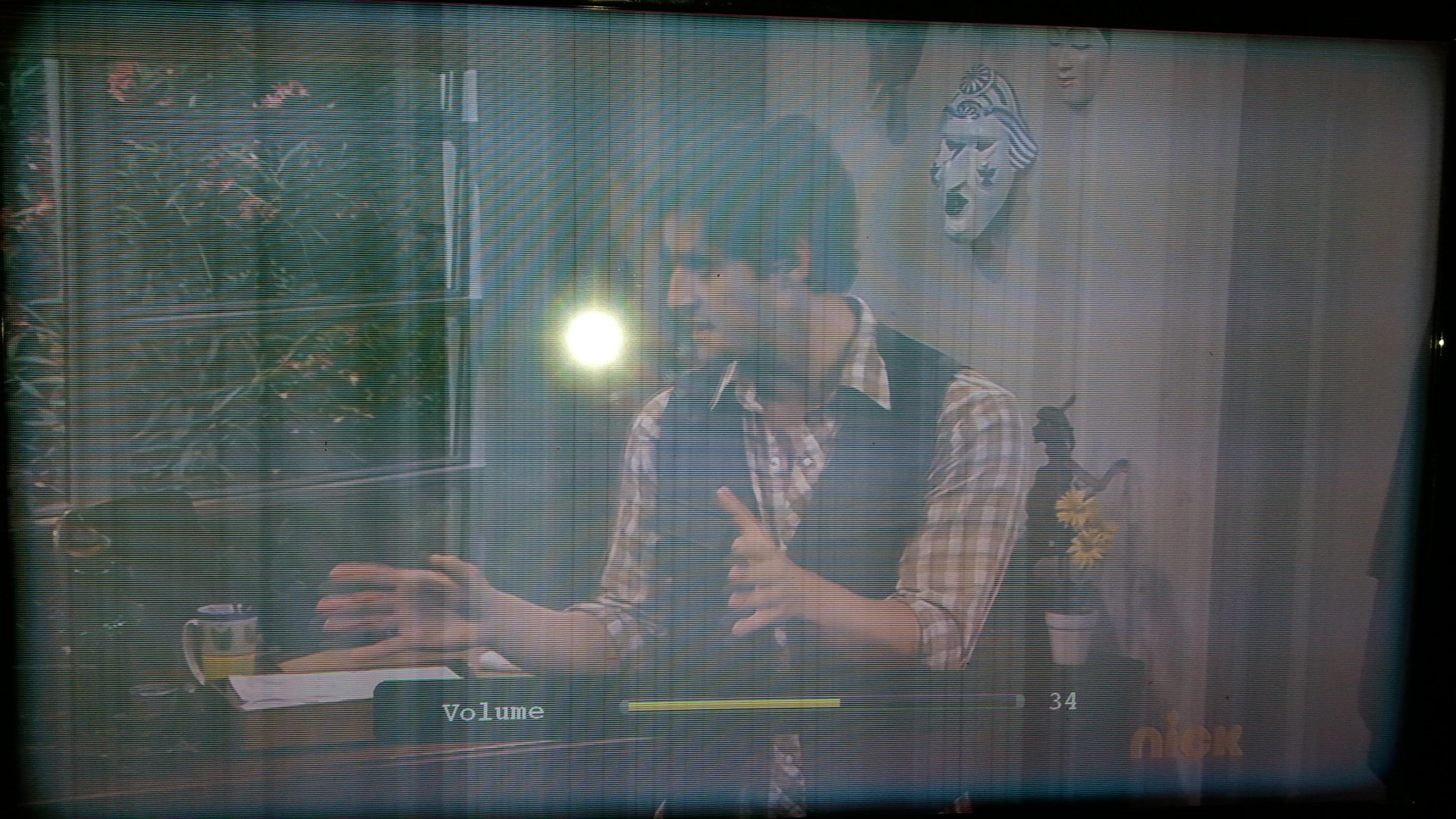

    Toshiba 32BV500B suspected panel fault
    Would everyone here tend to agree?
    PS - 17PW26-4
    MAIN - 17MB45M-3
    PANEL - LTA320AP06
    INVERTER - SSI320-4UA01
    TCON - 320APO7S4LV0. (can't quite see the ver. no.)
    PS b/d voltages in stby and powered on check out ok.

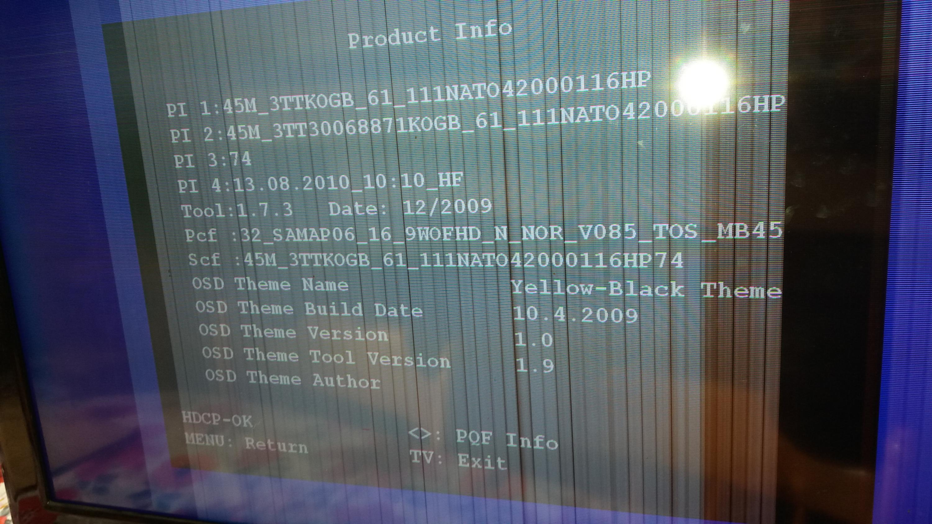

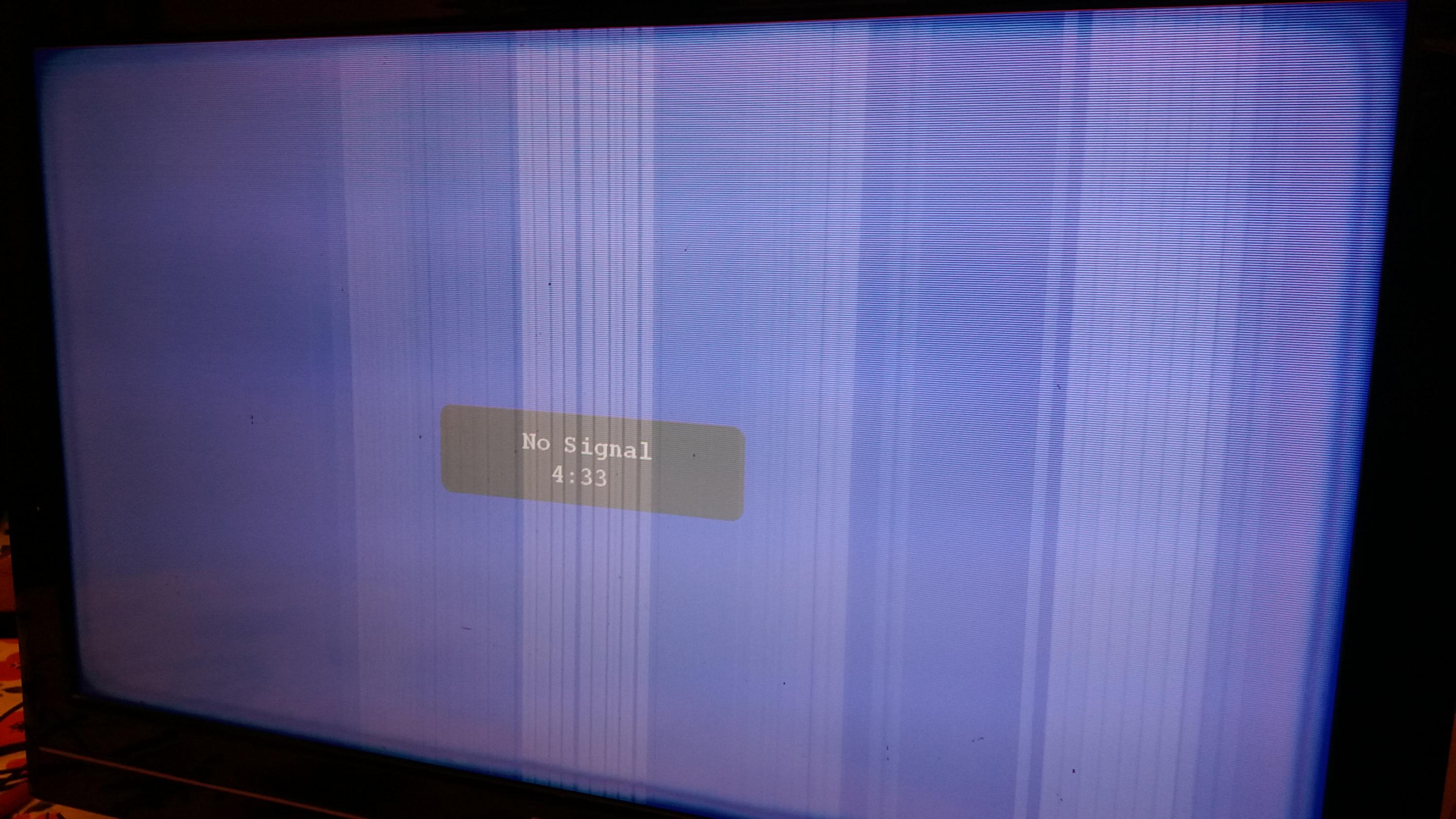

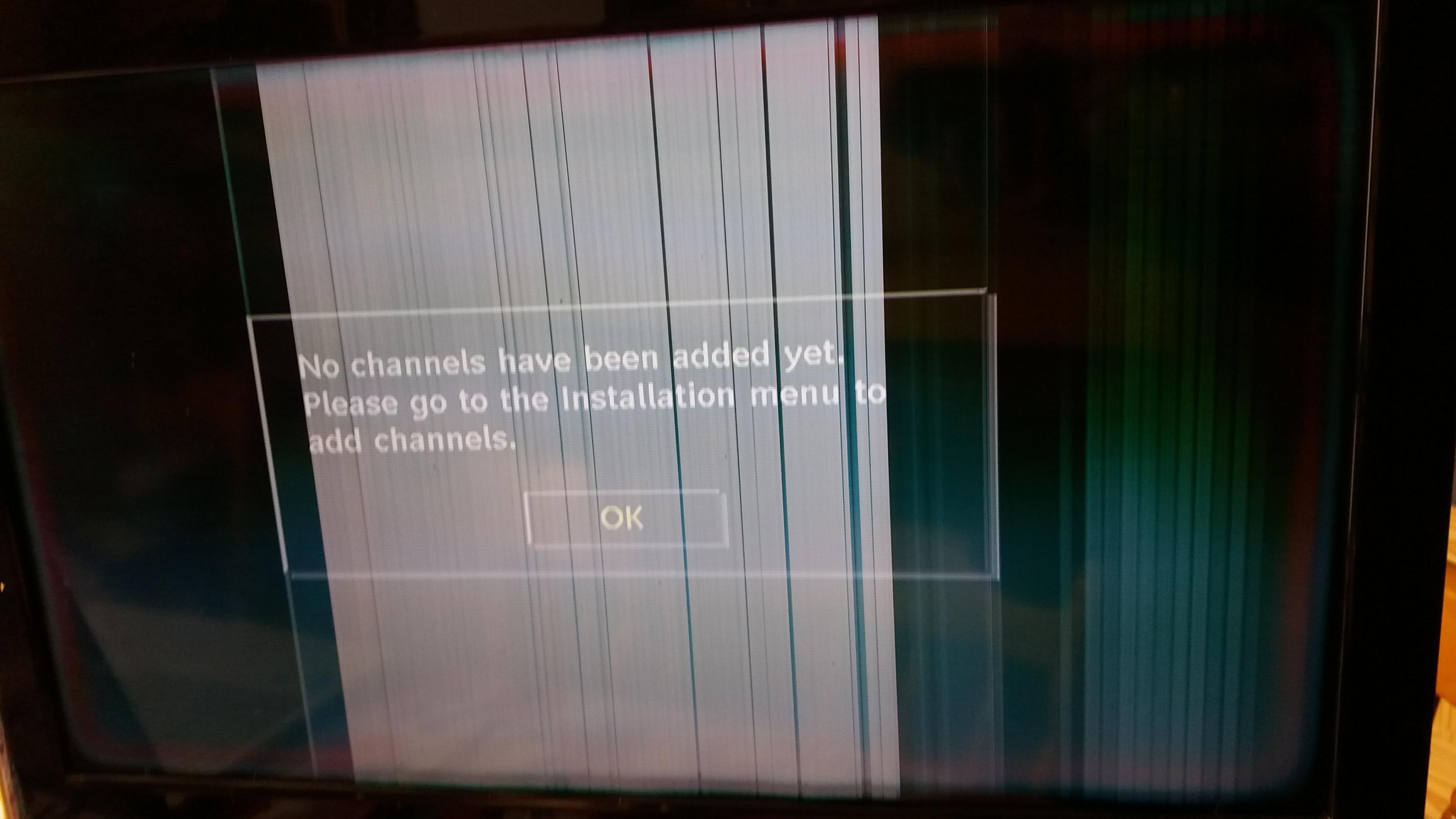

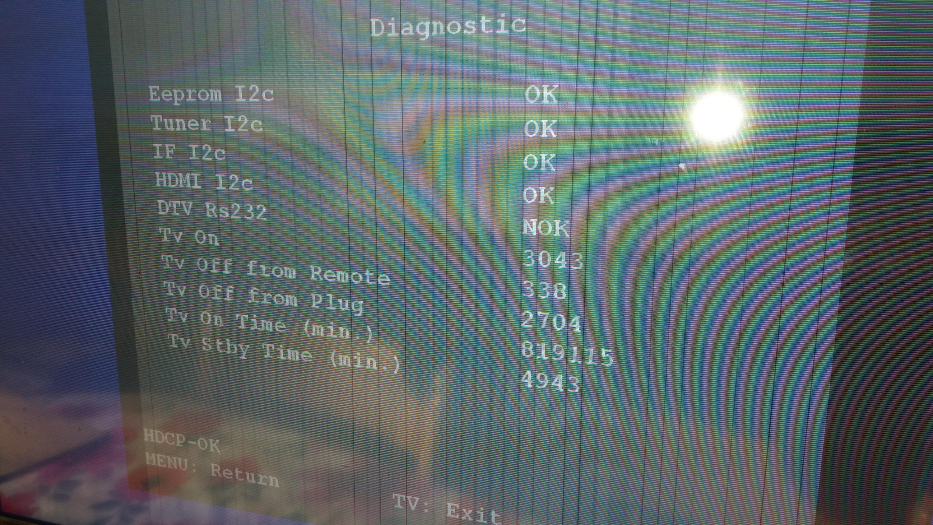

    Odd behaviour - no led status on the front panel in either stby or when switched on, in stby the TV still beeps when the front buttons are pressed i.e vol and channel up/down buttons, also insert a USB drive and the TV shuts down. Otherwise operates as normal.
    Picture is the main issue, see attached photos. It doesnt show like this immediately after switch on, it slowly 'bleeds' down the screen, eventually the whole screen whitens.

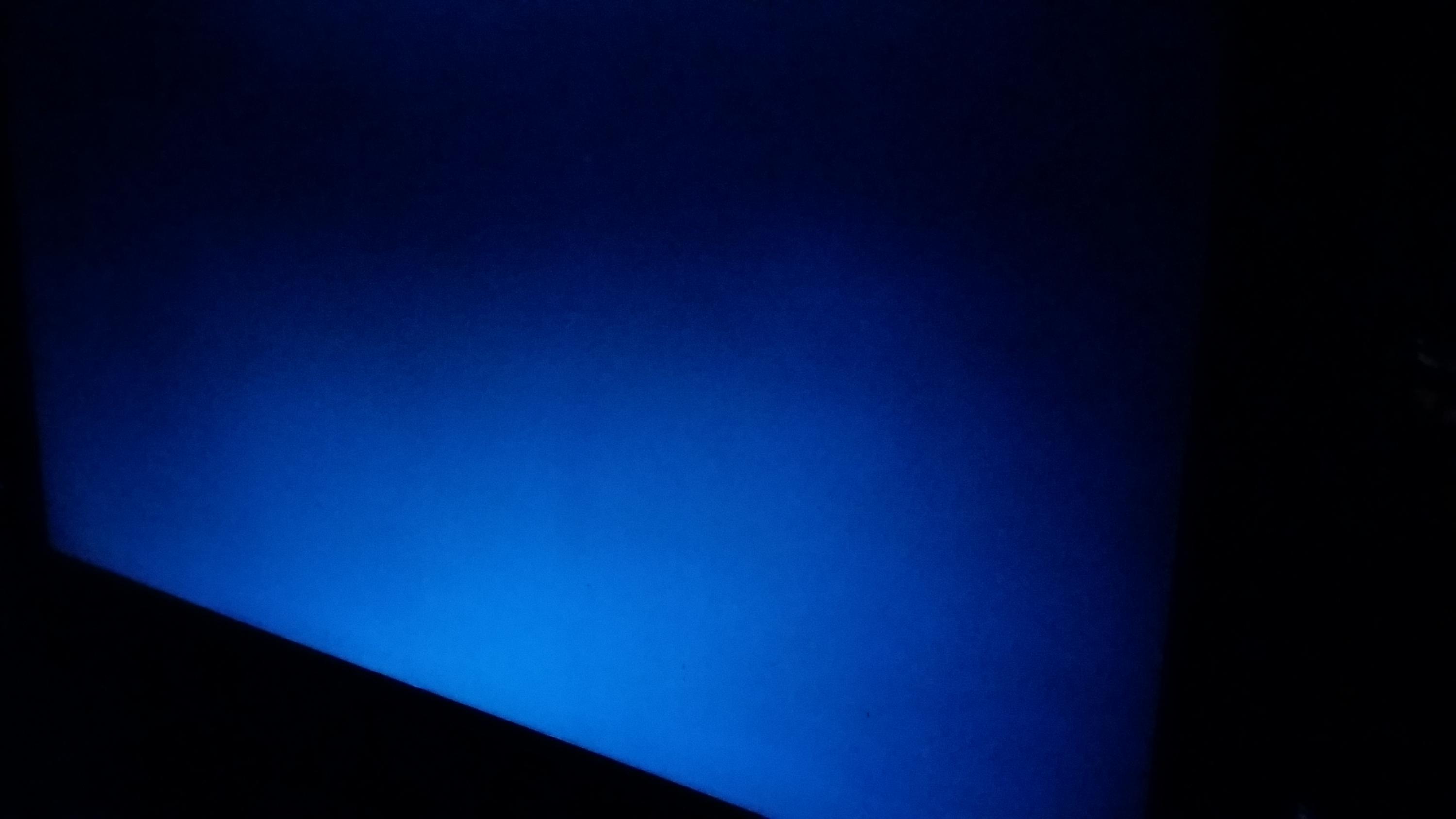

    Remove the T-con cable and just shows a backlight blueish/black screen with no distortion, kind of expected I guess. Just for added info.
    Menu shows fine.
    Input source (HDMI) shows fine.
    Photo of PS b/d voltages also added.

          Just my opinion but doesn't seem like a panel problem

            Hi, it is a very common problem with Samsung panels, i would like to ask you if you can measure esr or ripple out the power bd on 12v line. Second test, disconnect one at a time the ribbon connec. between tcon-panel and take a picture of the result, please scale pictures when is possible that slows down page.. Third try, locate CPV1, CPV2 testpoints on tcon and with continuity see to which pin goes on the connector, then put a small stripe of tape on that single contact on the ribbon, in turn first CPV1, second CPV2, then if there are significant changes post them here.. Bye

                      I wonder if you have a mainboard fault. The menu details all look fine and no characters are missing.

                        "unfortunately I do not have a working scope" I have never spoke about scope, it is not necessary.
                        "it is the panel bd or perhaps video processed /scaled etc on the main bd which is more likely." I dont understand this sentence, sorry, you are meaning that the tcon is integrated to the panel, so is large as the panel and deep few cm?
                        CPV1,2 in your tcon is CKV1,2 , have you understood my suggestions? I have never done this test and i can't do now because i have damaged the only one tv that i own with this sympthom. Sorry, but there's no risk.

                          1) If correct, DMM on ac setting, probes across chassis ground and +12v. Reading is 25.5v ac.
                          2) There is no T-con bd! Its either integrated on the main bd or it is the board that is heat bonded onto the top of the lcd panel. If I remove the bonded connectors there is no way I would be able to rebond them back on.
                          3) I do understand your suggestion and shall try it when I have more time on my hands - the panel has been re-assembled due to lack of working space, little children and inquisitive hands.
                          Thanks again for your help, appreciate it!

                            1) I have never asked you to measure any voltages, only ESR or ... ehm sorry, yes i've asked for a view of the ripple, but you don't have scope, so an esr meter?
                            2) ok, since i recognize tcon marking, it is a Samsung, mainb. is Vestel, so tcon is integrated in the panel..
                            Bye..

                                This seems like a common issue on this model
                                https://www.badcaps.net/forum/showth...shiba+32BV500B
                                out of curiosity its the lcd/tcon pcb on the top or bottom of the tv, there was a thread a while ago where the tab bonds was on the bottom of the lcd panel and someone had cleaned the screen with liquid which had then ran down onto the board and caused corrosion etc just though i would mention it.

                                  Located on the top. Have inspected the board and looks ok.
                                  Anyone know if the tcon can be powered independently?Though I suppose it would need more than just the 12v and gnd feeds.

                                      Yes it would seem my symptoms are the same as the thread you posted above. Might be best just to ditch the panel.
