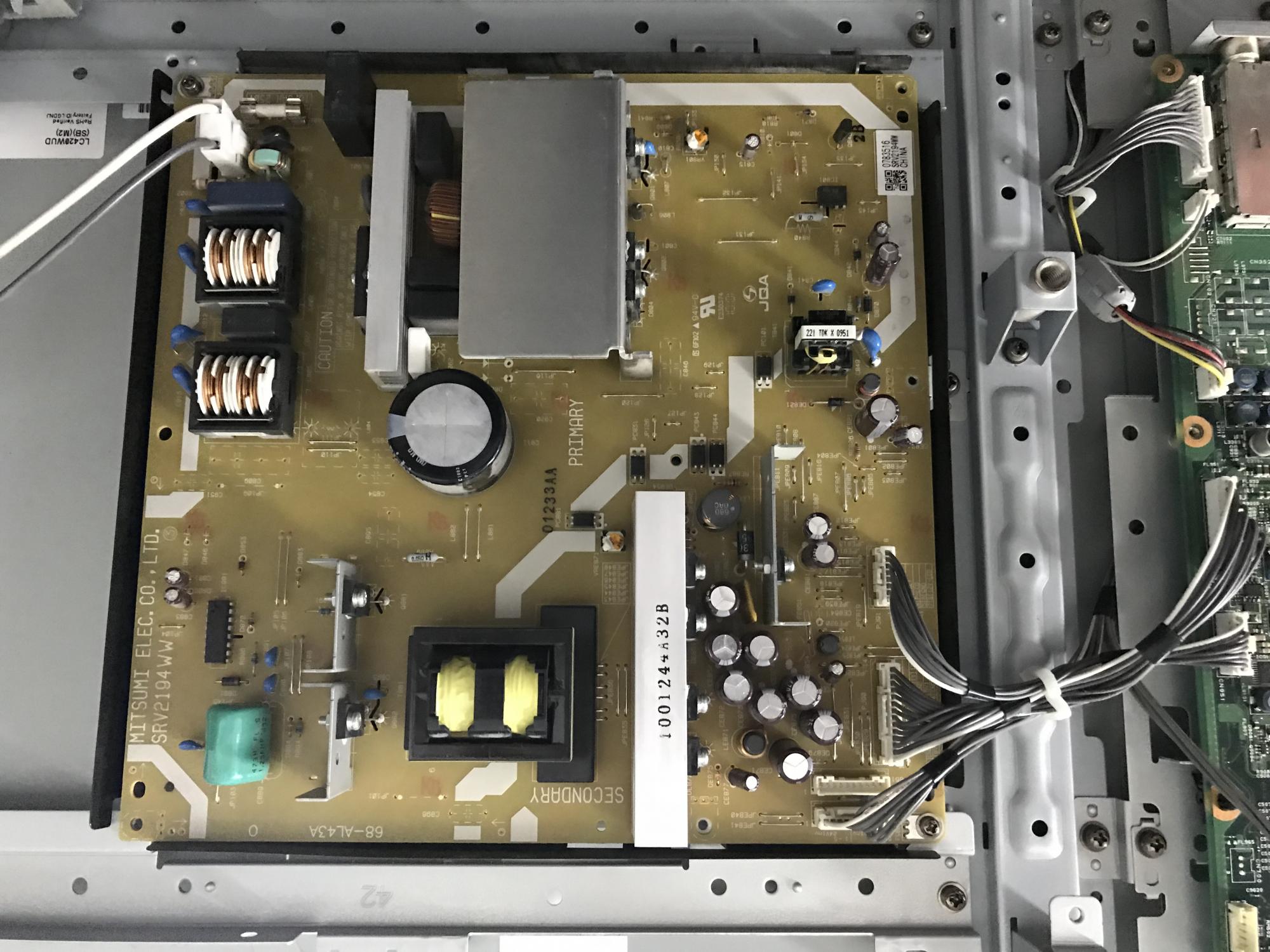

    Hi there,
    got this TV not powering on. Checked PSU, seems to be ok but not turning on the LCD 24V. Red LED in front is not turning green. 5V Standby, 18V, 12V and 24V to the main board is ok. P-Protect and AC-Det is around 3,2V. Do not see P-Sig and P-LCD (zero volts). Do not hear the Relay clicking. I don't have the schematics of the power board but found that 12V LCD and 24V LCD will be activated by P-LCD. Unfortunately the powerboard is not part of the documentation available at elektrotanya.com.
    Before I poke into the mainboard why it does not activate the LCD - anyboady out there with some experience?
    Power Board is SRV2194WW. Main board is V28A000966B1 or PE0693 (not shure what is the right number).
    Any help would be really appreciated.
    Martin

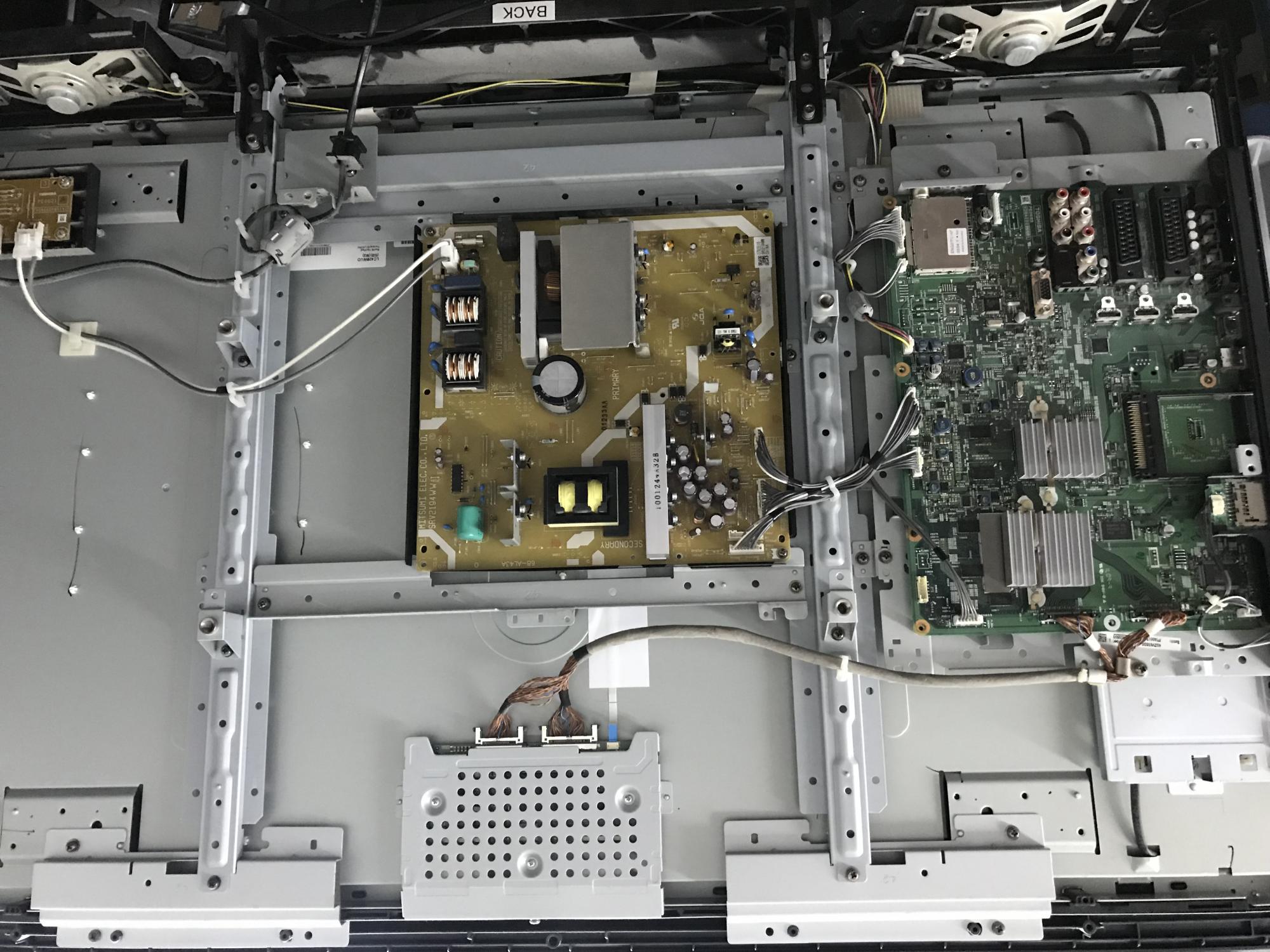

    Can we see good clear pictures of all the boards and how they are connected together?
    It sounds like the main board is not sending the command signals.

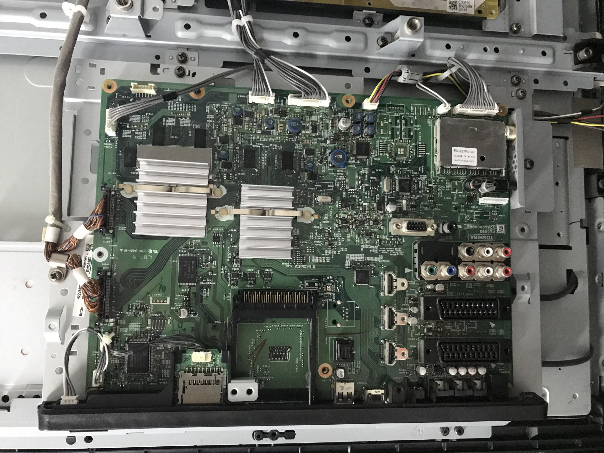

      Shure, see following pictures. I already checked the capacitors in the main supply lines. All of them seem to be in a normal range. What I also saw: It does not power on the supply for the audio on the main board.
      Got the description from the former owner that the TV could not be switched off for some reasons. After a while it was also not possible to switch it on. There may be a corrupted EEProm which is often mentioned in the forum? Or maybe a power rail on the main board failed.

          Well, first I'd try freezing the EEPROM with a can of air upside down and turn the TV on. Sounds like a main board problem. See what happens...
          PSon and BLon are created on the main board. Could also be that the main IC needs a reflow, or it may be toasted.

                Checked the schematics. The microcontroller who does the control is a QFP64 Package. Sorry, no balls to reflow. Checked the power rails on the main board. Two of them are missing. The switching regulators do not geht their enable signal generated by the micro. Freezing the EEProm does not change anything. Found two of them on the board and cooled both down without any change. Maybe the microcontroller is missing a signal to go ahead. Where to go next? Reading the EEProm? Which signals must be present to start powering up?

                            Ok found a shorted power rail which is shorted by one of the big BGAs. Not worth to repair. Taking your suggestion and looking for a board. BTW: took out the EEProm and read it frozen and warmed up. Same values. Defenitely it is not the EEProm.

                                Checked all the capacitors by putting them off an after measuring again on in the power rail and ended up that the big BGA is shorted. To repair that I will need a BGA rework station and a known good chip. Got a spare board for about 50$.
