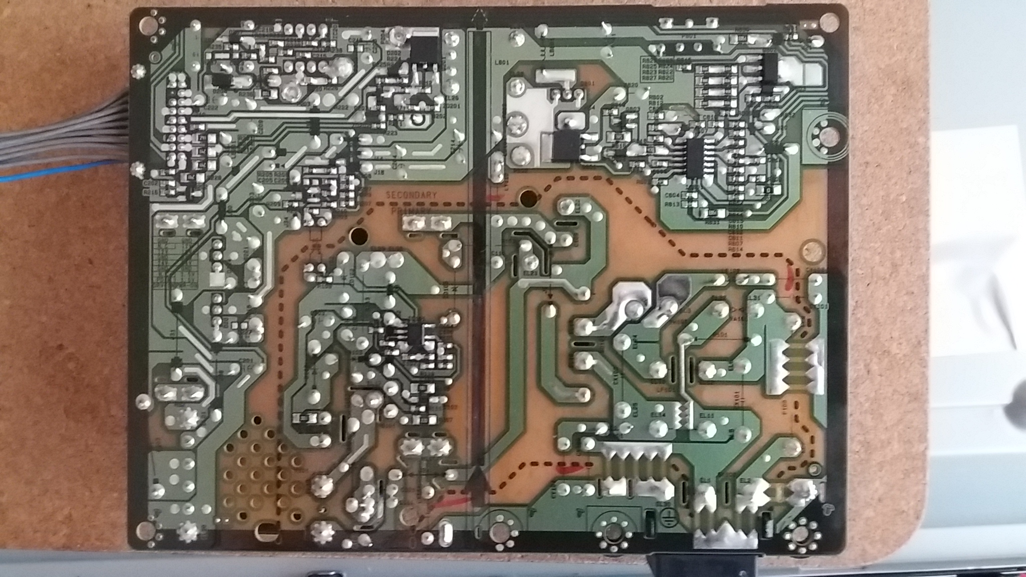

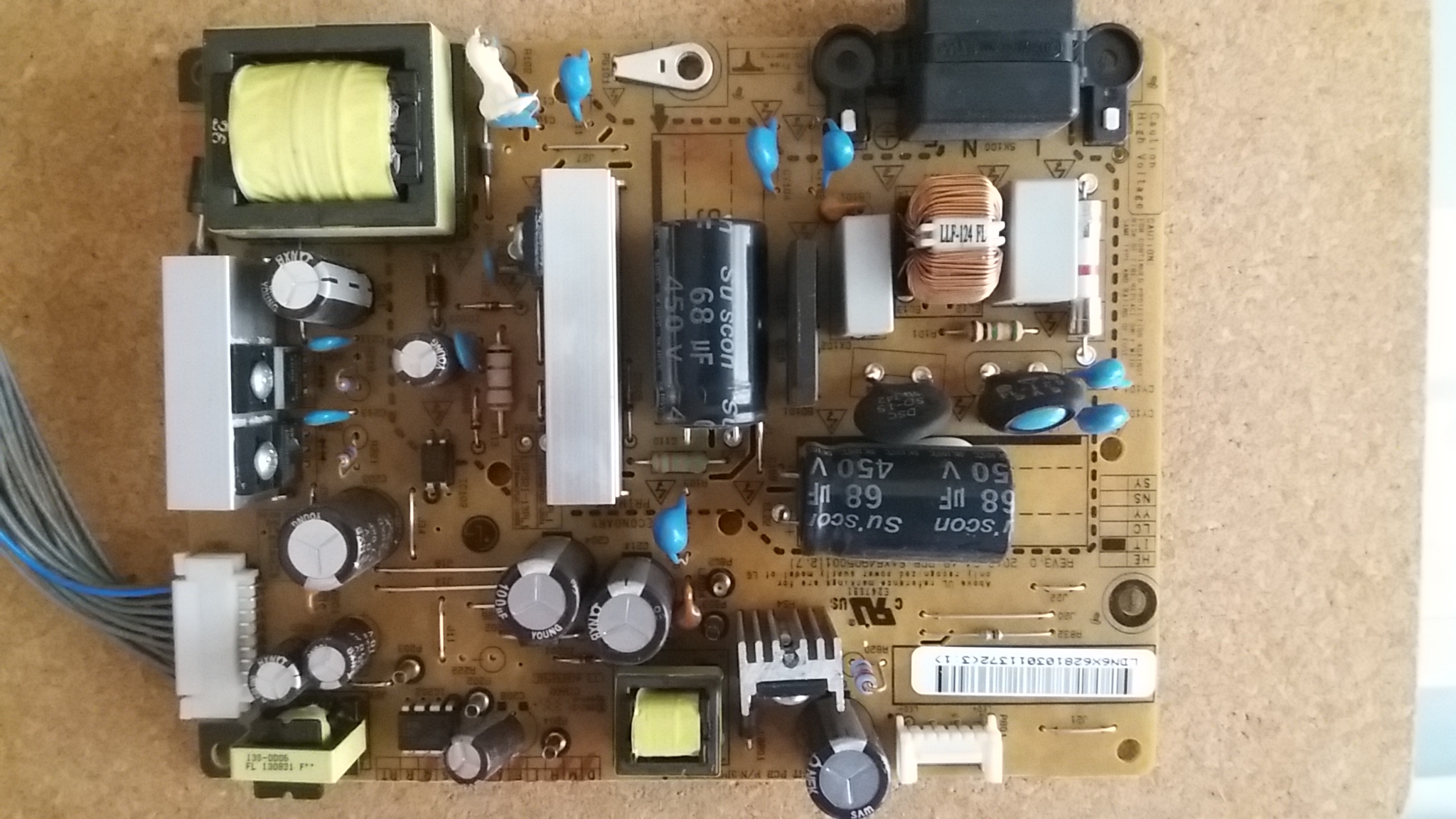

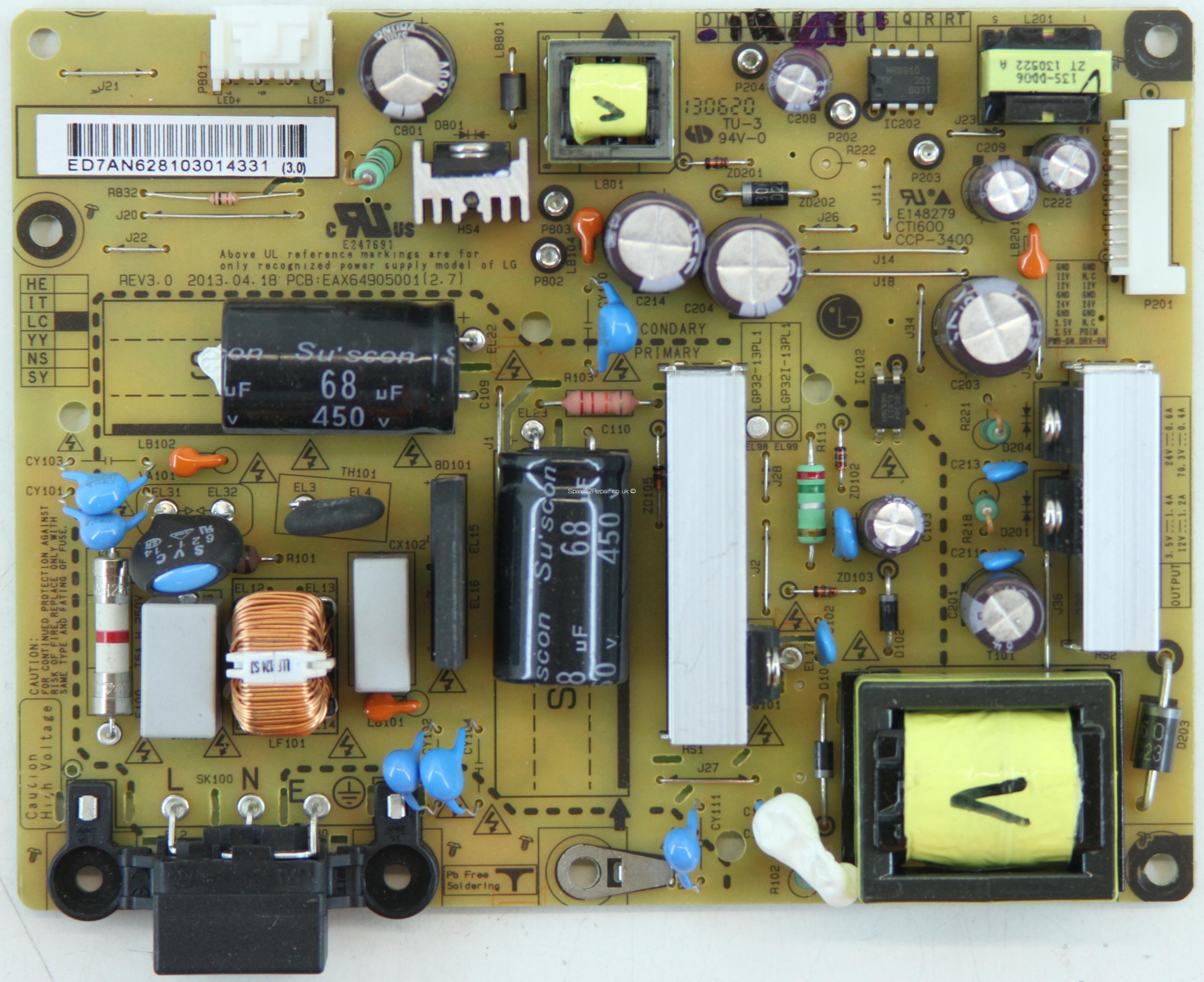

          Re: LG 32LN578V PS b/d issue
          Photos of PS b/d

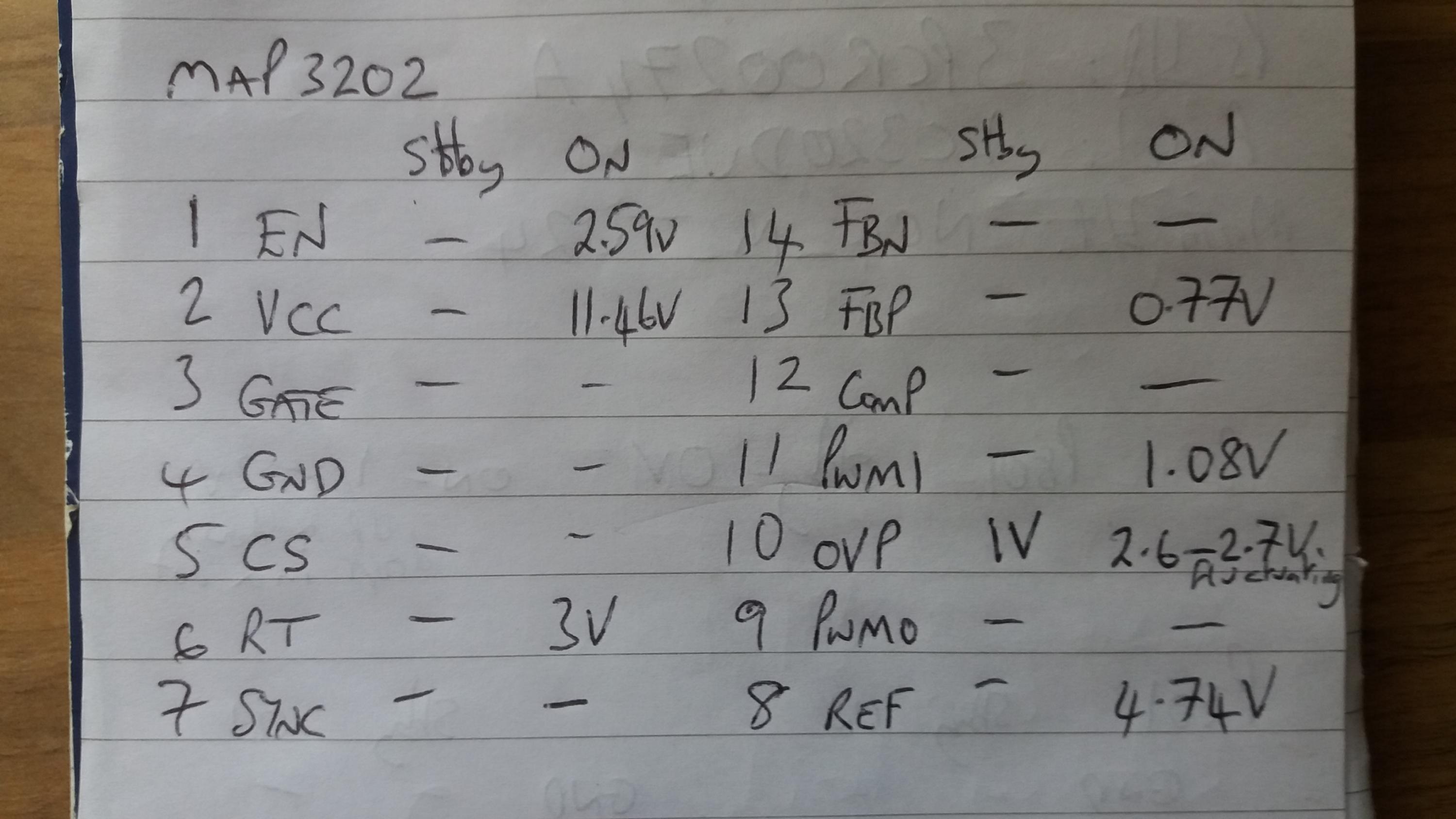

            Map3202 readings
            • dick_barton
              • Aug 2015
              • 6643
              • Wales
              The MAP3202 voltages look fine.
              VCC is within the operating specifications and the REF output may not be quite 5V, but close enough.
              The OVP looks as though it may be kicking in which would indicate the led voltage is too high which happens when there is no load due to open circuit led(s)
              I still suspect you have led faults.

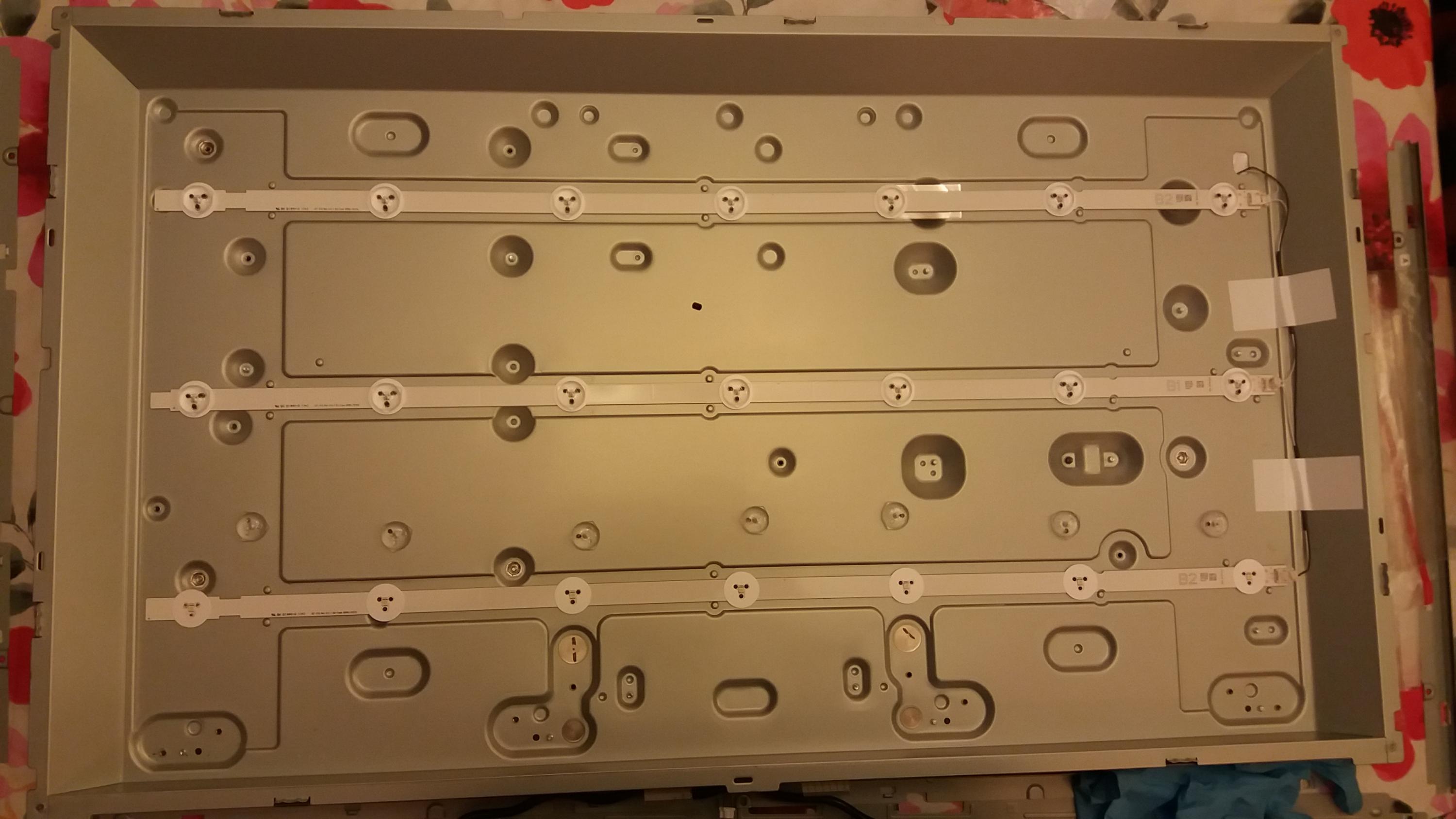

                      Stripped down the panel to find 1 led not working on the 1st strip I tested, so what leds are needed to replace them? SMD 3528 1W 100lm cool white any good?
                      Not sure my soldering skills are up to these delicate leds but worth a try for a few quid.
                          Photo of B1 & B2 Type led array strips
                          32" V13 Rev 0.0 1 B2-Type 6916L-1437A
                          32" V13 Rev 0.0 1 B1-Type 6916L-1438A
