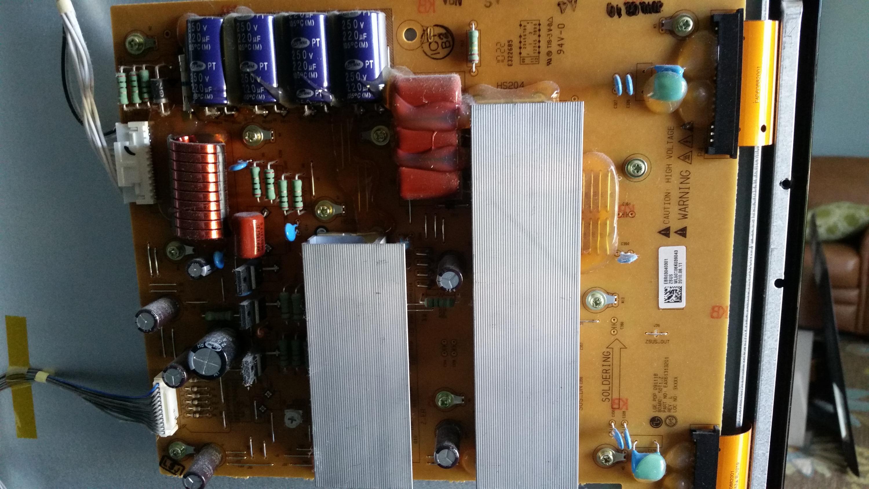

    Hey all, I have a Z50PJ240 tv with the 50t1 boards in it. I have been having pixel storm issues with it on certain screens. Cartoons and sports are fine but any dark scenes show pixels all around the edges. I had a ghosting problem along with the pixel storm and at the awesome advise of members of this forum I replaced the Z-sus board and the problem went away. I have checked all the voltages and the solder joints around the coils and everything looks good and is within spec. I have checked all the transistors and they all seem good. I am debating on replacing the Y-sus board but thought I would give a shout out for any other advice first. Any help is appreciated. Thanks!

    Photos would be handy, The ysus can open cct some low ohm high wattage resistors which present black splotches, but you may be talking of maldischarge.

      here are the pics. The ghosting was solved by replacing the Z-sus board. The pixel storm with blue green pink pixels is the issue I am having now.

        Interested in Images of the screen defects, good images of the 2 boards, last is 2.6 kb so no use.

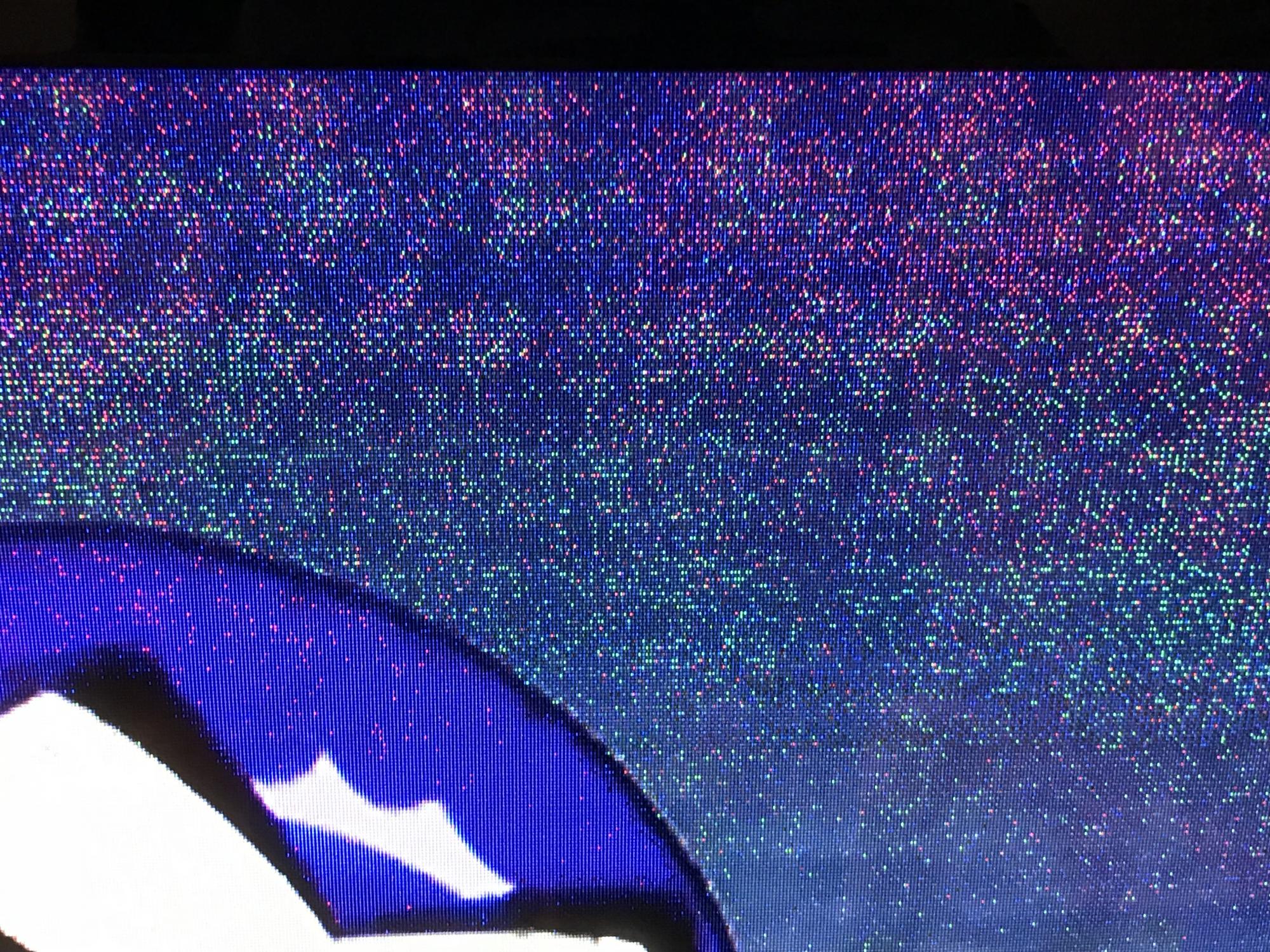

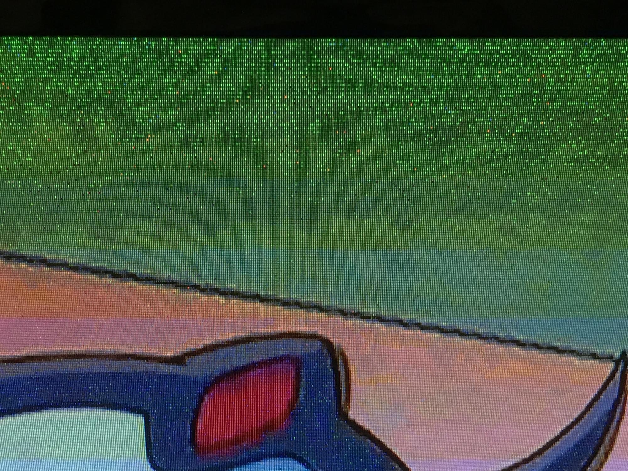

          Here are a couple of screen pics for the pixel storm.

            Must be a fairly common issue, that's where I'm at with mine. I'd expect it'll be the ysus but no idea whjat component is doing, bad cap ? WHo knows. it's only a HD TV so I have not invested any more money in it for the time being
