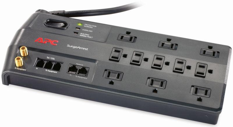

                Re: storm power surge
                Originally posted by budm
                No surge protector strip will protect the surge coming through HDMI port from the cable box.
                long time ago we had a surge protector that had cable feed into it along with phone lines.
                Did a google search and there are surge protectors for hdmi ports.
                • heavymachines
                  • Mar 2011
                  • 1028
                  https://sewelldirect.com/bolt-hdmi-i...ower-surge-esa found this, however most search results were false advertisement, you click on them and it would show hdmi splitter or hdmi device that has nothing to do with surge suppression, that apc does not have hdmi suppression just phone and coax and ordinary plugs cat 5 etc.
                  • freelancenoob
                    • Oct 2017
                    • 77
                    Correct. I posted that to show what we used years ago. That was before hdmi came out.
                      That is an in-line HDMI surge protector, never seen one on the outlet strip yet. That one is up to 1080P. You are going to need one for each HDMI.
                      Best protection is to disconnect the devices during the thunder storm and just read the book or do something else till the storm is over.
