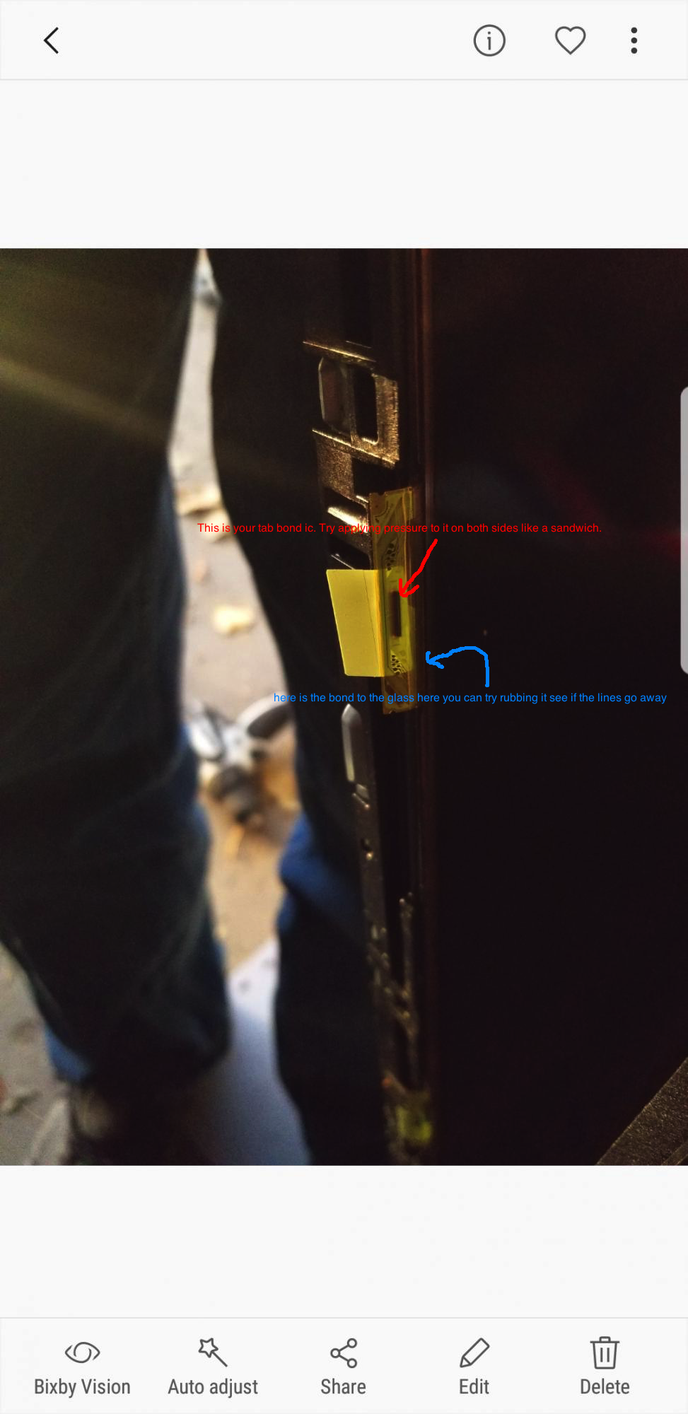

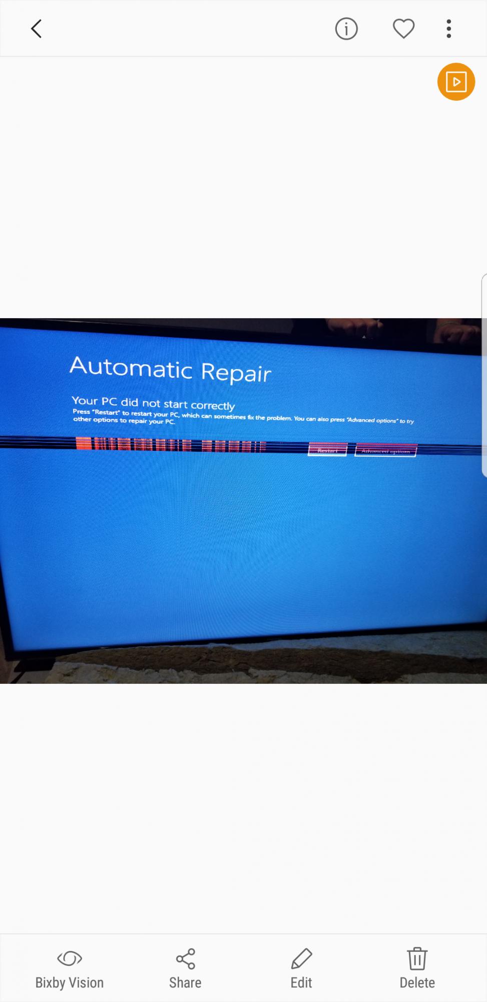

        i have figured out exactly which 2 tabs, directly across left and right from the lines in the picture...those tabs, just like the other side ones dont actually connect to anything, just hang off and had a little piece or tape on them...if i push the bezel in toward the glass (both sides at the same time) it goes away...
        no other pressure anwhere else has any effect, just those 2 side tabs

          what are those tabs for?(the ones on the side that dont connect to anything) you say to remove them?
                can you take some pictures of the tabs in question that connect to the lcd panel the ones you press and the picture goes good so we can see what were dealing with thanks

                  there are tons of posts on this. You need to do as suggested and post a very good picture with a well known tv test pattern that people can easily recognize what is and isn't there. Then you can decide on further action like removing tabs.

                    sure i will do tonight, but the lines will be in the exact same spot they are now, just harder to see with a full screen of color....thanks

                            With the bezel off I can't change anything touching the tabs, only when the bezel is on when I give pressure near the tabs on both sides do the lines go away
                                Weird indeed. So pushing on tabs at the glass edge does nothing, ok try this, you see the shiny mirror elongated ic's on those tabs? put something non conductive under those ic's like a rubber drawer bumper or wood even for this test and apply pressure carefully on the topside and see if it makes any difference sometimes those ic's will start to detach from the printed circuit. Pressure on ic like a sandwich.

                                  The shiny part not touching the glass loses the picture, with finger pressure no bezel, touching the glass brings back the picture, but doesn't affect the lines... I was hoping a simple shim work around, but it's puzzling for sure... On the inside of the bezel is what looks like metal tape all the way around, does that need to be in contact with tabs? Is it possible when pushing on bezel and the tape makes contact it fixes the issue?

                                      Originally posted by heavymachines
                                      ok don't think we're on same page, i'll see if i can find some examples online.
                                      In the middle picture is that oval you see in the tab what you are referring to?

                                        I can't find the exact video of the fix been few years buried on youtube somewhere however you can try to do this on every tab in the general area of the lines on screen and you can do this while tv is running. instructions on edited picture.

                                          your problem is that you need to isolate which side is the issue. At the bottom of the set, the edge boards are "interconnected" with clampable flex cables. Look along each side of the bottom and disconnect the flex cable clamp / cable at that point. Does the remaining picture clear up? Repeat the "test" on the opposite bottom "half".... any difference? Go from there.
                                          PS. you still didn't follow my suggestion of putting up a known test pattern. :-(
