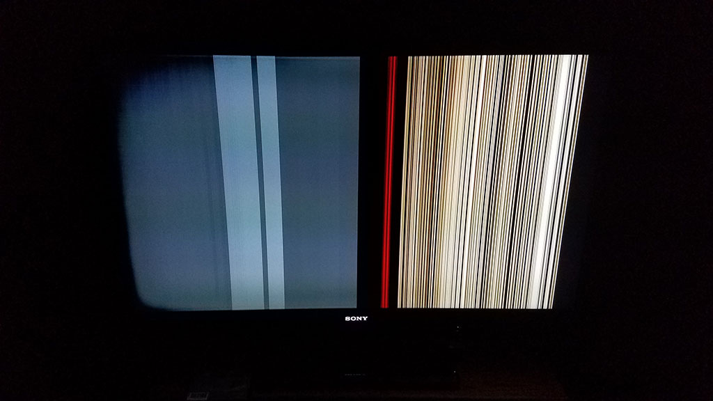

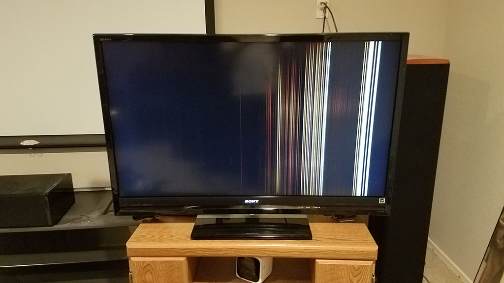

    I've seen a few threads about this issue, but no clear conclusion. I have a Sony KDL-46Z4100 and when I turn it on, it powers on and the backlight comes on. Then there are some lines down the right side of the screen. If I hit the Guide button on the remote the lines change and a white cloud slowly grows from the right side of the screen to the left (see linked video) and some more lines show up on the left side of the screen.
    From my previous experience with a Sony 46XBR6 TV I had, I figured the problem was the T-con board. I bought a replacement on eBay and the TV still exhibits the same issue.
    Do you think...
    1) I got a 2nd bad T-con board off eBay (sounds crazy, but with my other Sony TV I ended up getting THREE bad T-con boards before I finally got a good one and everything worked), or ...
    2) Bad main board, or ...
    3) Bad panel?
    Help.

    I should also mention that if I look at those lines you see in the picture closely I can very faintly see some letters in the upper-right corner of the screen (where the input would normally display), and if I press the input button, the lines fade away very slowly and other lines appear in different places very slowly.

      I'm thinking bad panel. What happens when you unhook t-con to panel cables one at a time?
        Re: Sony KDL-46Z4100 bad T-Con?
        Try flexing the panel to see if the lines will change.

          Flexing panel had no effect. Pictures of panel with left ribbon disconnected and right ribbon disconnected are attached below.

            sounds like panel to me. you could strip it down to the screen and see if pressure on or around the cof chips affects the picture.

              It does looks like a bad panel fault especially the way it sweeps across the screen.

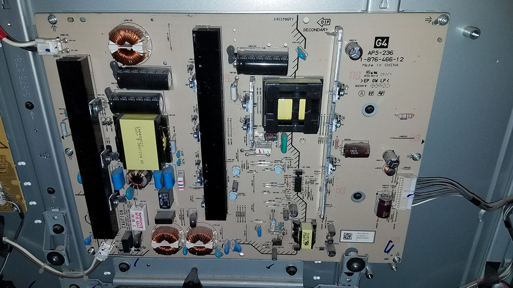

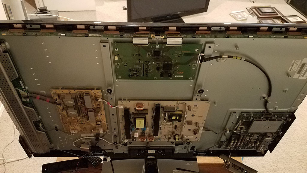

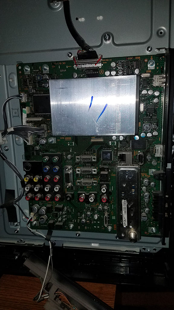

                Update on this set. I would've given up on this days ago, but I wanted to take the investigation to its conclusion because I saw so many threads here regarding this model or similar models that never got closure
                I bought a new T-Con and a new Main Board.
                Old T-Con, Old Main: Lines down screen, but TV stays on.
                New T-Con, Old Main: Lines down screen, but TV stays on.
                Old T-Con, New Main: Lines down screen, TV shuts off with 14 blink code (High Frame Rate 120Hz Error)
                New T-Con, New Main: Lines down screen, TV shuts off with 14 blink code (High Frame Rate 120Hz Error)
                **Q1: Not sure why the behavior is different with the new main board vs the old main board? Any ideas on that?**
                But the symptoms at this point do seem to point to a defective panel. I took the front apart and tried putting pressure on each of the tab bonds both on the panel side and the circuit board side. No effect. The panel LOOKS ok, so I'm thinking maybe defective components on the circuit boards that are bonded to the panel.
                **Q2: What do you all think? Defective panel? Due to faulty components?**

                        I still think it's a bad panel. I currently have a set that does exactly as shown in the video. If I keep quickly changing Source I will sooner or later get a picture but still showing bleeding on highlighted areas of the picture.

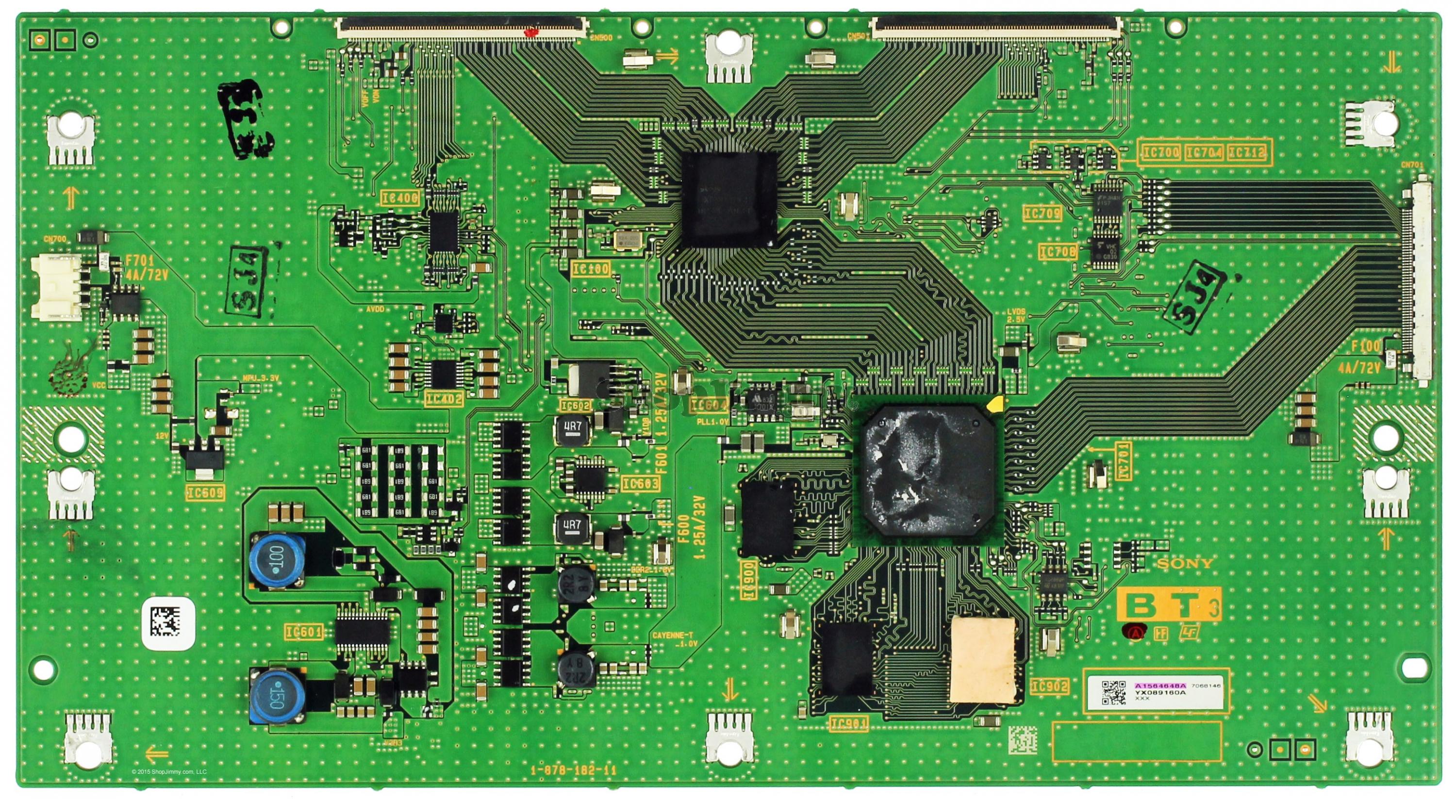

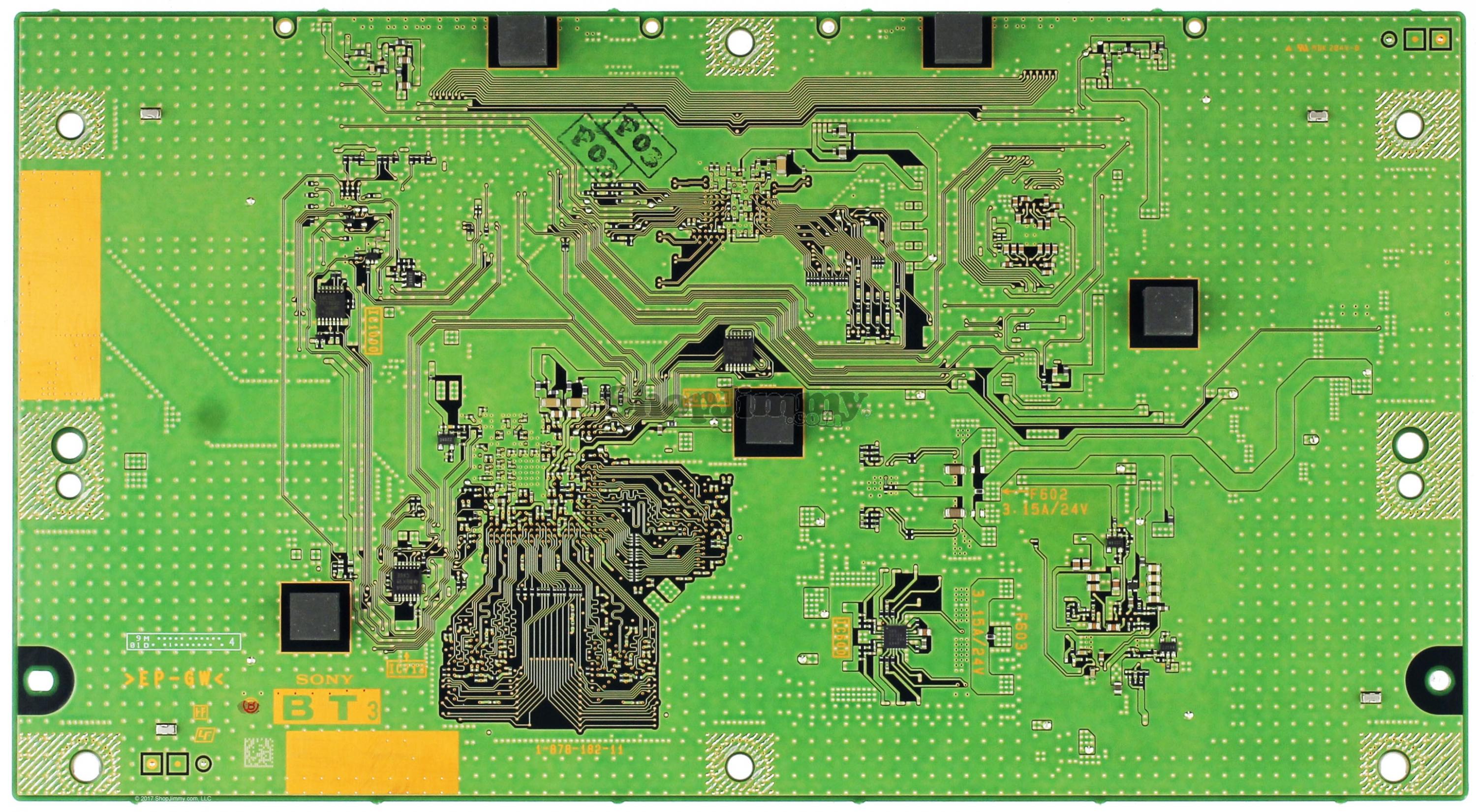

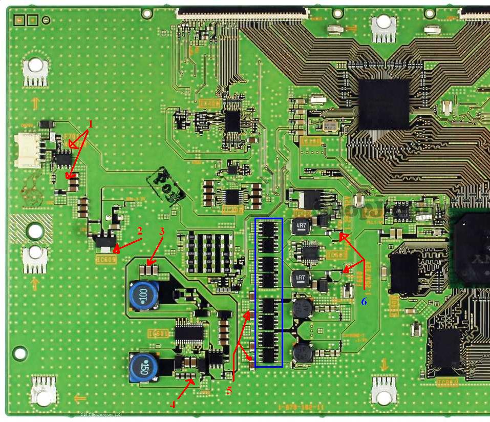

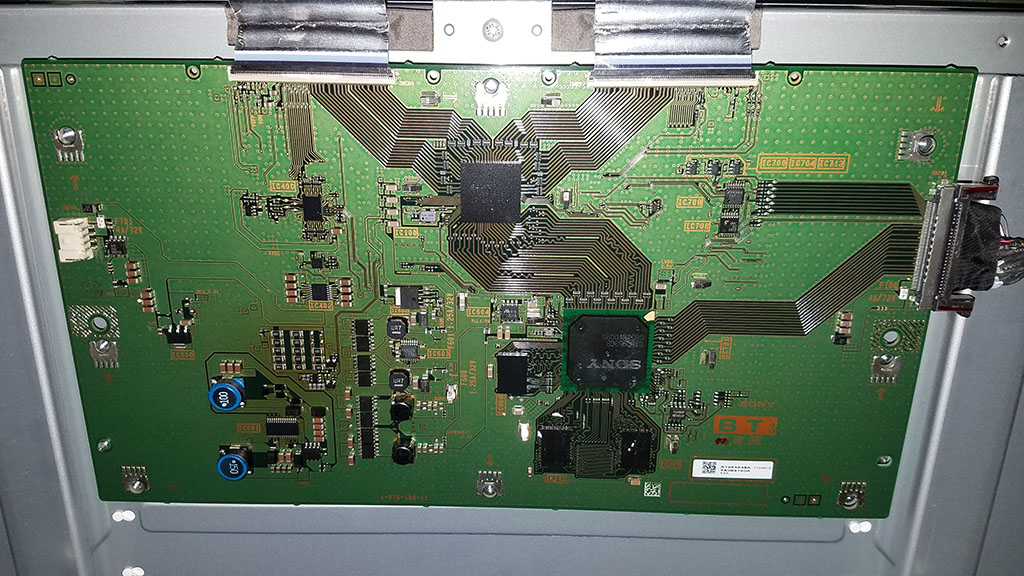

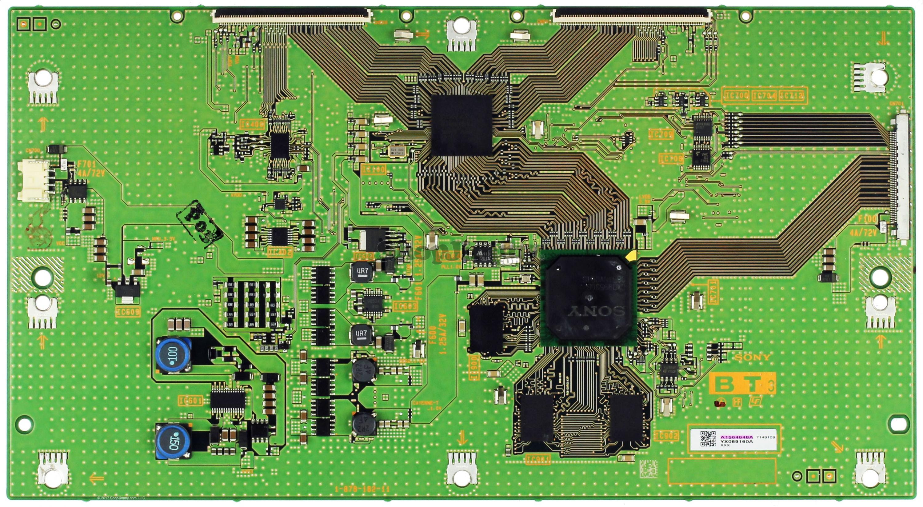

                                I need a photo of the tcon in hires perpendicular and without reflections, a good idea is to grab it from Shopjimmy and post here, search for its model code, i'm unable to see that site.. for now, just to make you in action, watch the board, you see a column of 4+4pin chips, those are almost sure power mosfets, are you able to test them for short?
                                • Daveleone
                                  • Apr 2016
                                  • 267
                                  Here's the pic of my T-Con (model A-1564-648-A). I also included a pic of A-1564-648A v2 because I'm not sure how to distinguish whether I have a v1 or v2 board.
                                  Also, I don't see the 4x4 pin chips you're talking about. Can you point them out? Thanks!

                                        HI, i refer to your first photo, that is the only important, i will mark in () the tension is supposed to be for me approx., points 1 (12V), point 2 (3,3v), point 3 (<0v), point 4 (>20v), point 5 (>12v), point 6 (<12v), the point 6 are fuses, must be measured on one terminal and the other. Blue rectangular shows the power mosfet that i know usually fails on that type of boards, measure in diode mode between the 3 legs joined and 4 legs joined, one way and other (swap probes). Good work..
