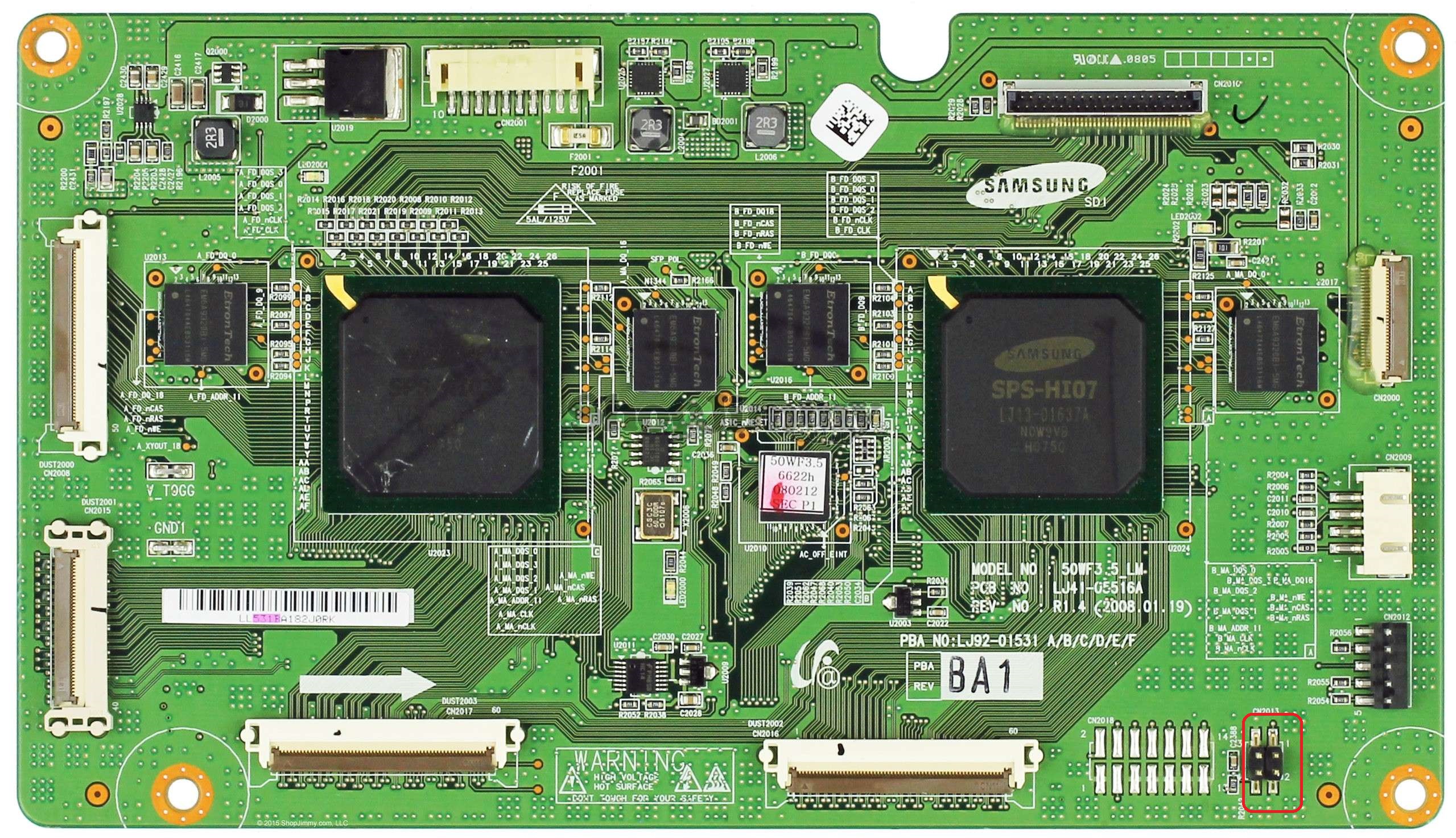

      Which pins do i short on which board.....i included a pic of logic board few posts earler
        Re: Samsung plasma wont power on pn50a550
        Are pins 1/3 on the bottom right of logic ...top 2 pins?....in the group of 4 pins?
        See photo i posted earlier
          I mean pins 3/4.....
          I dont see a pin marked 4 but i do see 123....i can assume the other pin is 4?
            And which cable do i disconnect?
            The lvds or power ribbon cables going to main?
              Ok i removed the lvds cable from logic to main and jumpered pins 3/4 on logic and tv still cycles on and off and repeats indefinitely

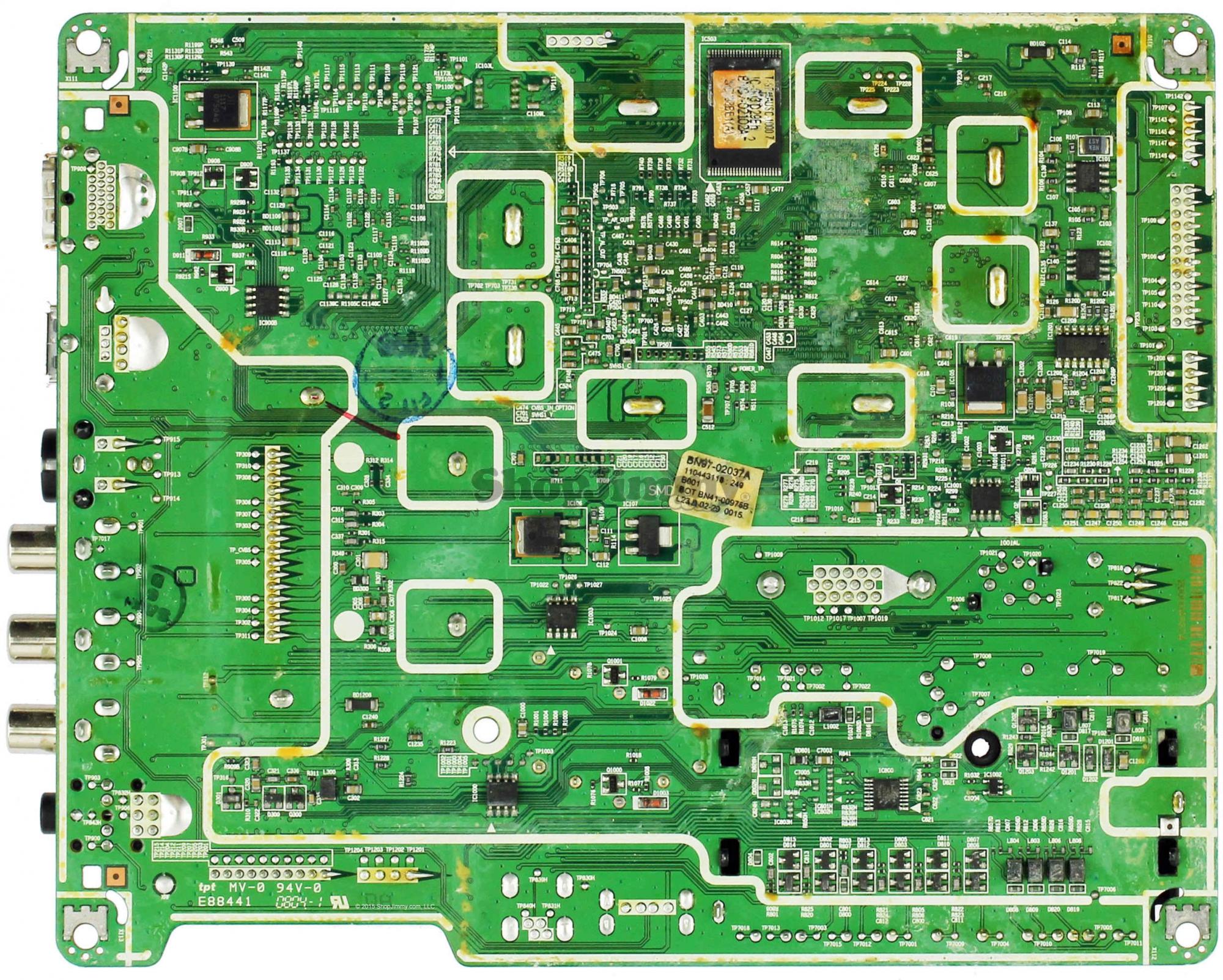

                                    Hi here is a photo of bottom of board...can u tell me where the 2.5v output cap is....i already replaced c102 the 3.3v output cap....didnt fix issue
                                      #38
                                      I found c131 it was on top side of board not bottom like c102 is on
                                      They are both same spec caps....i will try to replace c131
                                      To test voltage on c131 would i just meter both ends of cap and should be 2.5v?

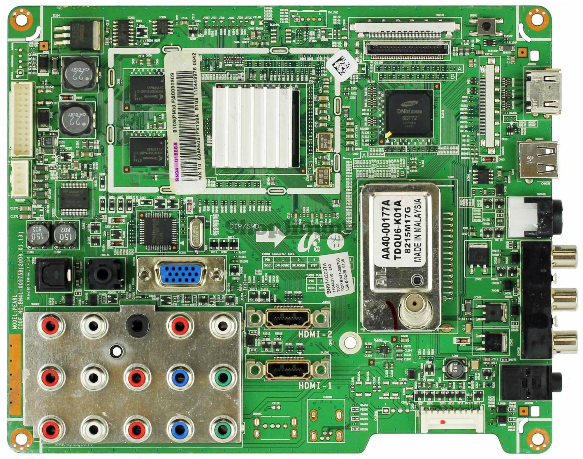

                                        Top of board photo
                                          #40
                                          Hi kc8adu
                                          I replaced both caps c102 c131 tv still cycling on and off
                                          Any ideas?
