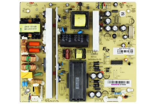

    The set played up for awhile then came good, then intermittent, and now turns on normally, flashes Polaroid logo, trys to continue then turns back to standby. I think ( in order) power board, main, eeprom. Owner is willing to spend the dollars to get a fix but my problem is no info for this make. Power board is ER991 rev 1.0 no other designation other than Part AE005329-20151024 these last 8 being make date I assume. Panel is T650HVN05.502
    I have yet to do test on the power board. It has 18pin putting out 24v 12v 5v 5vSB PSON BKON ADJ and first up will connect 5vSB to PSON and check other voltages stabilise. Another connector is for LED + - and my experience there is almost zero. Have yet to take pics etc but ShopJimmy has good pics for the RCA models. An ongoing problem for me is to find correct parts or whatever. Meanwhile posting this for any input and if I'm on the right track?.

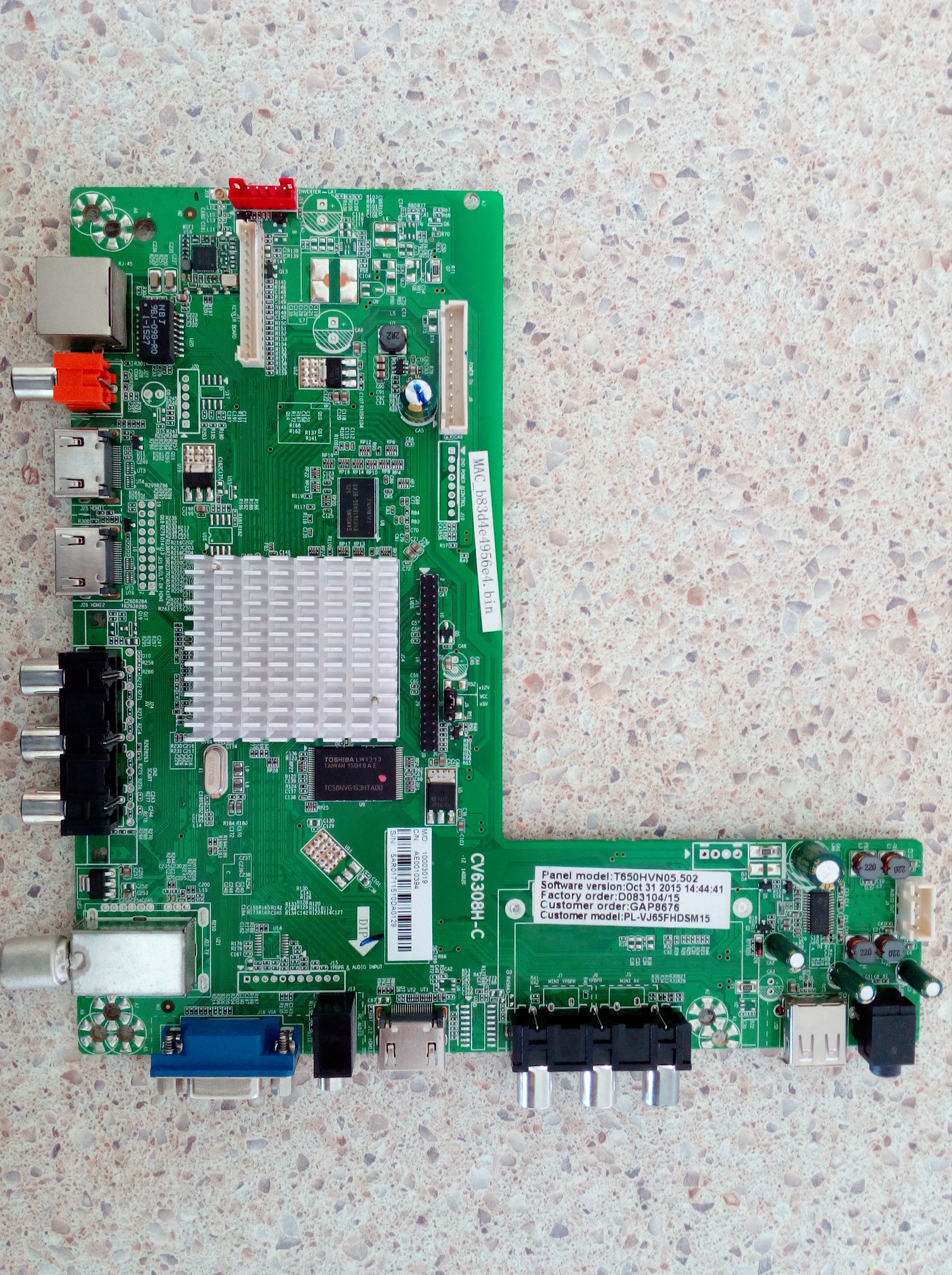

      Well got back to this large set which is at the owners house. First I checked main cap voltage was good then forced power board on alone and the voltages all came up OK so then forced backlight on and all stayed on OK. This seems to rule out power board so am now directing my attention to main which is designated CV6308H-C and all I can find about for this board is very little indeed other than appears in Goodmans a model I've not heard of and is EU UK type with scart connection.
      Do not have pic of whole set setup but only other boards are FRC (frame rate?) and Tcon. I am pretty much in the dark with this job as no info at all to work with so any thoughts at all appreciated.

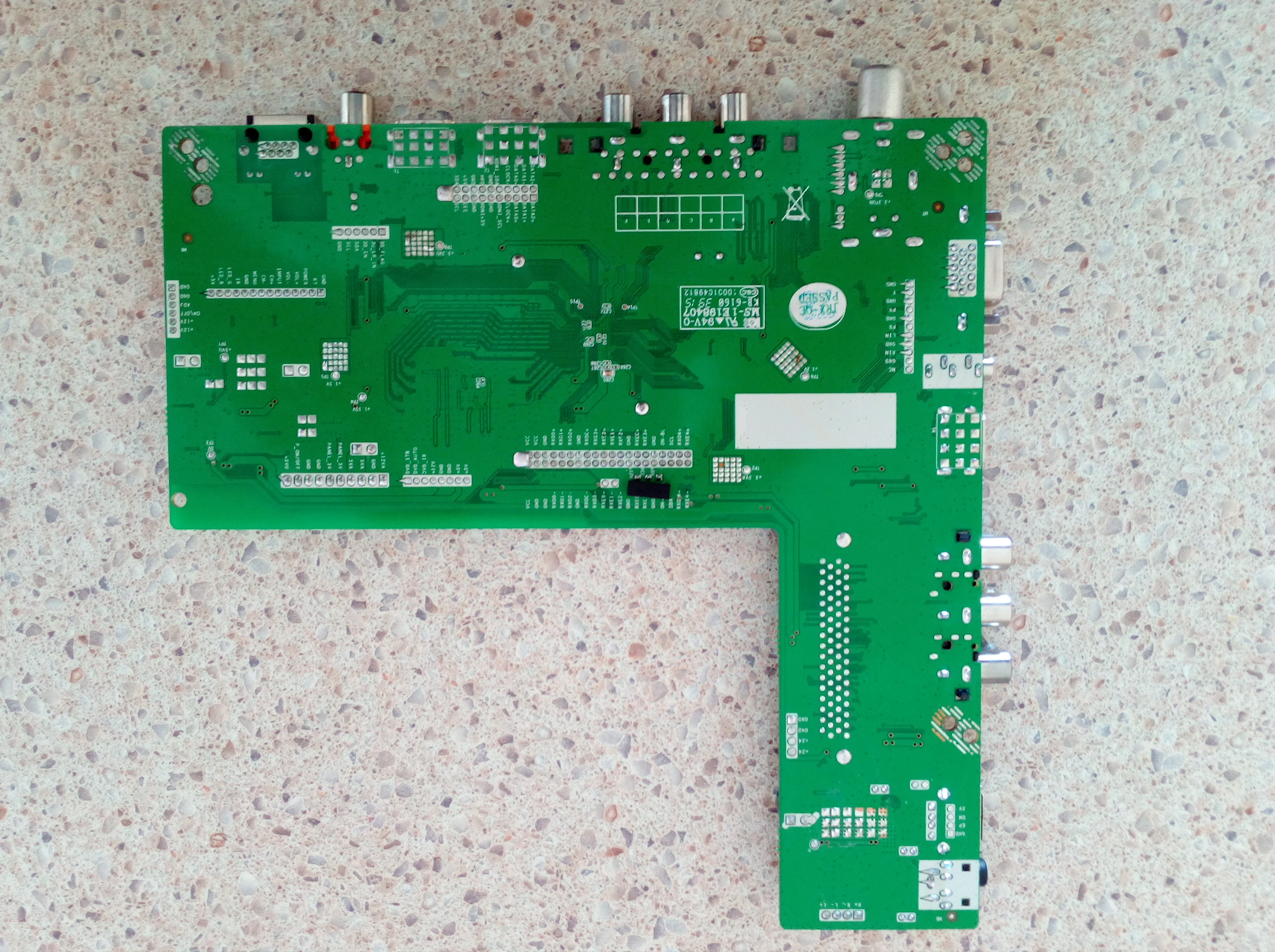

          Re: Polaroid (RCA) PL-VJ65FHDSM15 On/logo/off
          Thanks dskall I'm having trouble identifying the eeprom as the only 8 leg ic is on the FRC board. I have got the main board with me and have just looked at the 2 regulators which are 3.3 and adj. The 3.3 (in ohms) 69. 1880. 0. and the adj 164. 410. 0. and little idea if those readings are ok but a big variation on Vout pins.
            Guess they call it a nand flash. The 48 pin with red dot
                Based on history and a little experience with firmware I am still looking at power issues as I think eeprom problems see set "hang" at startup rather than turn off. Near main connector on the main board is a Samwei 470uf 16v capacitor which I will replace. Measured the regulators again by ohms to Gnd and starting with U12 adj near power connector then U19 3.3 below then U25 3.3 near tuner then the larger one U5 near lvds I recorded.....93. 254. 0459.
                0. 495. 1710
                0. 826. 1585
                0. 458. 1585
                and would like some input on these readings. I do suspect the adjustable ldo as I couldn't get any reasonable voltage reading when in circuit but set was turning off within 15-20 seconds, conversely the ldo under it read correctly with just over 5v and producing 3.3v on pin2.
                If it is eeprom problem have had no luck finding either a replacement board or the firmware. Only board seen of same number is a Goodmans 50" set and even if it was OK would still need firmware so catch22 for me. Have emailed supposed support for Polaroid here in Oz asking re availability of replacement main but no response as yet.
