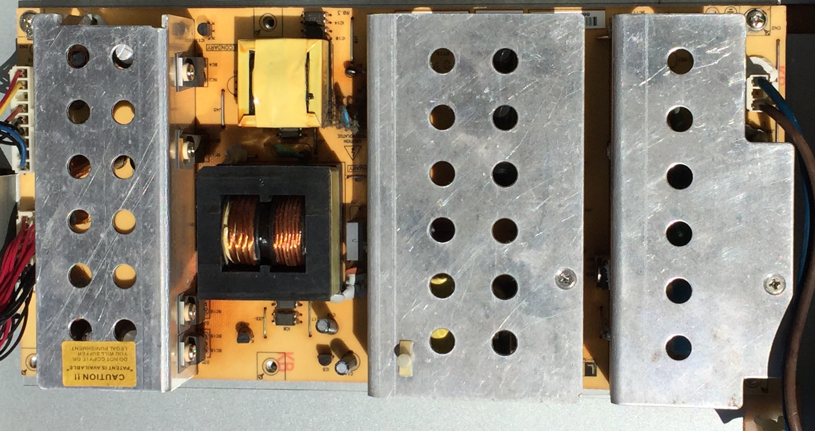

    The Tv's relay keeps clicking and the voltages fluctuate. The clicking relay is at location RE1.
    on/ off 0.8V--5.2v
    +5VSB 0.8V--5.2V
    12V 0.8V--12.2V
    24SP 0.8V--25V
    24V 0.8V--25V
    Main filter cap goes to 462V and drops with relay clicks.
    Thanks for the help.
    Re: Polaroid TLA-04641C clicking relay

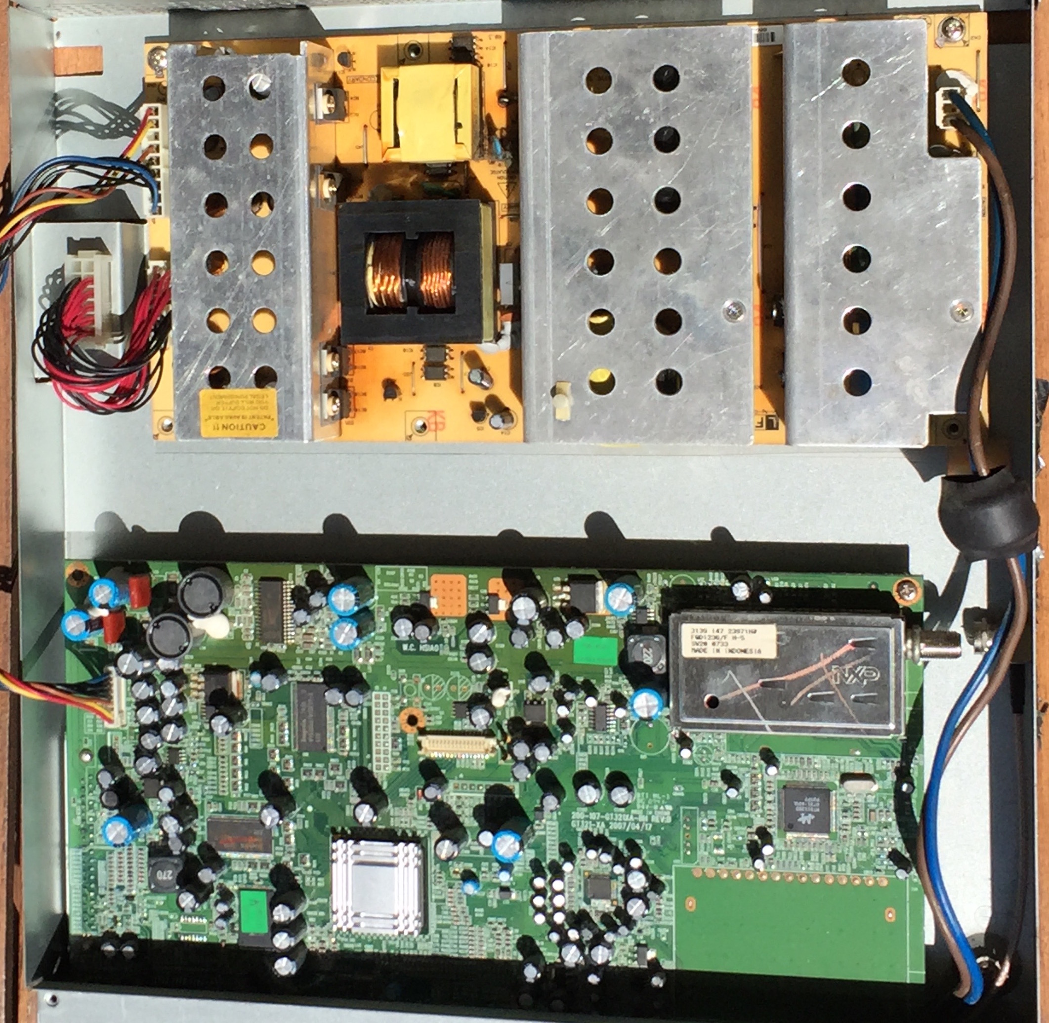

    Can we get side view of the power supply board? There should be small stratup-running lytics caps under the heatsink for the standby power supply section.
    Unhook the cable between the main board and the power supply board and then power up the power supply board by itself and check to see if 5Vstby will be steady 5V or not.
    "Main filter cap goes to 462V" What did you use for the GND ref for the meter to measure that filter cap Voltage? Chassis? You need to measure right between the two legs of the cap because you are making measurement in the HOT side circuit.

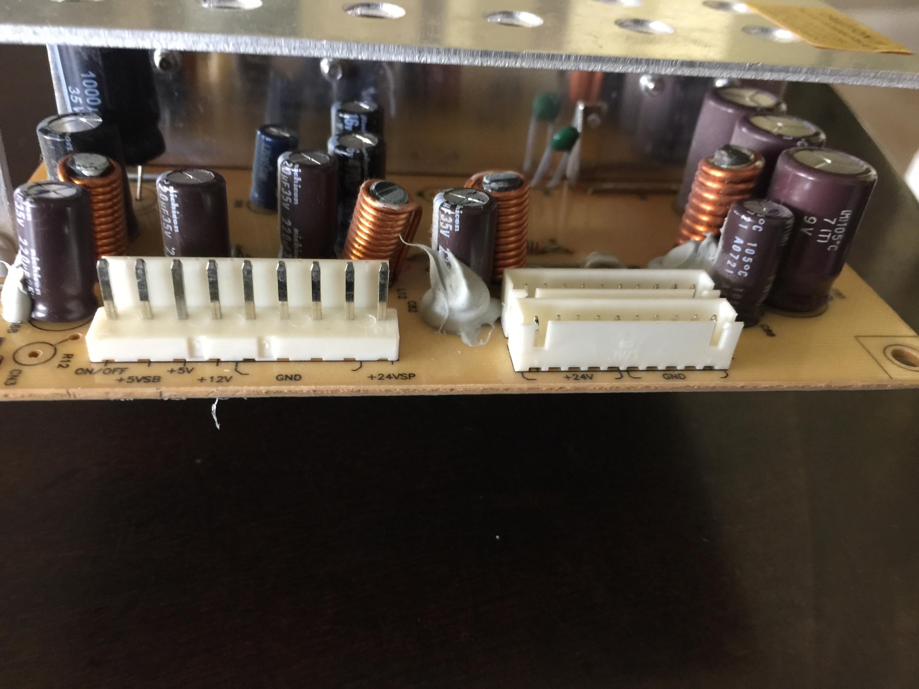

        Check all caps under heatsinks for bulging
          https://www.badcaps.net/forum/attach...2&d=1506707143
          There should be small caps under the second heatsink from the left.
          If you truely having 462VDC between the two legs of the main filter cap which is rate at 450 VDC then you have problem with the voltage regulation of the PFC booster circuit problem, it should cause the protection circuit to kick in otherwise that main cap will blow up big time.

                I checked it with another meter it will go somewhere between 442v or 435v for less than a second and then the relay will click and the voltage starts to drop until a hard click. The cycle just keeps repeating itself. There is a 47uf 50v cap and a 10uf 50v cap under the heat sink you referred to earlier.
                  The relay is clicking because your standby 5V is not steady for running the main board so the main board is sending out pulsing PS-ON signal instead of steady DCV of 2V or more.
                  Those two small caps are startup/running caps for the standby power supply section, if they are bad they can cause the STBY 5V to be unstable under load, so you can try replacing them first to see what happen.
                  Over output Voltage of PFC circuit is another problem, if the reading is true for sure.

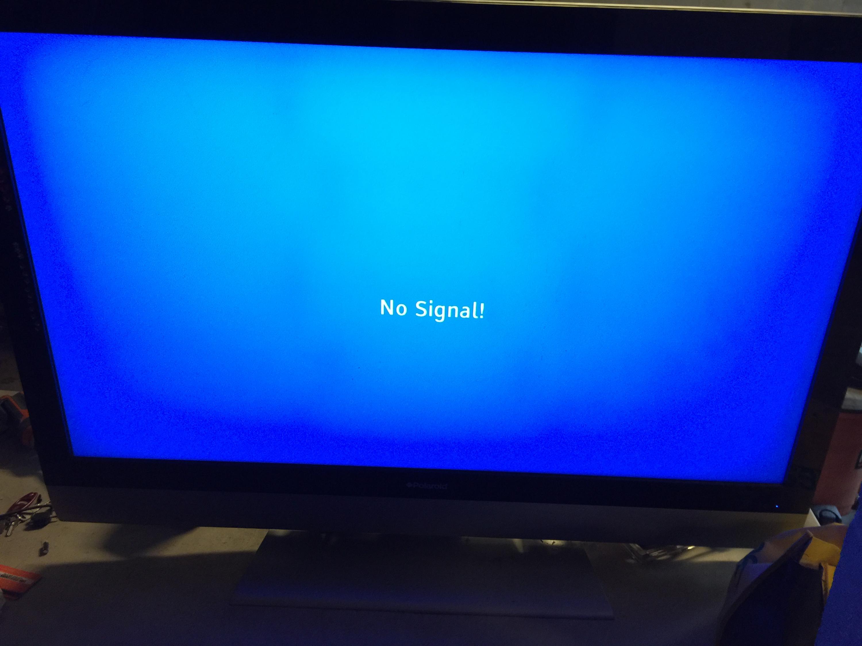

                    I replaced the startup caps and now it powers on. I will replace all of the caps.
                    I would like to thank everyone for their help.
