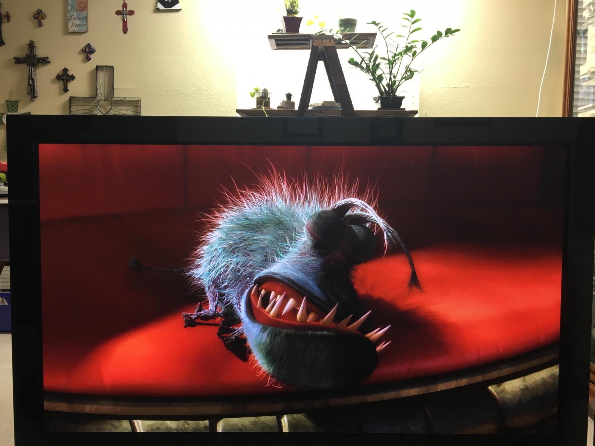

        Tv is working. Didn't even have to take the back cover off.
        I was in the process of removing the screws and saw the main power switch button. Pushed it in. Plugged tv in heard the start up click and had standby light. Turned it on and have been watching it for over an hour now. One thing I noticed is none of the fans are running. There are four fans at the top. Do these spin only when it gets hot enough?
        Thank you

          Fans do not run unless panel temperature hits 55C or so. So you're good.
          Nice fix!! Great TV, treasure it well, they do not make anything close to the performance of one of these sets.
