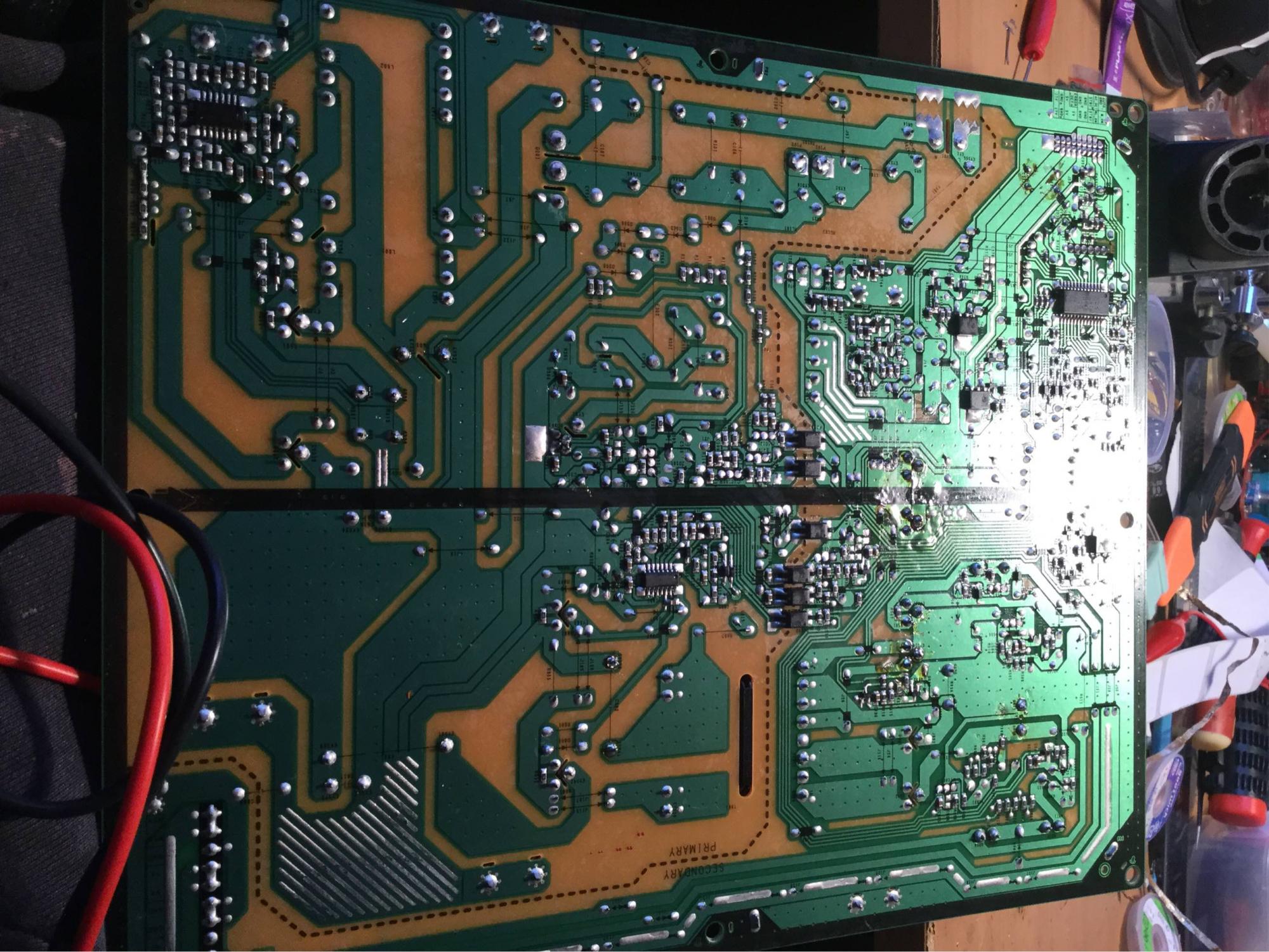

    Doing more testing around the board...
    There is a R2A20117 right neat the va/vs output wich i can tell controls the mosfets. It is not getting power :/
    Now can somone who is truly wise explain, does each part of the main baord work kind of independantly, or is there a main process that turrns each chip or cucuit on when conditions are met?

                  yeah you may be right, tommorow I might try a powered test, and follow the power track backwards. ill find this join.
                  Also generally these are shit PCB's, even when soldering a single join, the heat causes the top layer to separate from the board :S

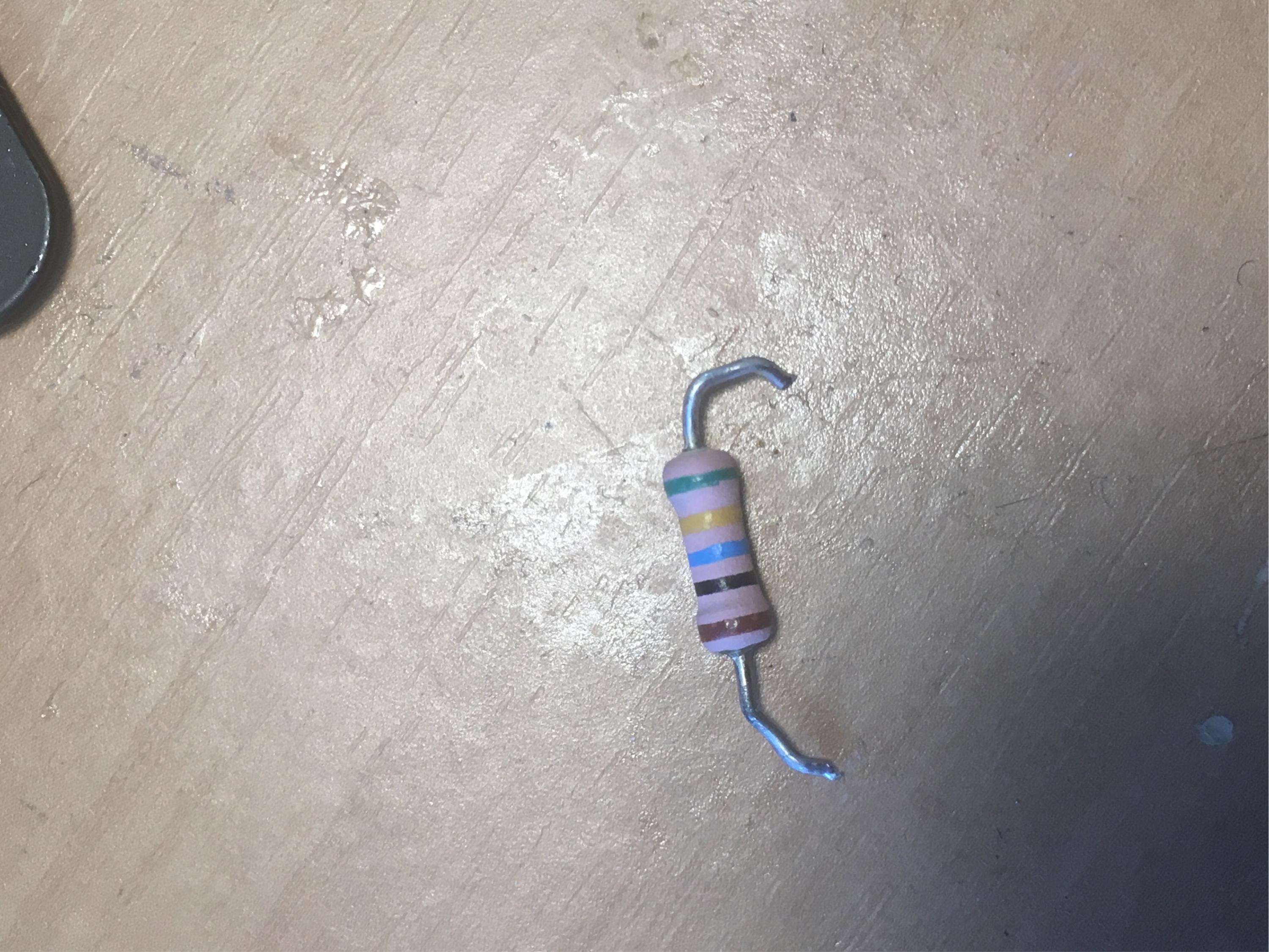

                      Hey stupid question, what would be this guys value?
                      • attainteddragon
                        • Apr 2013
                        • 764
                        • australia
                        Re: LG 42PJ350 clicking (yes another one)
                        starting from the brown side, i got 1.06m .5%
                        i hate colour codes.
                        WHY CAN'T PHILIPS USE PHILLIPS HEAD SCREWS?
                        • The_Todd
                          • Jul 2017
                          • 66
                          Realy? It reads about 10M on multimeter, it connects the main DC negative to hot ground
                          • tw2005
                            • Oct 2011
                            • 6458
                            Yeah, weird coding but 10 Meg, Mine reads about 9.8 Meg in cct

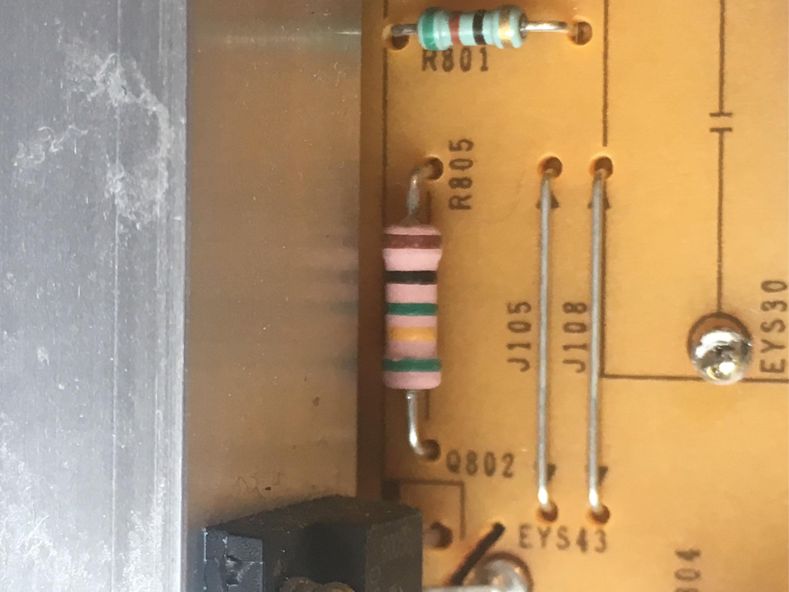

                              Ok cool,
                              And this ine only reads about 4K in curcit, what should this read?
                              Cheers
                              • dick_barton
                                • Aug 2015
                                • 6643
                                • Wales
                                Looks like a 1 Mohm but best to lift one leg out of circuit to measure.

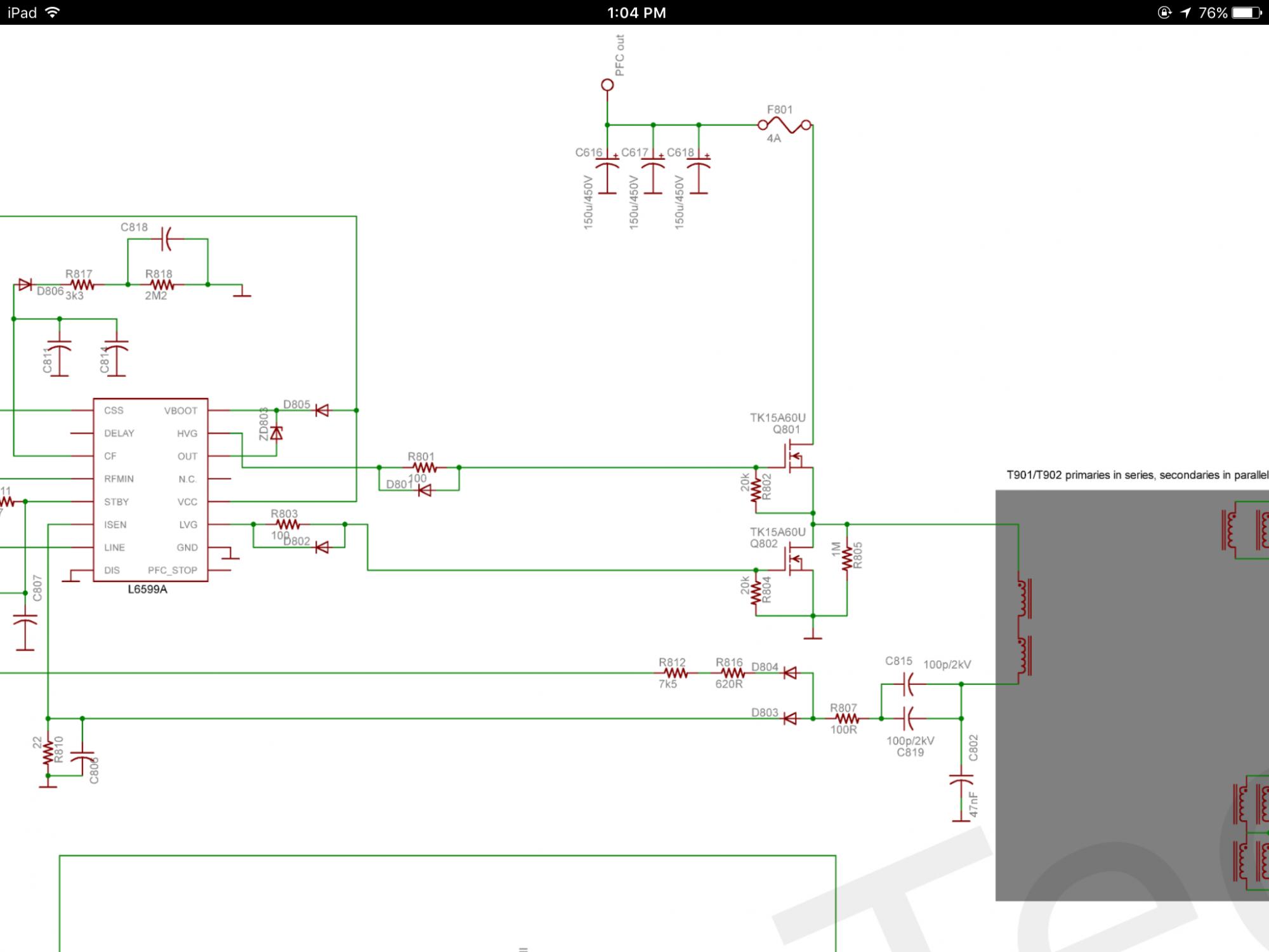

                                  Ok so over 9001 hours of reviews and reading, im fairly certain the problem lies with the main VA/VS supply curcuit (or the power supply to it).
                                  The L6599A give a very strange and eratic pulse signal to the mosfet, (mosfets are ok btw) and the of course stops and "click click" reset, and there is no output at all from transformer, and from what i can mesure no where near enough voltage going into the transformer.
                                  Now can comone have a look at the attached curcuit and expalin or point me in the direction of how the dual mosfets (Q801 &q802) work together to run the transformer, as So Far i only have seen single drivers.
                                  Cheers,
                                    1.05M Ohms .5% r805
