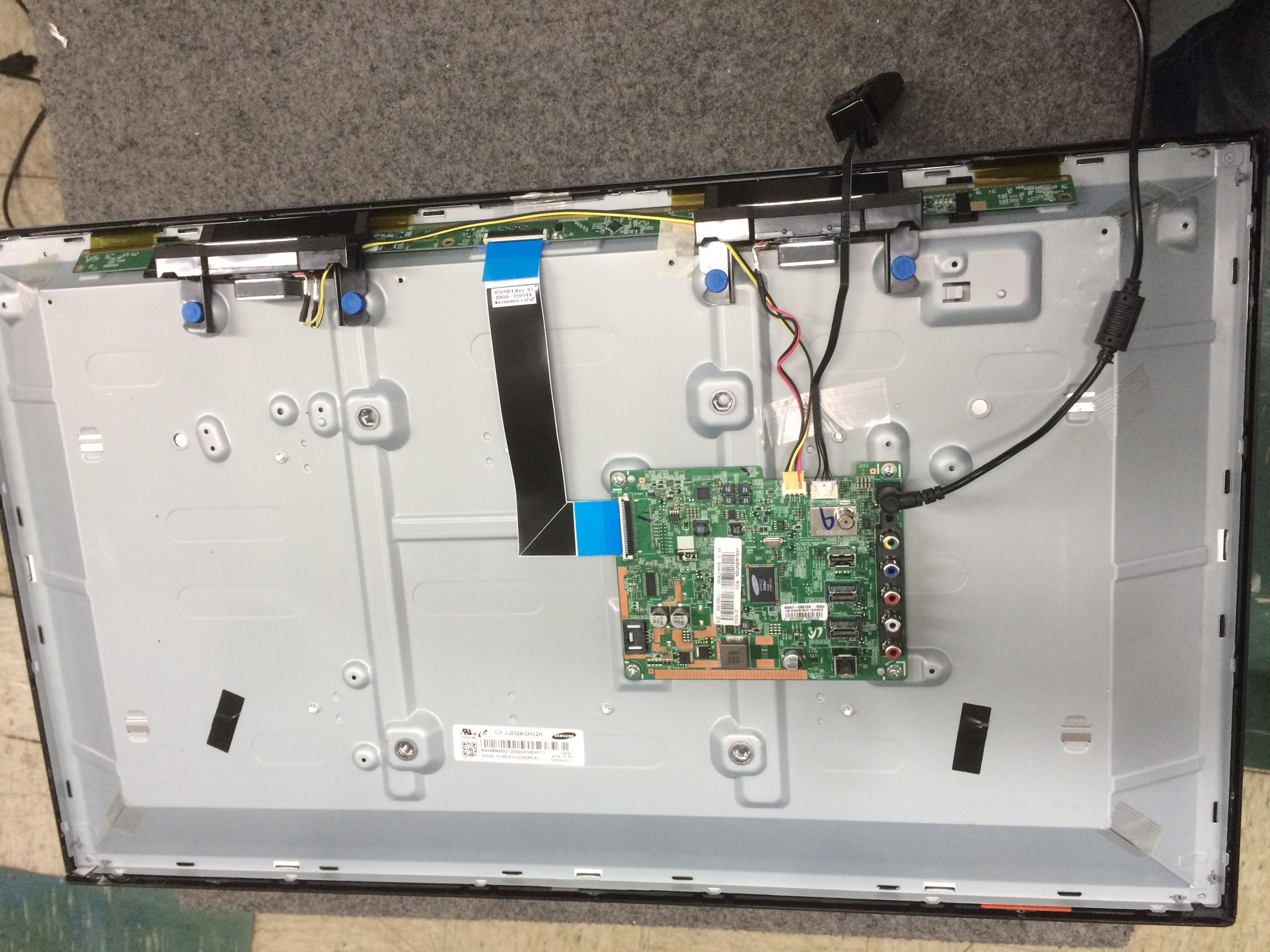

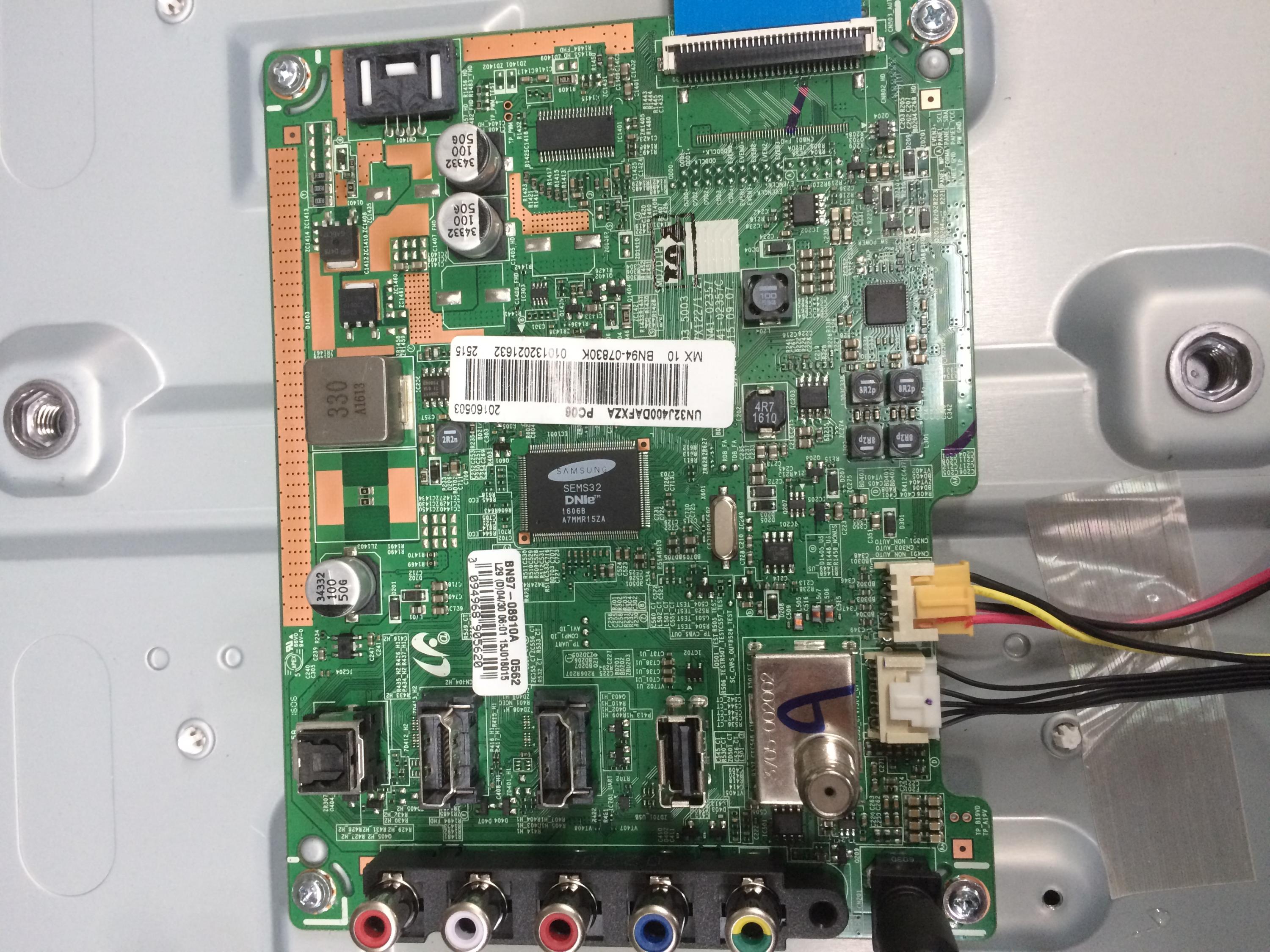

    I am working on a Samsung UN32J400DAFXZA that is not lighting the backlights. Video and sound are good.

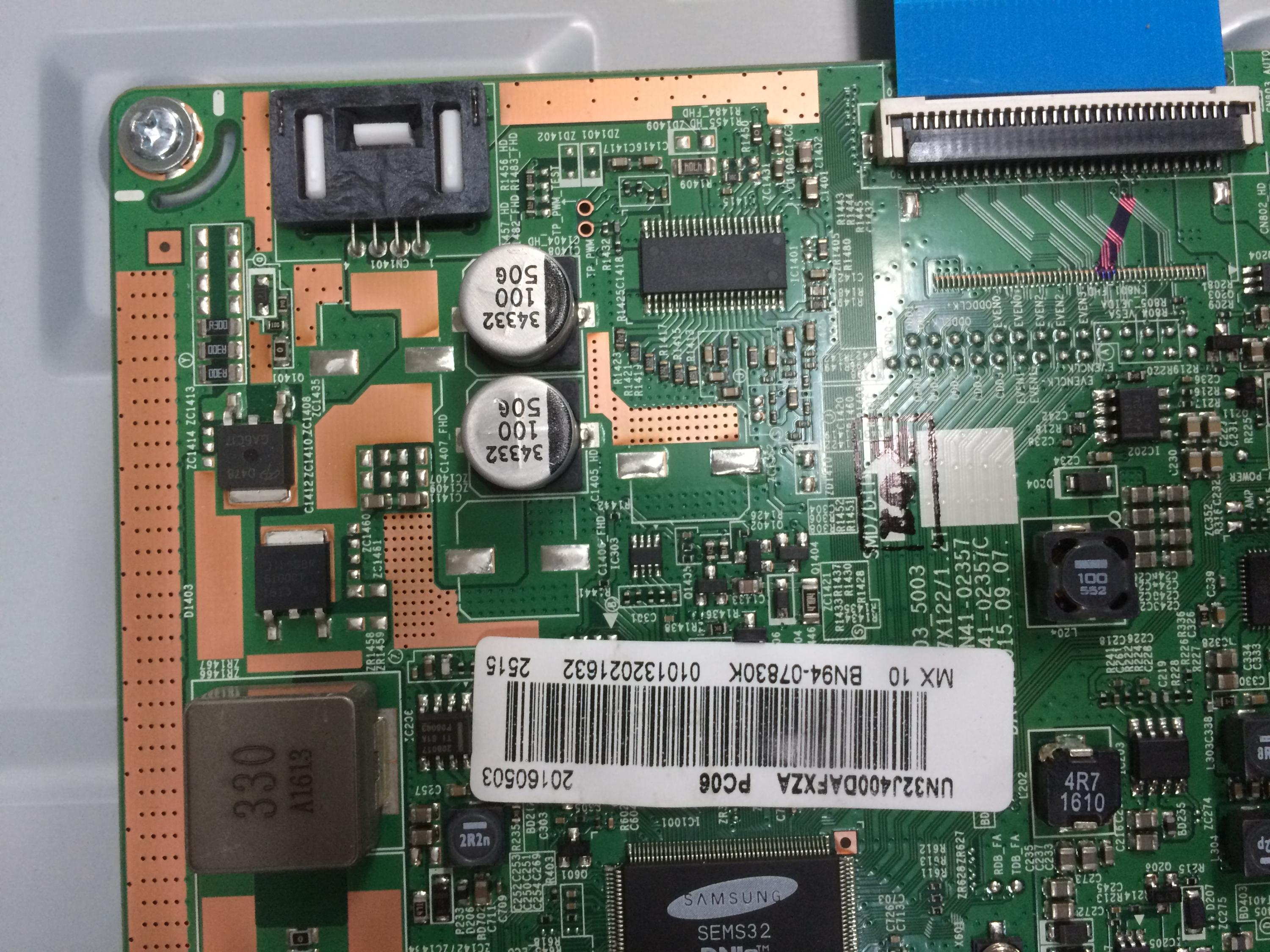

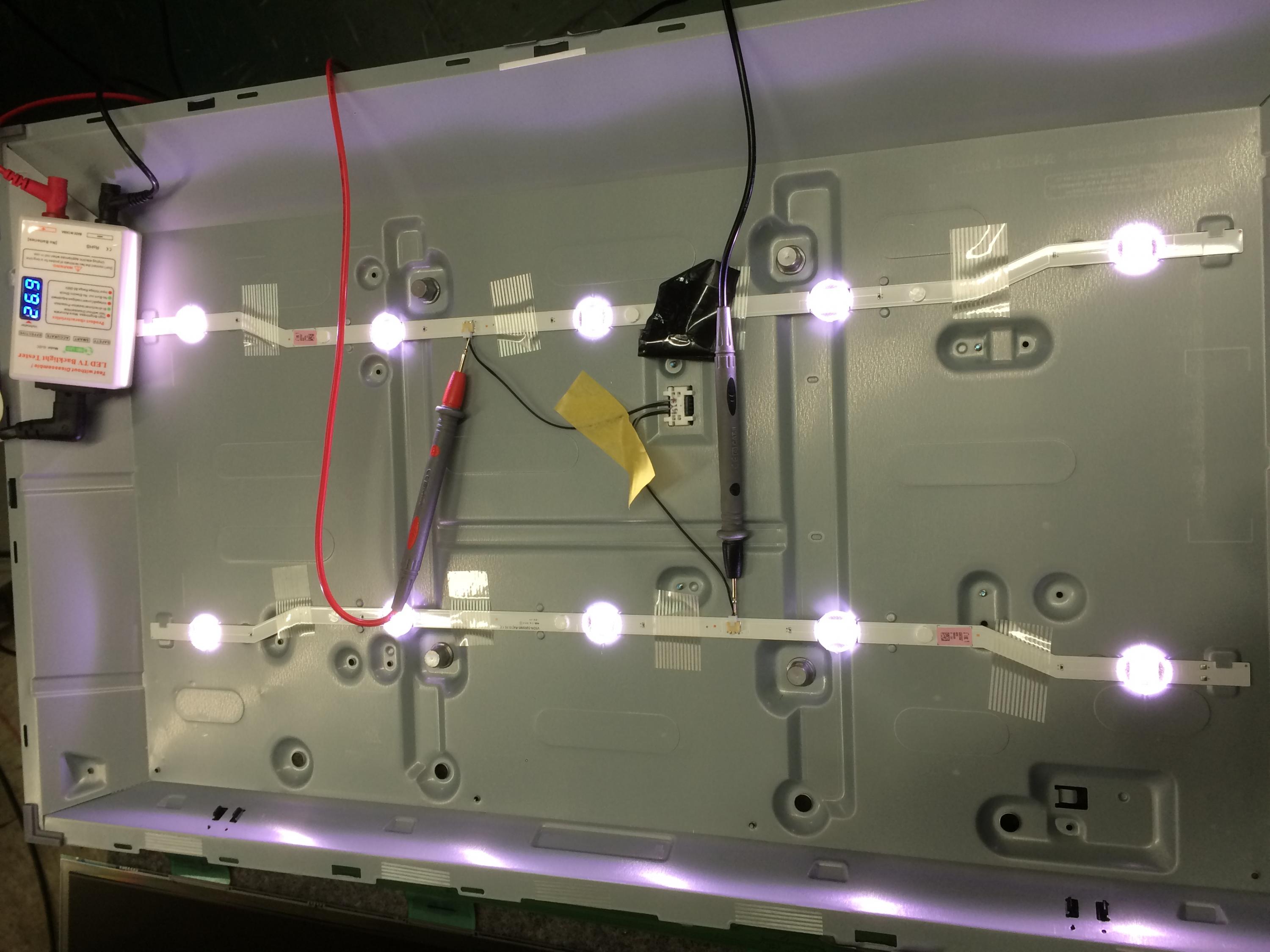

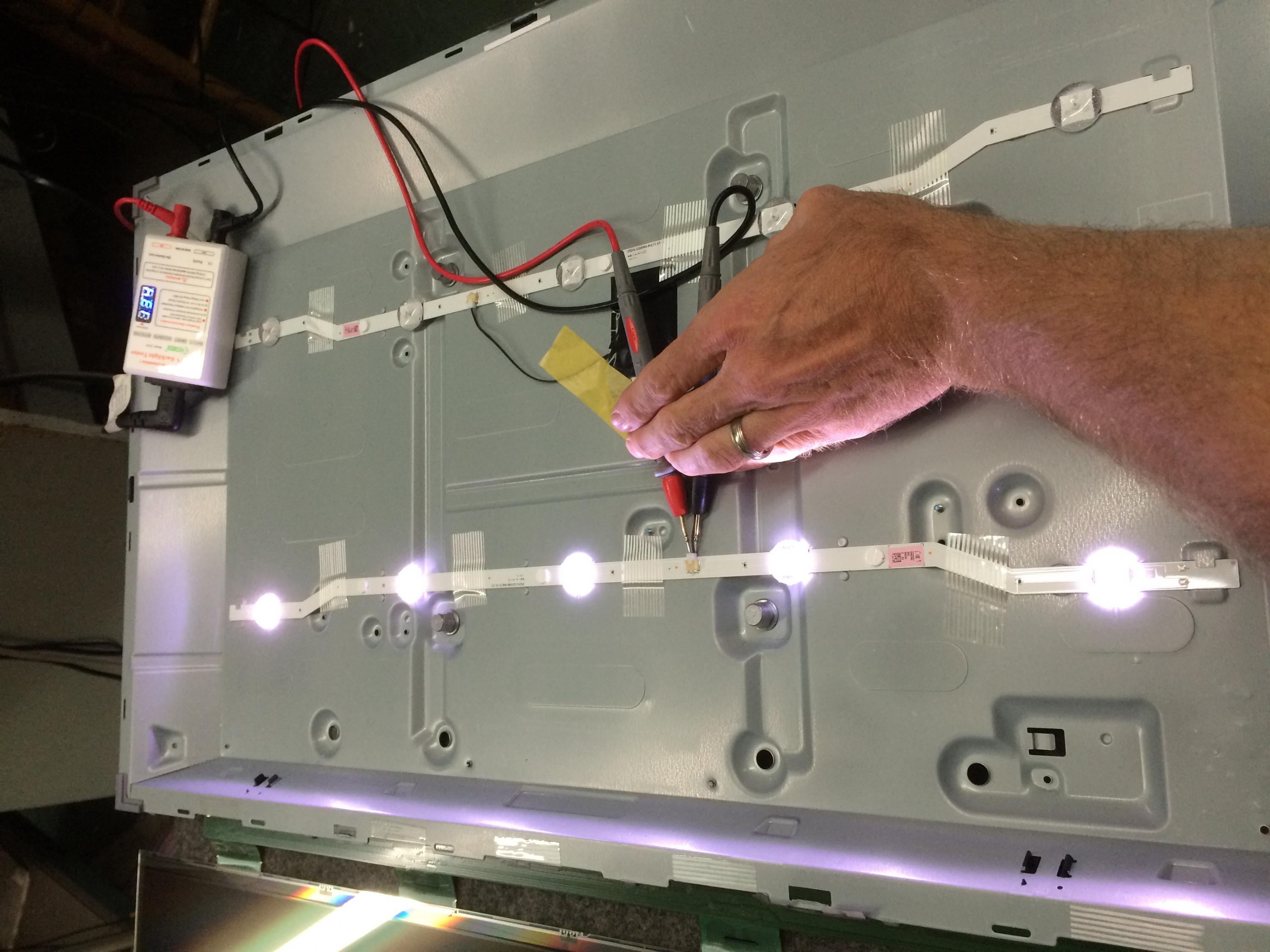

    On this model the led driver and the Main Board are combined into one board. I believe the Main is not producing proper voltage to the backlights, as I have taken the screen appart and drove the leds with a backlight tester. All the leds lit and drive at the same voltage. (13.5v)
    I have replaced the Main 3 times, as the first 2 were defective, from Shopjmmy. The 3rd one is giving the same voltages as the original board.
    The question is: What voltage should I be seeing at the backlights on the manin board? Am I wrong to assume there should be approx. 27v?

    I have measured the led voltages using the chassis ground as:
    Pin4: 14.3v
    Pin3: 3.4v
    Pin2: 3.4v
    Pin1: 3.9v
    Also measured accross pin1 to pin 4: 9.8v
    LEDs are in series. Top pin (pin4) of the led connector is the positive connection. Pins 3 and 2 are connectred and the bottom pin (pin1) is the negative side.
