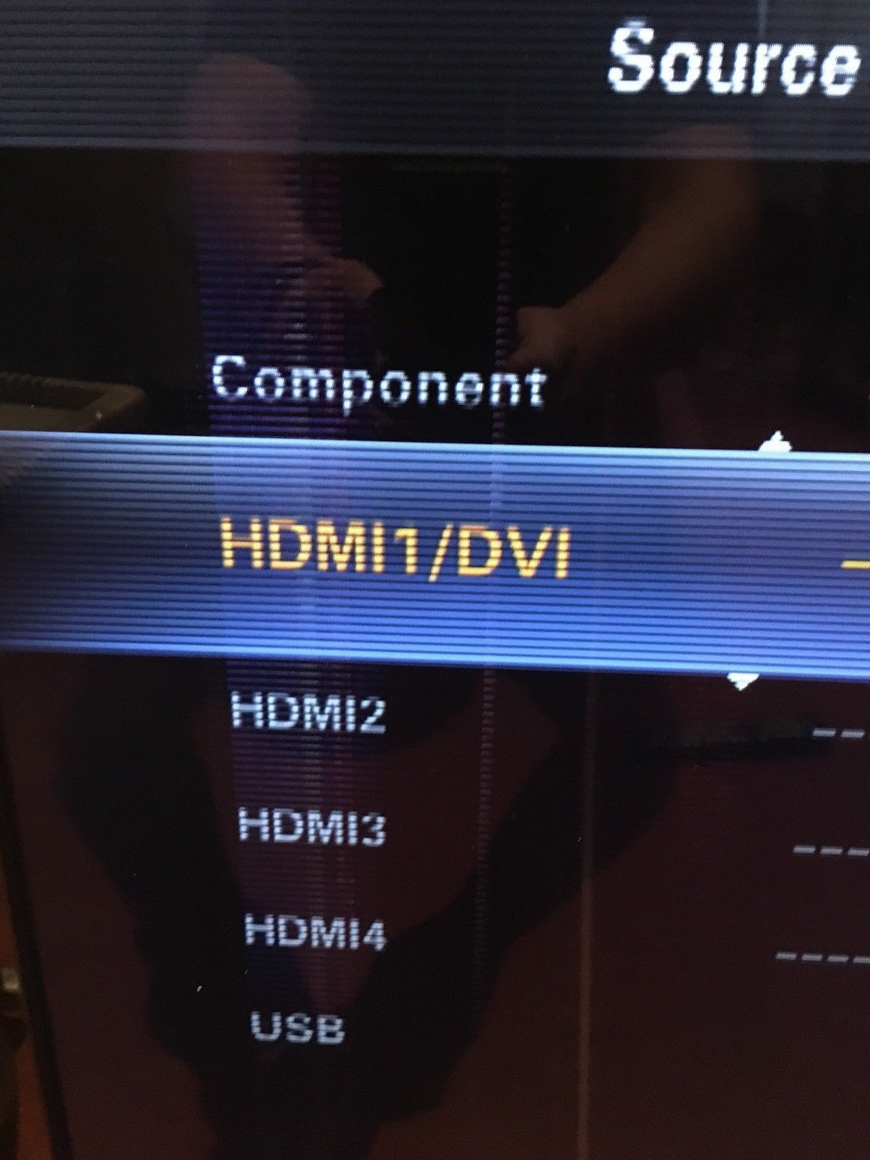

    Hi All
    Please could I ask a quick question on whether the stripes onscreen showing on menu items is fixable or worth trying to repair? I haven't acquired it yet, but if it's not an economic repair, I won't bother taking the project on! Hope this is OK?

    Re: Samsung LE40C750R2K horizontal lines
    check the flexcable from the T-Con to the LCD screen.
            Thank you for tips.
            i already same problem with my Sammy.
            i have already know origin of the problem .. LCD flex cable..
            if i press the pins on flex cable display goes right.
            is only solution replace it?
            cutting the top of flex may help me?
              Shipping of what?? the flex cable? You are meaning those attached to lcd glass? How do you go to change it?
                LOL if you were to change tab bond flex you would need a $5,000 tab bonding machine or make a homemade one. Also requires special strips and solutions consisting of acid.
                https://www.youtube.com/watch?v=ci4OFwtD1cE check this out.
                  did you cut ckv lines?
                        interesting video. Not sure if I had all that "capability", that I wouldn't use a "new strip" instead of trying to salvage the existing strip... I think that's what I saw. Kind of like replacing the lcd in a tablet but saving the existing digitizer screen for reuse. :-) Maybe they are harder to come by than the equipment.
                          LOL there are other videos on Y/T showing using new tabs. however despite using old crusty tab it did work.
                          However the vid was edited so hard saying if you watch the vid you can see he has 2 tabs the one he inspected under microscope and the other under the glass table and that one looked wrinkly and crusty.
                            The tabs you can order on aliexpress for cheap. Also the tape for bonding ( around $80 ). Only problem is to attach it to the panel in line.....
                            You need big machines for that i guess...
