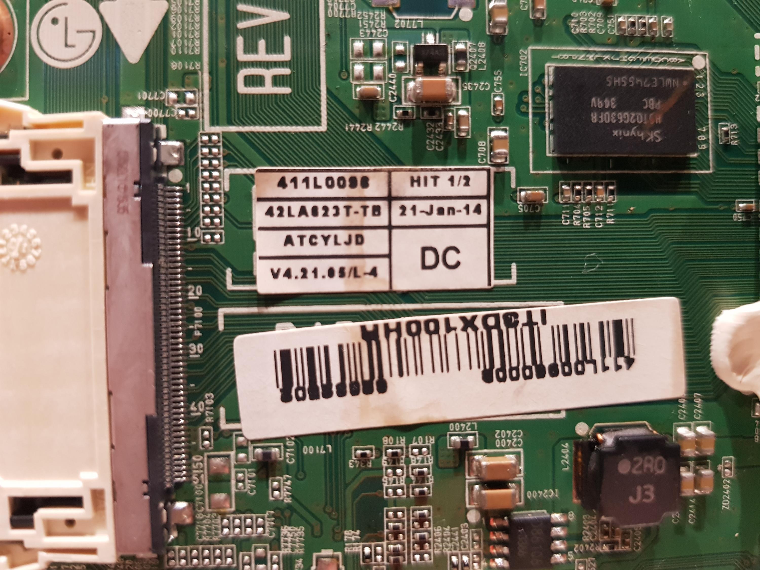

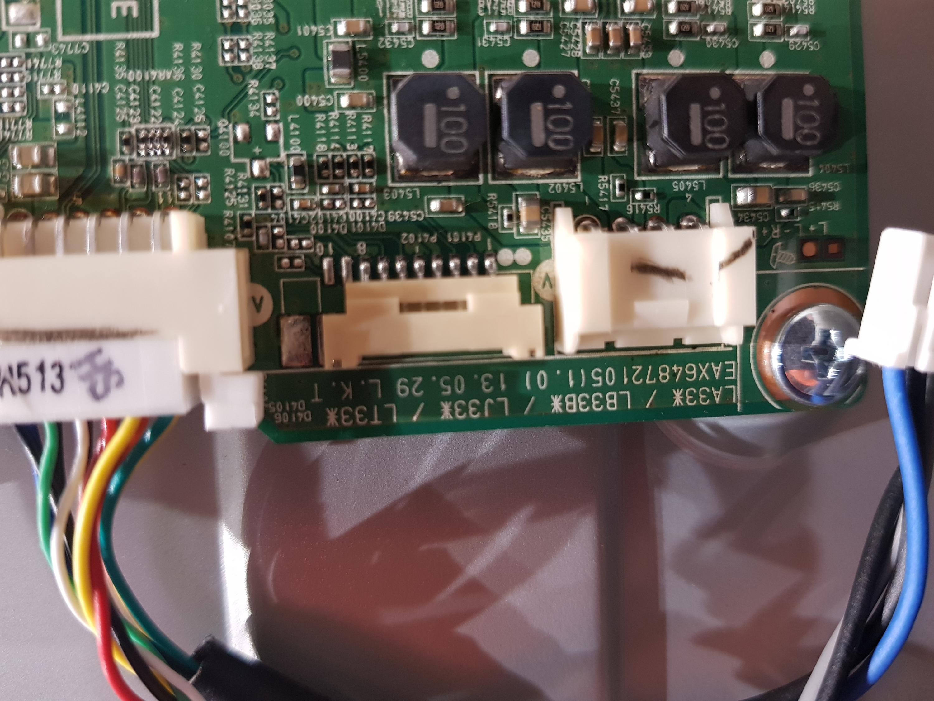

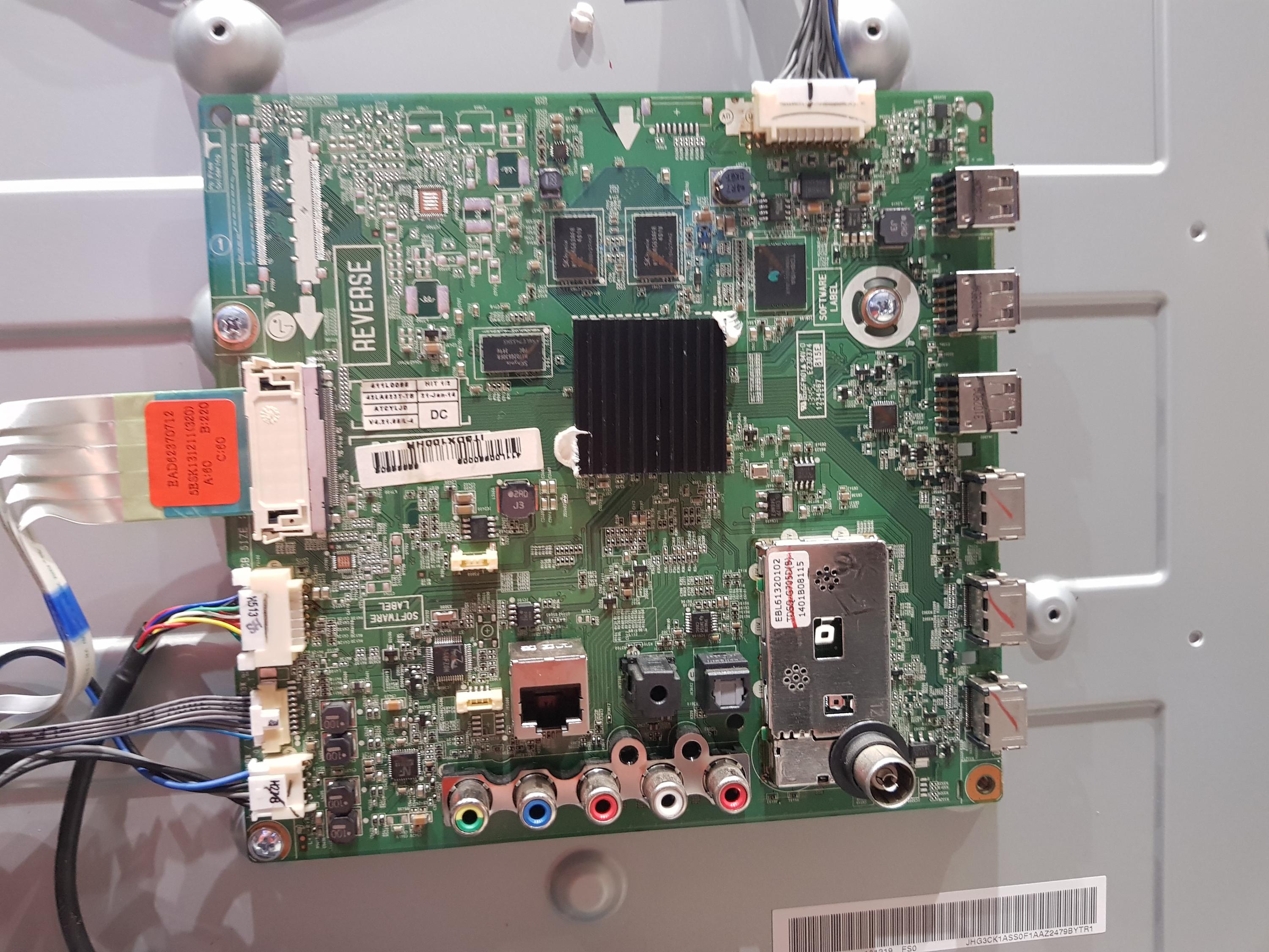

    Hi guys got given a LG Smart 3D TV model number 42LA623T which from which i have seen has been imported from Asia or Pacific part of the world so would not let me select UK or anywhere in europe to get our apps like iplayer and stv player etc so apps where limited. i had a play around with it and software was very glitchy and slow and freezing apps so i updated software but problem got worse as i opened netflix and tv restarted after a few minutes and was stuck on LG logo for over an hour. tried all the usual stuff like unplugging for an hour. i done a reflow on mainboard and tv went back on and worked no problem for an hour or so then got picture issues going black and white etc so now assuming its mainboard. to get to the point i have 2 questions.
    1: if i import same board eax64872105 can i reprogram the region using service menu etc
    2: is there another tv with similar board that would fit in this tv with UK firmware.
    i have tested another LG board from a LED tv and was working spot on but cannot get back on tv as all the ports are in the wrong place.
    any help appreciated.

    Re: help with imported faulty LG LED TV.
    pictures of mainboard
      ok guys got into EZ-adjust menu and In-start menu and adjusted the settings to EU. i copied country group etc from another LG smart tv and can now get all the UK settings and apps.. i used an old Samsung Galaxy S4 to get into the menus.
