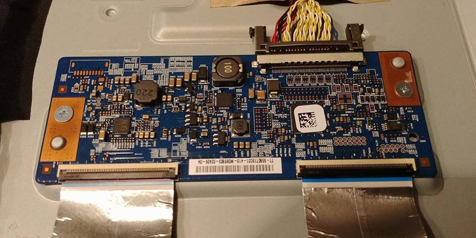

    I have ordered a new T-Con and replaced it. Same issue.
    The fuse F1 on both T-Con are ok.
    I have 12 V after F1.
    When I unplug either 2 of the ribbon cable or the T-Con main connector while the TV is on, it doesn't change anything. Doesn't flicker or anything.

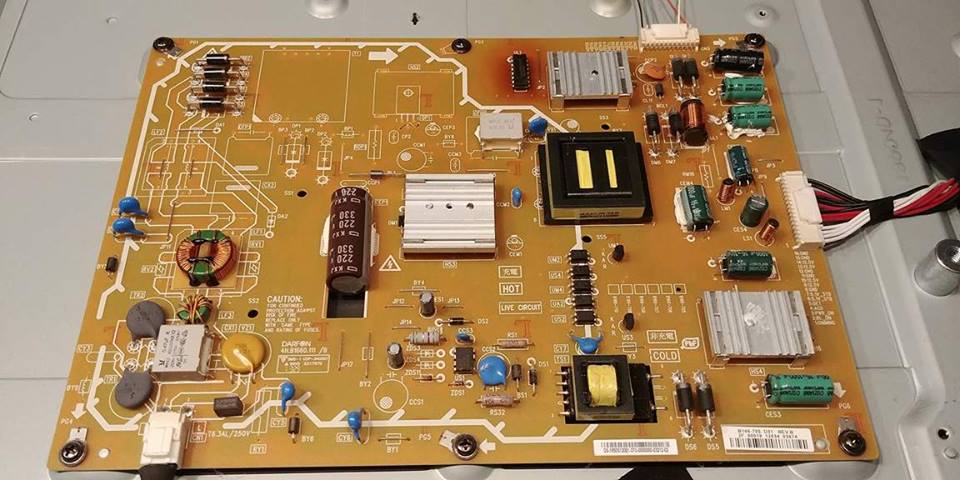

    The chip UL1 on the main power board is really hot to the touch. And the board is a bit darker around the chip than the rest.
    No Capacitors looks burnt or damaged.

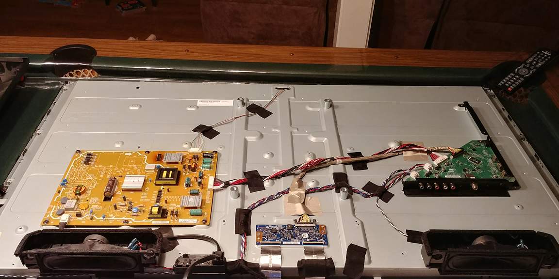

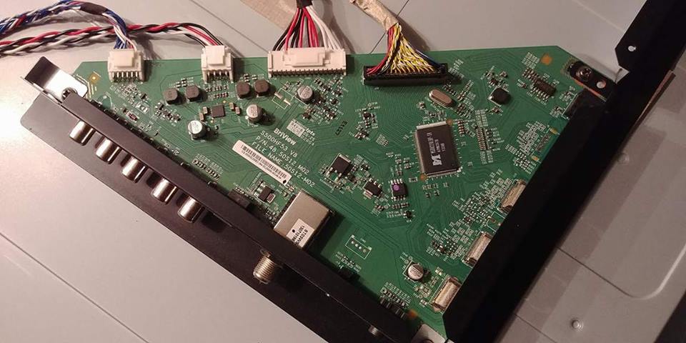

      Re: Insignia NS-50D40SNA14
      Here the picture of the full layout.
      Yes T-Con in bottom middle
      When I plug only the right ribbon, half right of the image is displayed correctly.
      When I plug only the left ribbon, no image.
      If I plug the right ribbon, on the left LCD, no image.
      If I plug the left ribbon, on the right LCD, no image.
      Plug back the right ribbon on the right LCD, half right image again.
      I can do that right since both ribbon have the same P/N ?

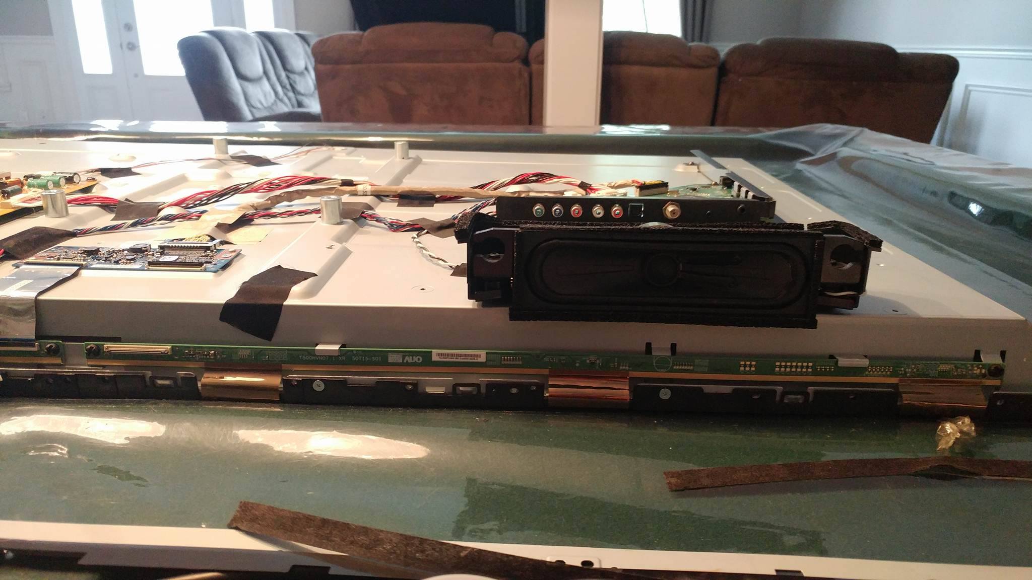

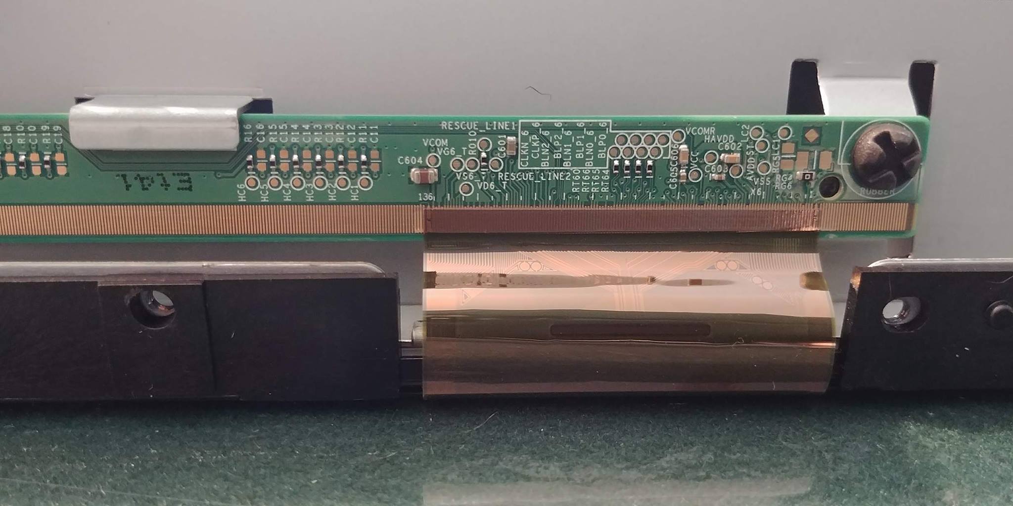

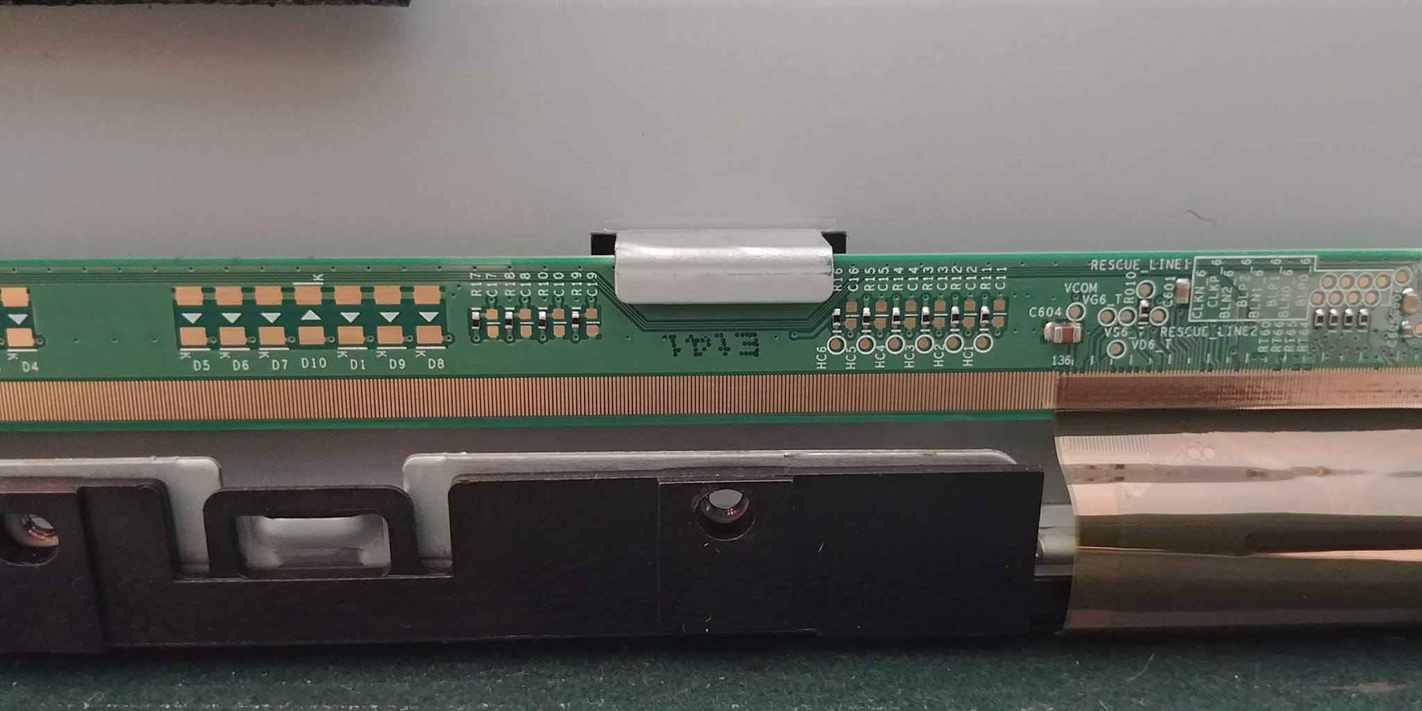

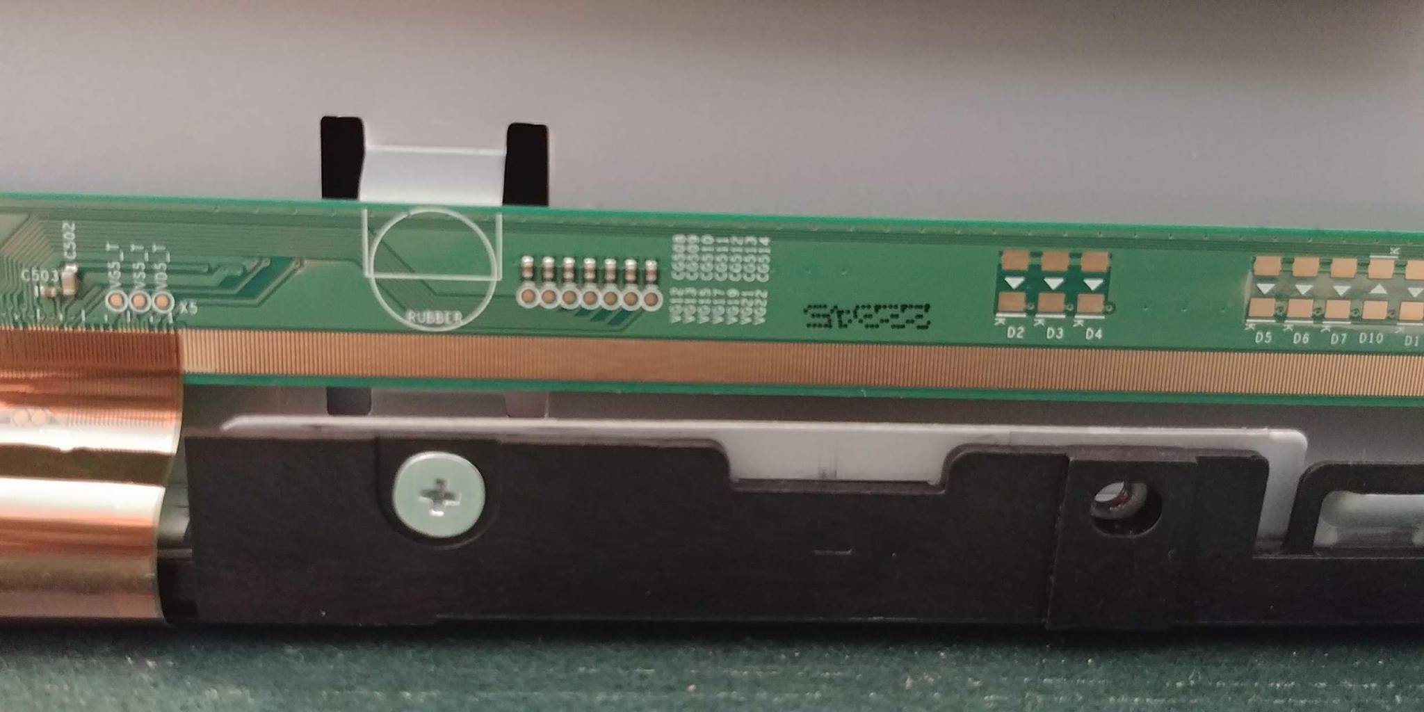

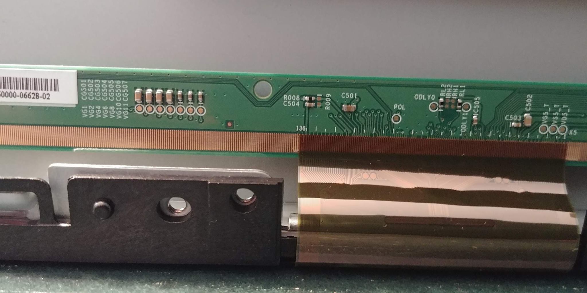

            • Helisstra
              • Sep 2017
              • 10

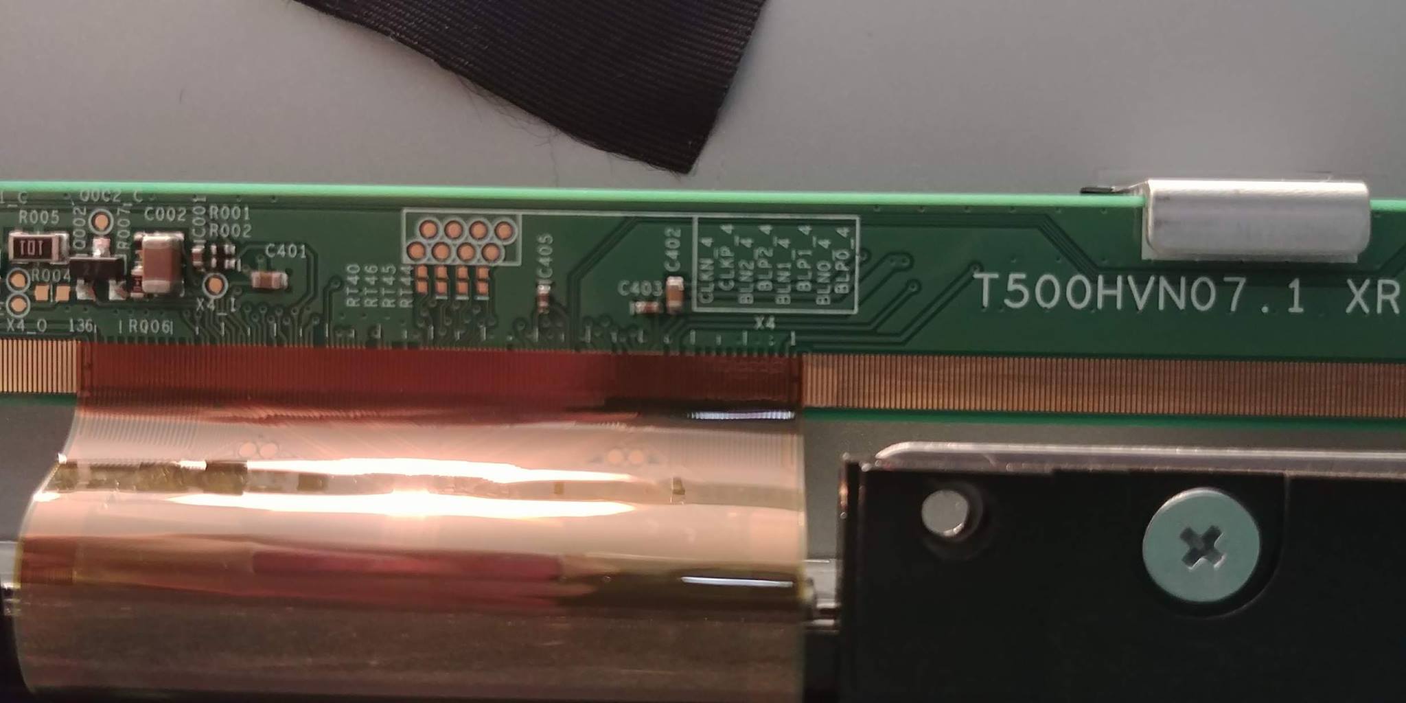

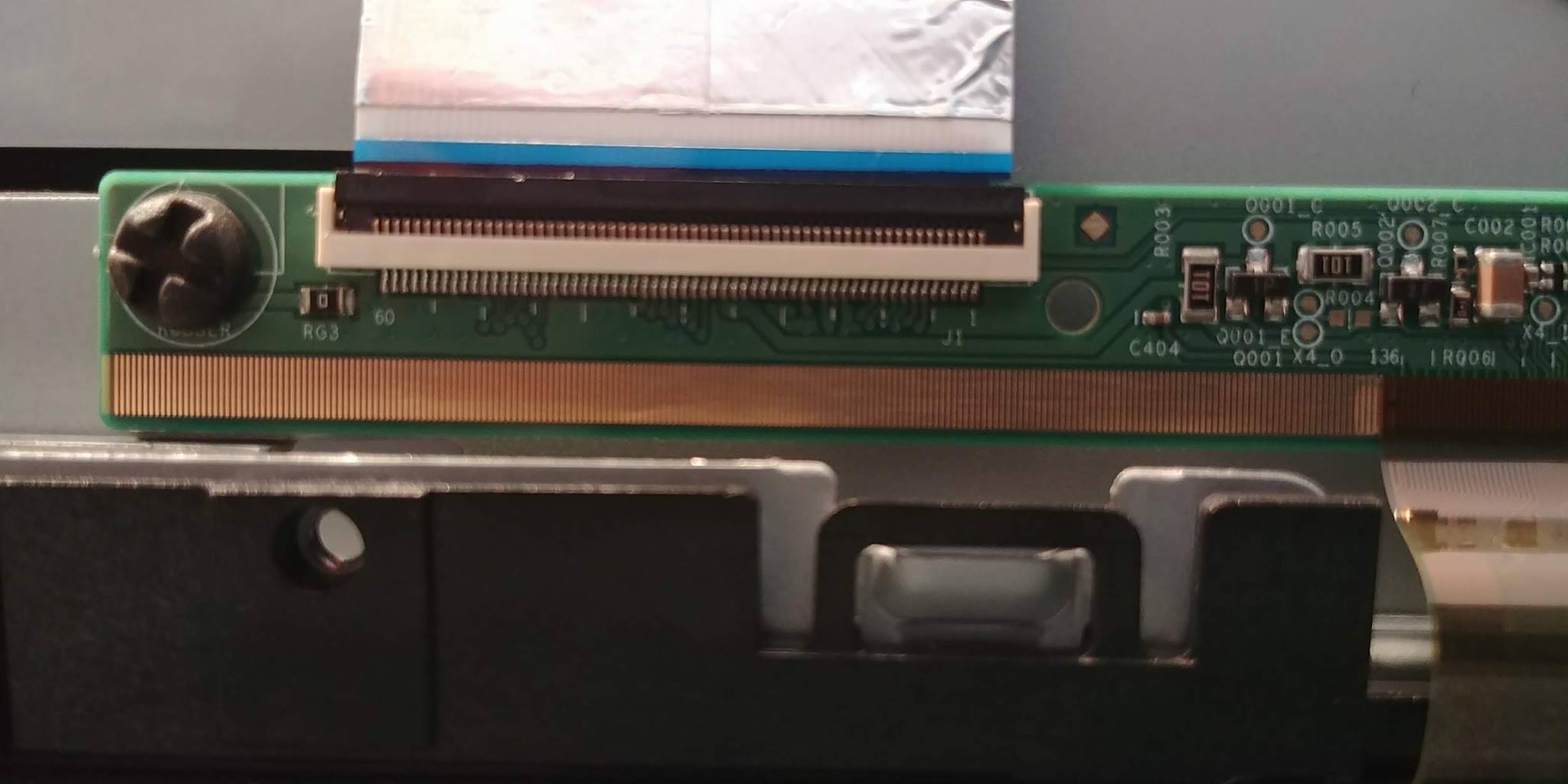

              I have removed the frame, I don't see anything suspicious on the board. Linked picture
              Is there a chance of repair at this point or it's dead since it's the LCD Panel ?
              The bonding board is not replacable due to the soldered ribbon ?
                There are many caps on that tab bonding board, you should check to see if any of them show low (100 Ohms or less) resistance when measured between the two legs of each caps.
