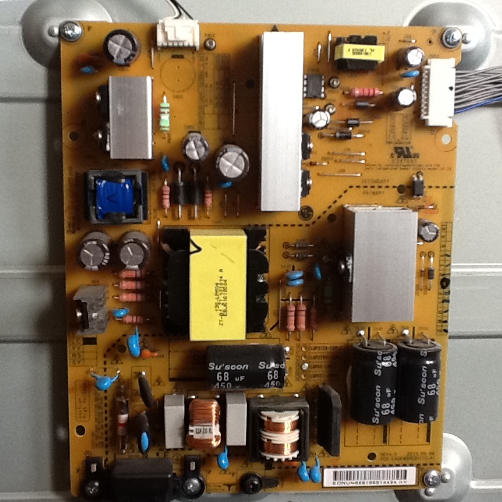

    Hi guys, got an lg here with the usual faint picture, got 105v on the negative of the led plug, and 215 to 230v varying on the led plus side of the led connector. Any thoughts or does it sound the the screen?

      Feint as in dark, or feint as in the pictures are washed out.
      A picture of the screen would be helpful.

        When I say faint what I mean is black until you shine a torch on it and you can see the picture there

          So you have an open LED. But I'm sure you already knew that.

            Well I had an inkling, but I'm allways ready to listen in case someone has had anything different
