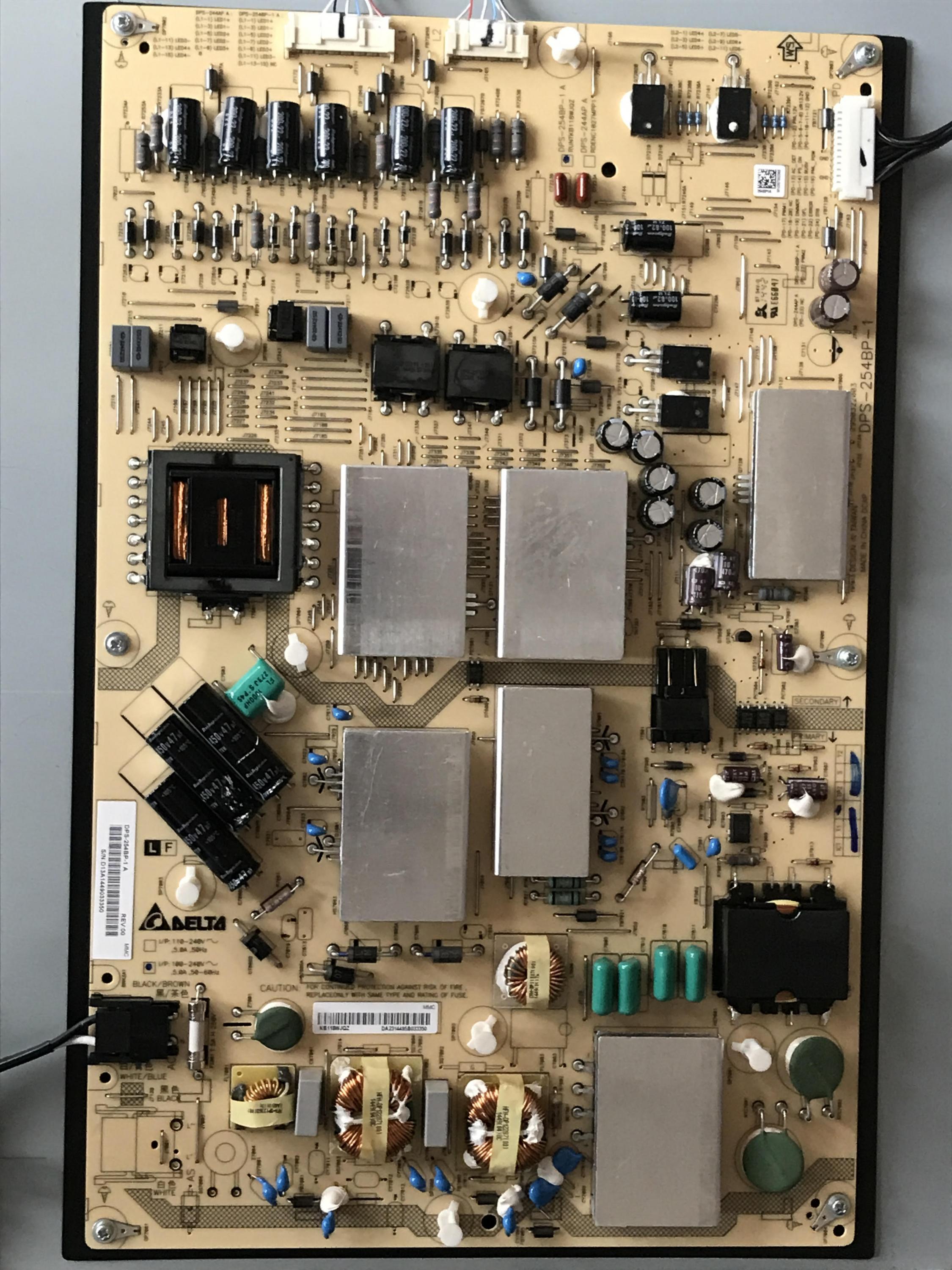

    If you restarted the TV the problem would go away. Around a week after it first started, however, the TV shut off while we were watching it and it won't turn back on. The front light blinks in the same pattern repeatedly -- three long blinks, pause, one short blink. Based on some research I did it sounded like it might be the power supply board, so I tried replacing it but it didn't work, still have the same blinking pattern. Then I thought the replacement part I had been shipped may have been defective, so I ordered another new one and it didn't work either.

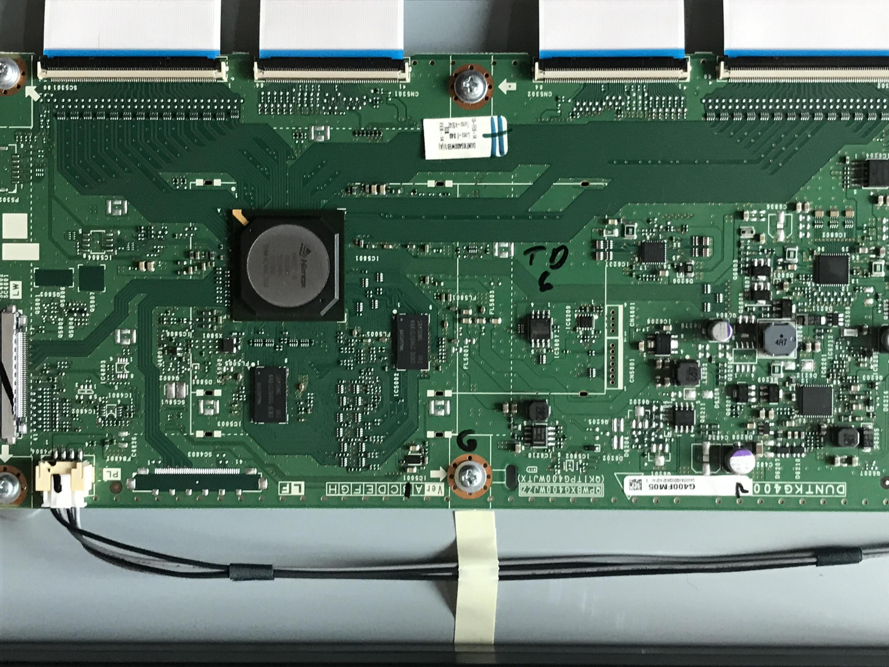

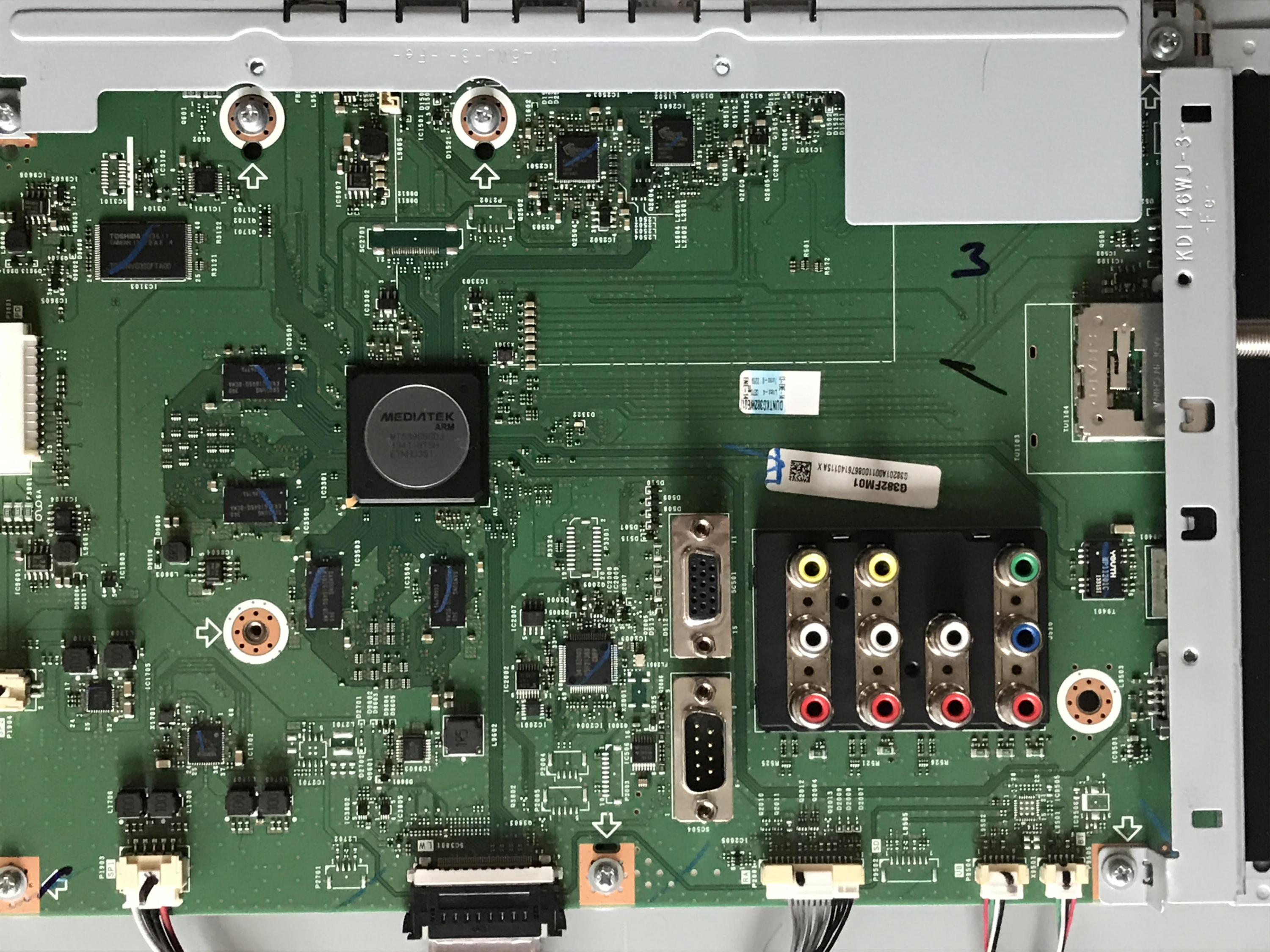

    Here are the various boards in the TV

      A communication error on a Sharp set in most cases would indicate a main board fault. That is the first board in those pictures, the one with A/V inputs.
        Re: Sharp LC70UQ17U won't power on - 3 long blinks, one short
        Thanks for the reply. So in your experience, if I replace the main board it should fix my problems?
          I have only fixed one before in another Sharp set, and it is possible there are other faults, but for a big 70" set I would have thought it is worth taking the chance. I have not looked up the cost of a main board, but you can usually find them for less than $100.
          I would say about 80% chance it is the main board at fault.

              Well, unfortunately that didn't work... swapped out the main board today, plugged in, hit power and after around a minute the front light started blinking the same pattern as before. Is there any factory reset/ firmware I would need to update in order to get around this error code?

                I guess there's a chance it's the T-con - 3rd picture in your first post - but I wouldn't think that as being very likely.
                You could try a second main board (consider an exchange with seller?), or a T-con, up to you, but I do not know, sorry.
                  you can also try unplugging one cable going from tcon to panel and see what the result is. Repeat the test doing the same with other cable. Some form of stable picture may result (half that is still plugged in). Go from there. Ensure your cabling between boards is well connected / clean contacts.
