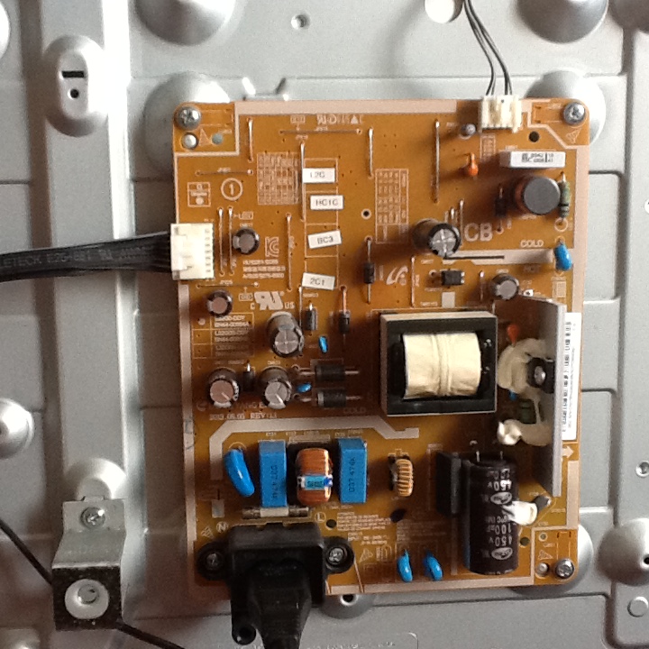

    Hi guys, got a faint picture on this Samsung, got 180v on pin 1 of the backlight connector and nothing on the other 4. Should there be?

    Power supply pic

        Does the board say led voltage 112V @ 260mA which would suggest that 180V is the open circuit voltage and the led strip is probably open circuit. Either a bad led(s) or bad led strip connection.

          Hi Andrew, without the main board attached there's no picture at all, not even a dark one. Hi Dick, on the pcb it says 65v 450ma. So if the voltage is high is that suggesting the led's are open circuit not bringing the voltage down?

                I probably didn't say it right....You WILL NOT get a picture with the cable from PSU to Main Bd disconnected....I wanted you to look for the backlights through the holes at the back of the panel.......You do however have bad backlights though from what I read......Can you strip the panel down to reveal the LED backlight strips??
