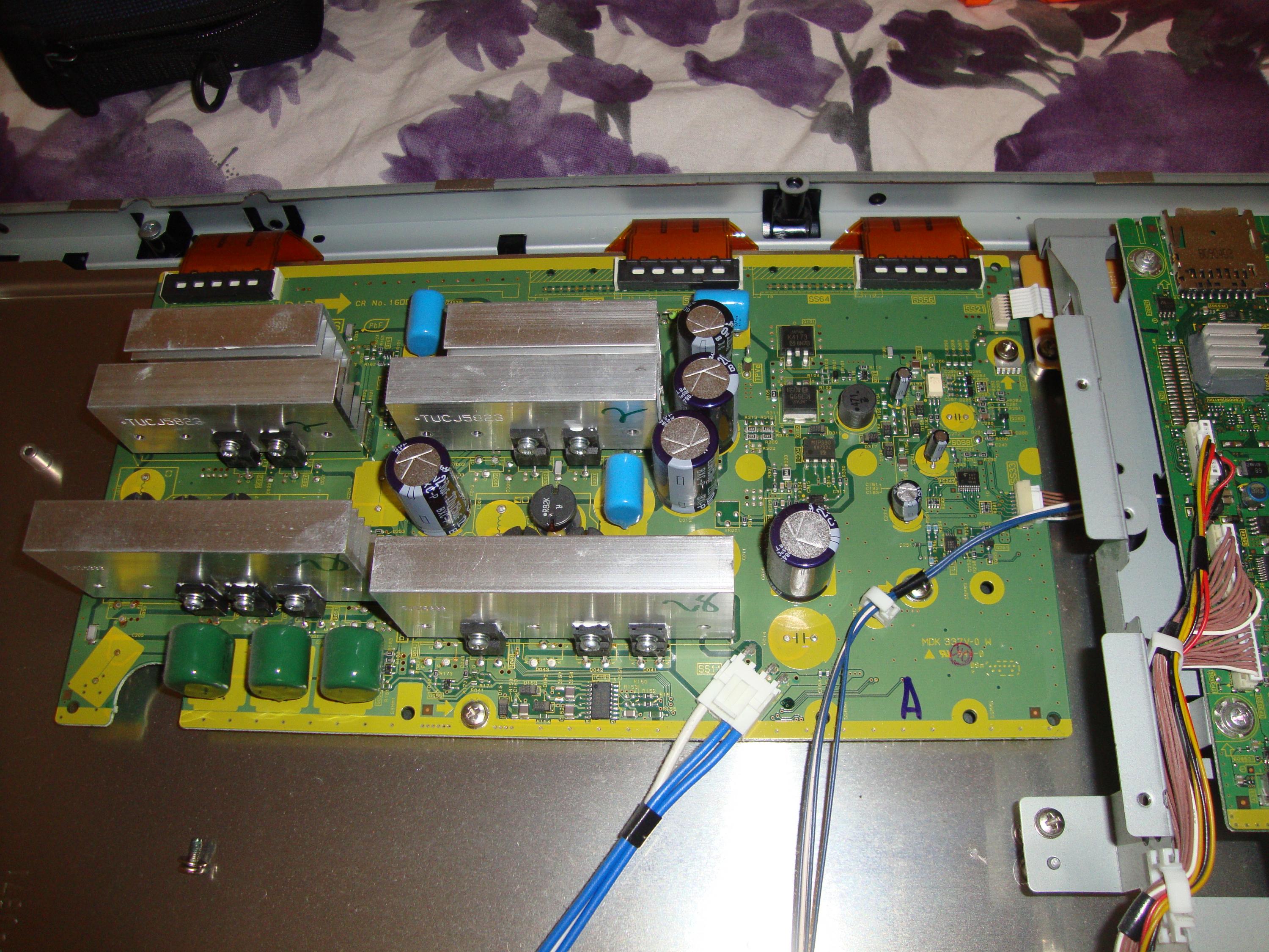

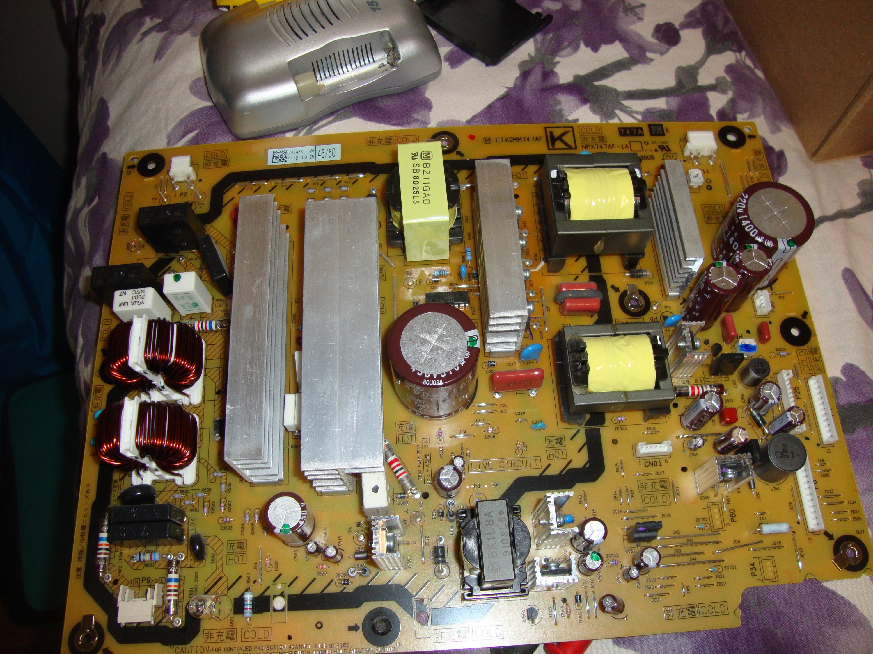

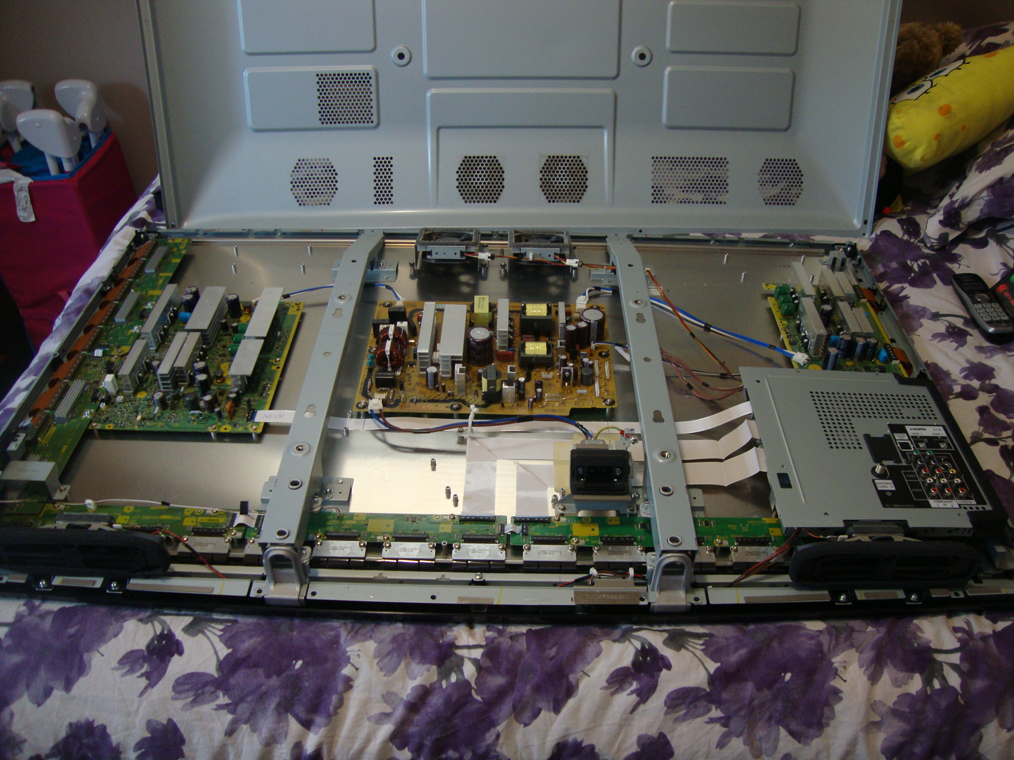

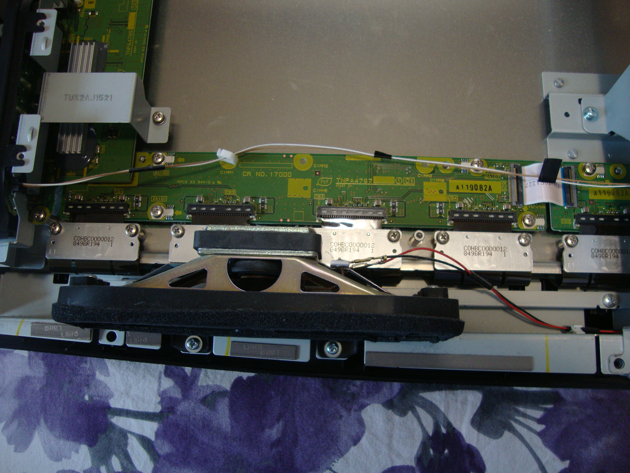

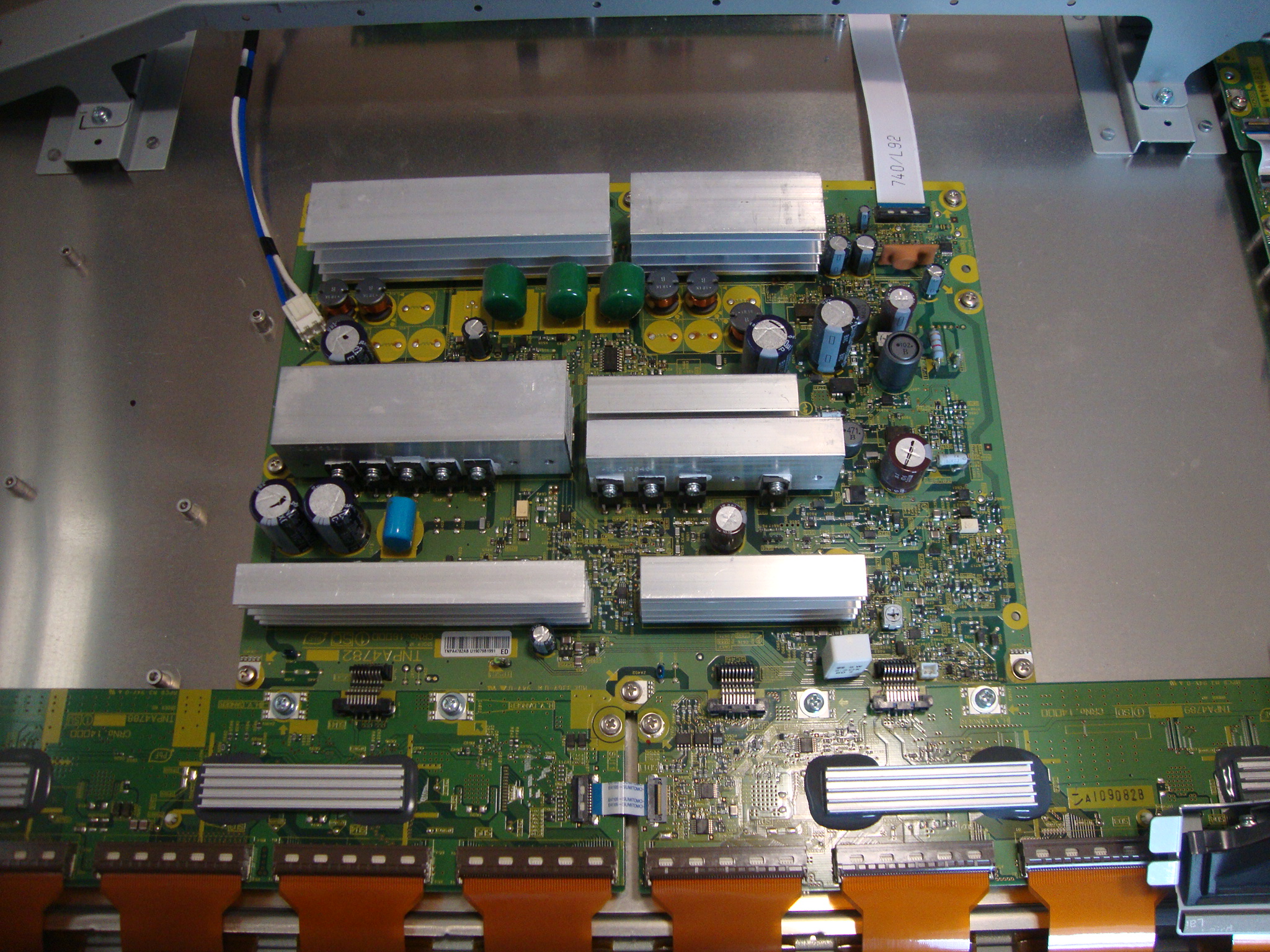

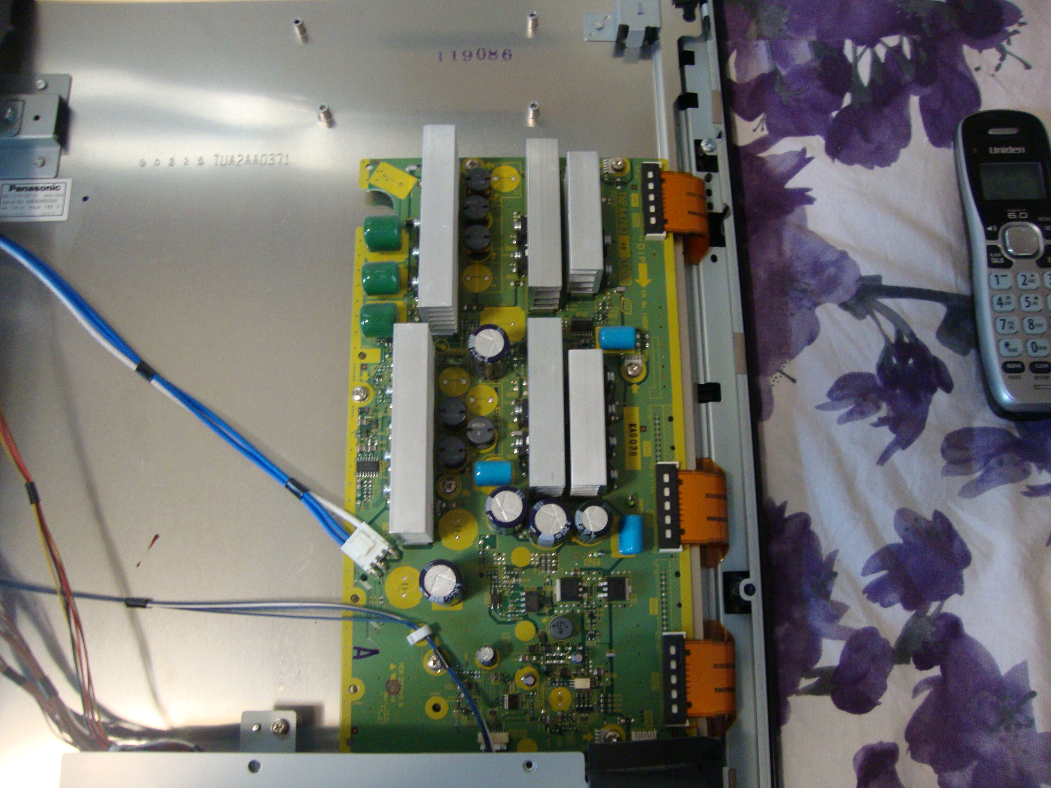

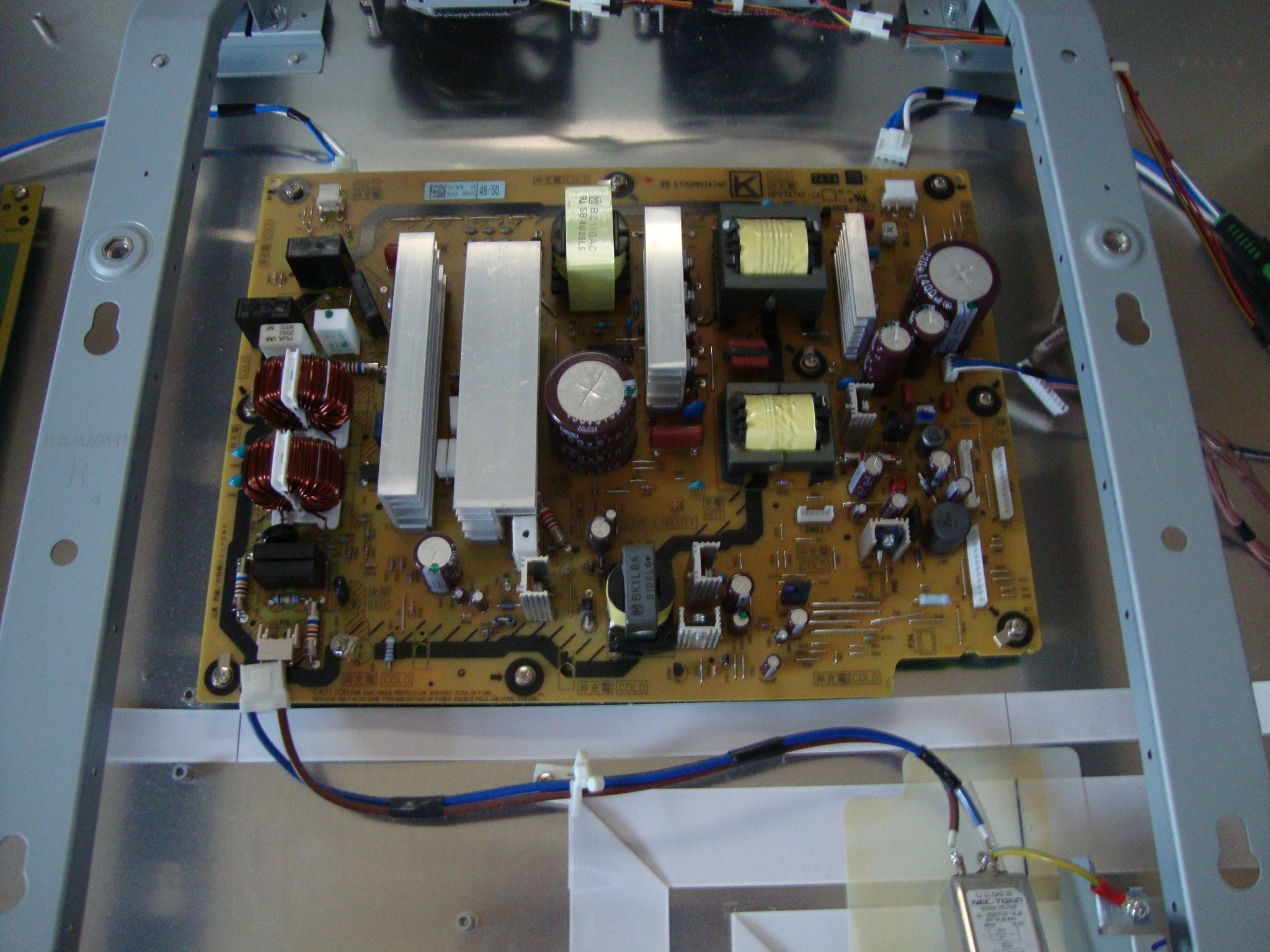

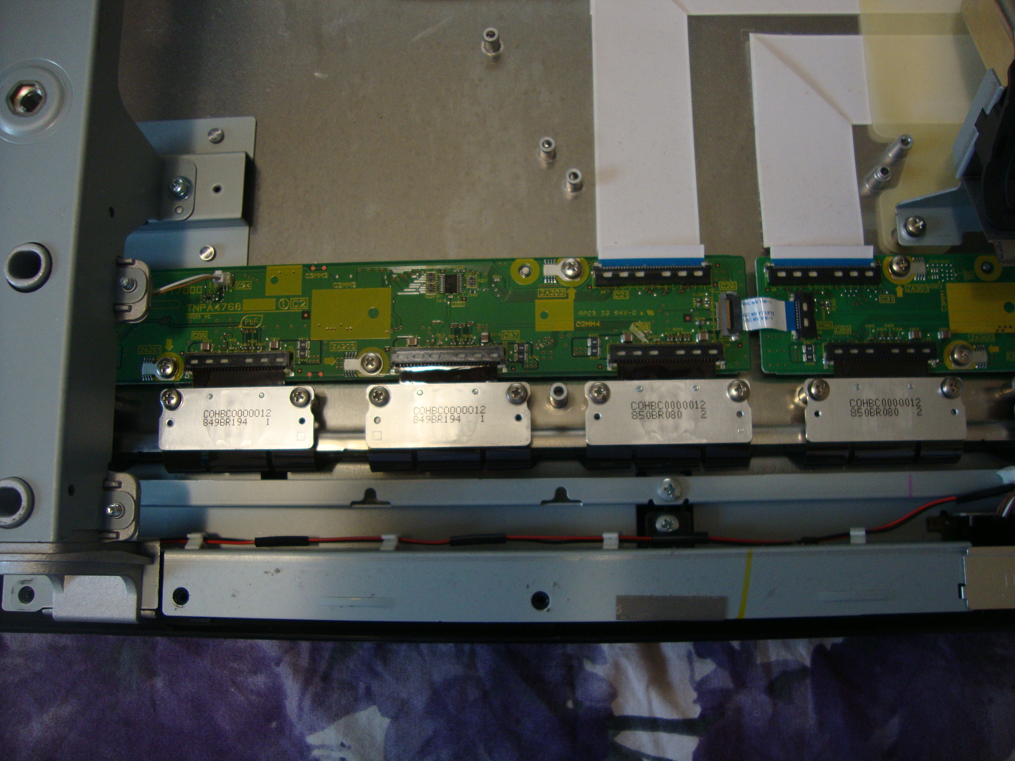

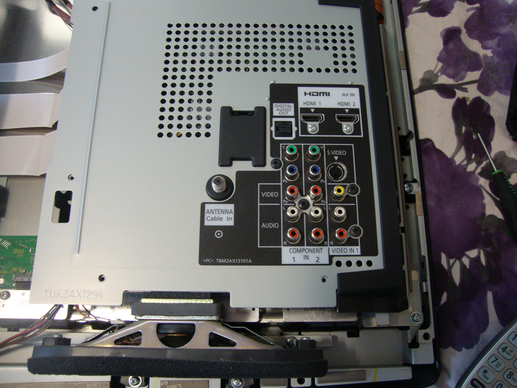

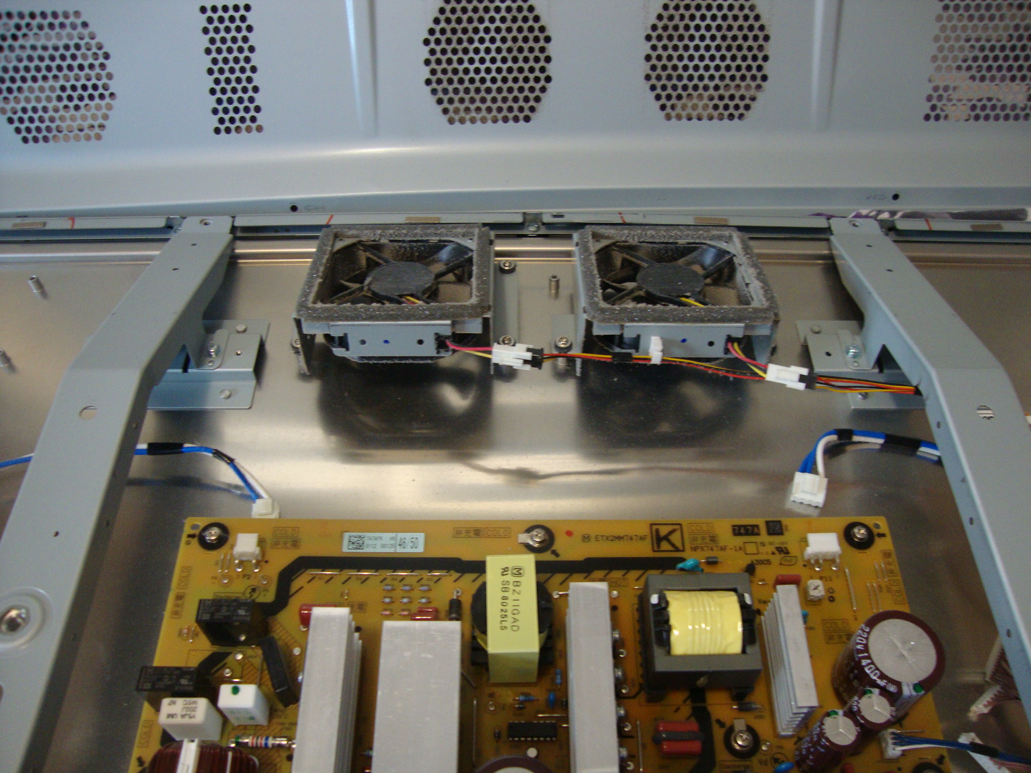

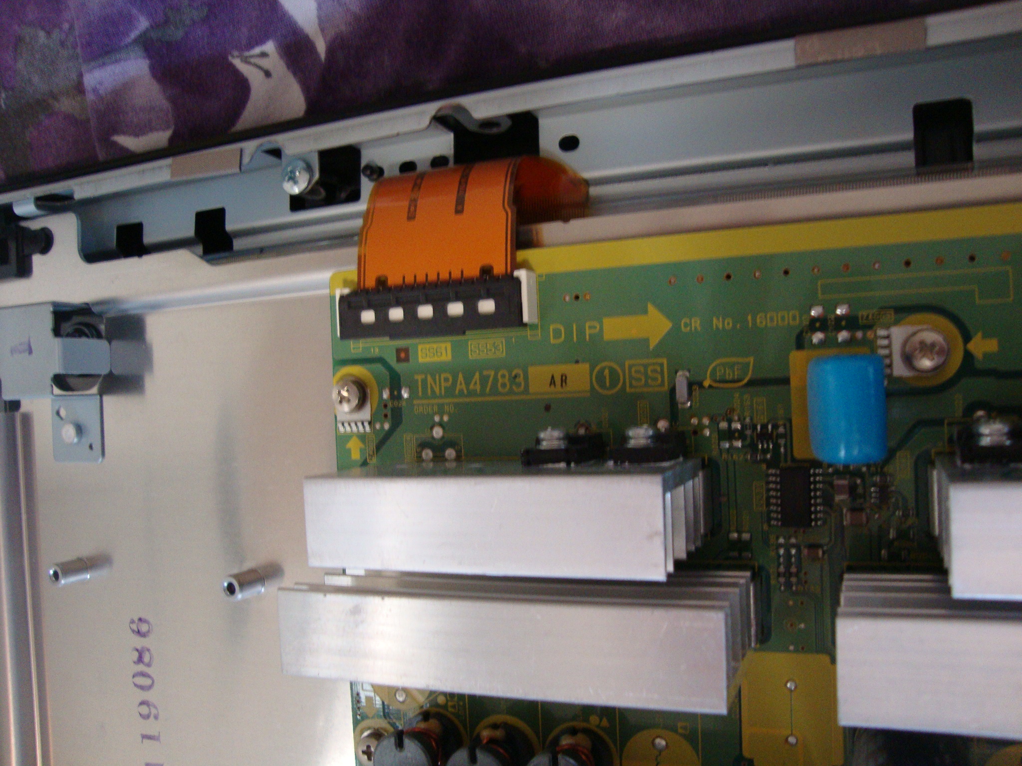

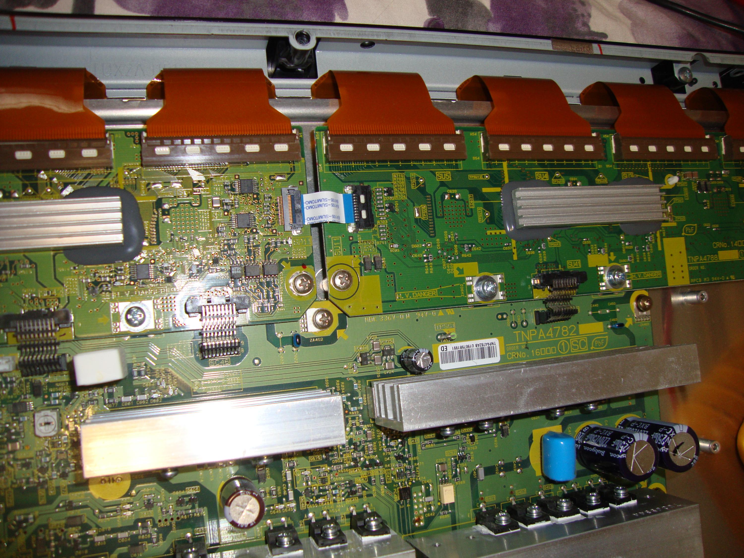

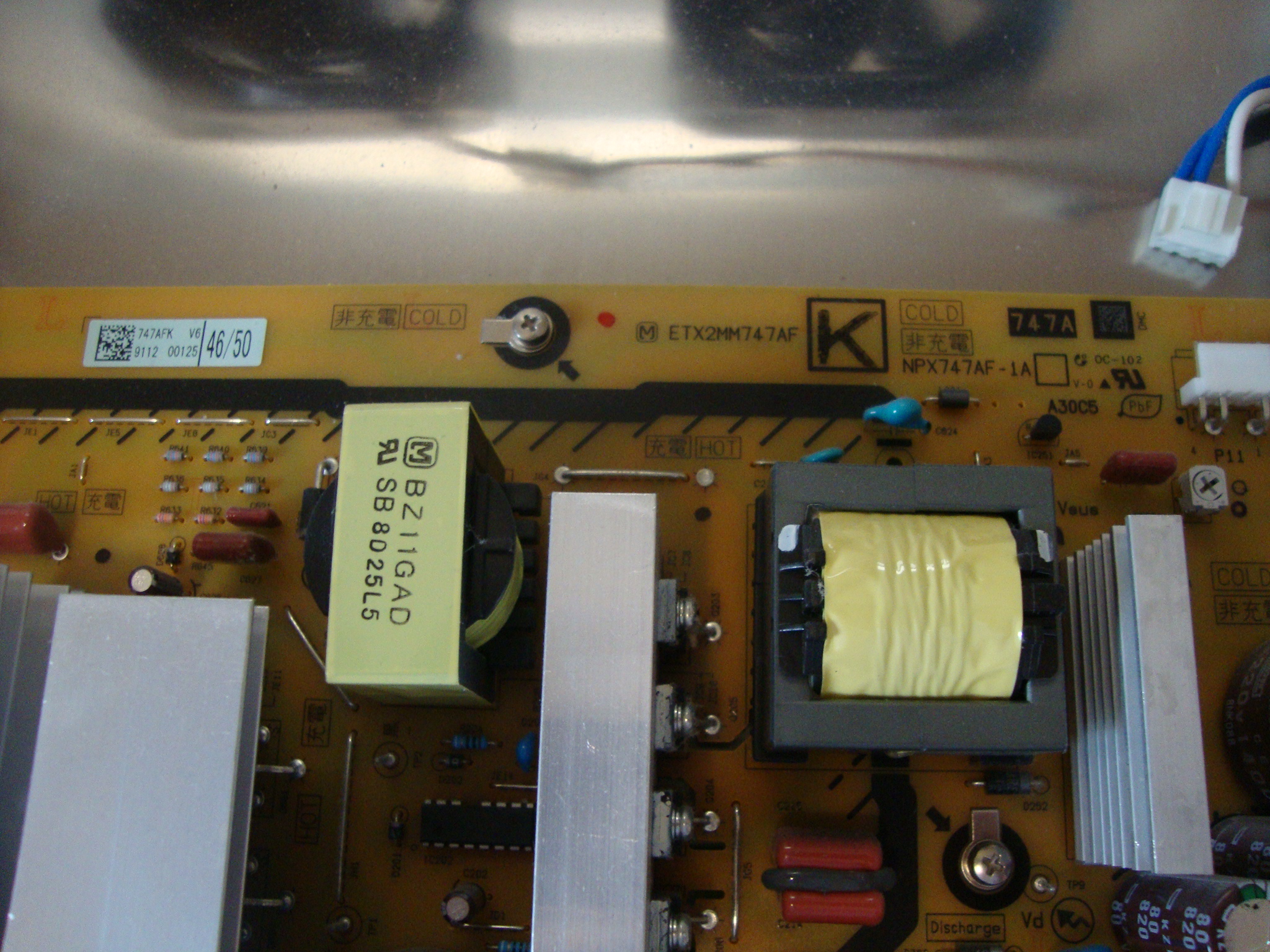

    I have a Panasonic TC-P50S1 with 10 blinks SOS. I have attached pictures and some of the board part numbers are:
    P Board = ETX2MM747AFK
    SS = TNPA478
    SU = TNPA4782
    Am I lucky enough that the P-Board is subject to the thermal fuse failure? Here is to hoping I don't have to get into the SS board.

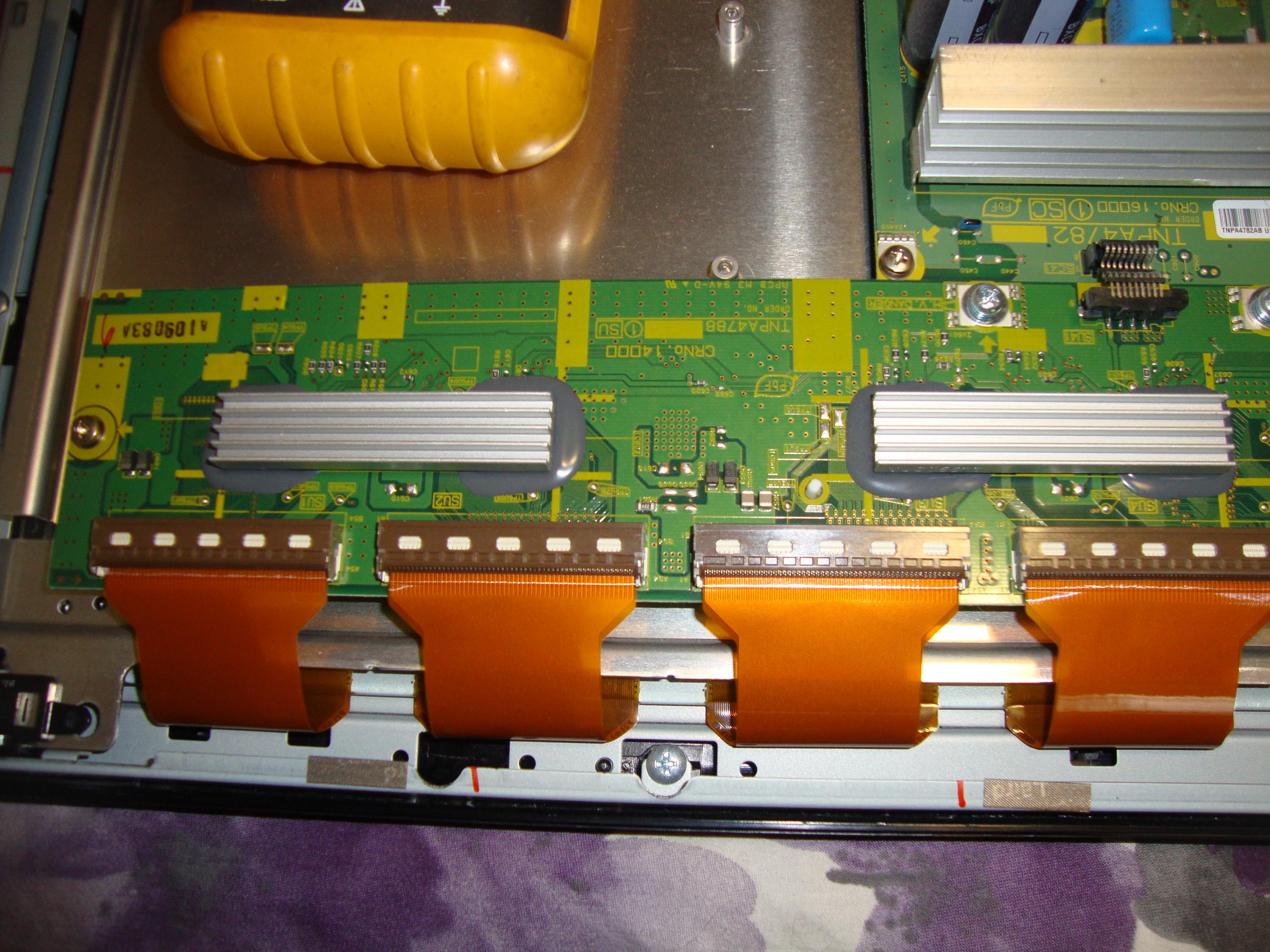

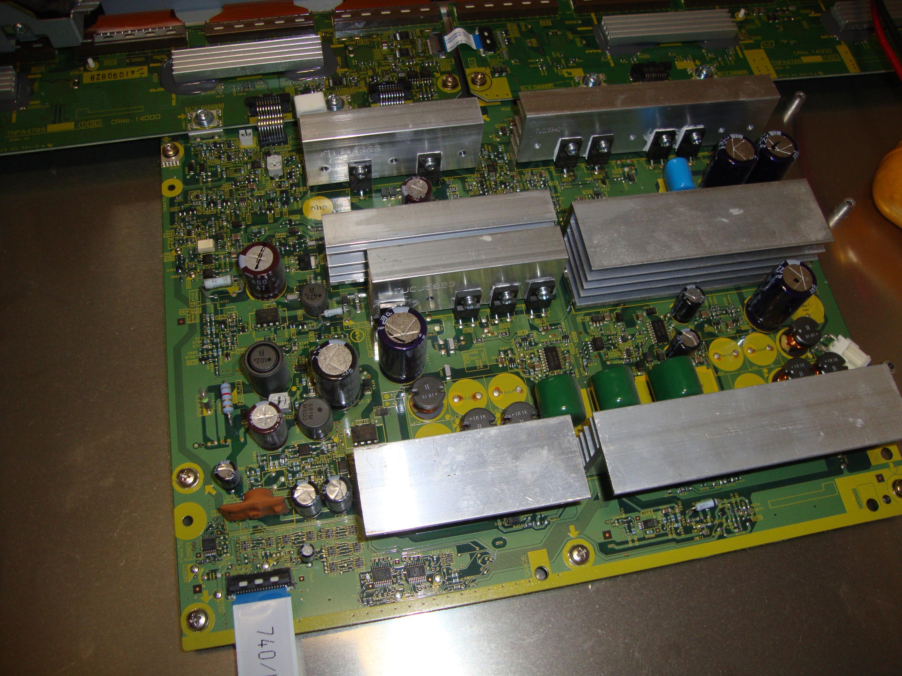

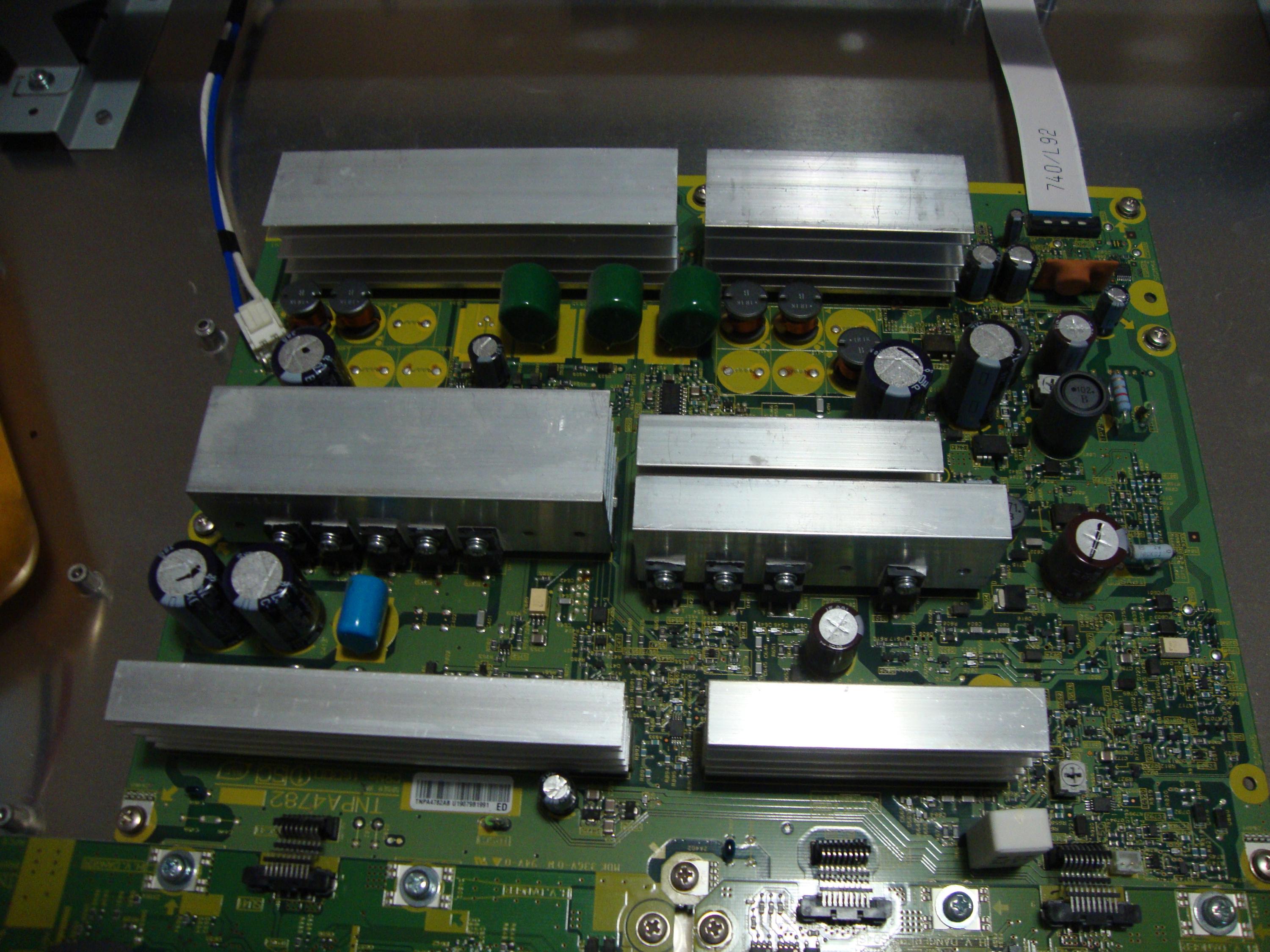

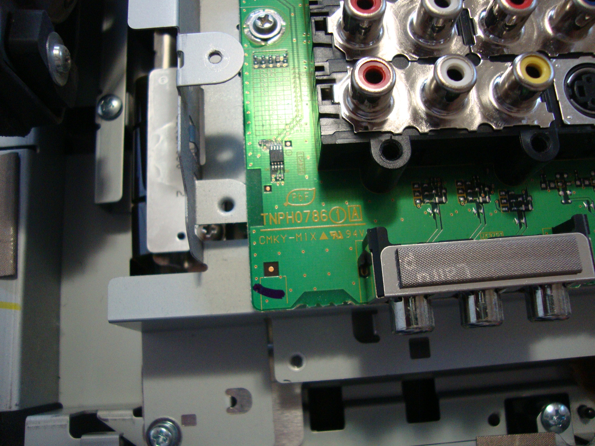

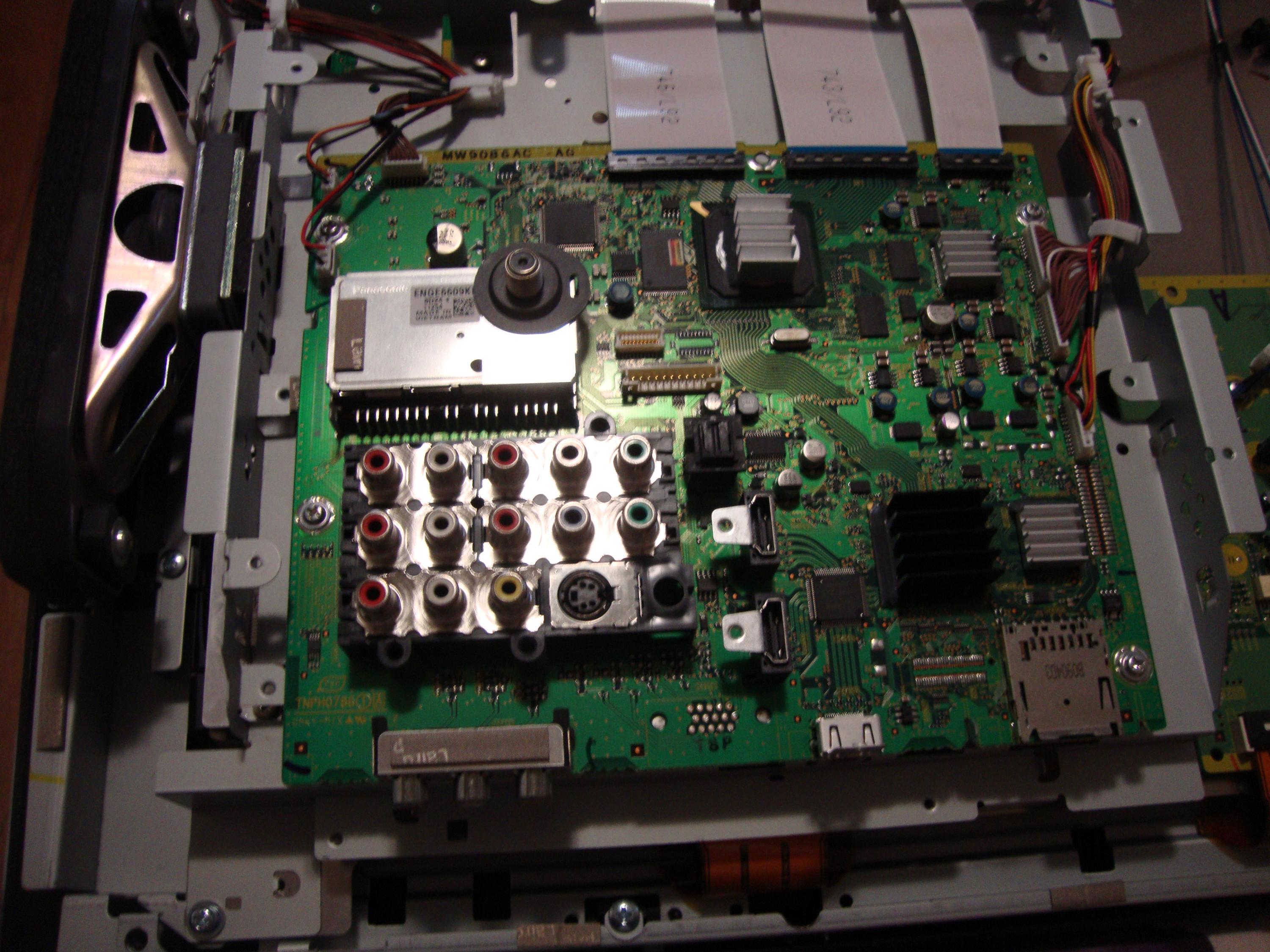

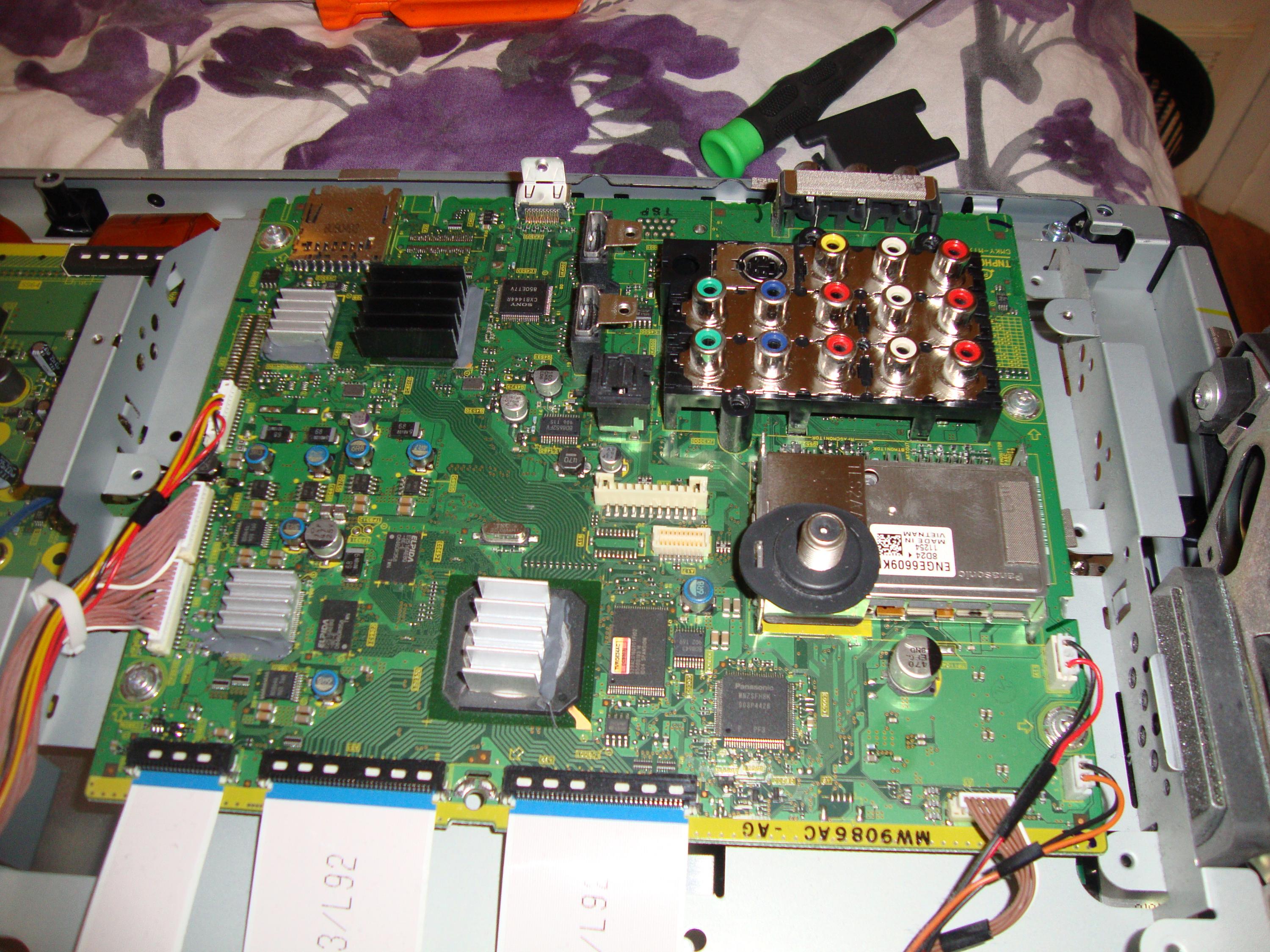

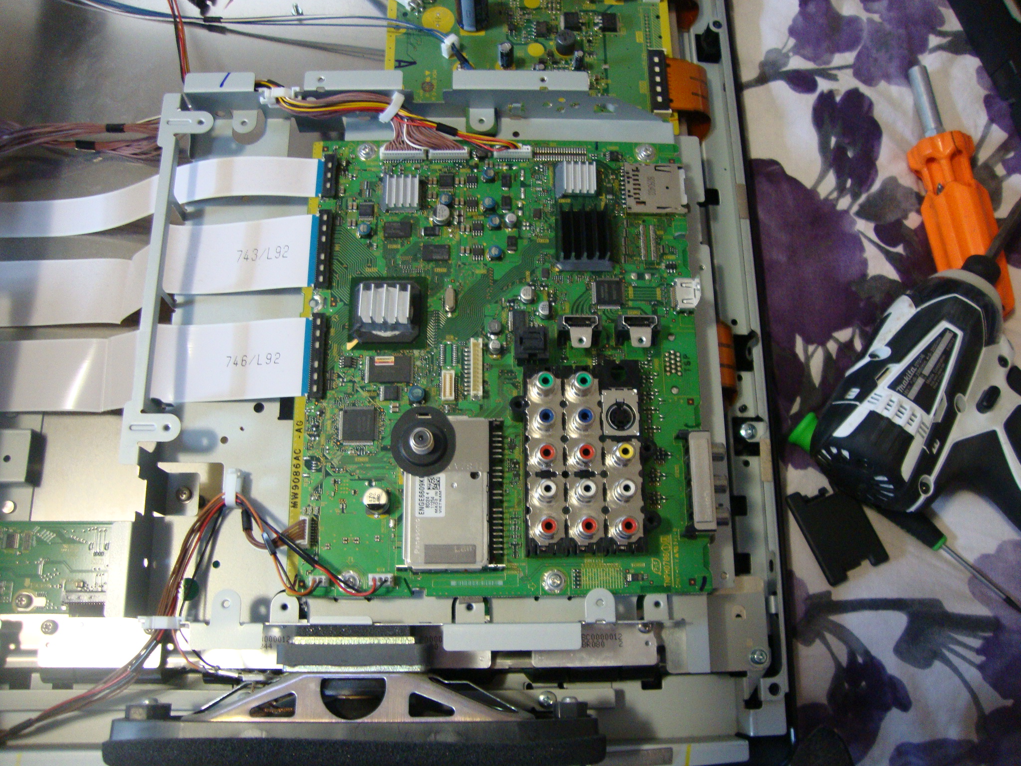

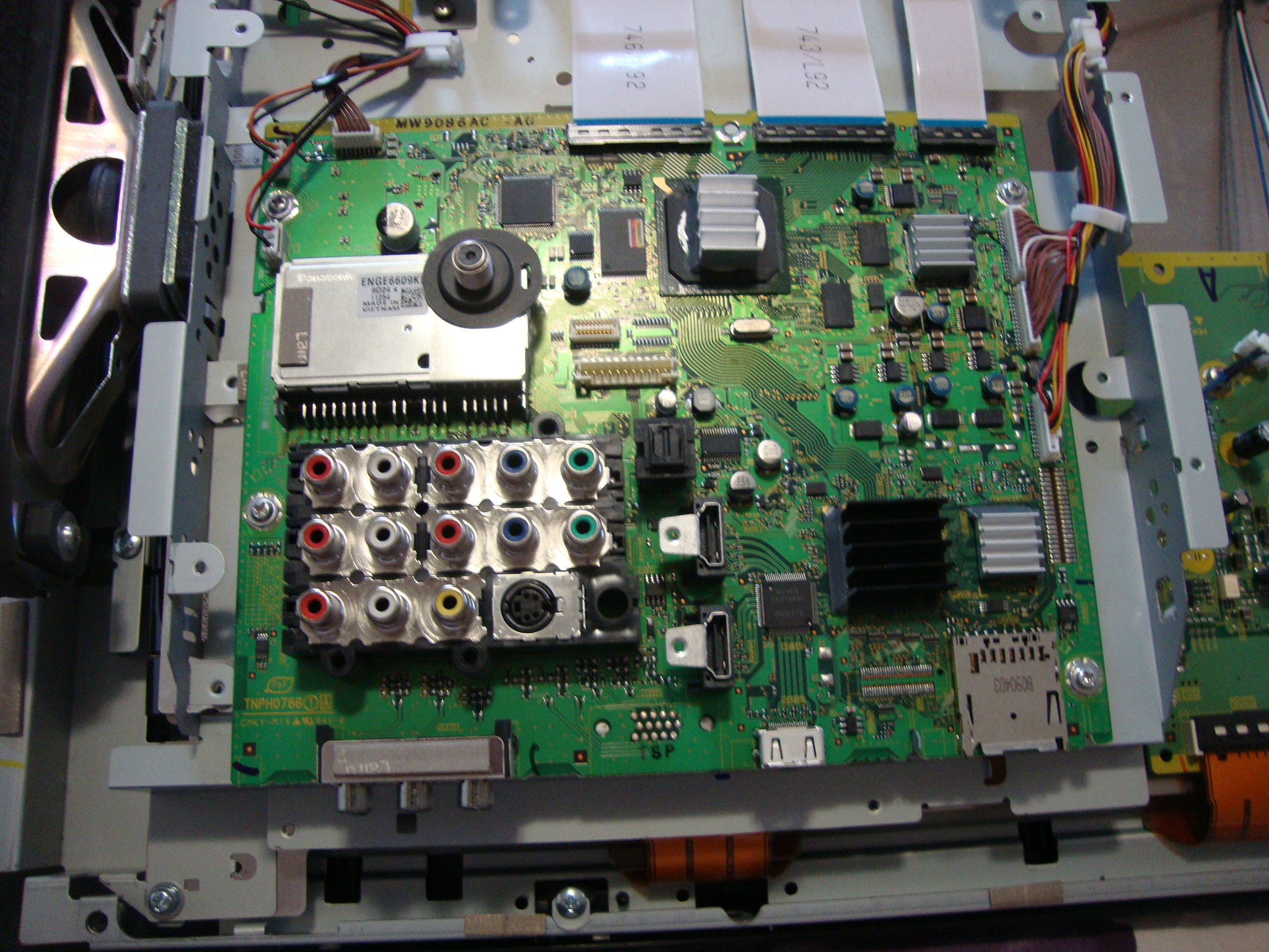

    I have added pictures of the A board because the manual say that is the board to look at.
      Re: Panasonic TC-P50S1 with 10 blinks
      Your pictures need to be clearer and in focus, there is a bit of blur making it hard to see some parts. I recall a fuse can fail on these A boards causing 10 blinks. Also check the SD card slot for coins, damage and debris.

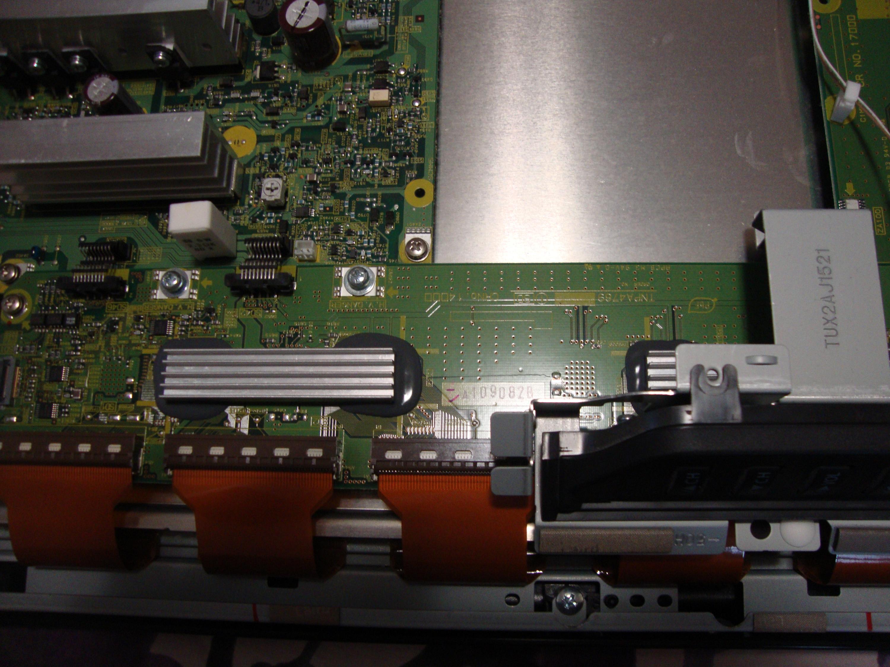

        More hopefully clearer pictures.
          See slide 31
          Can you see TPSOS on the A-board?
            Just looking for it now, where about on the A board is it?
              TPSOS appears to be labled TP3500 on the A board. It is +5VDC. Pin 7-8-9, P board comes on for 1/2 second or so at 14.65VDC. TP3500 stays at 5VD on.

                            Ok so I finally got back to testing this TV. I looked at the manual and it's not clear about the order of disconnecting SC/SS boards. Like what ribbon cable is for what board?
                            Anyway when I have all three ribbon cables disconnected from the A board and power disconnected from the SC/SS the fault clears. That is the red power LED come on solid no blinks.
                            How do I narrow down the boards to figure out if it SC/SS?
                              Bump... How do I isolate the SC/SS boards from the A board, separately. When both are disconnected the PSU comes on. Want to narrow it down.
