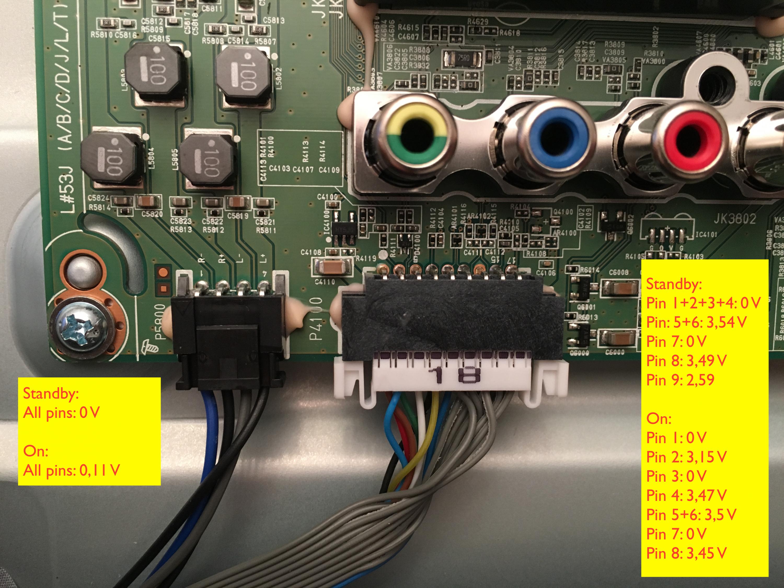

    Hello
    I have an LG 65uf860v
    One morning the screen turned green/purple and then black. Before that everything was normal.
    There is no backlight and no sound. If I use a flashlight I can see the screen flickering when turned on.
    The t-con board makes a “high frequency sound” but not very loud.
    Also on the powerboard the diode LD701 is flashing 5 times. several times. Cant find the meaning of this.
    At the powerboard I get the following. All the numbers are steady.
    At standby:
    11 and 12 is 3,51 V
    When turned on:
    4 = 25,1V
    5= 25,1V
    7= 11,68V
    8 = 11,68V
    9 = 11,68V
    11 = 3,48V
    12 = 3,48V
    13= 3,33V
    14 = 3,48V
    Thank you!

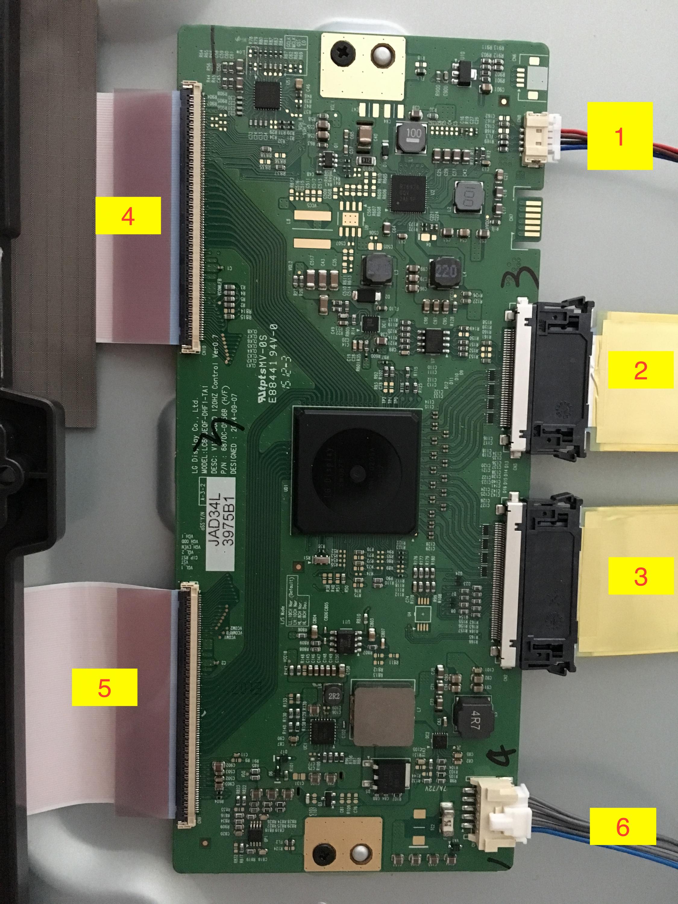

    Unplug one ribbon at a time between t-con and panel and see if noise goes away.
    • Spu
      • Aug 2017
      • 17
      • Denmark
      Re: LG 65uf860 Black screen, no sound. Gets an error code from the power board
      Thank you for your response.
      When I unplug 1 at at a time:
      1) Nothing happens
      2) Sound changes a bit, gets a bit louder
      3) Sound changes a bit, gets a bit louder
      4) The noise is gets very low
      5) The noise is gets very low
      6) The noise goes away

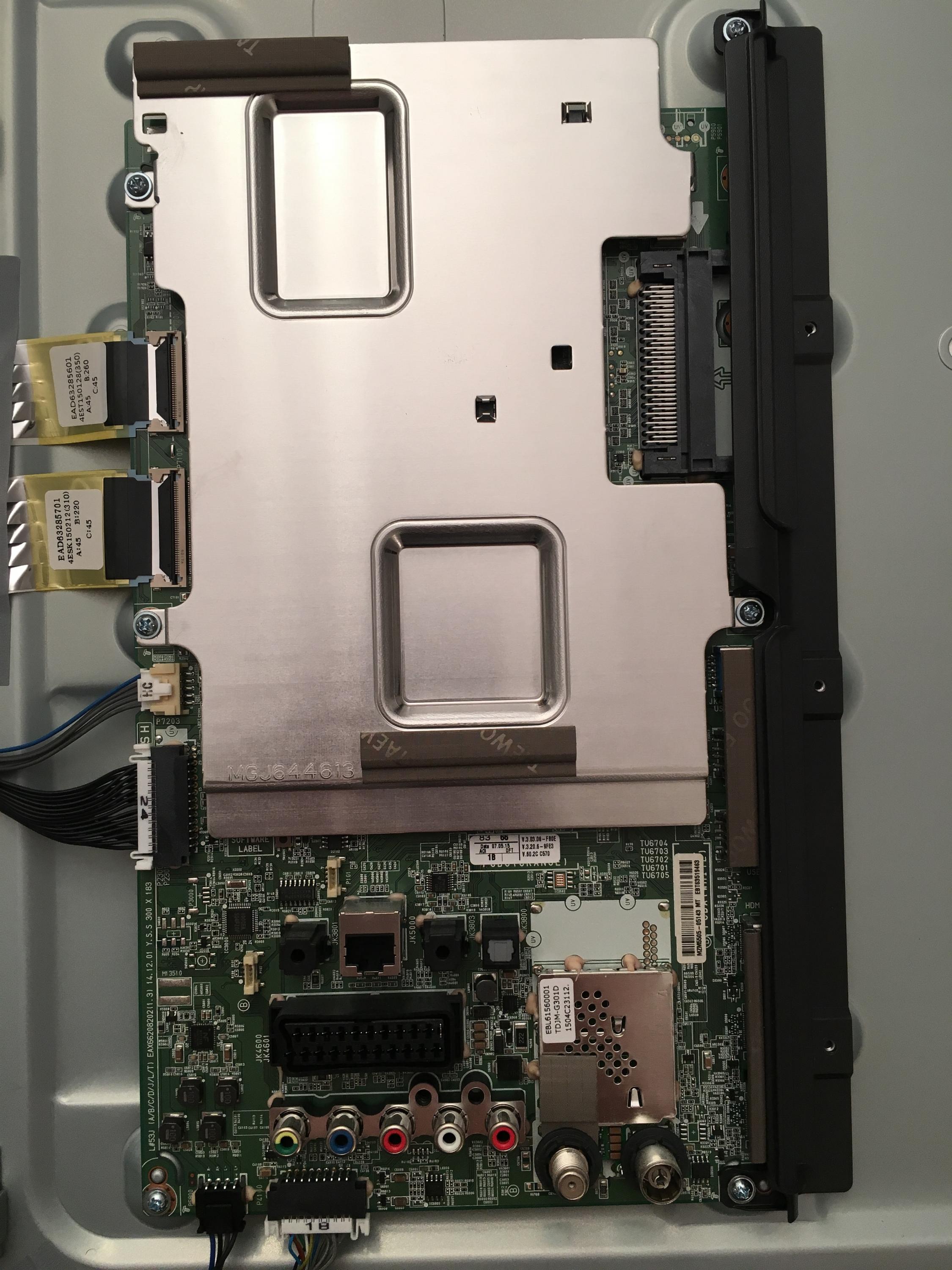

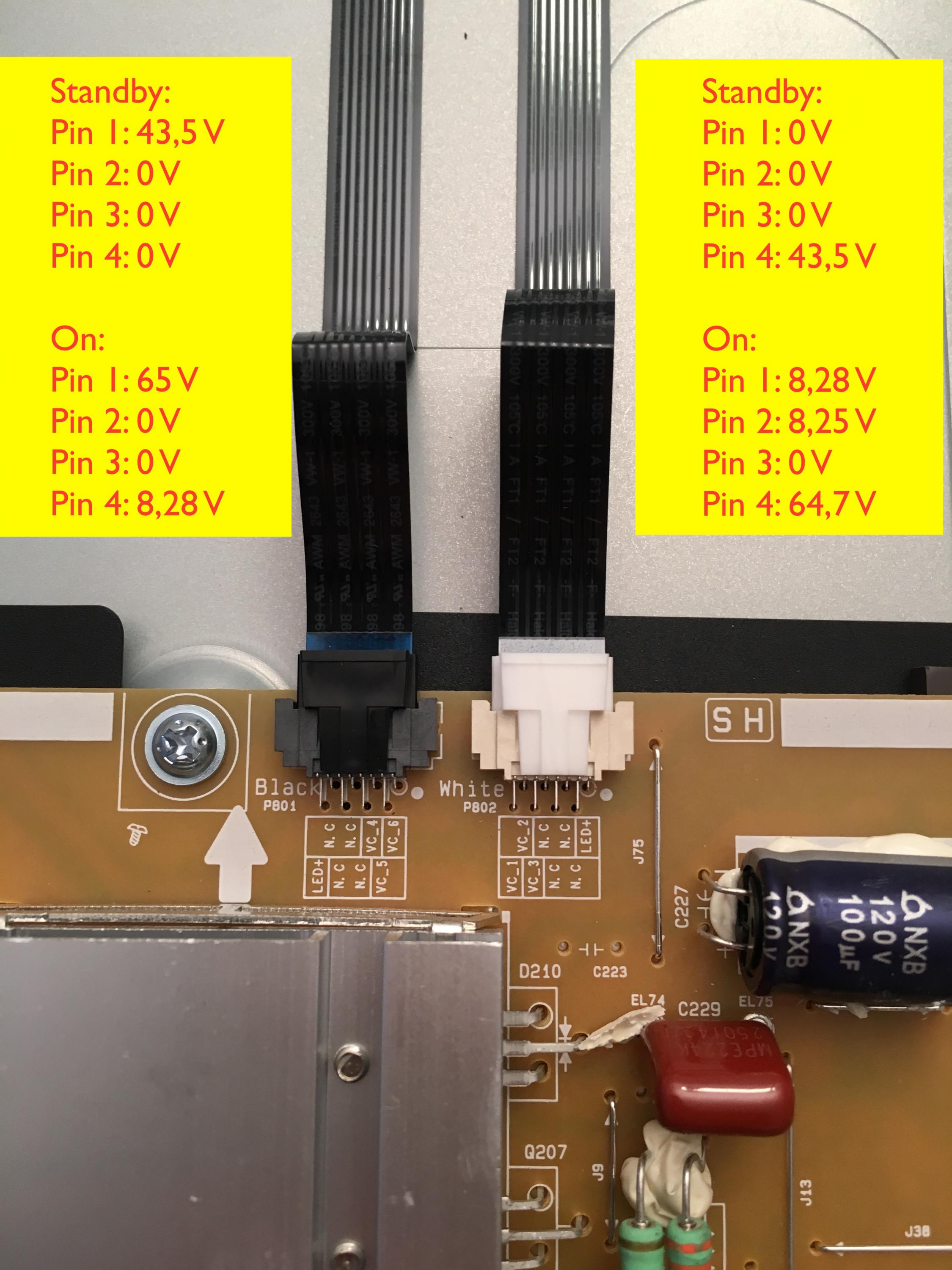

          you have only listed half of the voltages that go to the main board. can you test the other half as well and report the voltages. use the connector where the wire harness goes to the plug.
          WHY CAN'T PHILIPS USE PHILLIPS HEAD SCREWS?
          • Spu
            • Aug 2017
            • 17
            • Denmark
            Please see the attachments.
            I have listed all the voltages in both standby and when the tv I on.
            Please let me know if you need anything else.
            Thank you! :-)

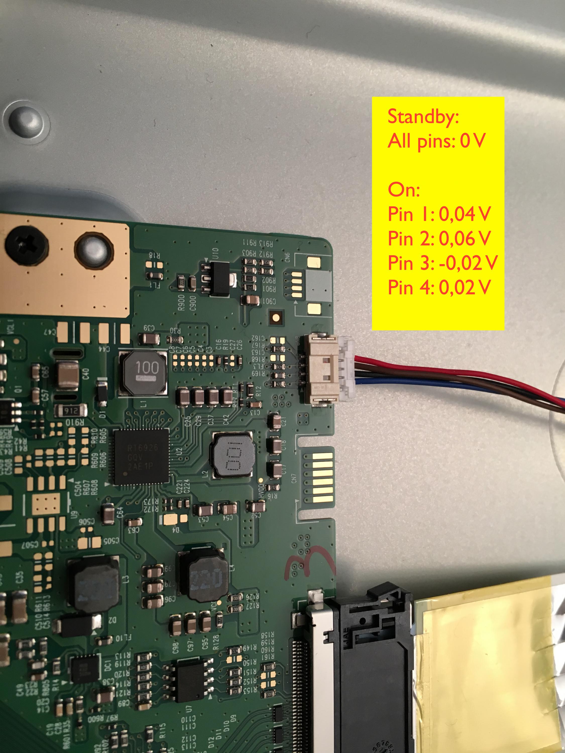

                There are various voltages on t-con board. Examples:
                T-con voltages (typical)
                1. Vin (Vcc): 12Vdc or 5Vdc
                2. Vlogic,LCM, Vddd,VCC): 3.3Vdc
                3. Vda (Vs, Vsource,VDD, Vdda,Avdd): 14Vdc~20Vdc
                4. Vgh (Vgon,VGHR, Von, Vddg): 20Vdc~30Vdc
                5. Vgl (Vgoff,VST,VGHF,VGHEVEN, Voff,Veeg): -5Vdc~-7Vdc
                6. HVDD about 8v
                7. DVDD,VDDC 3.3v, 1.2v
                8. VCOM about 5~10vdc (about half of Avdd)
                I would check and see what voltages are with 4 and 5 hooked up and disconnected to see if difference. Also check if any components on t-con getting real hot

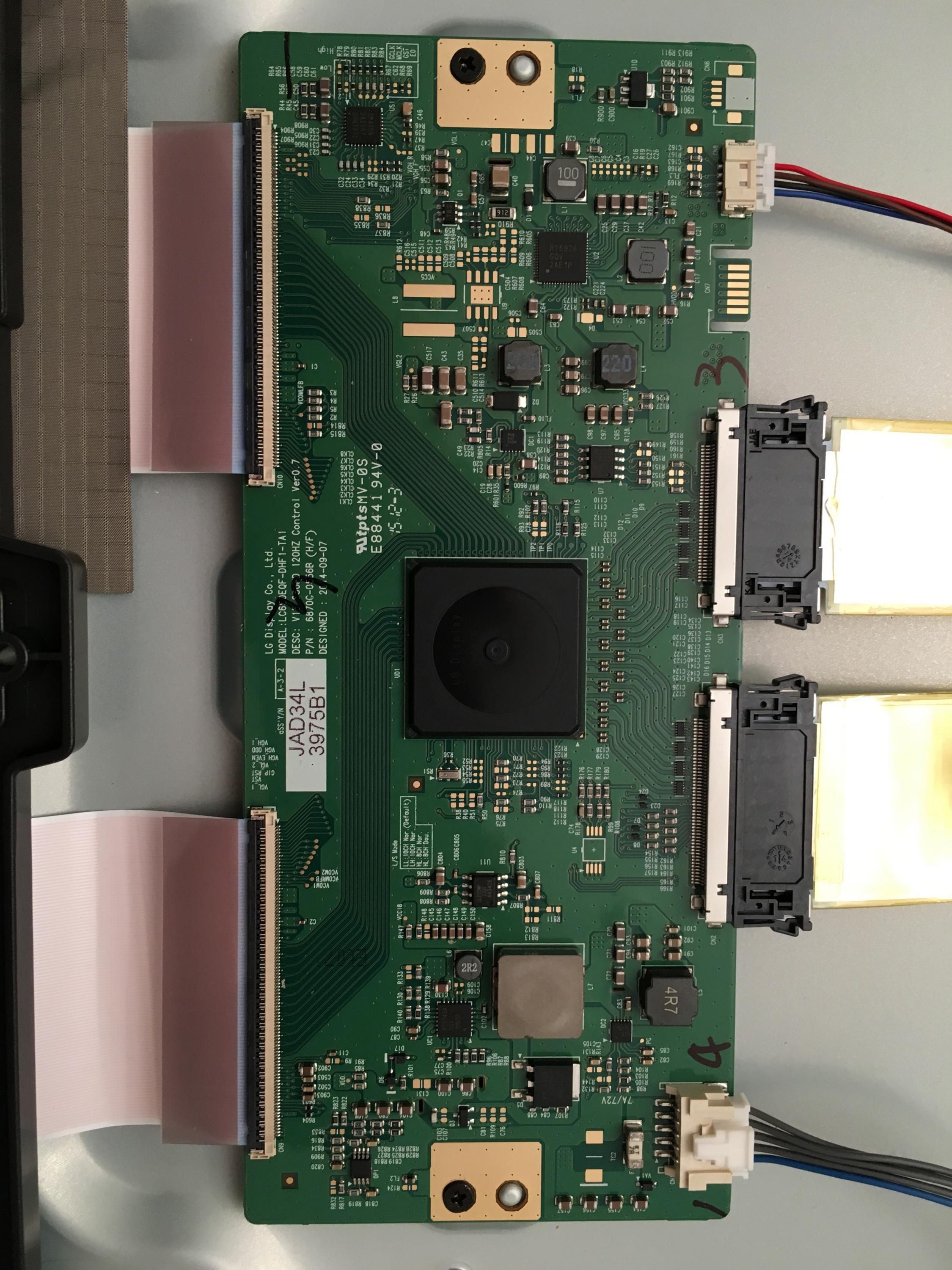

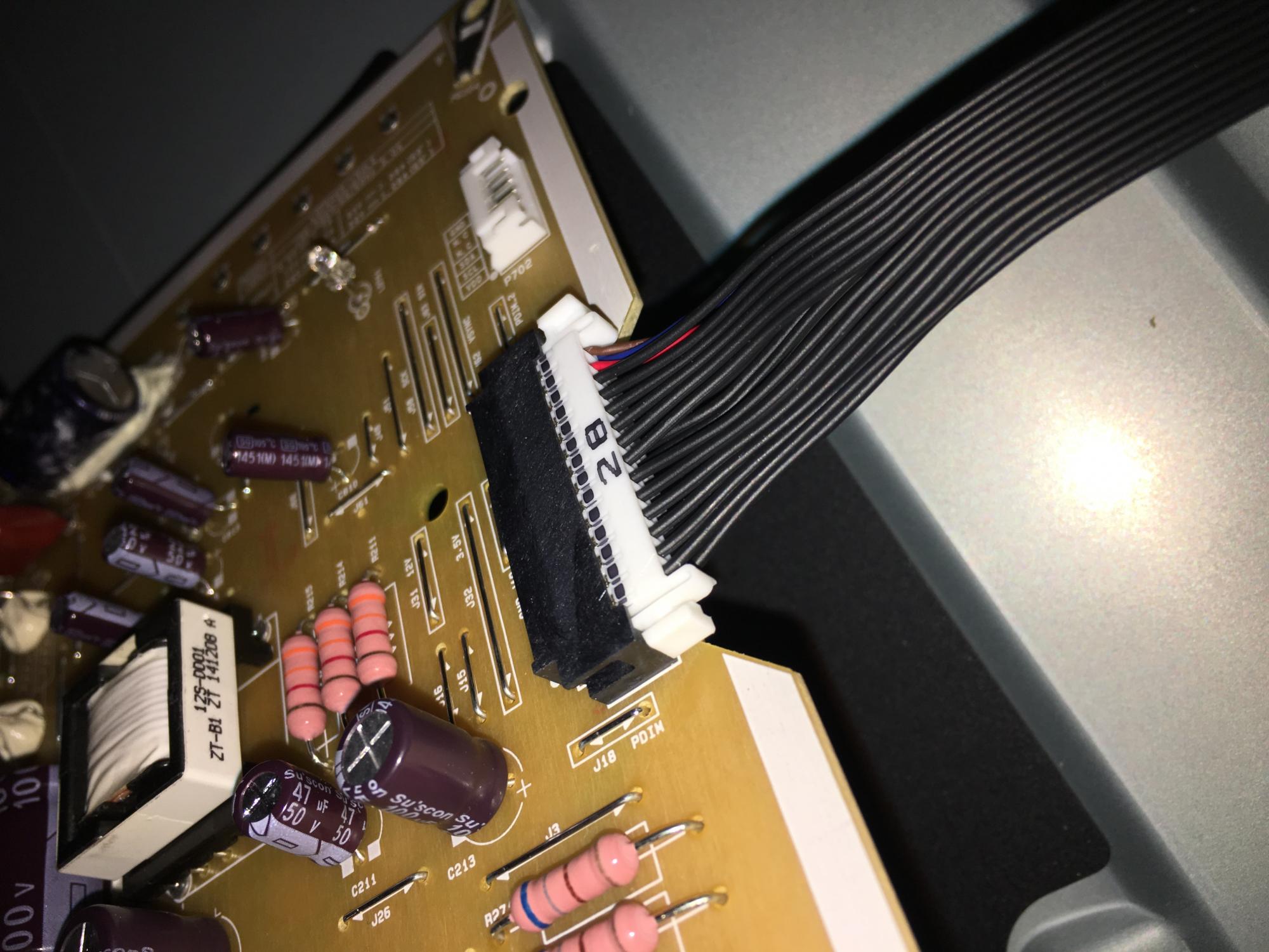

                  At picture 4 called "Tcon" there is a change. With 4 and 5 (the ribbons at the tcon) connected the voltages are near 0, but if I disconnect both pin 1 goes up to 3,29 V
                  At picture number 5 called "Powerboard" there is a change. With 4 and 5 (the ribbons at the tcon) connected the voltage at pin 2 (the black one) is near 0, but if I disconnect them, the voltage goes to 8,61 V
                  There a several other changes but its only a few percent. Do you need me to list them up ?

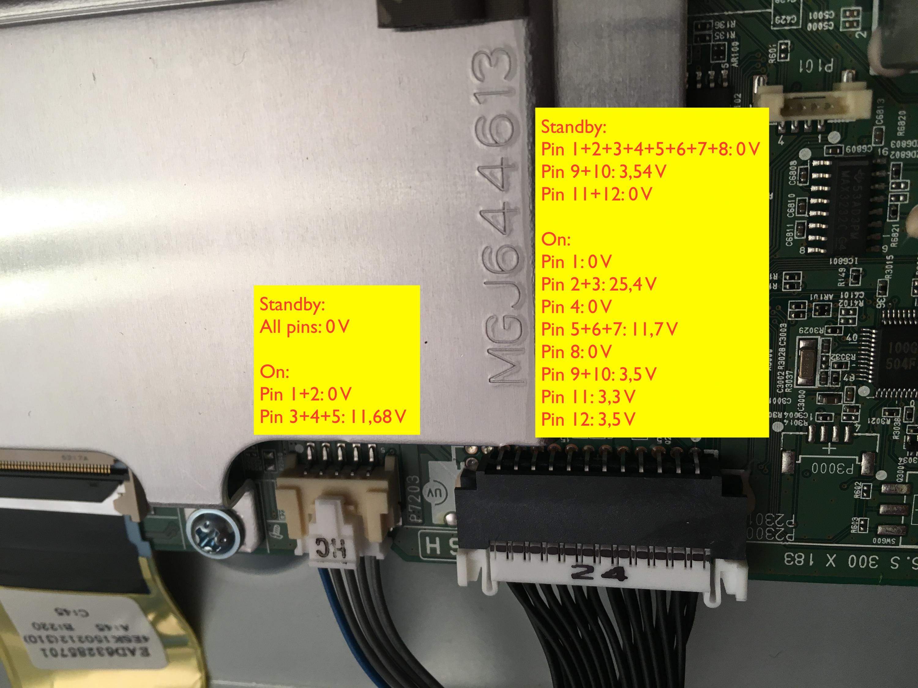

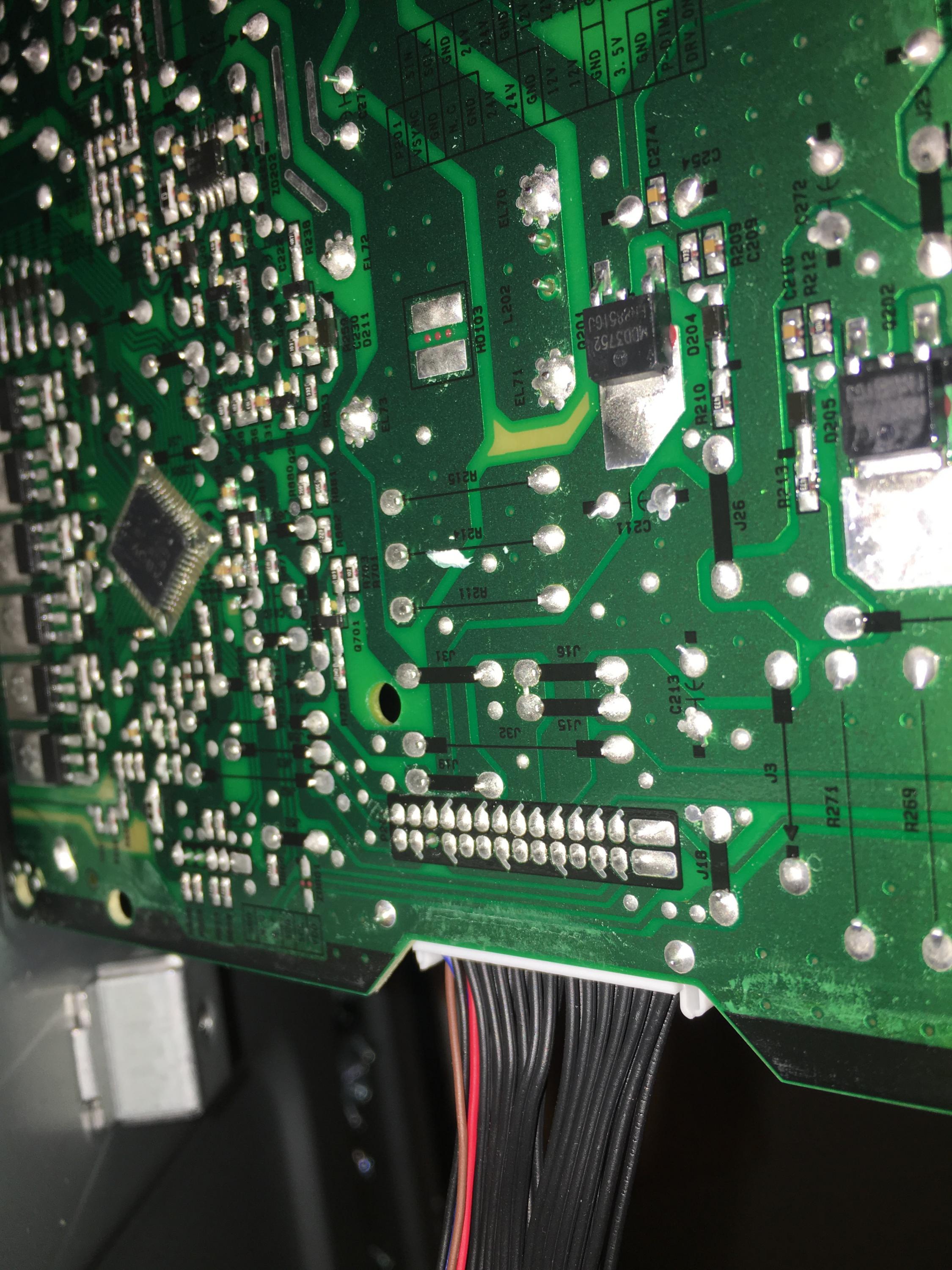

                    You are only showing half the pins voltages (there are two rows of pins!) the second row is hidden under and closer to the connector.
                    • Spu
                      • Aug 2017
                      • 17
                      • Denmark
                      Here are the numbers from the powerboard. Do you need them from the mainboard as well ?
                      At standby:
                      Row 1:
                      Pin 11+12 = 3,54 V
                      Row 2:
                      Pin 11 = 3,54 V
                      When turned on:
                      Row 1:
                      Pin 4+5 = 25,4 V
                      Pin 7+8+9 = 11,73 V
                      Pin 11+12 = 3,5 V
                      Pin 13 = 3,3 V
                      Pin 14 = 3,5 V
                      Row 2:
                      Pin 5+6 = 25,4 V
                      Pin 8+9 = 11,73 V
                      Pin 11 = 3,5 V
                      Pin 13 = 3,3 V
                      • attainteddragon
                        • Apr 2013
                        • 764
                        • australia
                        now we can see that you have your ps/on signal and your bl/on signal.
                        are you positive that you have no back lights? check through the holes in the back of the set.
                        on the fuse of the t-con (7 amp just above the 5 pin connector), what voltage do you have on both sides of it when turned on?
                          I made the room completely dark and turned the tv on (with no back cover). No light
                          The fuse at tcon is 11,7V on both sides
