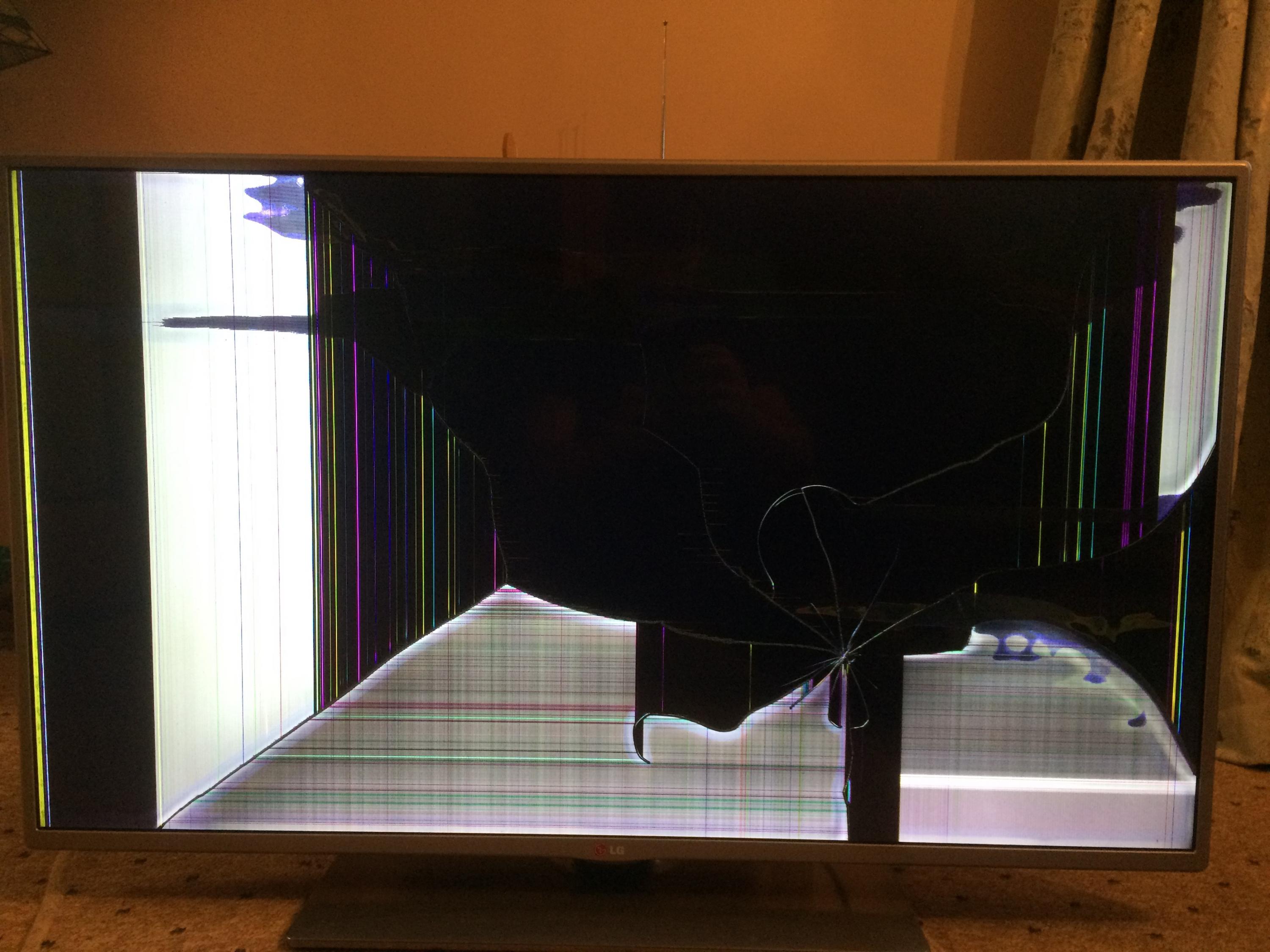

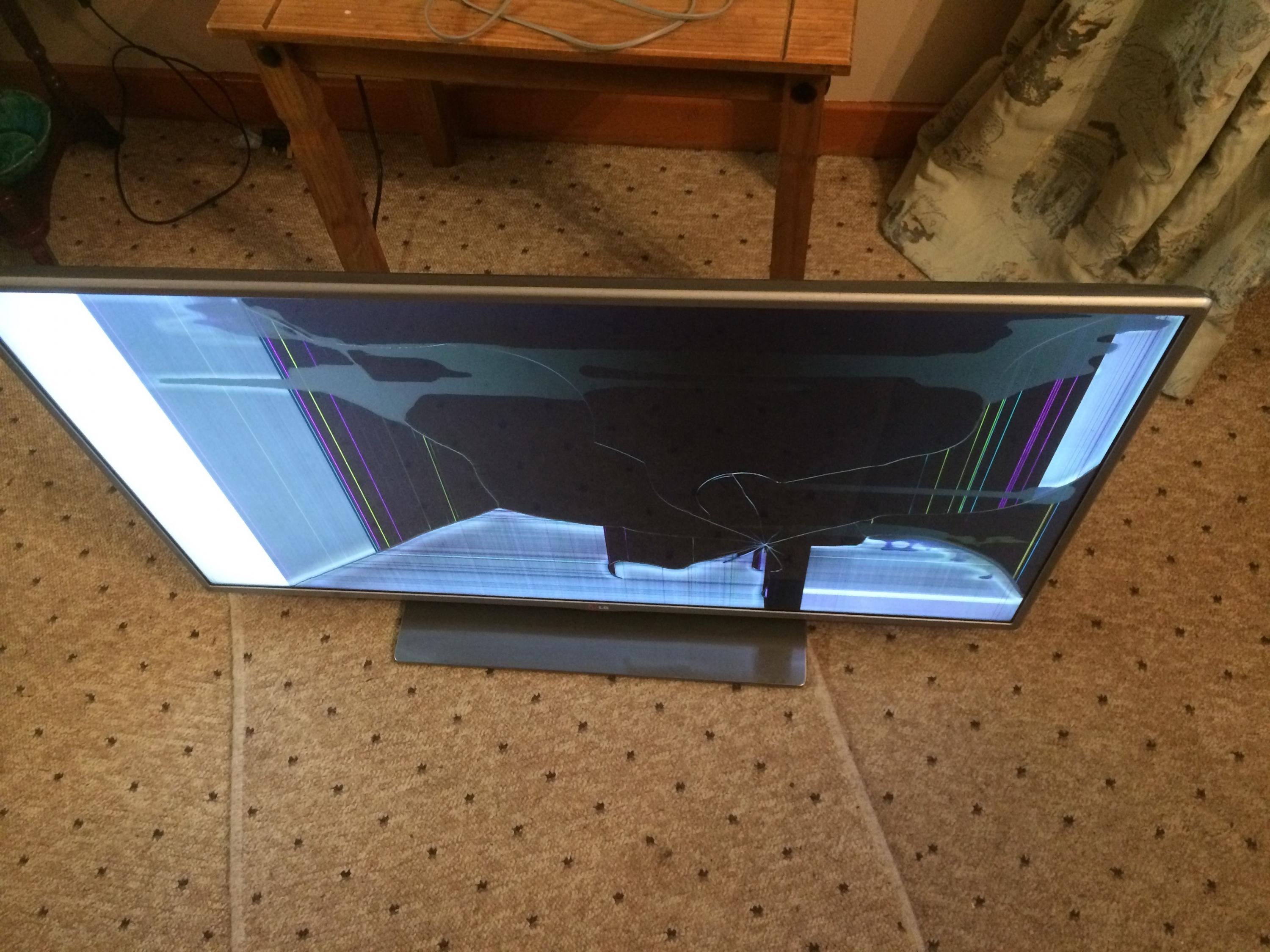

    I think this is an LCD panel - Is there any chance getting this fixed or is the panel dead?

    You can probably get it repaired for the price of 2 new ones, Sell it for parts

      Only if you know Harry Potter or one of his friends
      Parts only, don't forget the LEDs.

        hang it on the wall in a gallery, then auction it for a starting price of 100,000

          If you can catch one of those "little green wee bastards" he could buy you a new screen.

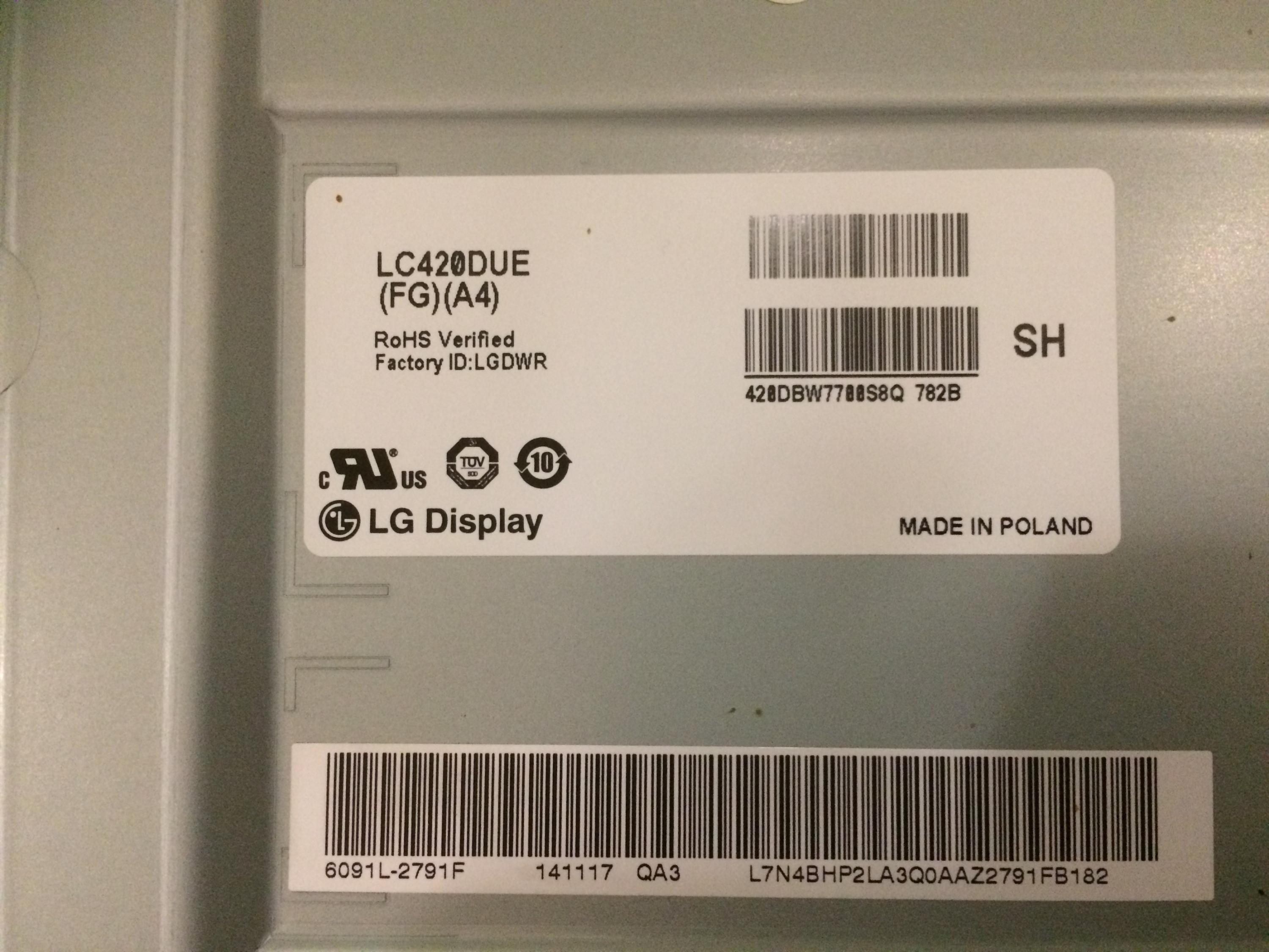

            Is there a guide on now to strip and what parts to sell?
            Is there a way to check the parts are good?

              What's the model number of your set?

                A guide ? The delicate part is already broken. Remove the back. Unscrew the boards.
                Remove the LCD and the polarizing layers and diffuser and then use a hair dryer to soften any self adhesive tape holding the LED strips.
                You know the power supply works and the LEDs do too. As the screen is to damaged to get any picture it's up to you if you sell the mainboard and tcon as working. (I'd guess yes they are ok).
                You could disconnect the cable going from the tcon to the broken side of the screen to see if you get a picture the other.

                  selecting the menu or other options from the button board should alter the lines of interference on the screen. at least you will have some idea of operation from that.
