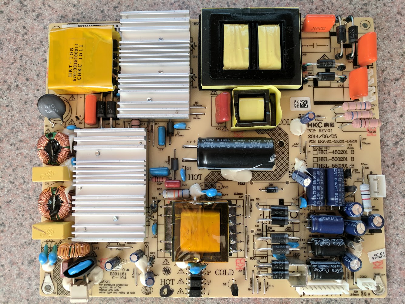

    I am getting no response from this TV when plugging it in. There's no standby light and the power switch doesn't appear to do anything. I am looking at Bud Martin's troubleshooting pdfs and I'm trying to locate the main fuse on the power supply board, but cannot find it. If anyone has any other ideas about what may be causing this, I could really use the help. Thanks.

    Re: SCEPTRE U550CV no power, no response from switch
    May be brown rectangle lower left. What dcv do you get across C17
      113.1 uF
      EDIT: Misread your question. 0.0VDC on C17 and and 117VAC at plug

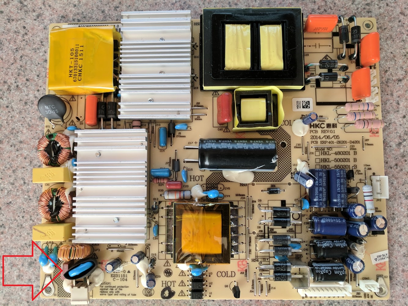

          the fuse is located below the coil label "LF3" . It have a brownish color. see picture red arrow
            Thanks. Fuse tests good, so it's not that.
              disconnect main board and check if your stby voltage is stable.
                It's not stable at all. It goes up and down in a cycle from ~0.1V to ~0.02V
                  oops, missed that there was nothing on c17.

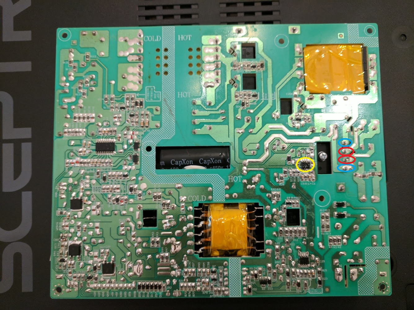

                  we will need pics of the bottom side of the board.

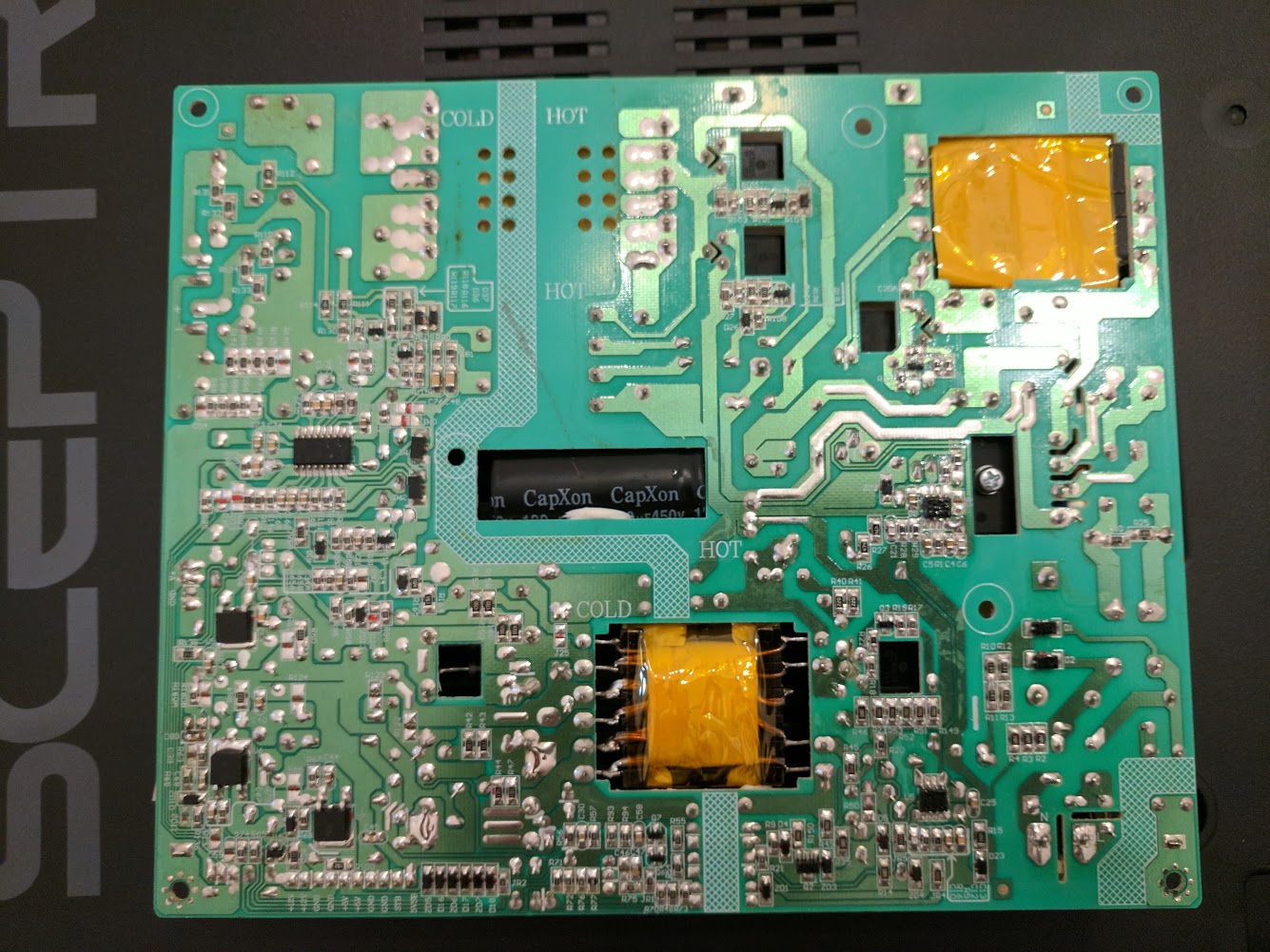

                  • Downward_Spiral
                    • Jul 2012
                    • 37
                    Bottom
                      test the voltage on the bridge rectifier.
                      blue in dc, red in ac. this is the hot side, so care must be taken. do not touch anything with your hands.
                      check the yellow ic. it is probably just flux on it, but looks wrong in pic.
                      also a higher res pic would be good, and the ps part number. as someone may be able to find a schematic for it.
                        Thanks for the help, everyone. I ended up just buying a new power supply from TVPartsGuy for about $50+shipping and it turned right on. Problem resolved.
                          For myself I would have tried replacing c17 being a capXon then if no change the diodes full check.
