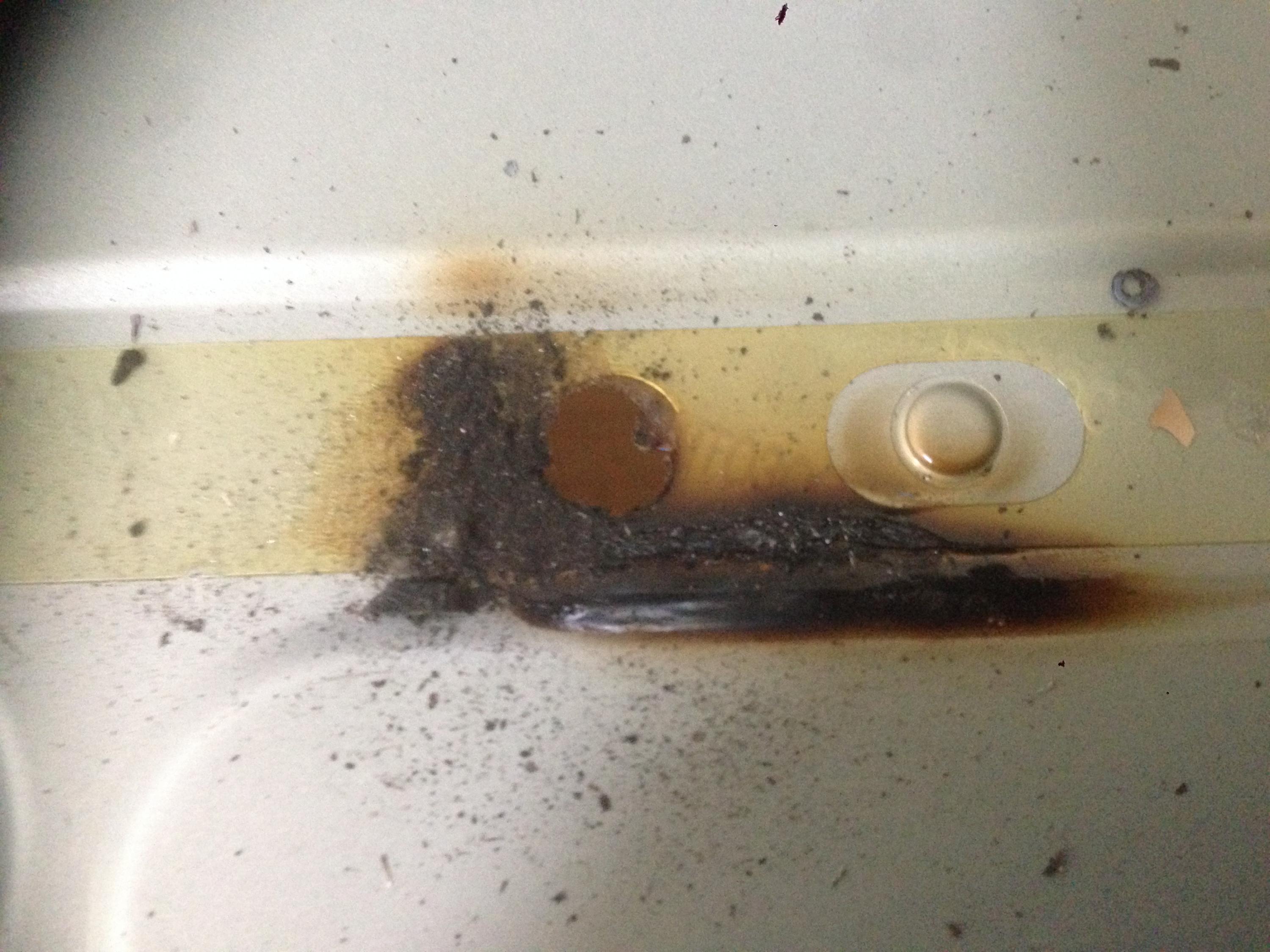

    Hi All

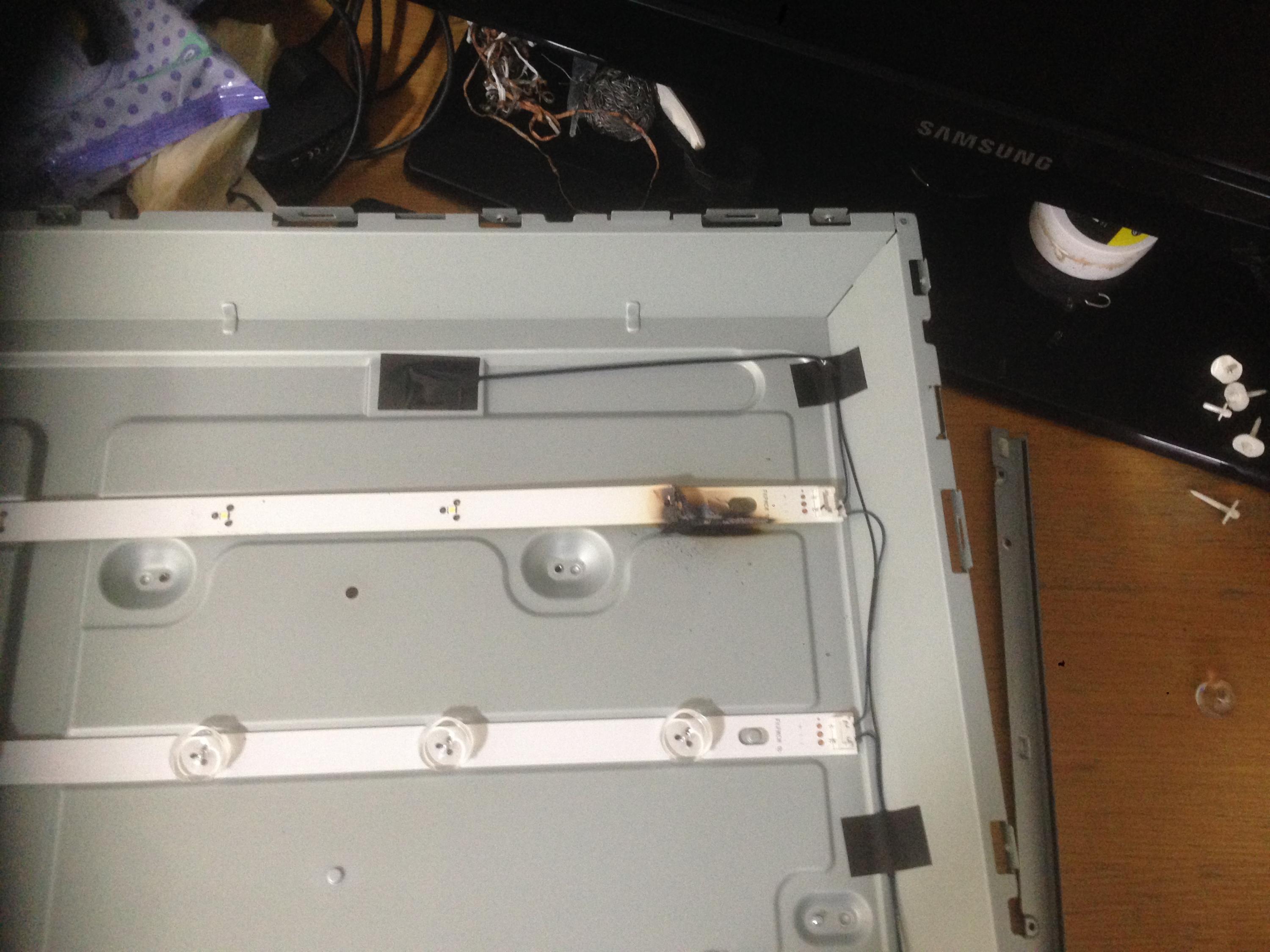

    Got an LG 39LN575v with a bad LED ! in fact its completely burnt out. Its burnt the strip, diffuser metal casing and power board !!
    Stacking is not an option as there is no strip to work with so i need to find a strip
    problem is they seem very rare (one in spain but at nearly £50 thats not an option )
    does anyone know where i can get one ?

    i would cut the section out and take a section from another strip, and wire them together. also dremel the corrosion and carbon on the panel itself.

      What is the LCD panel model number?
        Re: 39LN575 - LG INNOTEK POLA 2.0 39" B Type Rev 0.0
        No reason you can't do stacking
