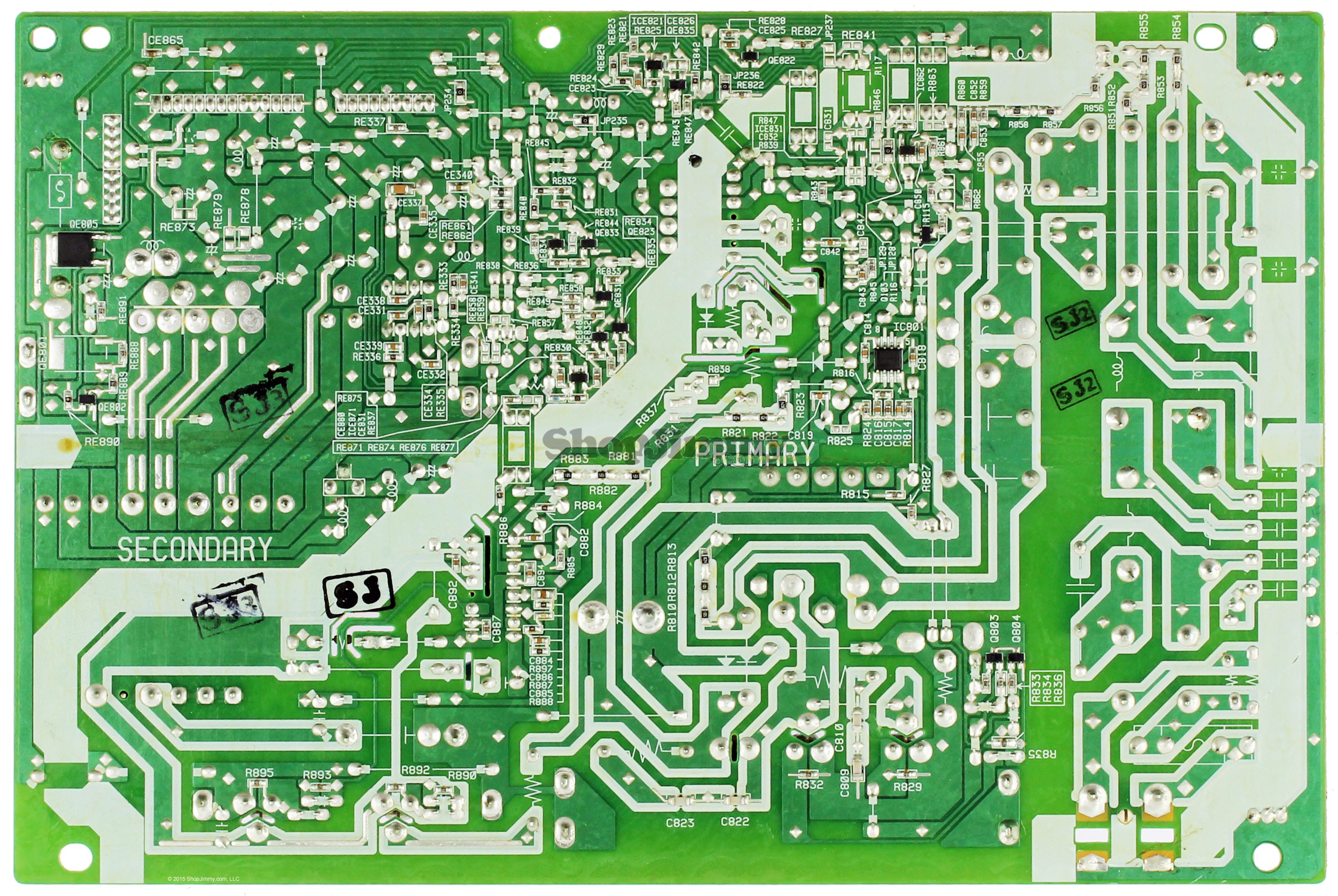

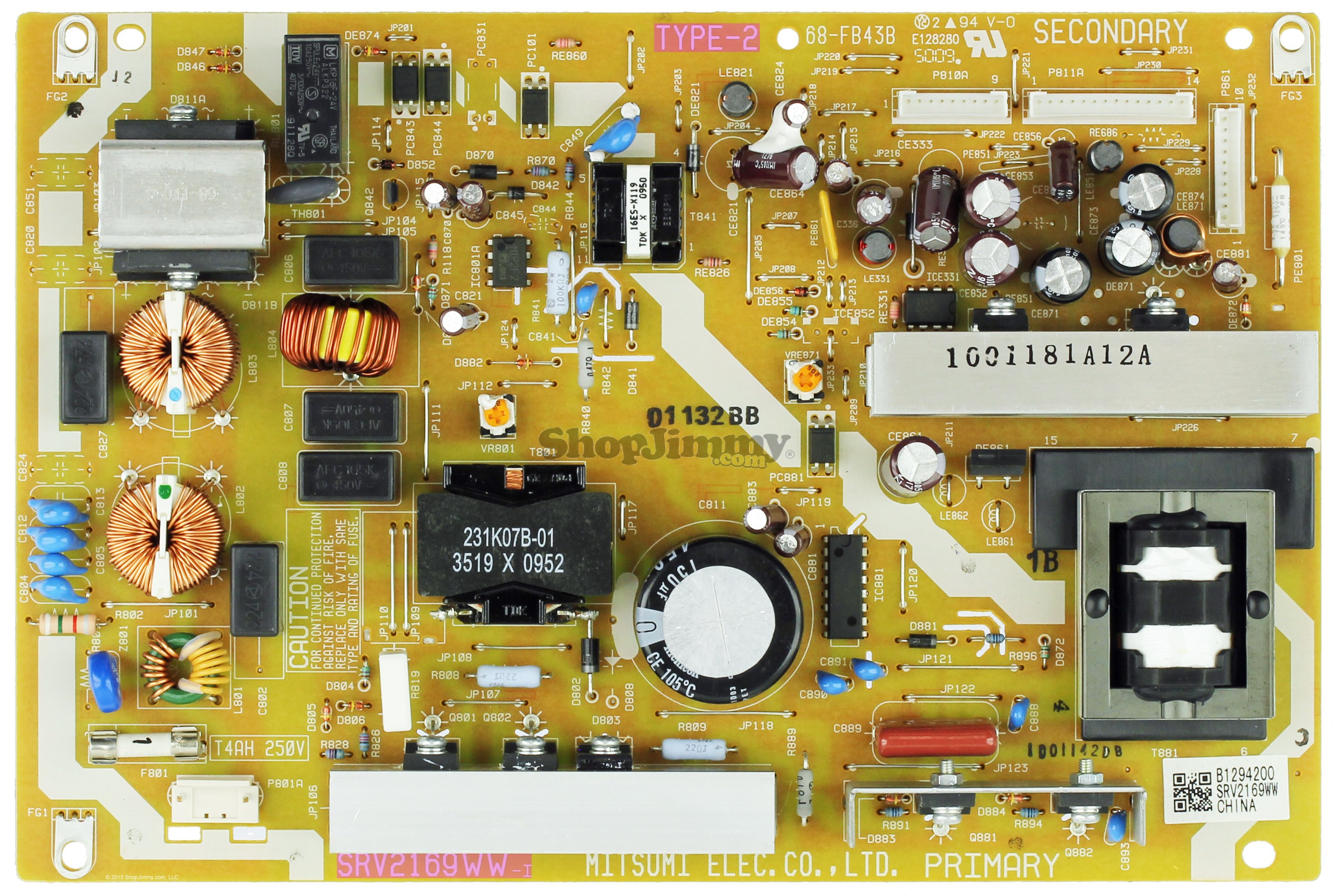

    Re: Toshiba Regza 42XV635D sometimes doesn't turn on
    I am not convinced at this point that this is a PSU problem. Could you upload high resolution, straight shot pictures of your PSU and the main board?
        They are too dark and not high res enough to zoom in and read things off the boards. We need to be able to identify things written on the boards.
              I scanned the boards at 300dpi
              https://drive.google.com/open?id=0B-...EVmcTJxeDMwWms
              https://drive.google.com/open?id=0B-...FlvQnBycm8zWFk
              https://drive.google.com/open?id=0B-...XFFa0NjR0VaaFE
              https://drive.google.com/open?id=0B-...GhxWkFGblF4M00

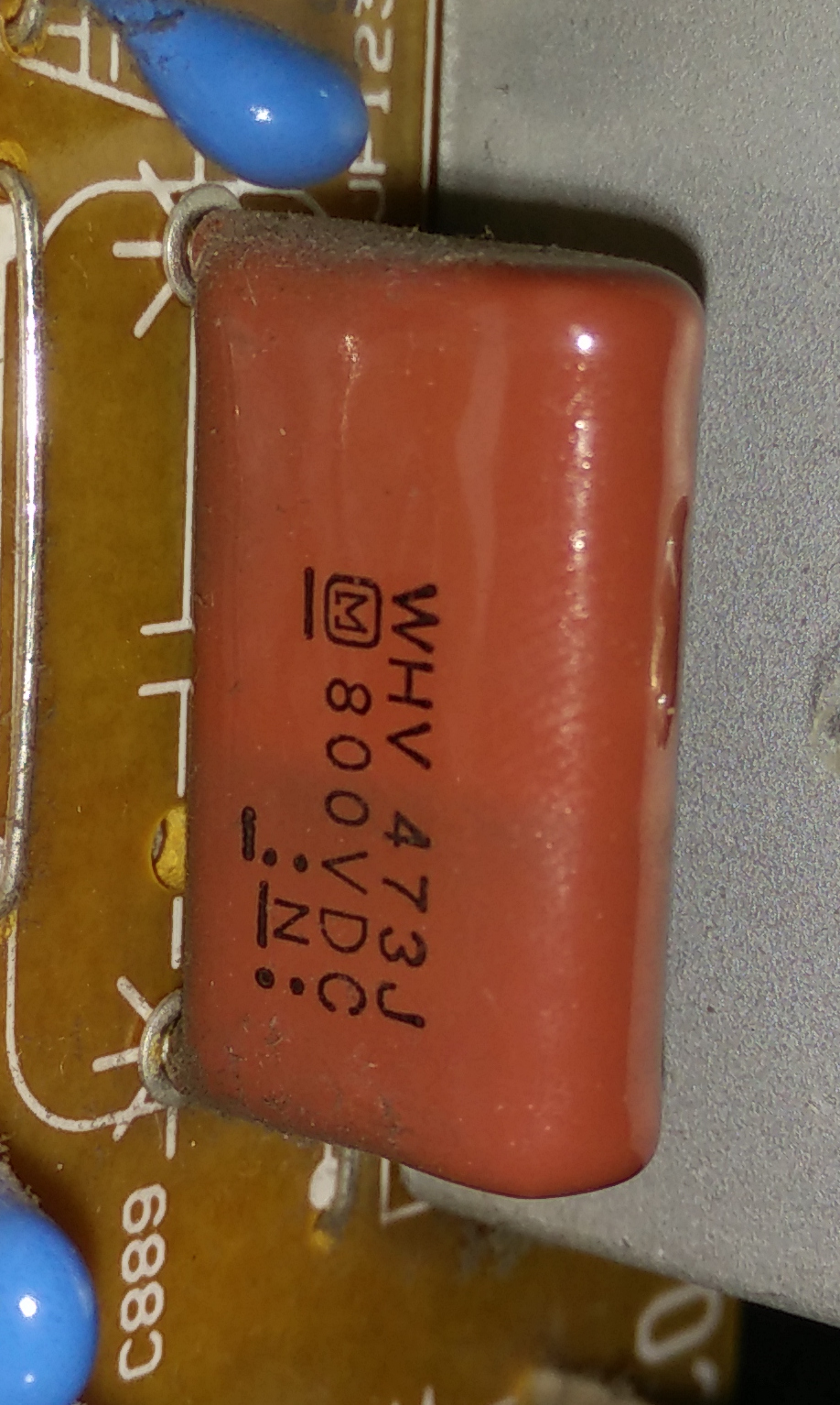

              • dick_barton
                • Aug 2015
                • 6643
                • Wales
                Check C889 for any signs of damage and that it hasn't changed its value.
                • JackHack96
                  • Aug 2017
                  • 11
                  • Italy
                  I visual-checked the capacitor, but there are no evident sign of damage (nor bulges, the surface is super flat). My multimeter doesn't have the capacitance measurement option, but I can try to use the resistance method for checking the health of it.

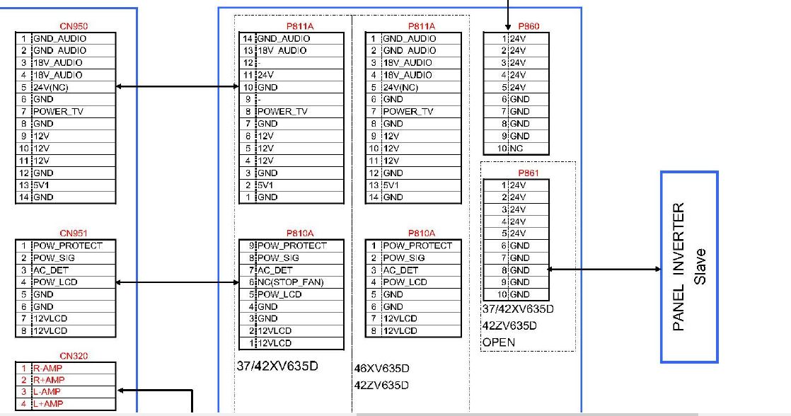

                      • dick_barton
                        • Aug 2015
                        • 6643
                        • Wales
                        Manual available from:-
                        Page 22 gives the connector voltages.

                        • JackHack96
                          • Aug 2017
                          • 11
                          • Italy
                          I tried to measure the voltage of POW_SIG pin in P810A when I press the power button, but nothing change. I tried to use an external 3.3v source and I poked the pin with it for a few second, and I can hear the "click" sound of the TV when it turns on (don't know it it's a relay or something similar), but the TV remains off.
                          I then tried to poke the BL On/Off pin on CN653 with the same external source, hoping it would have switched on the backlight, but it didn't work.
                          I'm puzzled, I don't know what to do next
                          • JackHack96
                            • Aug 2017
                            • 11
                            • Italy
                            Hey, now the TV has turned on by itself (it's one of its lucky moments) and I've just measured the voltages of the following pins:
                            On the P810A connector (PSU)
                            POW_SIG: 2.80V
                            POW_LCD: 3.30V
                            On the CN653 connector (Main)
                            BL On/Off: 3.30V
                            PWM: 3.30V
                            Normally these voltages are 0 when the TV is off.
                            (sorry for the double post, it seems there's no clear way to edit previous posts)
