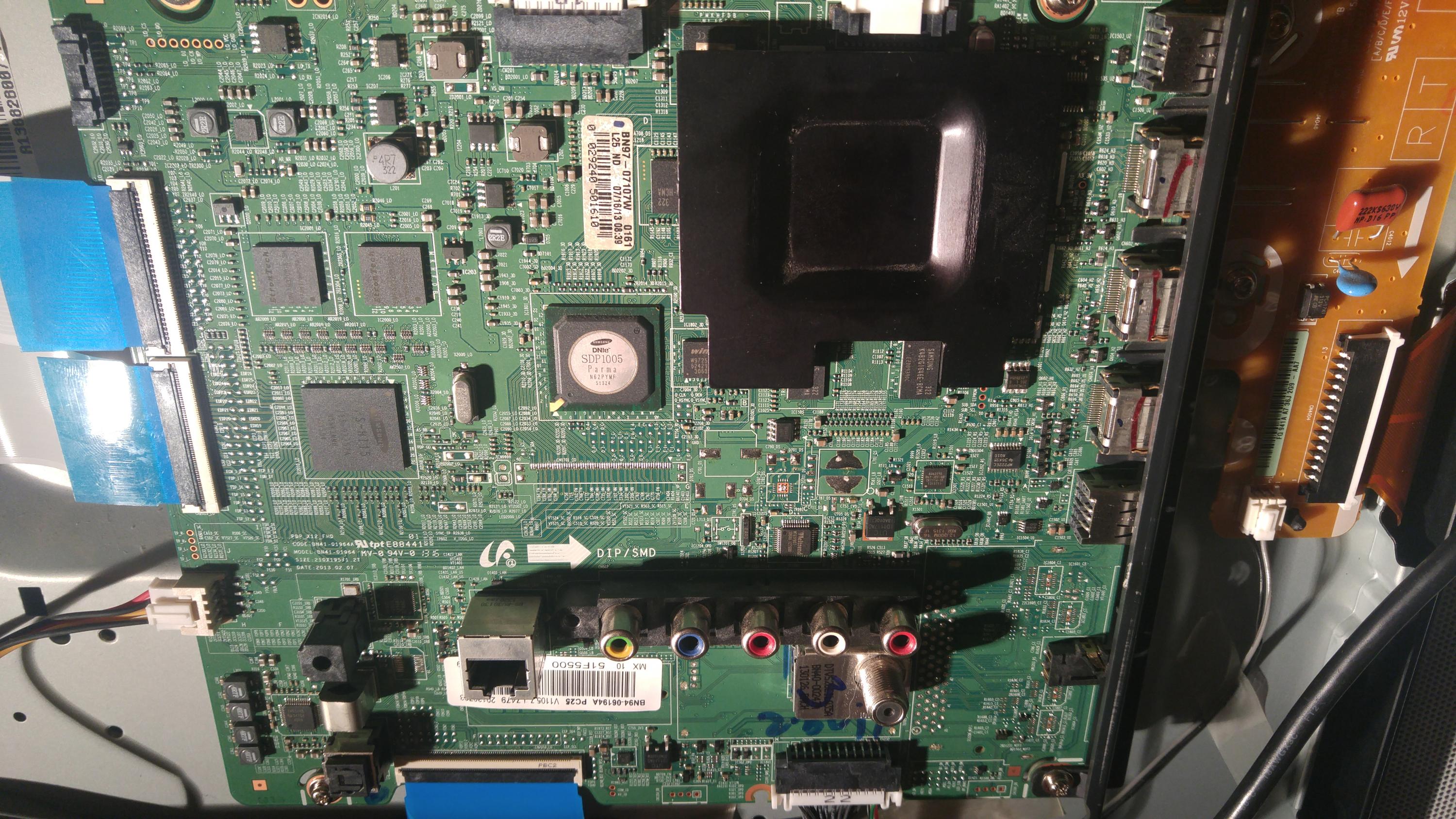

      my board dose not have the ribbon connector in the center !
      my sps- hi15 is pretty dark and i can barley read it,
      i see you can buy these chips and they are part if the logic board circuit.
      i can hire some one to flow a new one on but that may cost as much as a new one.
      i can try myself but may screw it up beyond repair unless i had a re flow station
      i see a BN96-22025A logic bard has same chips.

          i can get a BN94-06194B for a 60 inch local apposed to my BN94-06194A.
          i wonder if i can just change the aspect in service menu to make compatible?
          its a shame samsung just had to integrate the boards together.

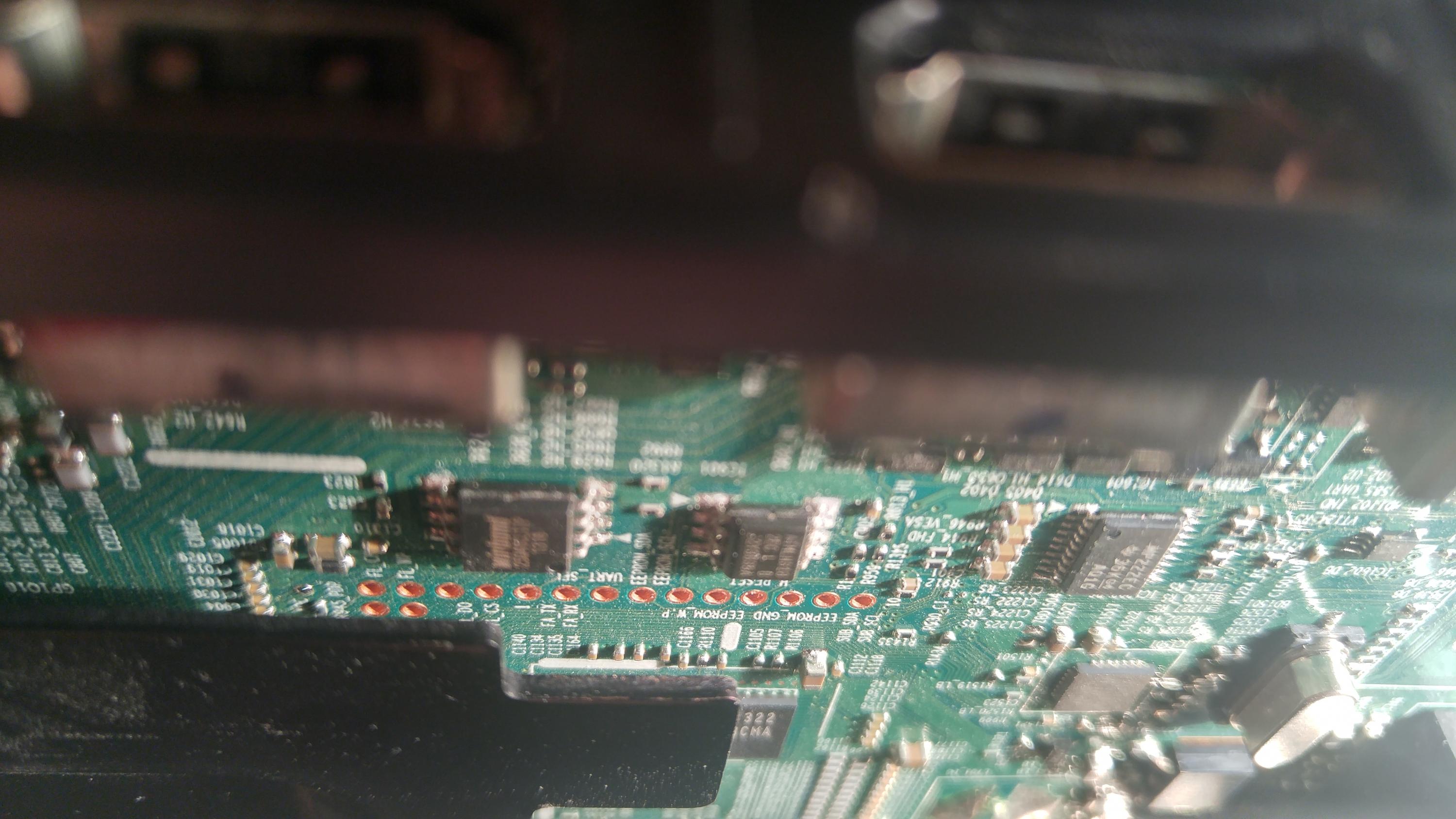

              there is 2 eprom chip's on the top of the main board under the black heat sink at the bottom right.
              top one is a sda lower one is scl
              i tried fowling the procedure on both by shorting the pins 5& 6 but nothing.
              gotta charge flash light before i can get part numbers on the eprom.
              im getting the 13 second reboot loop such as others i find on the internet

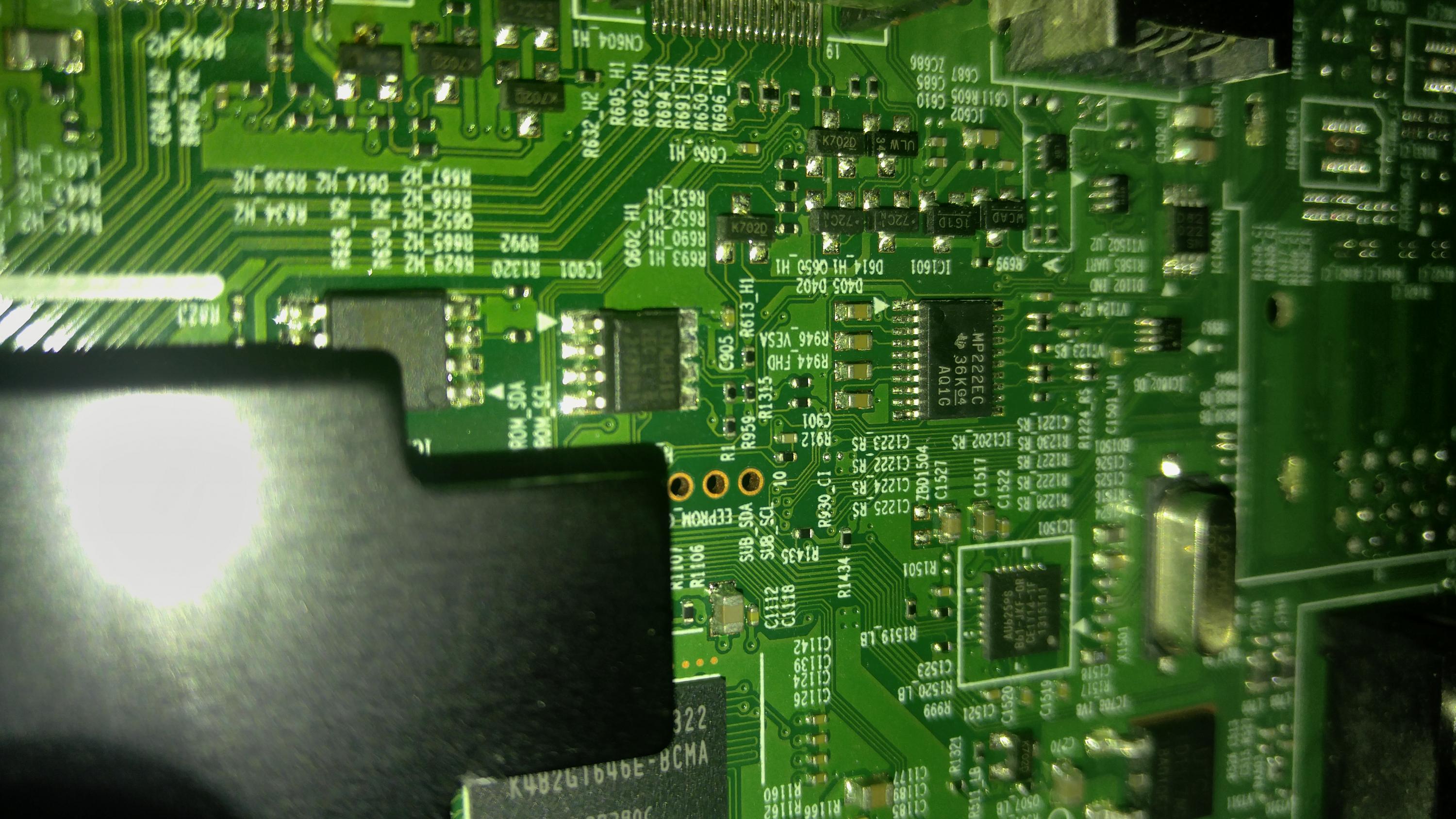

                  a better pic than i can take of the main board is a couple post up , if you open it you can expand it really big.
                  i get no Samsung logo so it makes me lean towards bga issue or a power surge hit the tv and took out the eprom.
                  eprom -sda
                  winbond
                  25q40clsip
                  eprom- scl
                  atmlh318
                  2ec l b
                  2y3835a

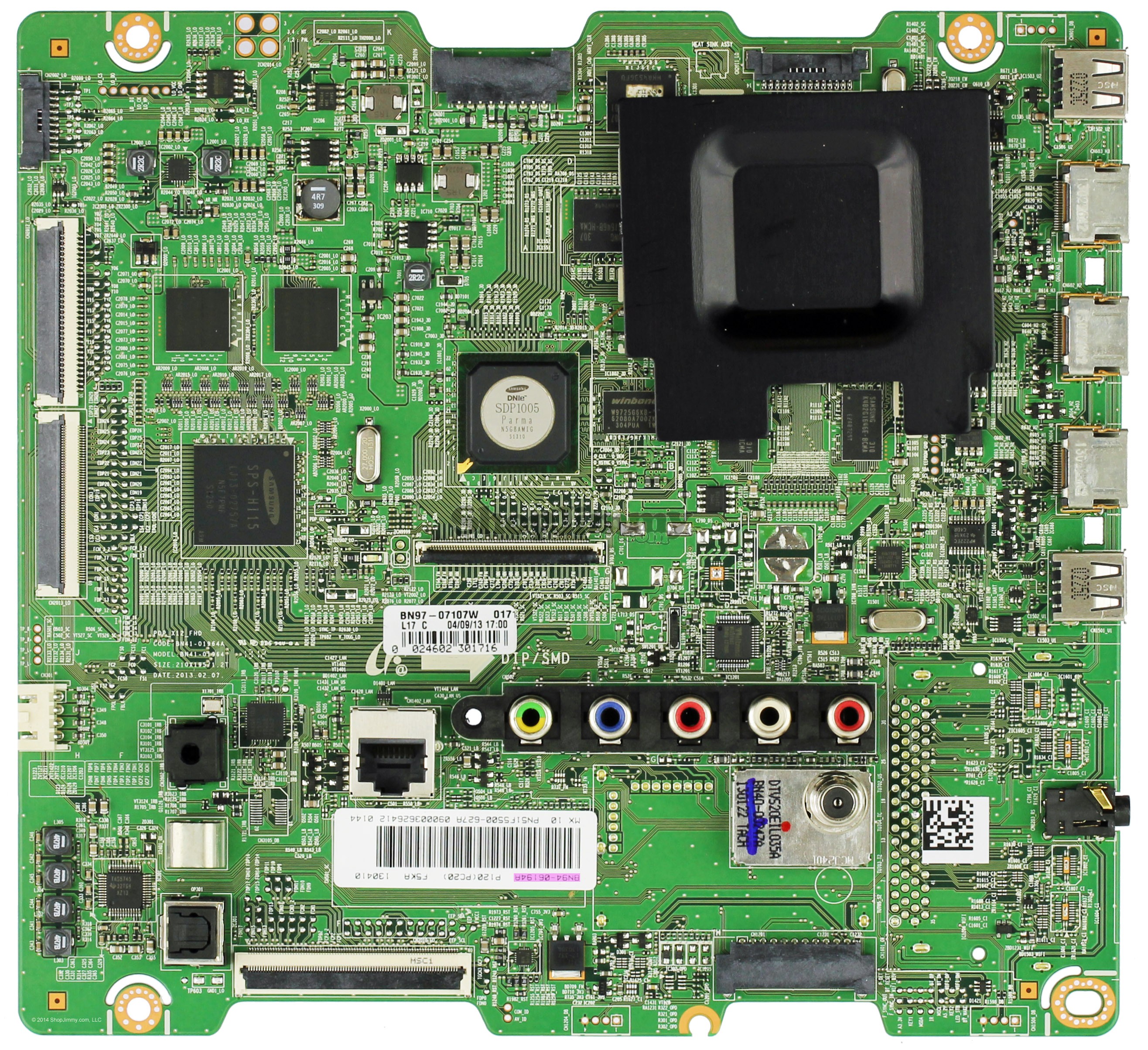

                      you can use a vpn or proxy, best picture i can find.
                      try searching BN94-06194A on google then selecting tools, image size large

                          there is set of holes and the ones next to winbond says uart.
                          the one's next to the atmlh831 says h reset and eprom ground but im not sure witch hole's are witch.

                          How to hard reset eprom
                          For resetting TV, settings, you needed to remove SoC EEPROM device from TV. But it's not required. In electronic world, if you disable communication of the chip, it counts as removed. So we just needed to kill communication of SoC EEPROM. EEPROMs on Samsung TV's communicating via common i2c protocol. That protocol carries data via SDA line and send clocks via SCL line. In our situation, both blocking SCL or SDA will works. But I decide SDA.
                          To do this, all you have to do that feeding (connecting) GND (ground) or VCC (3.3v) to SDA line with little wire... That's all. Since this lines are HIGH (v3.3) in IDLE, its better to hold it via VCC. You can also hold this lines via GND too. But don't try to connect both GND and VCC. It will be short circuit and probably will damage your board.
                          Join VCC and SDA, power on TV and hold about for 20 seconds with the TV powered. It just try to read (wrong) settings from EEPROM, since it cannot read anything (refer to the warning message bellow), just start with defaults. That is what we want. Than releasing SDA line and shutting TV off will update the settings on EEPROM with null values, that TV could boot with it. After all, you can enter service menu and change the required changes.

                            Just upload the picture here please I'm not going to go faffing around with VPNs to find a picture just to give you help.
                              #34
                              Re: SAMSUNG PN51F5500AF 231v vs

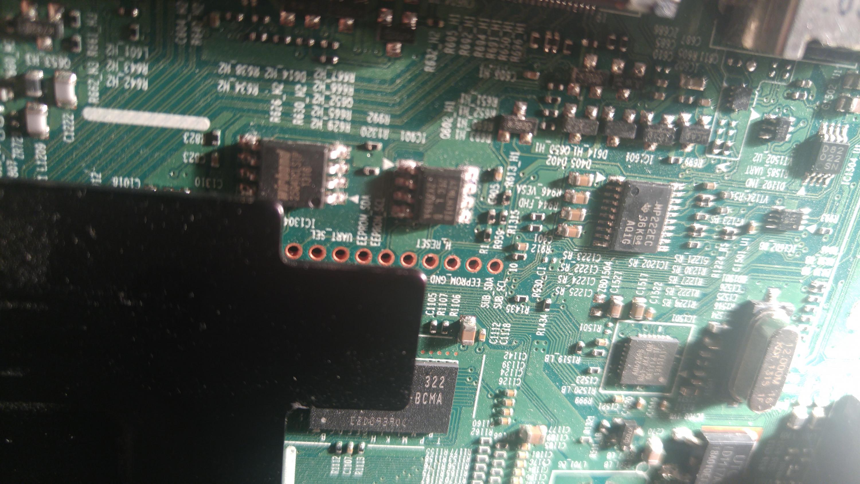

                              got to have fun this morning with the camera on the lg g4, i also saved and up loaded shop jimmy !
                              i tried getting the best shot of the part numbers
                              don't think of it as just helping me but any person who comes accross this.
                              there is these other main board eprom repairs and possibly we can start one.
                              if i have to i will buy another main board and extract the eprom to try to repair this one then upload it for the community.

                                after poking around to find abnormality's i found that there is a corrsion / white substance that was bridging connections on the atmlh eprom, scraping it away did not fix all the pins to ground. i really think i have a shorted eprom or circut and my next step would be to pull it off to test,the solder joints look bad anyways.
                                  Normal for several pins on that device to be at ground.
                                  Worth checking CN9999 next to the processor on the left. Might be a test pattern jumper. Try jumpering it with a 100 ohm resistor (just in case it's not this will limit current).

                                    i will try to look for CN9999 but don't think there is one.
                                    the 4 big holes at the top left at zcn2014_ld are the control board test pattern pins.
                                    shorted 3&4 with just a wire and stated in a post earlier that i got a good pattern but continued to reboot loop.
                                    i think pins 6 and 8 of atmlh need to be shorted while powering set on for 20sec.
                                    there is also h reset pin but what method should i use and how.
