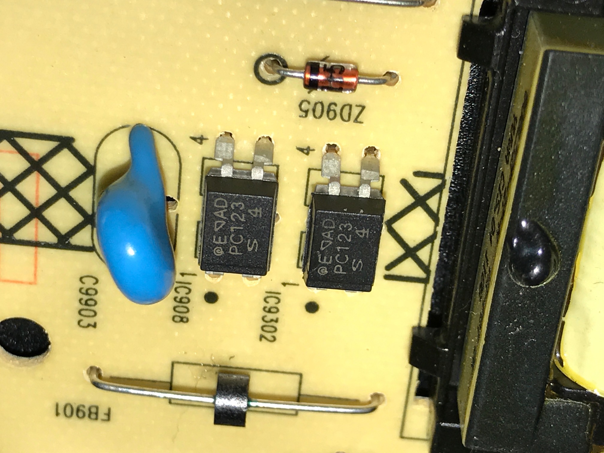

        I didn't test the original inverter again before removing the main. I did just put all orig boards back in, nothing. Then put the new power in, nothing. Left new power in and put in new inverter, nothing.
        So I think I need to take a further look at the IC. These are them correct? Is there a way to test the pins to see if it is truly the issue? Even if the TV does not come on?
