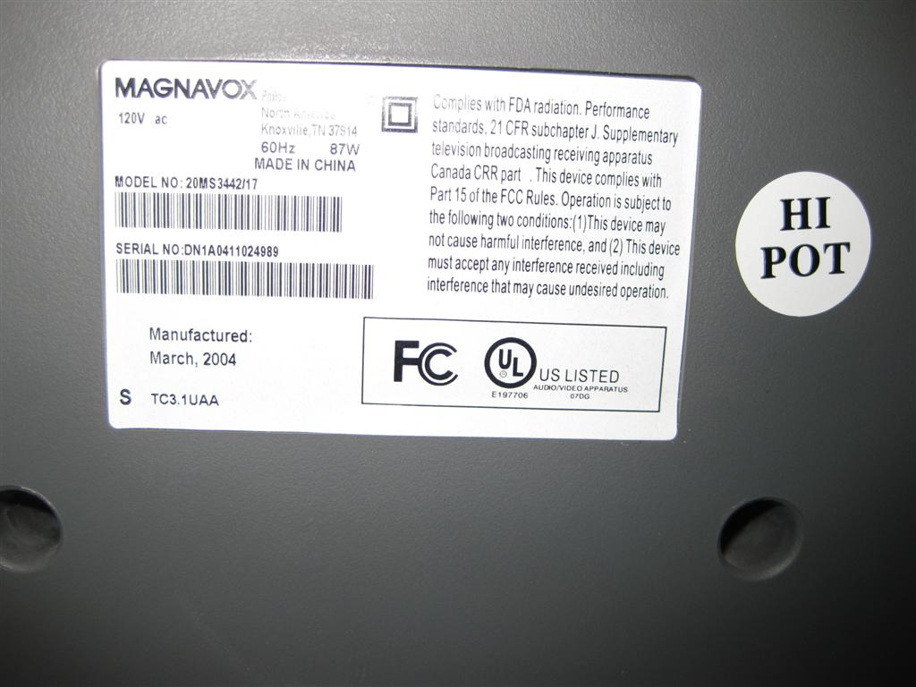

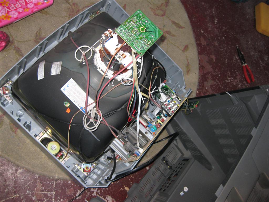

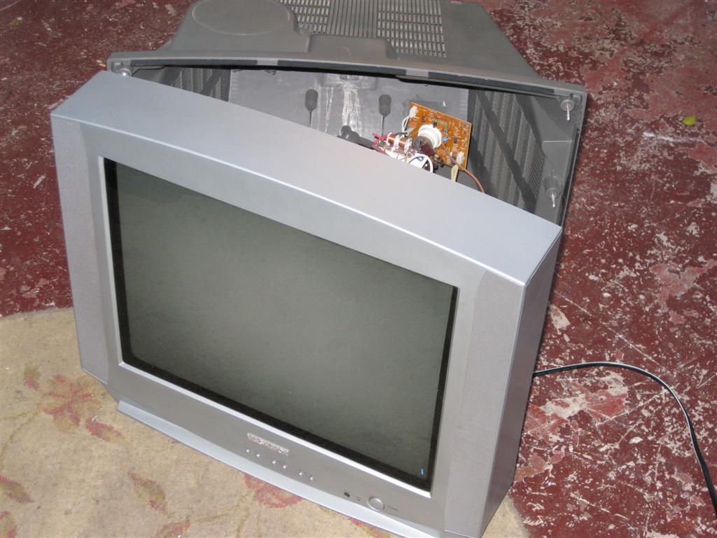

    Found this by the side of the road. It works, but often starts turning itself off, then on, then off, then on, then off, then on.... etc. etc. Also remote doesn't work. Any ideas?
    Chassis has crapcaps.

        I actually left it outside dissasembled for two days and was planning to throw it away tonight, but when I got home I found it playing nicely in the kitchen! Turns out my dad went through and dusted the chassis then put it back together and it's been on for about 4 hours without turning off. He thinks maybe some setting in the microprocessor was corrupted and letting it sit unplugged for a while cleared the memory, just like our old Sanyo would do sometimes (it would start flipping channels on its own). That could be possible, or maybe marginal crapcaps, or I was thinking maybe a dirty relay. Whatever the case, it's a nice TV and we're keeping it. If it starts acting up again I will clean the relay and start testing caps.
        EDIT: Also, the remote worked the whole time. I noticed it was only the volume buttons that wouldn't work, and this was before it fixed itself, but I forgot to come back here and edit my post. My dad took the remote apart and cleaned that too and now all the buttons work.
