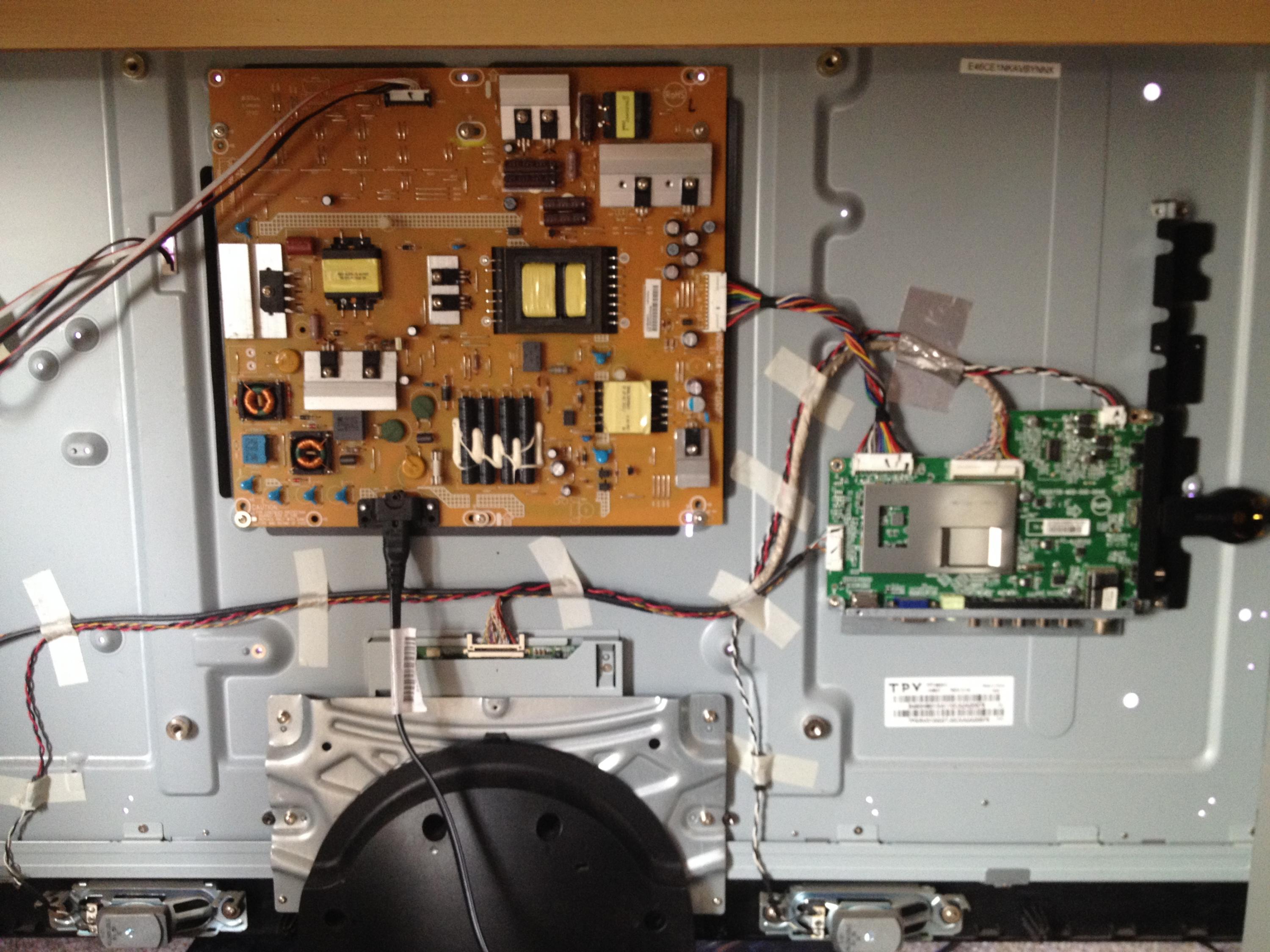

    I picked up an Insignia NS-46E340A13 TV yesterday. The original owner says the TV sometimes takes minutes to hours to turn on and it's been in their garage for 6 months.
    I searched the forum for this particular model number. Looks like there are two threads, but neither have their issues resolved (one guy didn't post any information, and the other guy never replied after declaring the EEPROM could be bad).
    This morning, I got the TV to boot after 3-4 power cycles. I took the back panel off and observed the following:

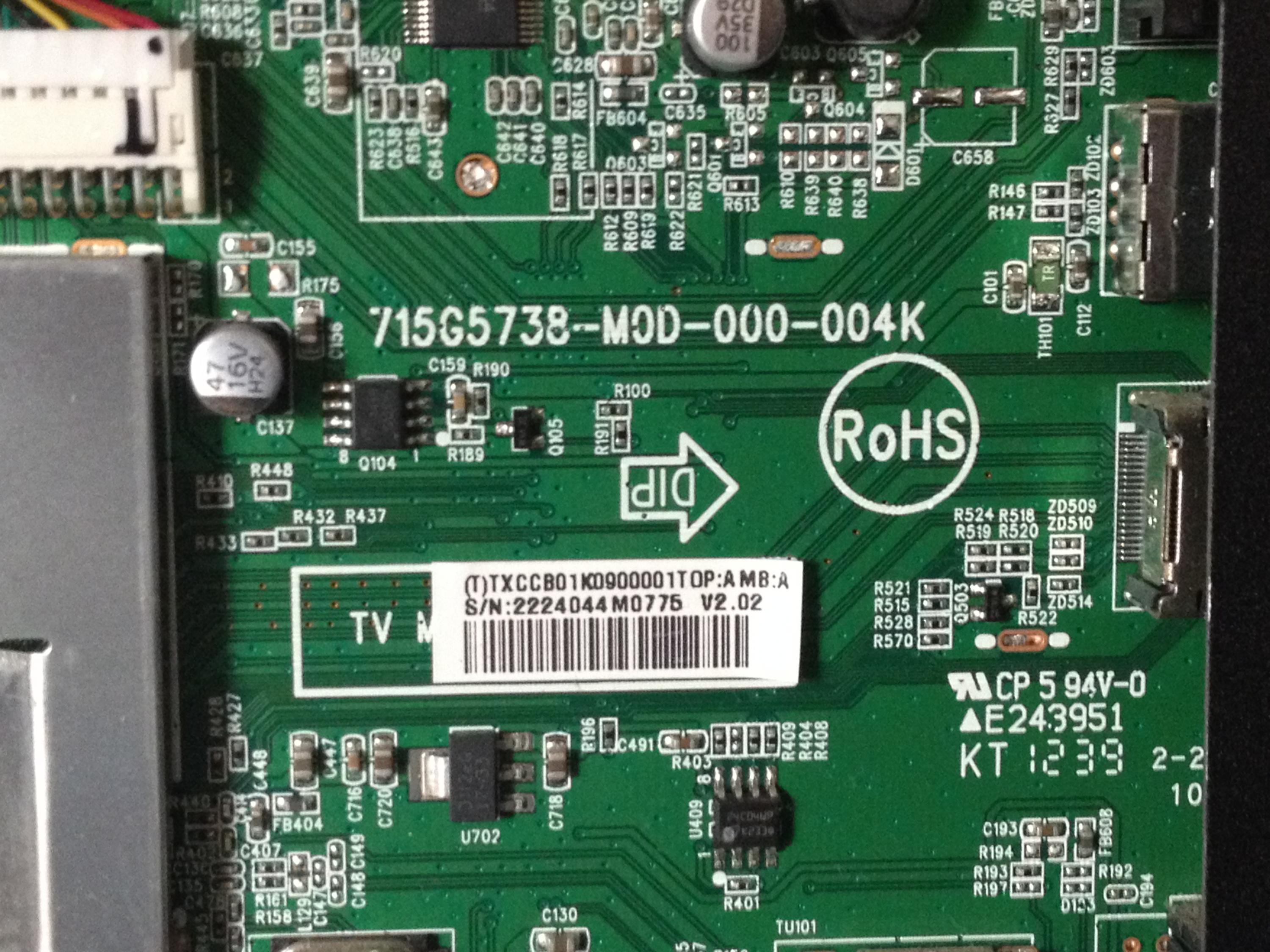

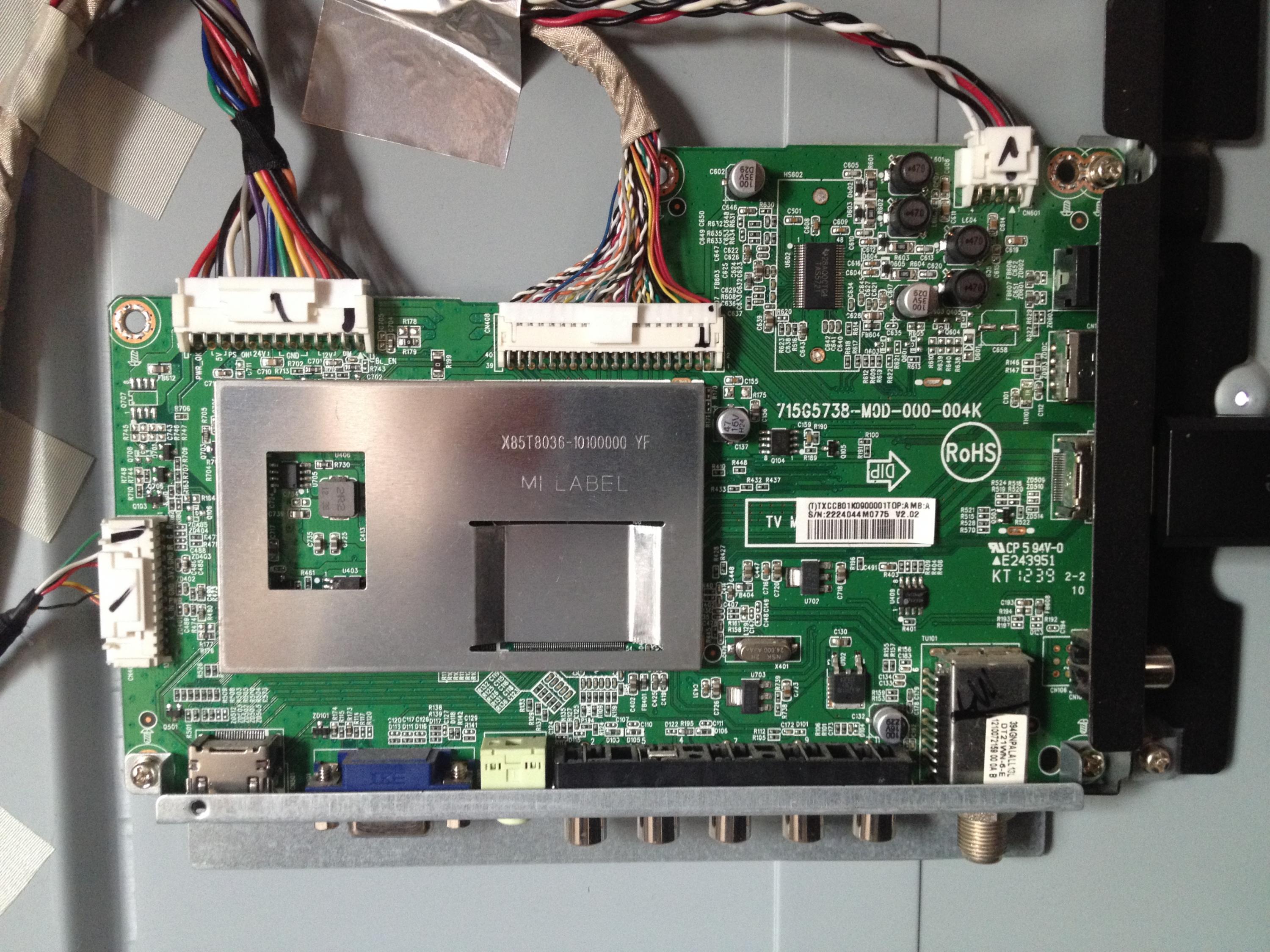

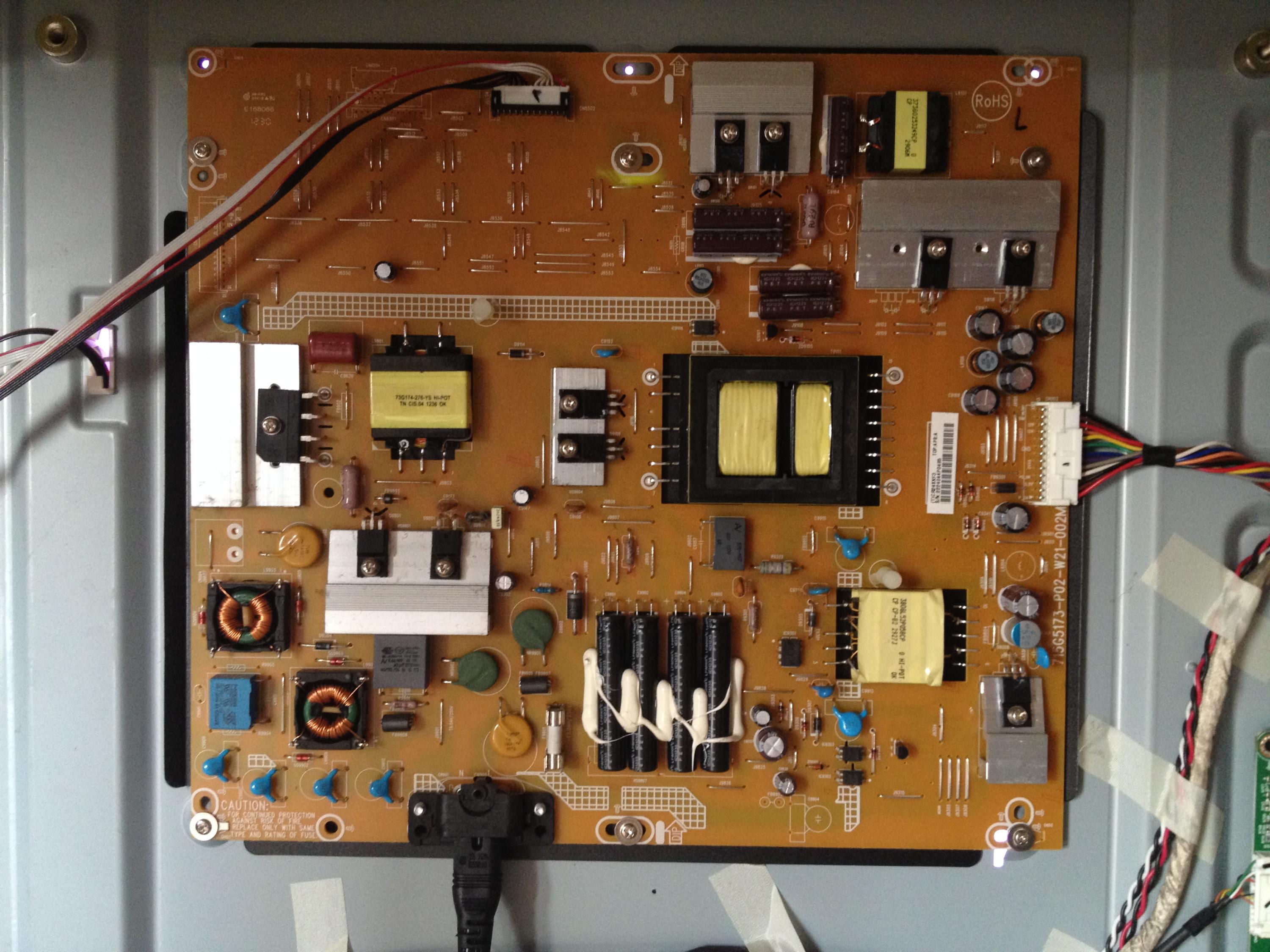

    Power board: 715G5173-P02-W21-002M / (T)CR248XF3
    Main board: 715G5738-MOD-000-004K / (T)TXCCB0K090000TOP:A MB:A v2.02
    (see photos)

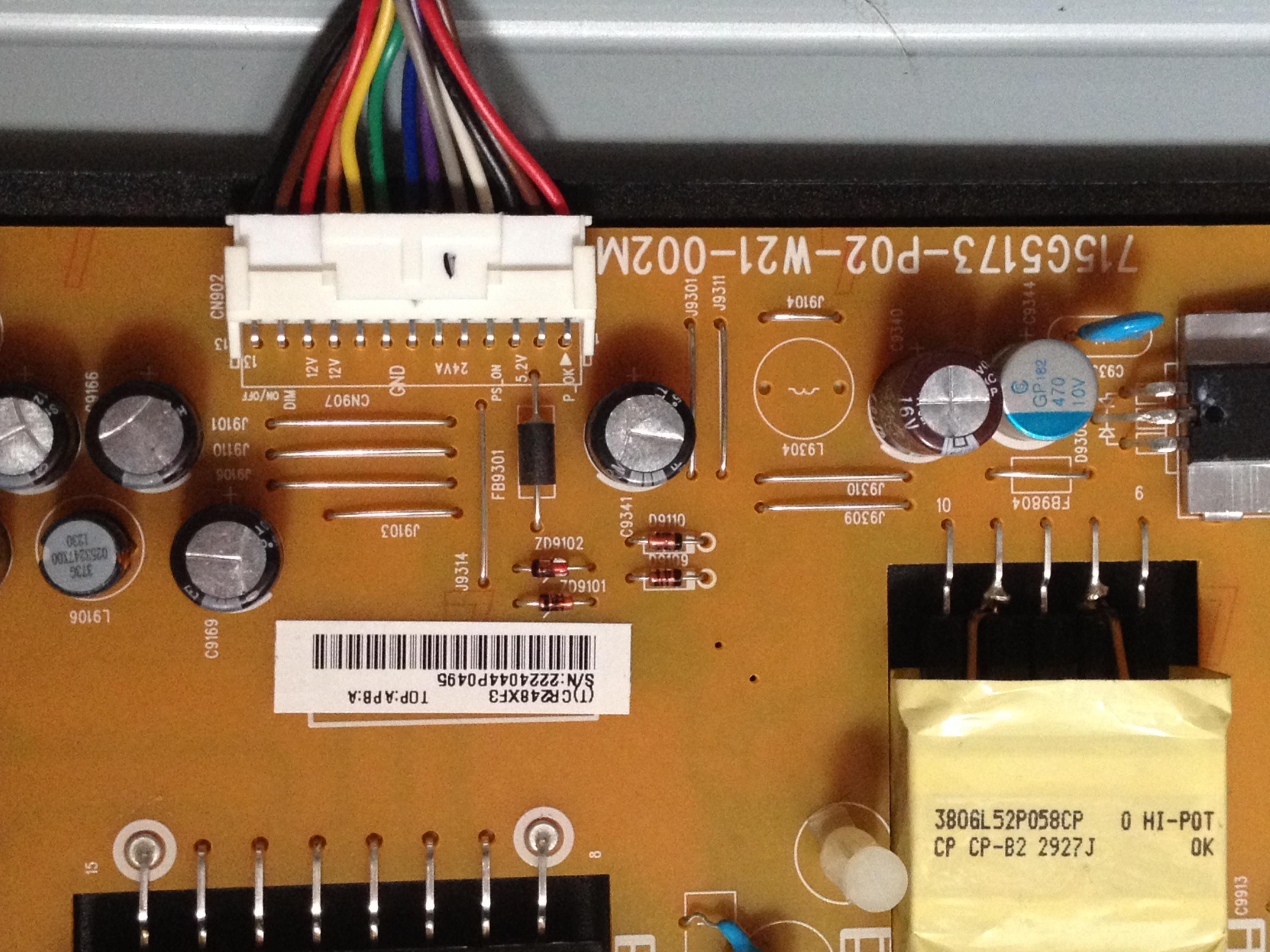

    8. Interestingly enough the P_OK signal stays low. Is the P_OK signal indication active low?
    The full list of voltages observed on connector CN902 are as follows (as observed from top to bottom when the board is installed):
    • CN902: (Volts)
    • ON/OFF 4.7
    • DIM 2.56
    • 12V 12.39
    • 12v 12.39
    • GND 0
    • GND 0
    • GND 0
    • 24V 0
    • 24V 25.02
    • PS_ON 5.16
    • 5.2V 5.23
    • 5.2V 5.23
    • P_OK 0
    Its interesting that the P_OK signal is sitting at 0V.. I would have expected this signal to be active high vs active low. Any ideas here?

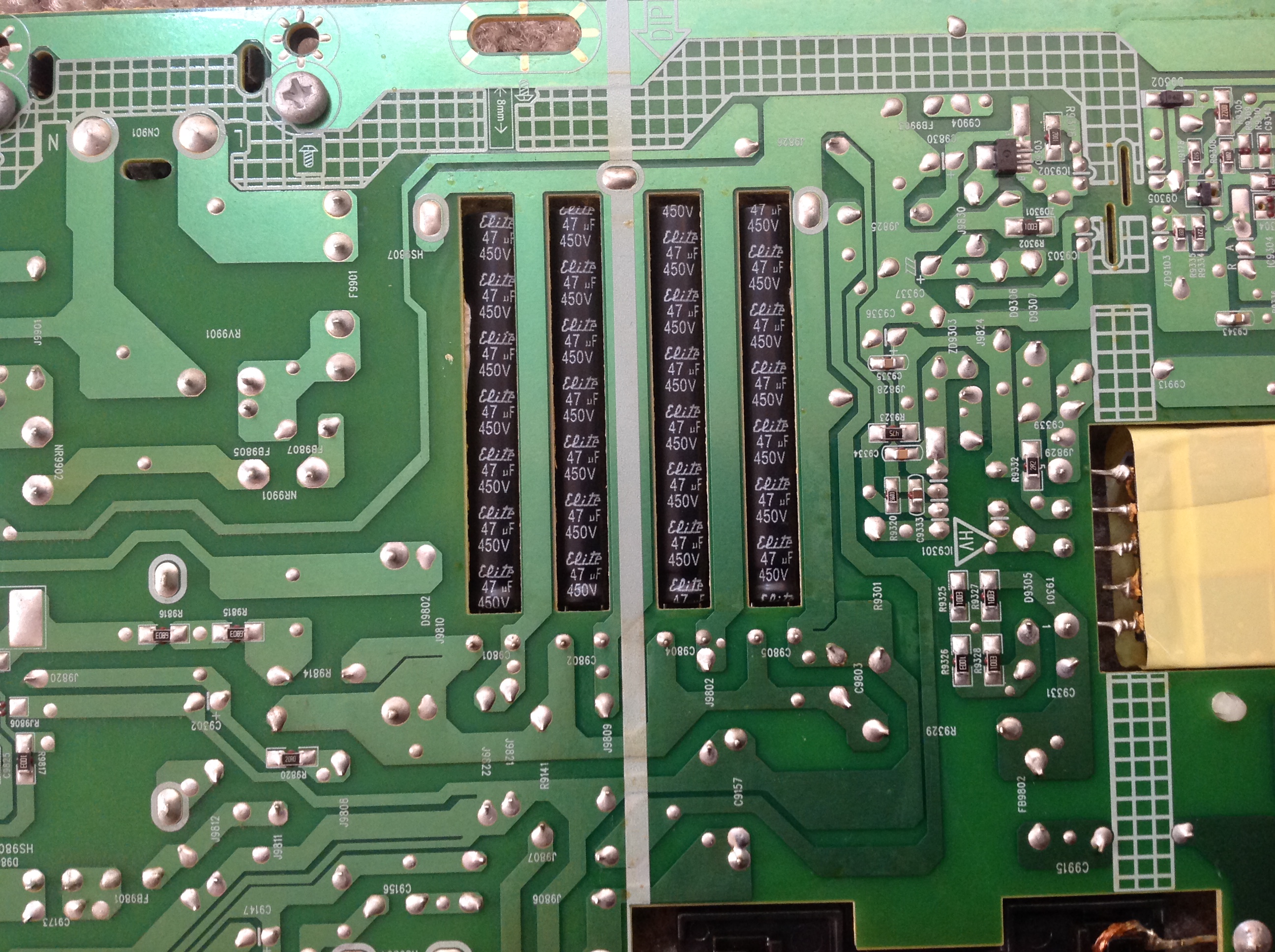

    What is voltage across one of your main caps when you press power button? Do you have an esr meter. Sounds like cap problem.
    • ngth82
      • Jul 2015
      • 541
      Re: Insignia NS-46E340A13
      I read 386V across the main caps (C9801, C9802, C9804, C9805).
      Is this a common failure among Insignia displays? I just haven't worked on these TV's much since they are the "$100 throw away when broken" type.
      No, I do not have an ESR meter, but I'll end up purchasing one. Looks like they can be purchased for around $13 or so. I'll post back with ESR results when I have results in hand. Alternatively, I may just spring for a replacement main cap set.

                I don't know if P_OK is like ac detect. May try freezing optocouplers

                          I don't have a picture of the backside on my phone (took it on my ipad).
                          As i recall, the caps are Elite branded 47uF 450V caps -- the labels said PET (C)1245 105degC. I can follow up after work.
                          -Thomas
                            Confirmed. Main caps are Elite branded 47uf 450V
                            -Thomas
                            I'm a hardware engineer focused on networking equipment for my day job. I void warranties and fix consumer electronics for fun.
                                Actually, I meant the smaller caps as those are more likely to fail.
                                  I will have to check this on Wednesday. The low voltage output caps physically look okay... but I'll check the markings and report back when I get a chance to. A new project landed on my desk at work and I haven't had much time to devote to this TV.
                                  If the lower voltage caps are suspect, i definitely have a lot of low ESR caps at my disposal in the parts box On a side note, my ESR meter arrives Monday.
                                    The smaller output caps on the right are 330uF 25V caps. Funny since the same caps are used for Cbulk on the +24V rail. The capacitance measures around 340uF with my DIMM. The ESR meter arrives today (yay!) so i'll measure the ESR of each cap. I would suspect they are good. I tried replacing the output caps with what i had laying around (a couple of low ESR ruby con 470uF 50V caps) but the TV behaved the same way -- taking multiple attempts before turning on.
                                    Does anyone out there have a service manual or set of schematics for the power board or the main board? I think it's time to dive in and debug this at a component / trace level.

                                      A couple of updtes:
                                      The power-ok signal is not connected to anything on the power board. I didn't trace it on the main board though.
                                      I received my ESR meter. The output caps have 0.09 ohm ESR. as a comparison, a known good 10 mOhm ESR cap reads as spec'ed.
