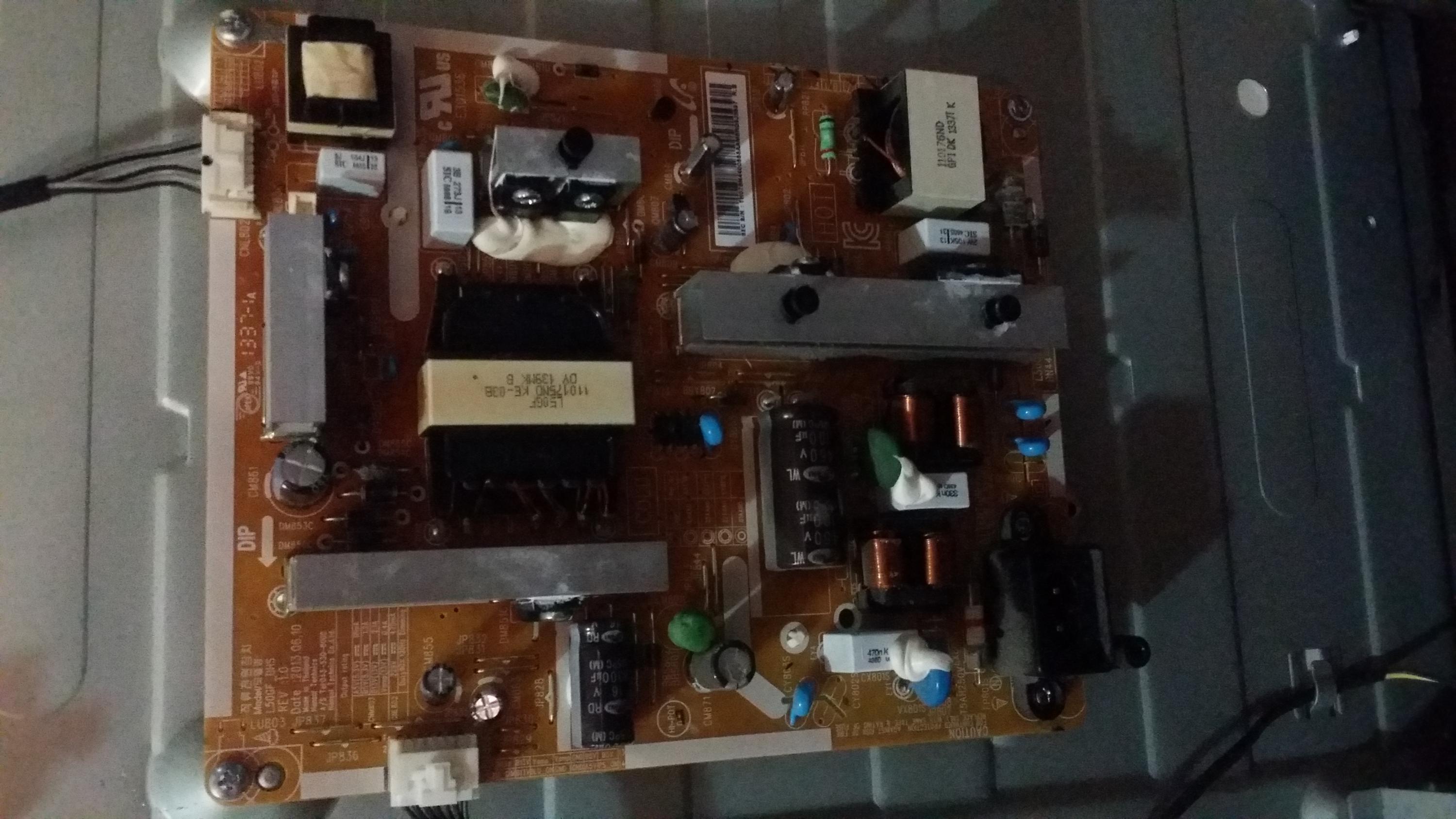

    samsung un50eh5300f
    having problems with this led the tv turns on flash light test done I can see menu but no backlight I check volts but seem outve wack. i see two test points for leds and if i touch one test point cross it over and touch one of the black wires on led plug they light up what should the volts be at led plug anyways

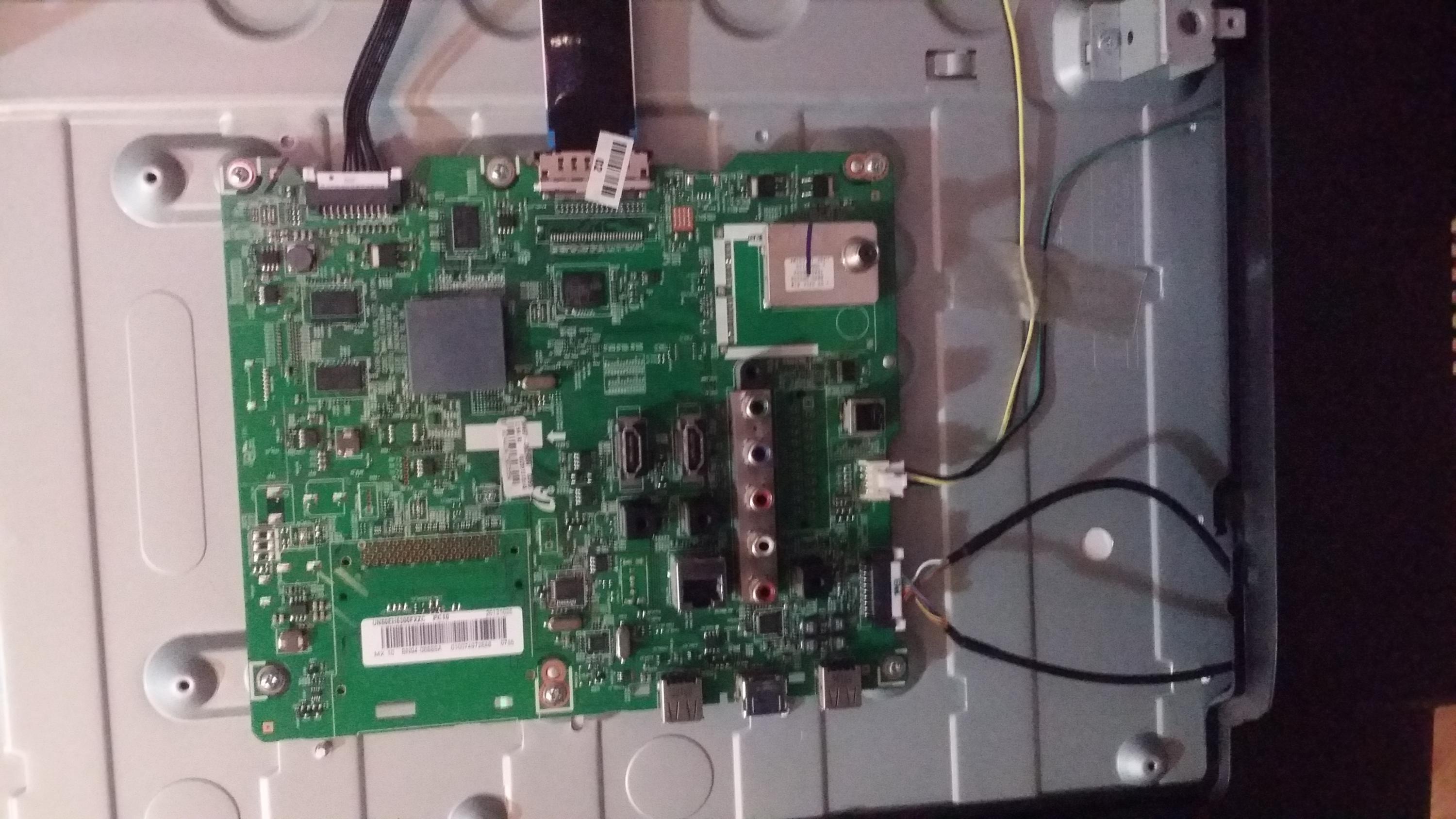

    Need good clear straight on pictures of back of tv with cover off and each board.

      i just measured volts to led plug and im getting around 113volts to the gray wires
        Re: samsung un50eh5300f
        1) TV is OFF.
        2) Keep the black probe of the meter on the chassis GND.
        3) Keep red probe of the meter on the first pin (top pin of the connector based on your picture: https://www.badcaps.net/forum/attach...5&d=1500943915) of the LED connector
        4) Keep an eye on the meter and then turn the TV on, see how high the Voltage go up to and then wait for about 10 seconds to see how low it goes down to, record that reading. Turn the TV off.
        5) Move the red probe down to the seconds wire and repeat the same test again. You will do that on all six LED wires.
        BTW, what is the power board P/N? BM44-??????

          board number is bn44-00668a
          pin1 116v off 2v on
          pin2 109.04 off 7.4v on
          pin3 109.4v off 2.2v on
          pin4 107v off 6v on
          pin5 112.5v off 6v on
          pin6 230v off 340v on
