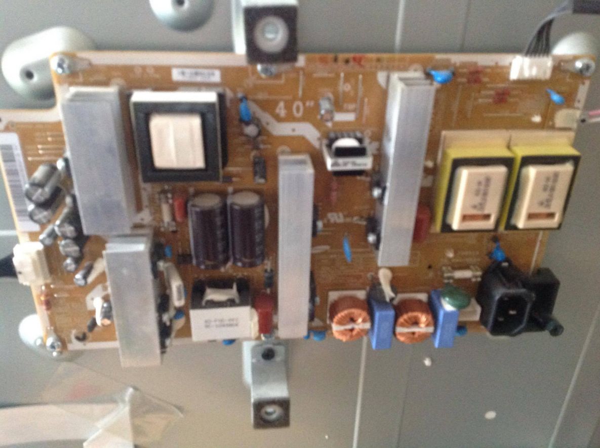

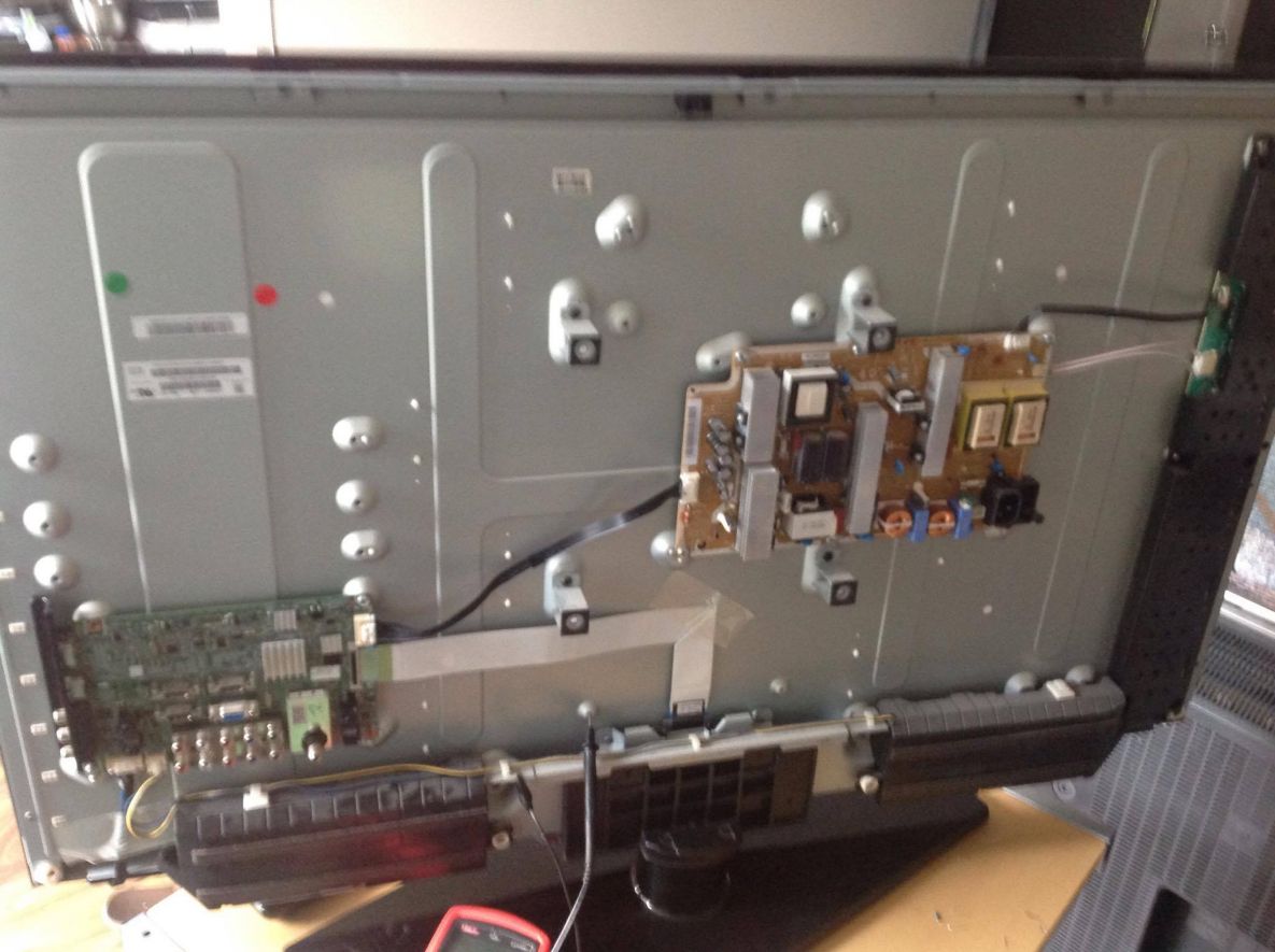

    Hi i have a samsung LN40C540F2F i want to fix.when i put the power plug the red light flashes 6 times stops and remain like that.

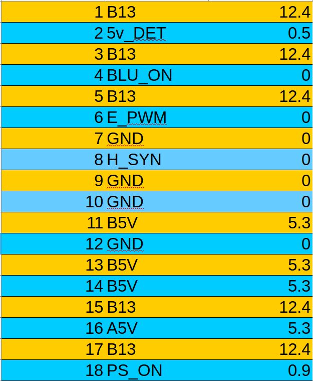

    i took the unit apart and measured the voltages ( see picture)
    the powerboard seems to be good according to the voltages and no bulging caps.
    the backlight is working fine if i unplug the connector between the PSU and the mainboard ( saw this trick online with this particular set)
    i suspected the mainboard not sending the PS_ON voltage (0.9V), but i have read a post here in this forum a guy had 0.8V and the tv was working fine.
    i'm leaning toward the mainboard, but i would like to have your input please
    thanks in advance

    Re: LN40C540F2F 6 blins then dead unit
    your ps-on is most likely good. some of these newer sets only need around .8v
    you are missing your back light on signal though, so your issue will be main board.

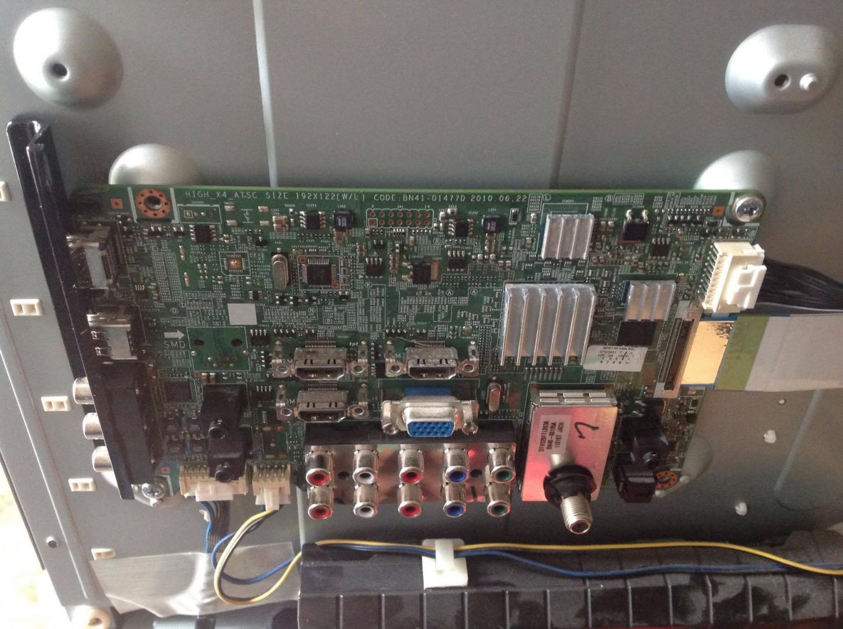

      when i remove the connector between the mainboad and the PSU i get the backlight and the pin BLU_ON is pulled high (5V).
      i'm planning to fix the mainboard, because i have fixed a few of them on the past.Hopefully, the problem is not coming from a chip, otherwise it's fixable.

                  While monitoring ps-on and pushing power button you get no change
                  • kgavionics
                    • Apr 2017
                    • 152
                    PS_ON remains 0.9V no change.
                    i checked the mainboard with my oscilloscope and i can't see any activity ( no wave forms),the only wave form i have is the crystall sine wave of 24 MHZ.so either the maincircuit is not working ( it's a BGA chip maybe a reflow can solve the problem) or it's not biased corrctely due to a bad component ( voltage regulator , diode, transistor..)

                          Common main board voltages: 1.1v, 1.8v 3.3v 5v 9v 12v 15v
                          Should be a number of voltages to check
                          • kgavionics
                            • Apr 2017
                            • 152
                            i've measured 1.8V,3.3V,5v and 12V,but never came across 1.1V,9v and 15V.i'll test again and report back.

                                I tested pretty much all the semiconductors and they seems alright.
                                So, i went and heated the mainboard for 1min on the oven and guess what,the tv worked on time only.grrrr!!!!
