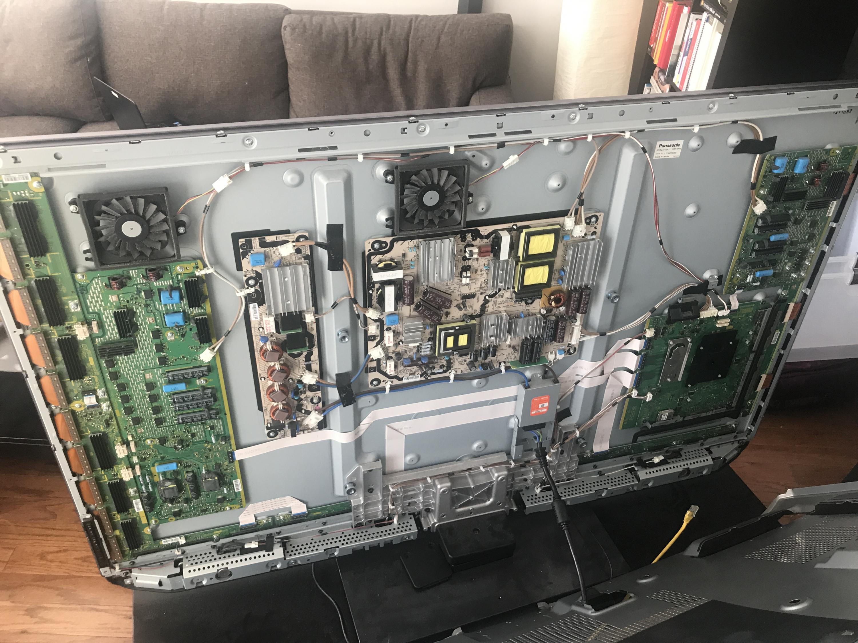

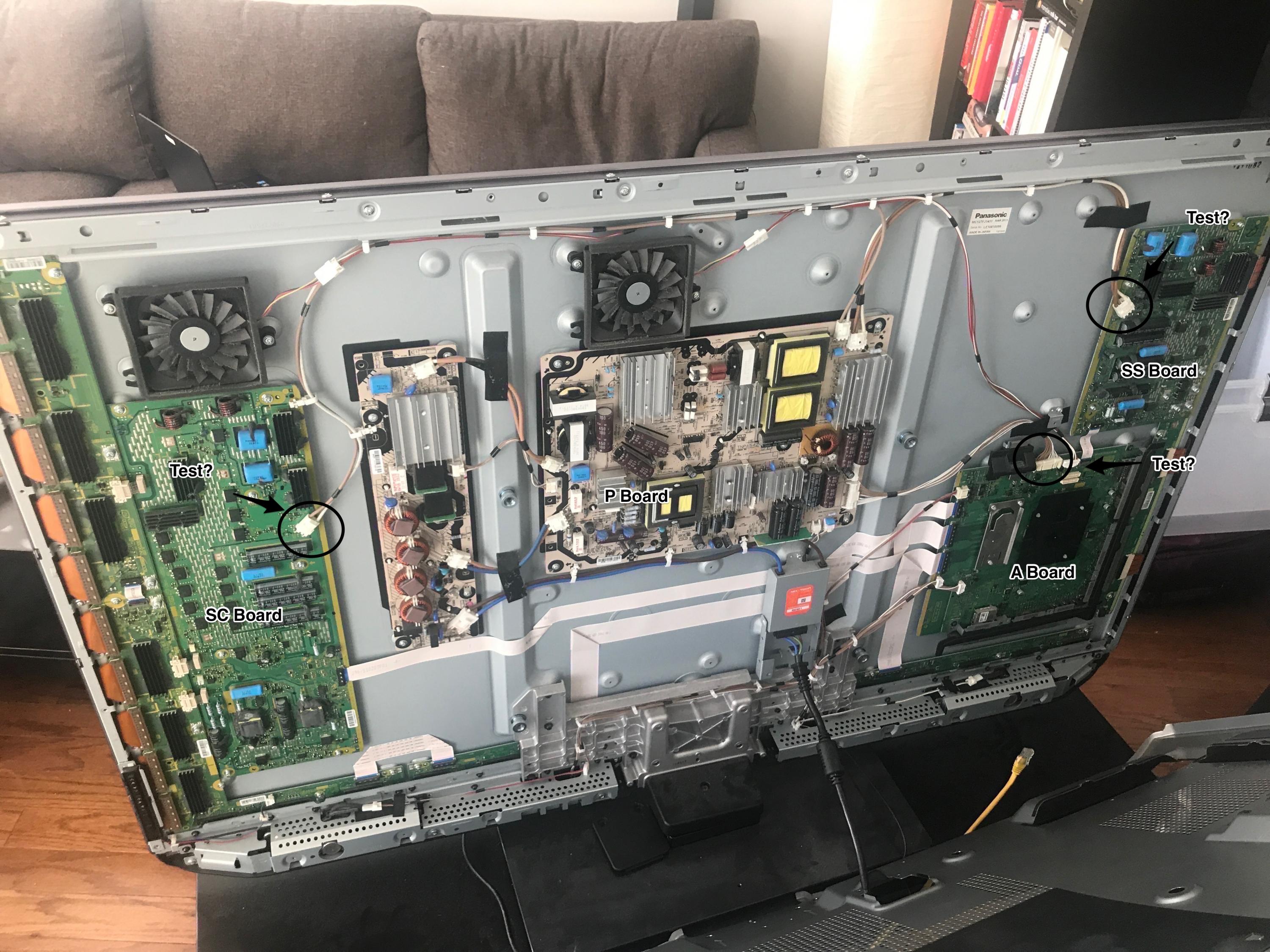

    Hi, I have a 2011 Panasonic P50GT30 plasma. A week ago I went to turn it on and it won't respond to anything. I've read a lot of other posts saying flashing lights will tell you what's wrong, but no lights come on at all. It sounds like it is some sort of power or main board problem (not SC, SD, or SU boards?) but I don't know how to verify that and what to do if it is. I appreciate any help.
    I'm attaching a picture of the boards. I have detailed photos of all the boards if needed.
    Thanks!

          Re: Panasonic P50GT30 won't turn on?
          Thanks. I had a look at this and went through the flowchart. It says to first test the SS board (4pin (P15V)), then the SC board (TP82 (P15V)), and then the A board (13 pin (P15V)).

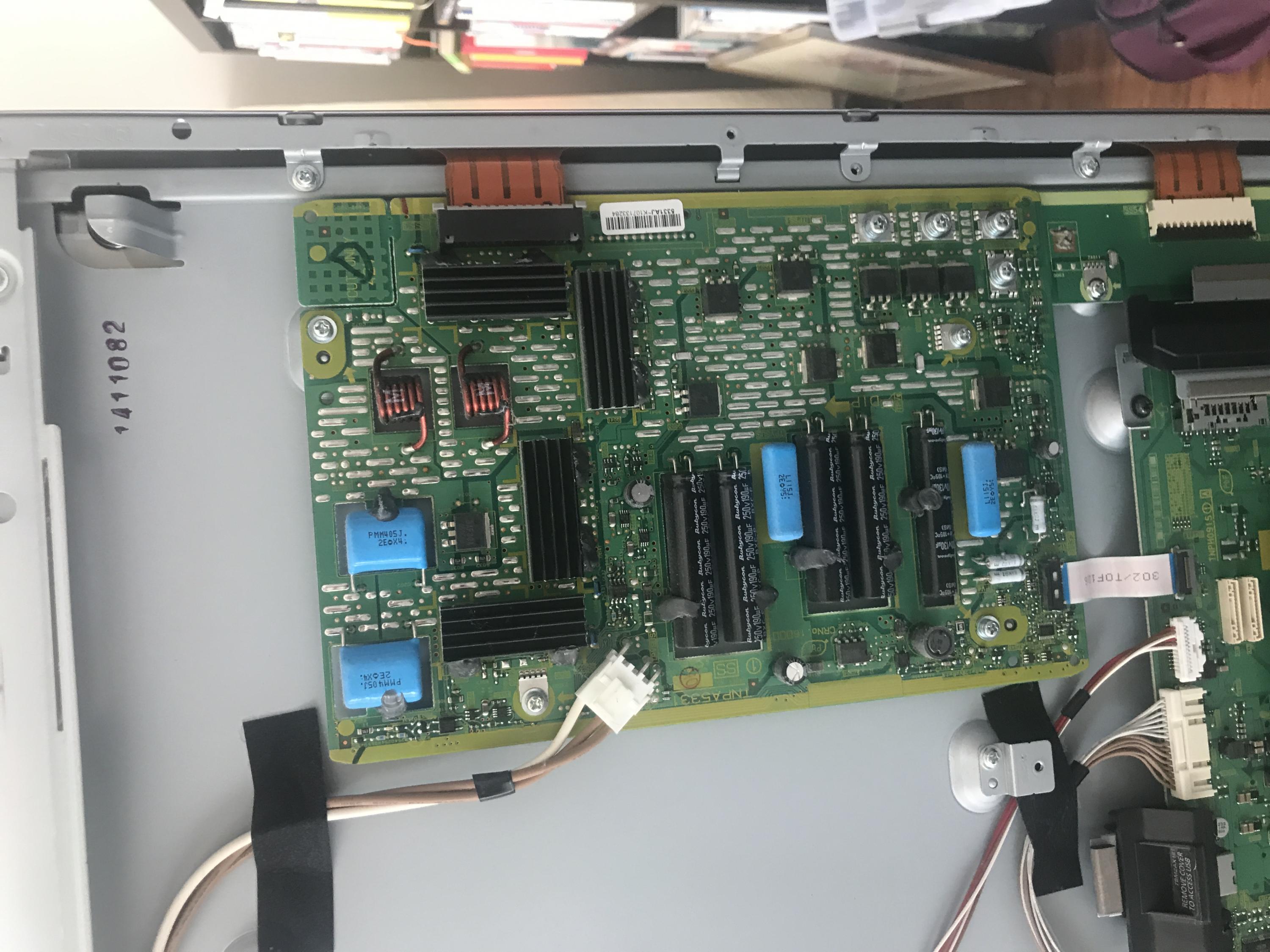

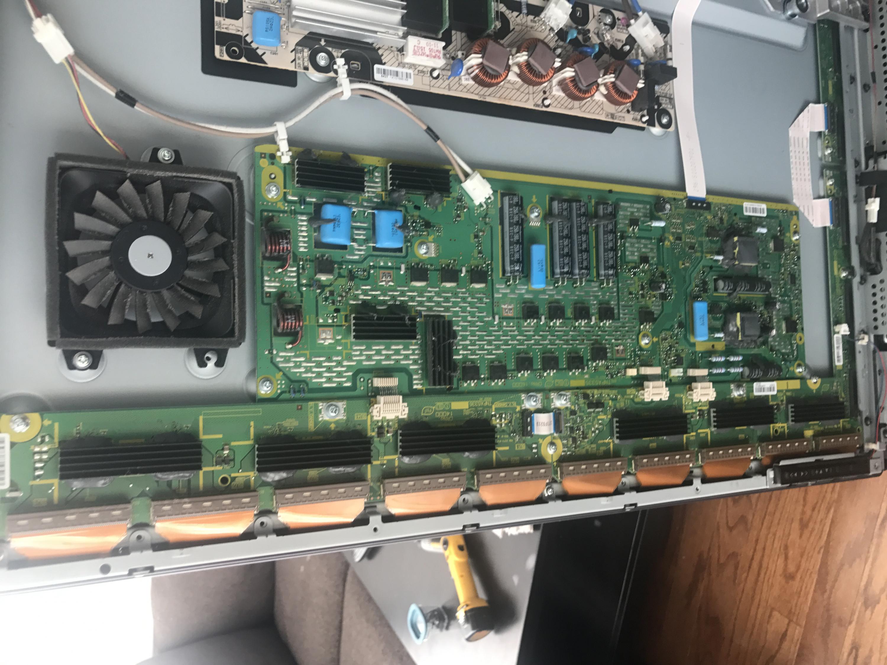

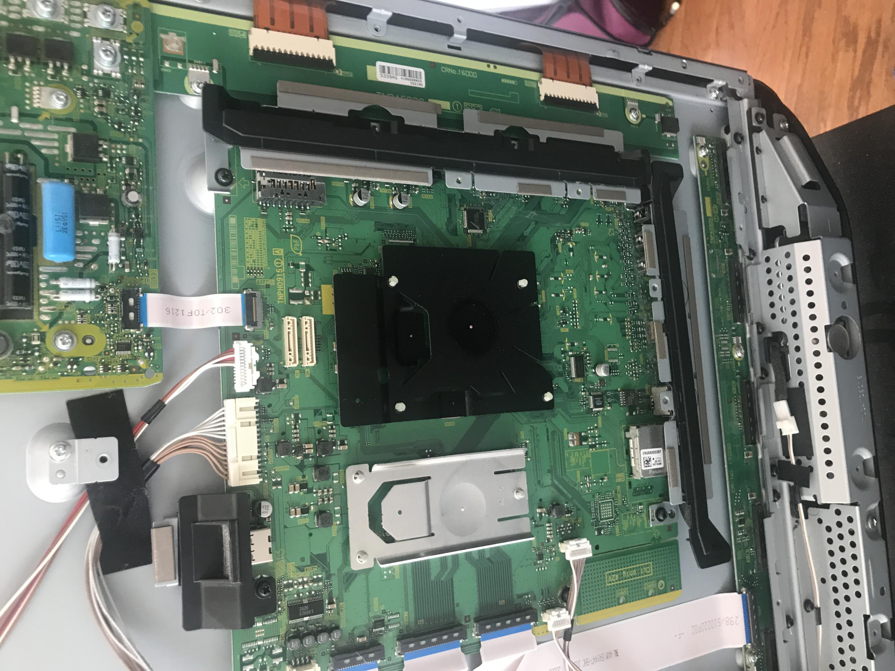

          I think I've identified the right sockets to test (they all go back to the P board). I've identified them on the attached photos. Do I have the right ones?
          Also attaching detailed shots of the three boards (SS, SC, A).
              I'm a total newbie doing anything like this so it's taking me a bit. I tested all of the fuses on both the P and P2 power supply boards. Used a multimeter on the diode setting and it beeped for each of them. As I understand it, that indicates they are good (not open). Also, I don't know that I can remove them, but I tested them while in the boards, which I believe is fine?
              I also tested the power coming into P2 and then going from P2 to P and it was 120v for both.

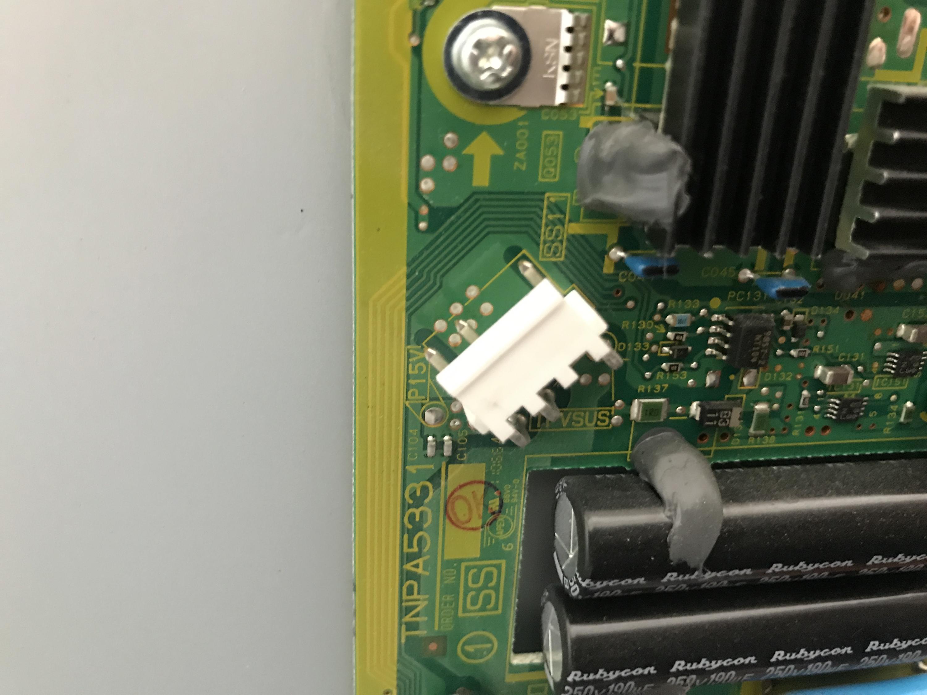

              Following the guide from tom66, it says to "Disconnect SS11. Does SS11's 4pin (P15V) short to GND?" I found SS11 and disconnected it but I'm not entirely sure what this means to do. Attached is the schematic and a picture of it on the board.
              A few questions regarding these directions:
              1) I'm assuming I should have the TV plugged in for this test?
              2) If everything is working, I'll get a readout of 15v (that's what the P15V means?)
              3) I'll place the black end of the multimeter on the metal backing that the boards are screwed into and then the red part on what? The pins for the connector on the SS board? Or the pins on the inside of the cable that I unplugged from SS11?
              4) "Short to GND" would be getting a 15v reading? That indicates power is getting to the SS board but the SS board isn't working?
              5) Edit: There's also a little label on the board next to a solder point that says "P15V". Is that of any meaning to me?
              Sorry for such basic answers. Have a lot to learn. Appreciate all the help!

                    1) I'm assuming I should have the TV plugged in for this test? No
                    2) If everything is working, I'll get a readout of 15v (that's what the P15V means?)maybe but TV wouuld have to be on and working so forget that thought for now
                    3) I'll place the black end of the multimeter on the metal backing that the boards are screwed into and then the red part on what? The pins for the connector on the SS board? Or the pins on the inside of the cable that I unplugged from SS11?pin 4 and gnd. you are checkking to see if it's shorted at the board
                    4) "Short to GND" would be getting a 15v reading? That indicates power is getting to the SS board but the SS board isn't working?If there was a short to gnd on the board, yes that indicates a board issue.
                    5) Edit: There's also a little label on the board next to a solder point that says "P15V". Is that of any meaning to me? A P15V test point ( 15volt supply) you could probe that to gnd for short.
