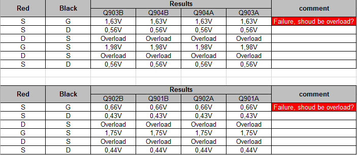

    I would check all the mosfets/diodes around those IC's. The 4 above and the 4 below the IC's
    see attachement
    I'm not realy sure, if the mosfet's are defect, but normally there should be overload between Source and Gate, isn't it?

      MDHT4N20Y & MDD7N20C
      Check between the Drain and Source, set powered off and with your meter in diode mode and you should see a diode reading one way and open circuit when you swap your meter probes around. There should be no short circuit between any of the pins of the mosfets.
        As I've already measured in one way 0,56V, the other way "open circuit" and no short circuit.
              Missed this tabled.
              Testing in circuit can give those readings but you have no short circuits and D-S check out OK for each of them so they look fine.

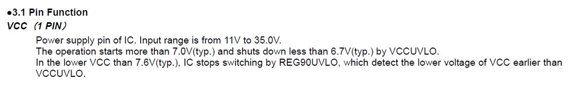

                  With Reg90 at 0V this disables the Gate1 & 2 drives and also Dimout1 & 2 drives. So something is switching off the Reg90 supply. What voltage is on UVLO (Pin 17).
                  Unfortunately without the power supply schematic I don't know what the AS358 function within the circuit is.
                    Pin 17: +5,66V

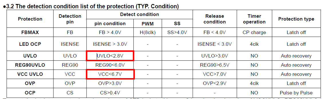

                      I find the data sheet confusing but I think it says that VCCUVL should be >7.0V and that the IC shuts down when VCCUVL <6.7V

                        I think the detection condition table is more meaningful.
                        Reading it, I think we have no Problem.

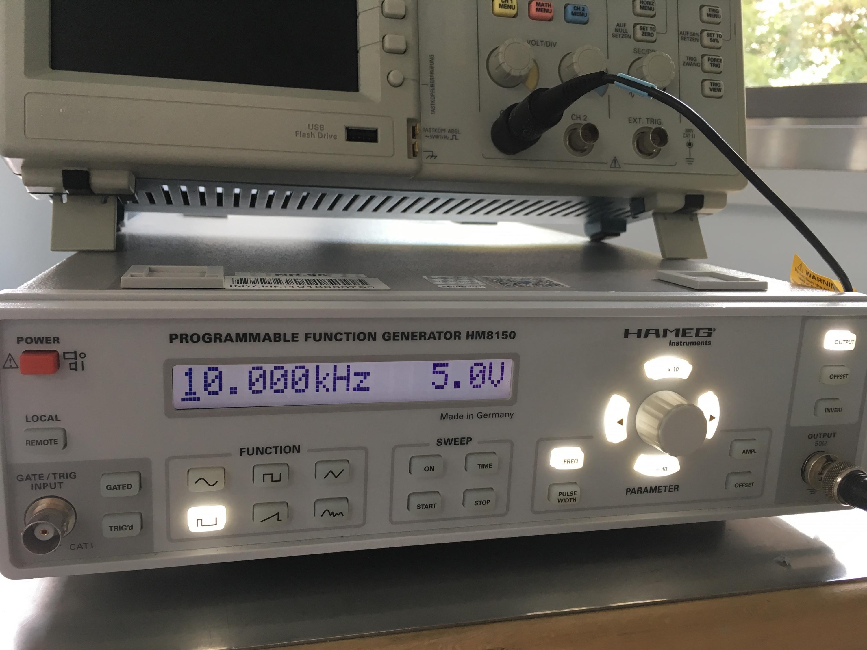

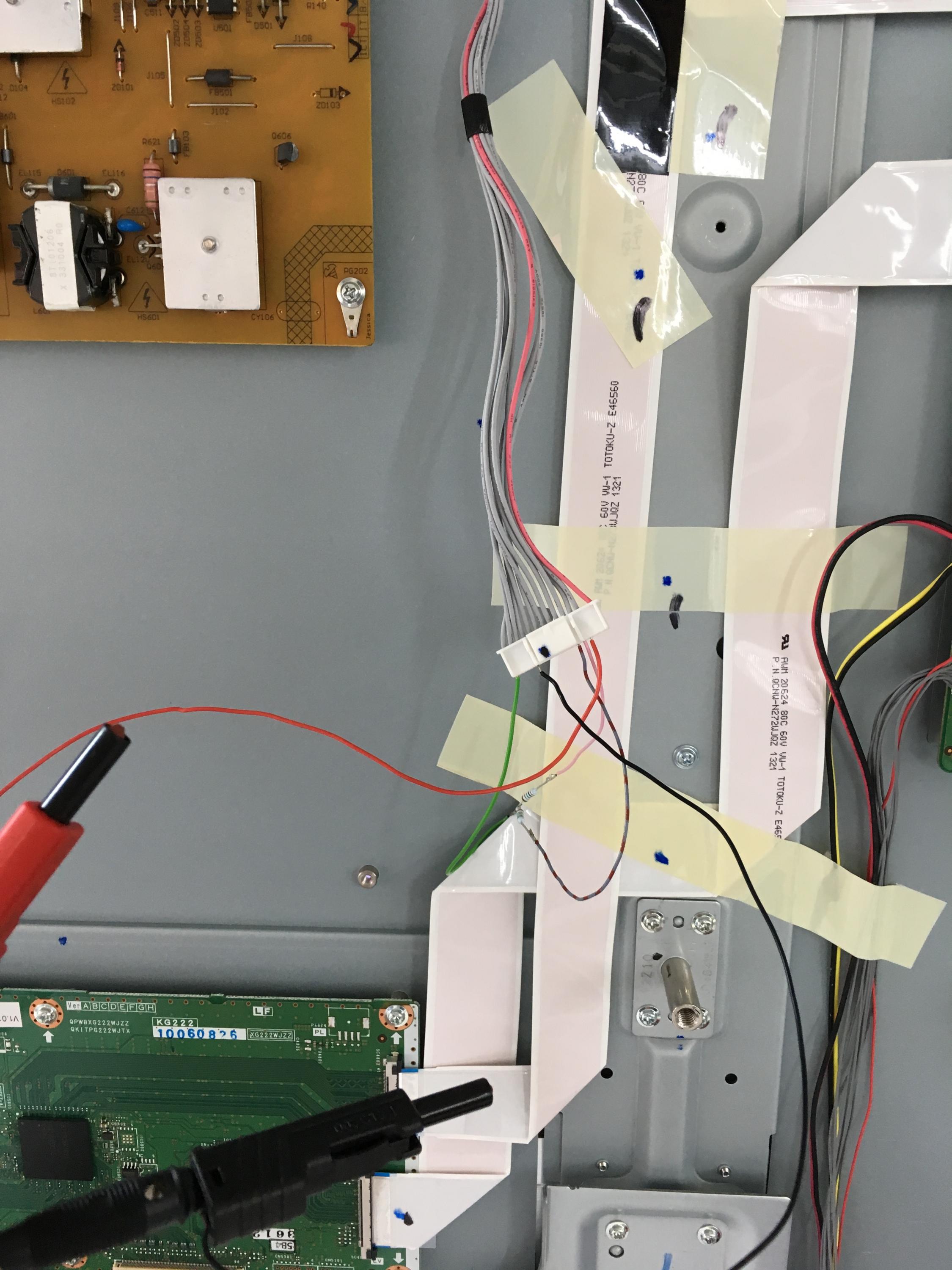

                        btw. - I measured the PWM1-Signal with my Oszilloscope, which should come from the Mainboard, but no Signal. So as I stated earlier, I think the failure is on the Mainboard.
                        What do you think and do we have a possibility to search on that board?

                          Could you try and jumper PWM1 & also PWM2 of one of the IC's to 5V using resistors and see if that clears the fault condition for that IC. Again with the mainboard disconnected and the other jumpers in place.
                          Data sheet does say PWMx = H; 2.0V to 5.5V

                                  OK, I connect my frequency generator to PWM1 of the connector, comming from mainboard + the other jumper in place.
                                  Settings are: puls-signal, f=10kHz, V=5V
                                  And as I switch on, the LED-stripes are lightning
                                  So now we can definitely say, that the PWM1-signal is missing from the mainboard.
                                  What do you think? Is it possible to search and find the failure, or do I have to buy a new mainboard?

                                    This was an interesting piece of troubleshooting. It does appear as though you were correct and that without PWMx signals the Led Drivers stay latched off. If driving them externally brings them on then that rules out the Led Driver IC's or the leds as being at fault.
                                    It does looks very much as though your diagnosis that the mainboard is at fault is correct.
