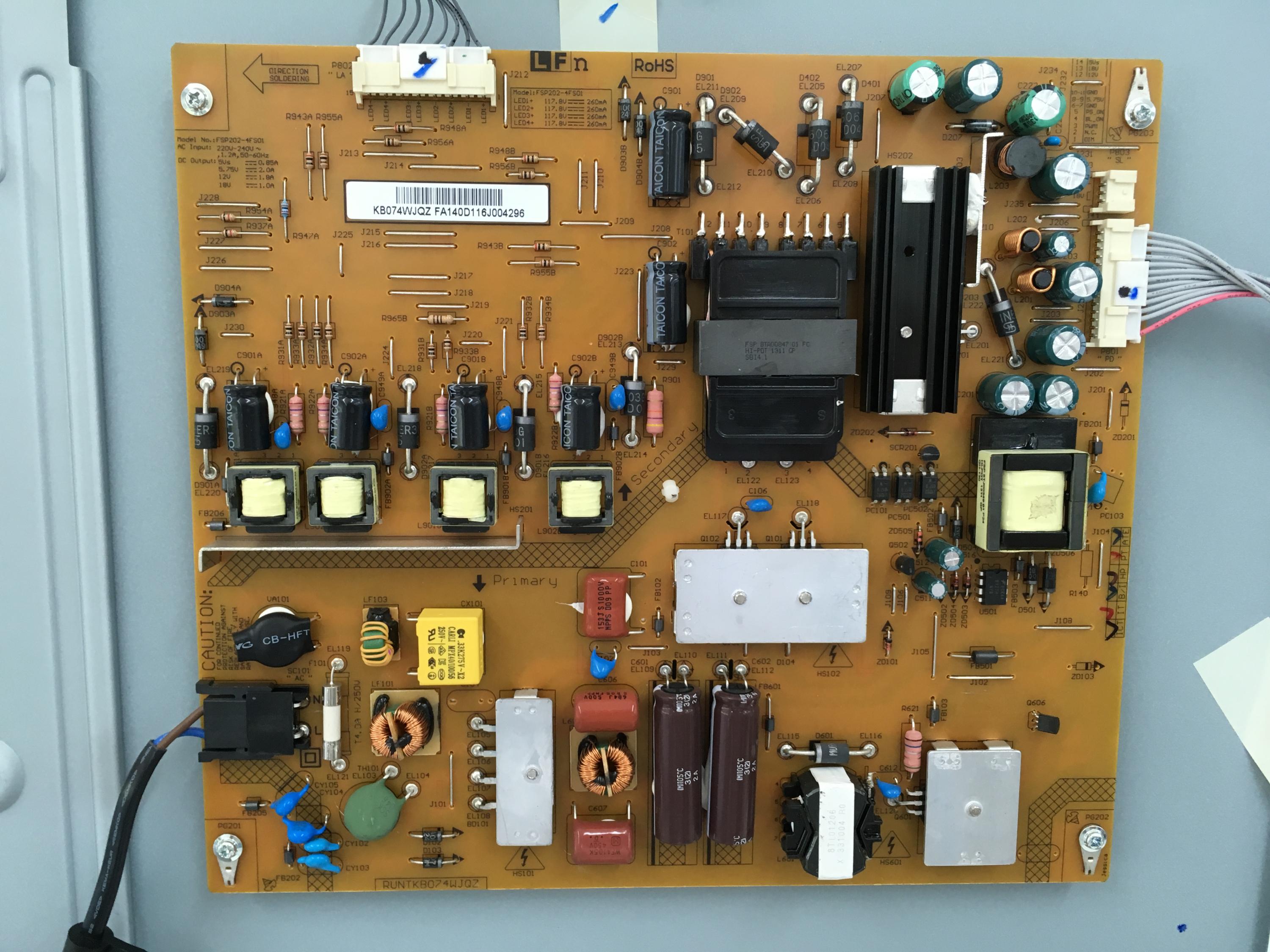

    Hi there,
    I've a problem with a Sharp TV.
    If I plug-in, only the turned "V" lights blue steadily. I cannot switch into stand-by, not with the power sensor button on the front, not with the remote control. Remote control ist working because if I press a button the "V" starts to flicker. If I connect my laptop via HDMI, no picture and no sound appears.
    Following actions I did, but had no effect:
    - hold VOL down and INPUT buttons at the same time, then press POWER
    - measure all voltages on the right connector of the psu
    >result: can measure all voltages with a dvm, except PS_ON, BL_ON (0V), PWM1 and DIM, because not knowing what to expect)
    - measure all voltages on the top connector which supply the backround LEDs
    >result: no voltages between LED+ and LED-, but if I disconnect and drive the LEDs with an external psu, the LEDs are working
    - measuring all diodes on the psu
    >result: all diodes are OK
    - looking on all capacitors
    >result: seems to be OK, nothing is bloated
    Any idea?

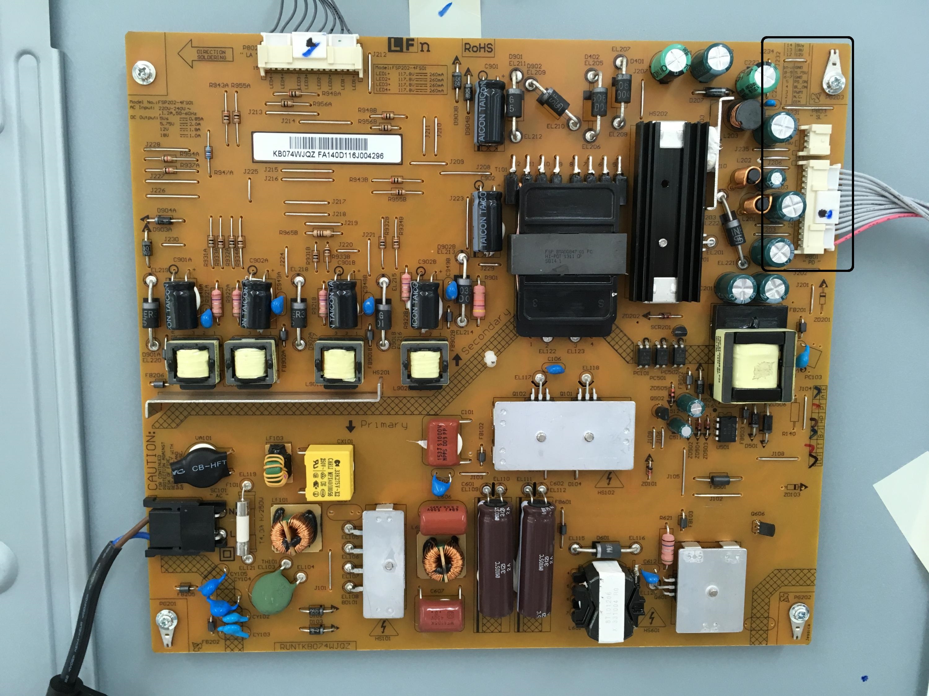

    A good start is to give the voltages on the connector. The label for the pinout is at the top of the photo.
      Re: Sharp Aquos LC-60LE652E - Blank screen, no sound, steady blue LED
      OK, here we go:

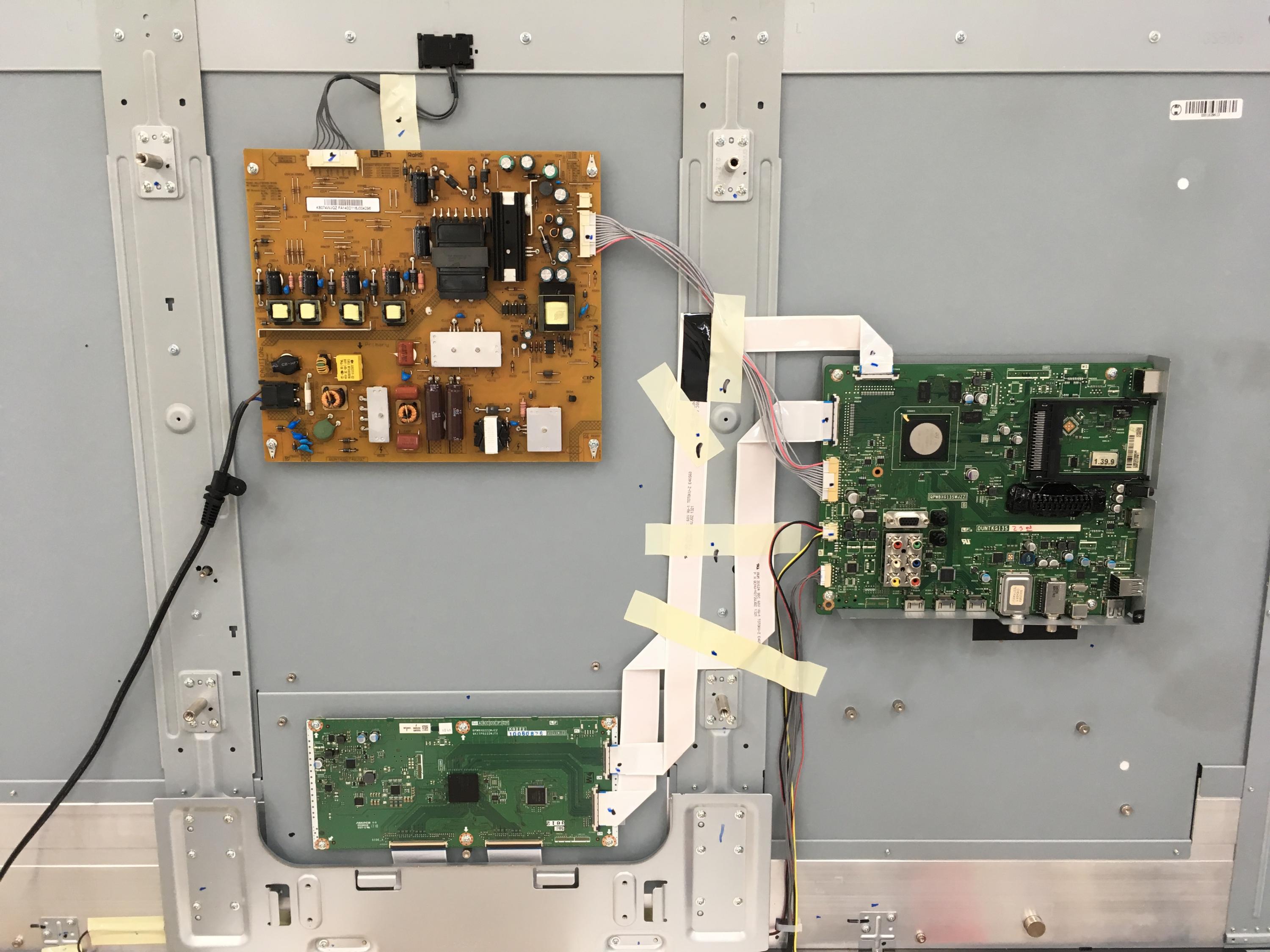

        You have no backlight or DIM voltages so the backlights won't come one. You should have sound and be able to see a picture using a bright light source (torch) shone onto the screen and looking carefully.

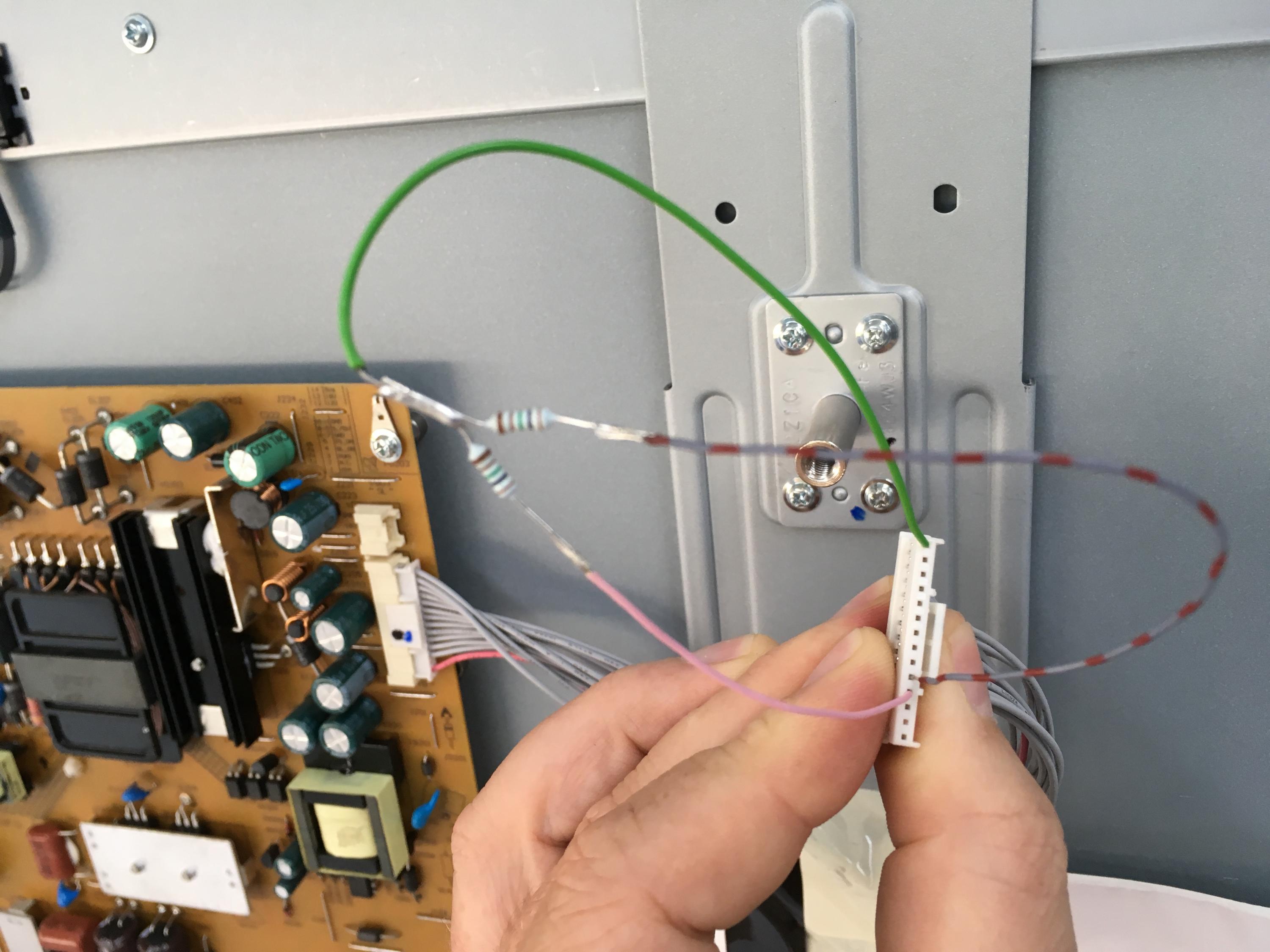

        If you disconnect the main board and power up, do the backlights come on. If not I would with the mainboard still disconnected, jumper the 5V standby to BL_On using a 1K resistor and a second 1K resistor to jumper 5V standby to PS_ON and see if the backlights then come on.

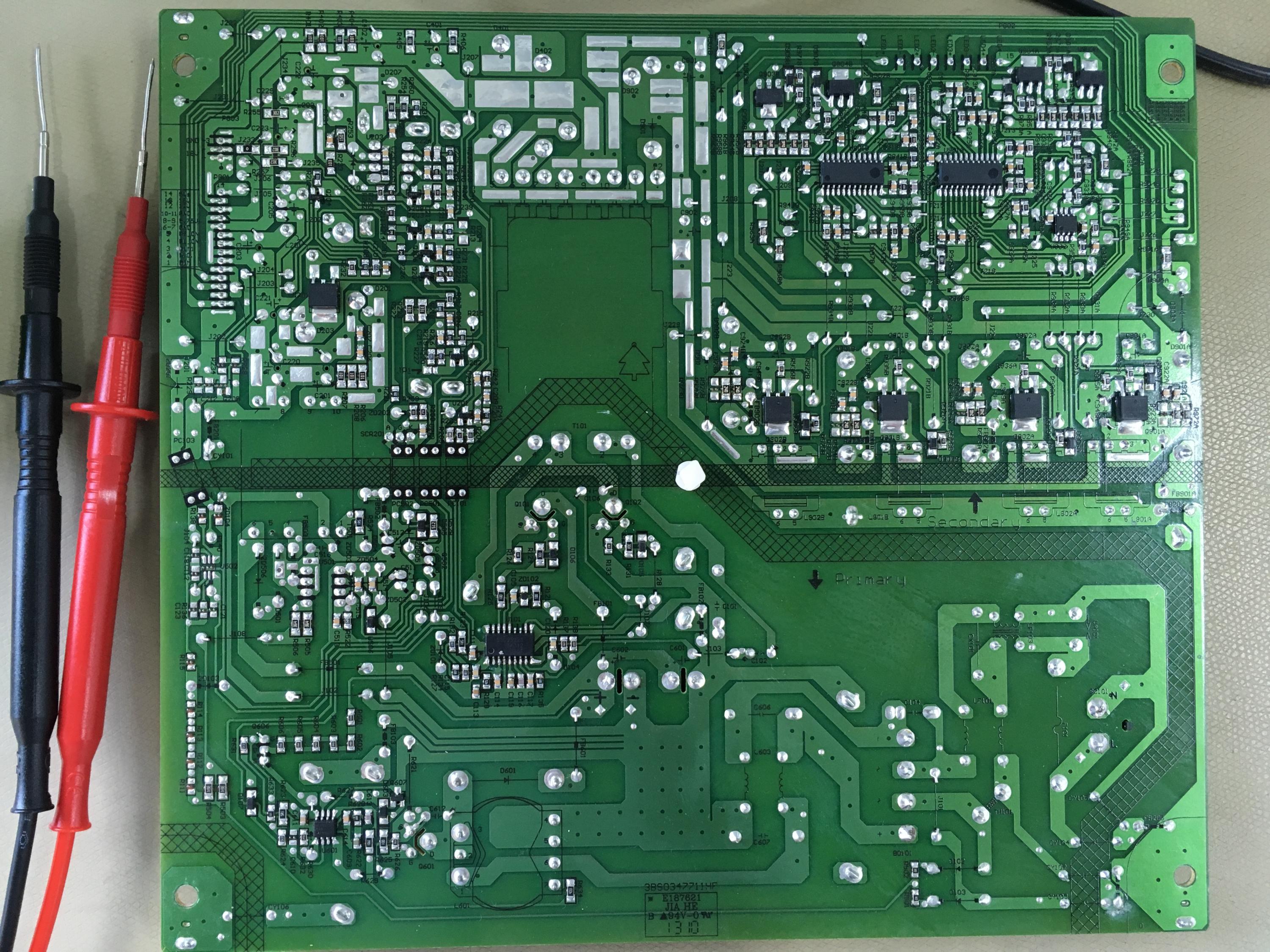

          Second issue "jumper...." I've done (see photo).
          After jumpering I can measure 5V on BL_ON and PS_ON, but no effect, so no
          backlight.
          Also the voltages on LED1+/LED1-, LED2+/LED2-,... are 0V.
          Further suggestions?
            What value do those resistors (above photo) measure with your meter?
            When you initially power on and come out of standby what voltage do you have on the led connectors. Initially it may peak and then drop suddenly.
            If no voltage then with the power off, check all the diodes with your meter set to diode mode.
            Can you post a picture of the underside of the power supply.

              Both 1kOhm, as you suggest.
                The colours in the photo look like brown, grey, green, black, silver

                  All diodes have about 0,46V forward voltage, except the 1N... . They have about 0,6V (that's normal).
                  D402 and D401 have 0,2V and D207 0,3V.
                  Is attached

                    OK, the value of resister is brown, black, green, brown, brown -> 1050 Ohm

                      What are the IC numbers as given on the IC's

                          the ICs U901A and U901B are both BD9483F (White LED Driver for large LCD
                          Panels - DCDC Converter type).

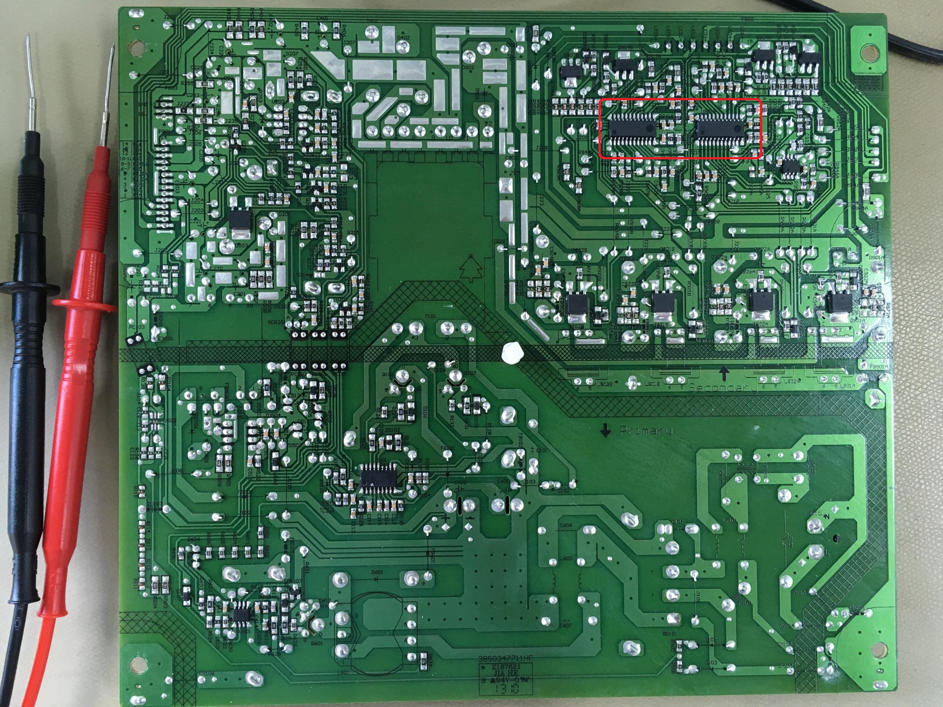

                                    What voltage do you have on Pin1 of the two IC's BD9483. The data sheets says between 11V to 35V This is with the jumper resistors in place as described in an earlier post.

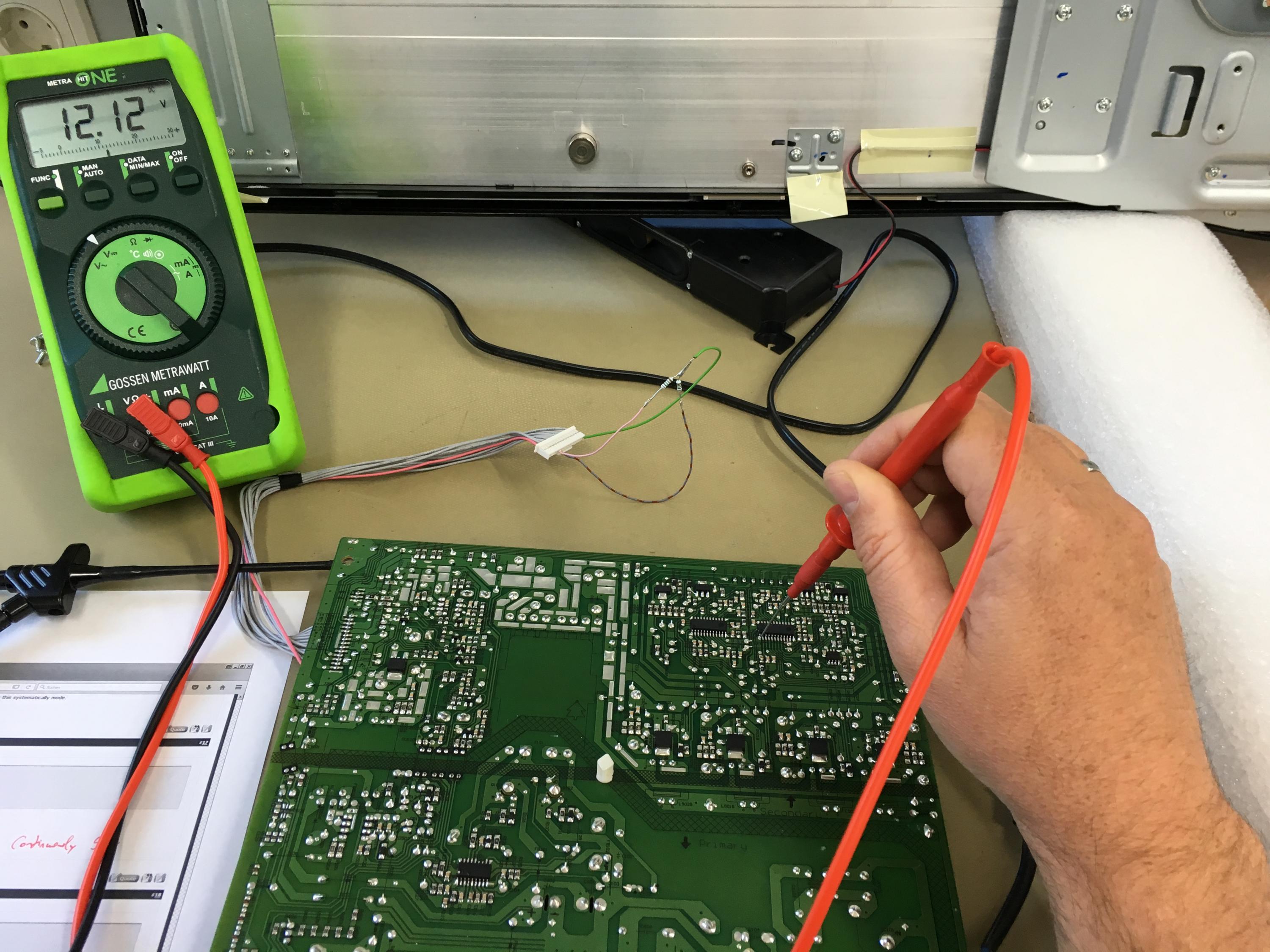

                                      I measured 12,12V on both IC's Pin 1.
                                        12V is within the operating voltage range for those IC's
                                        What voltage do you have on Pin 2 of each of them which should be >2V
                                        I would check all the mosfets/diodes around those IC's. The 4 above and the 4 below the IC's
