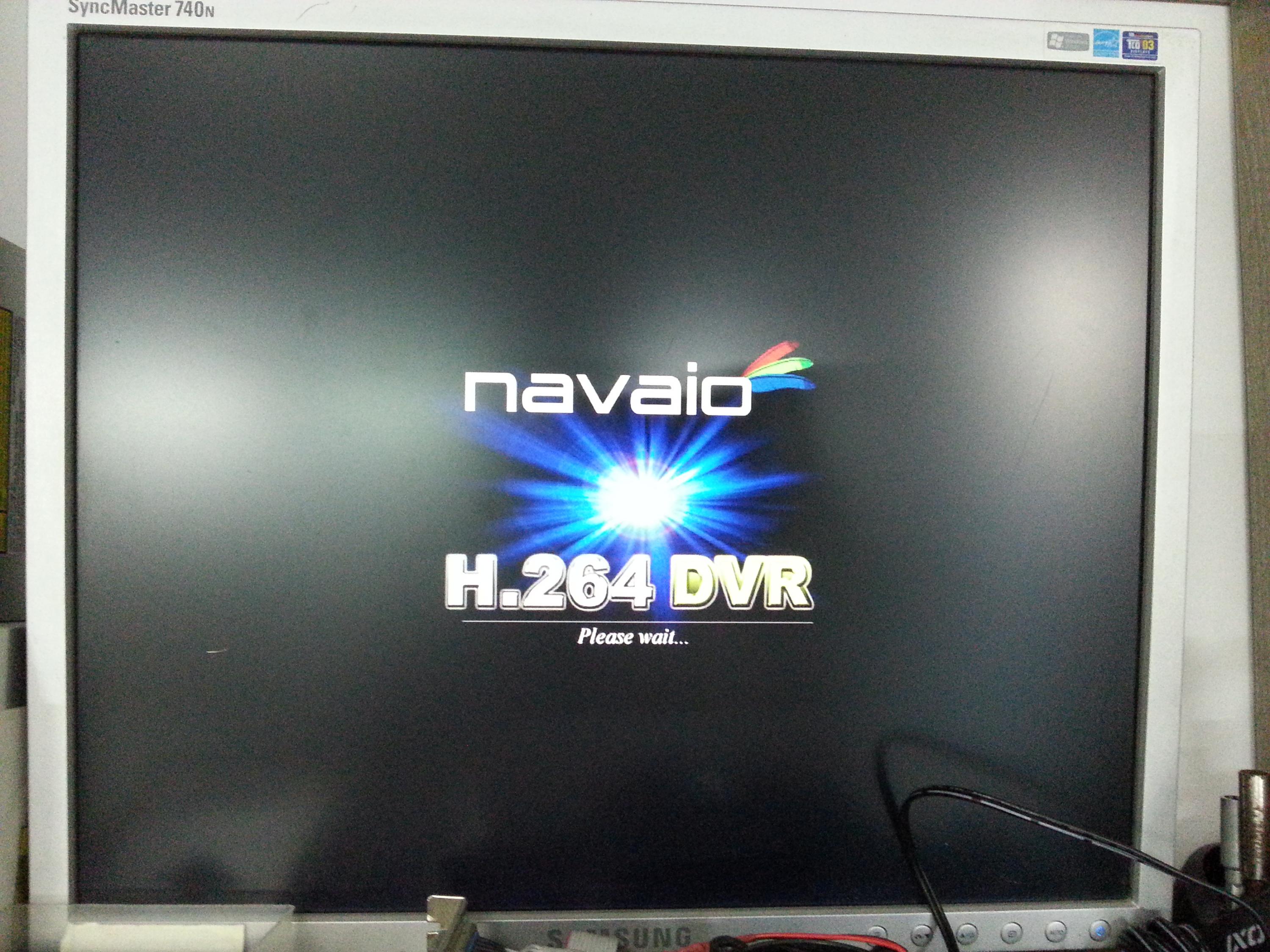

DVR not booting, stuck on logo screen (Navaio NAV-C08SE)
  • Dannyx
    CertifiedAxhole
    • Aug 2016
    • 3912
    • Romania
    Good day folks. Not sure whether someone will actually be able to help me, but another man's opinion never hurts. The issue is "simple" got this piece of junk DVR which doesn't boot - it just gets stuck on the logo screen. Mine goes by the brand name "Navaio", although I'm sure it's just generic and other DVRs use this exact same board, especially since I've seen that H.264 splash screen before. I could not find anything on this particular model, hence my low expectations here as well, though perhaps by looking at the board, someone will go "oh, this looks similar to *this* one - try it"....perhaps :| I see a UART connector on the board, but I don't know what to do with it and IF it can be used for this purpose at all. The main issue at the moment is obtaining something that can be written to the thing...anything Cheers.

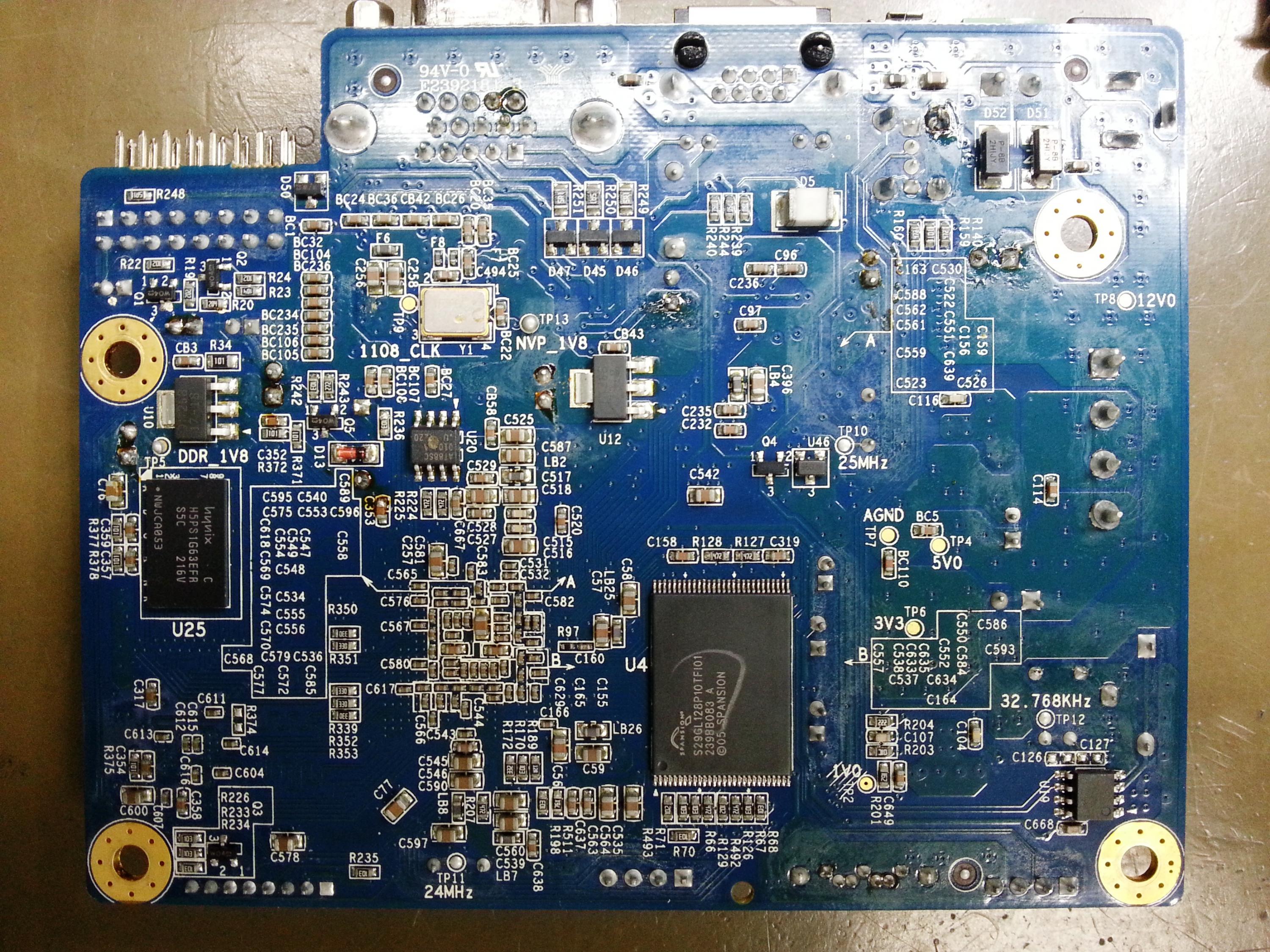

    Re: DVR not booting, stuck on logo screen (Navaio NAV-C08SE)
    There appears to be a couple of step down converters on one of the boards, an MP1482DS and the other one I can't read the number but may be worth checking the output voltages of each. There are also some standard 3 pin regulators on the boards that do have voltage test points. Have you checked those.

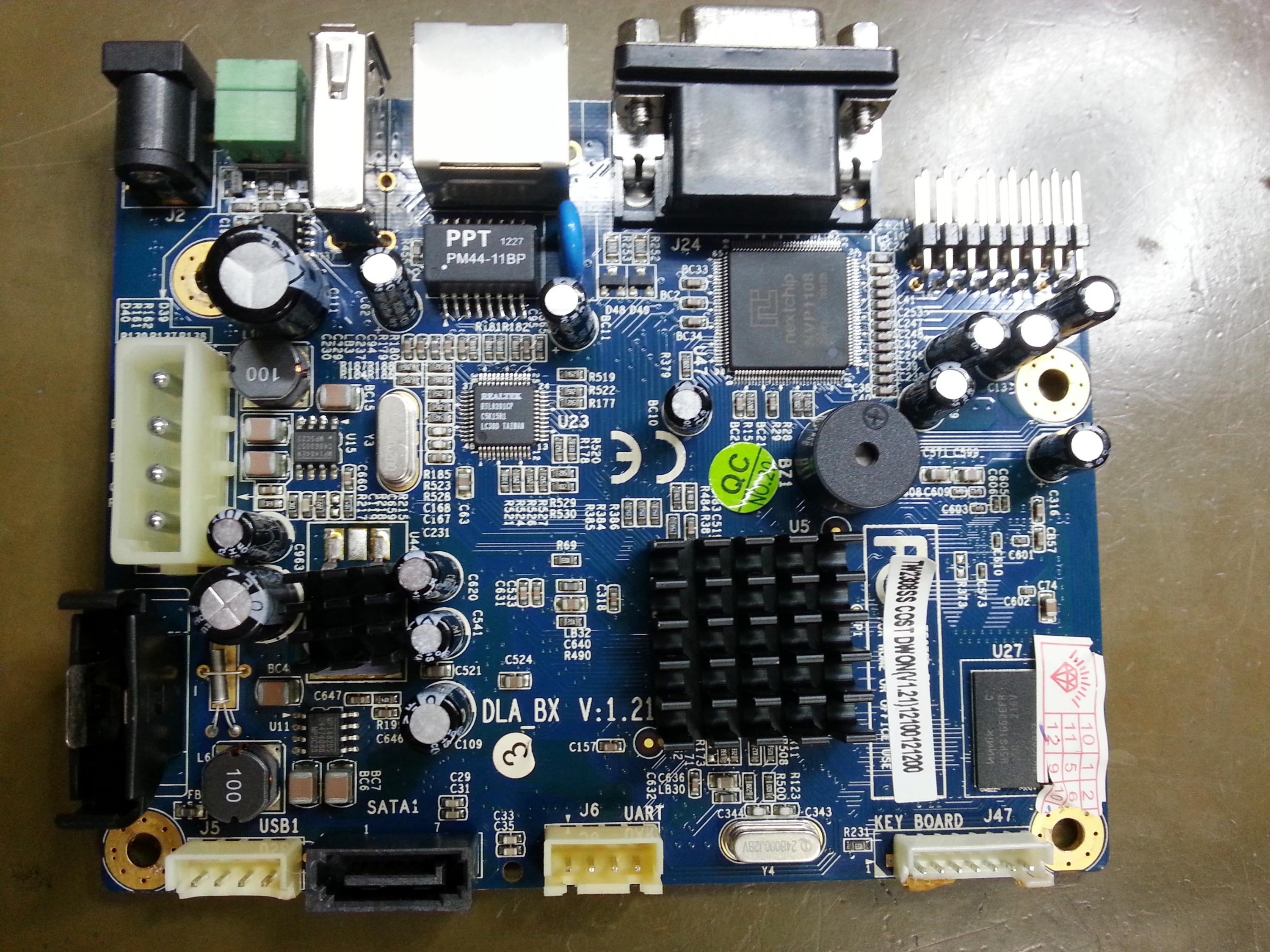

          Is this with no HDD or an HDD connected?
          EDIT: Is that a CMOS coin cell holder? If so, is it populated?
          Follow the white rabbit.
          • Dannyx
            CertifiedAxhole
            • Aug 2016
            • 3912
            • Romania
            No HDD and nothing else attached to the board. I even removed the board from the case. Also, the pictures show the same board, front and back - there's only one.
            Wattevah...
            • goontron
              5000!
              • Dec 2011
              • 4108
              • US
              Many DVRs won't boot with a bad or missing HDD, and some computers wont boot with a missing or dead coin battery. Plug in a FAT formatted HDD and see if it goes.
                I made another discovery: between the 1v test point and ground there's a short, so it could be the CPU is shorted and the splash screen loads from the EEPROM.
                Wattevah...
                • Dannyx
                  CertifiedAxhole
                  • Aug 2016
                  • 3912
                  • Romania
                  Although I AM getting 1v on that test point.
