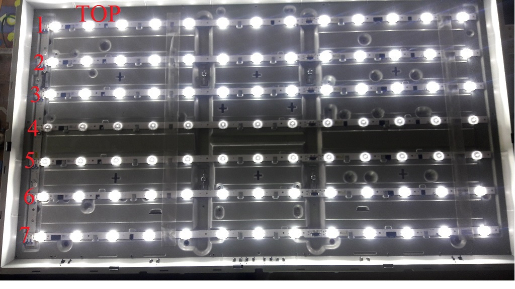

    The problem is - When power up the TV - standby LED blink twice for 5 Times and relay click but not ON and cycle continue...
    Based on advise from other thread on this forum and tested the below.
    1. Disconnected Main board cable 20Pins (CNM803)
    > LED backlight ON for half of the screen and half of screen flicker. Tear down the LCD panel and diffuser, found only top 3 Strip light UP and bottom 4 strips (2x2) flicker. So, removed the top 3 and swapped with bottom 4 LEDs but still top 3 is UP good and bottom same flicker.
    Hope the LED strips are found to be good - Please concure.

    You swapped 3 strips for 4. Did you swap forth strip?
      Re: Samsung UN40F6400 standby LED blink wont turn ON
      Yes, 4/5 - swapped with 1/2 and 6/7 swapped with 1/2 - same effect (1/2/3 constant light UP and rest flicker)- Hope LED strips should have no issue.

                Not all the LED 7 strips failed...
                First 3 is working constant full bright.
                Next 2 flicker like flash and try to glow slowly and next 2 setup start flicker try to glow full bright and goes off last 4 dtrip...Same cycle repeat.
                I have attached the photo in my previous post.
