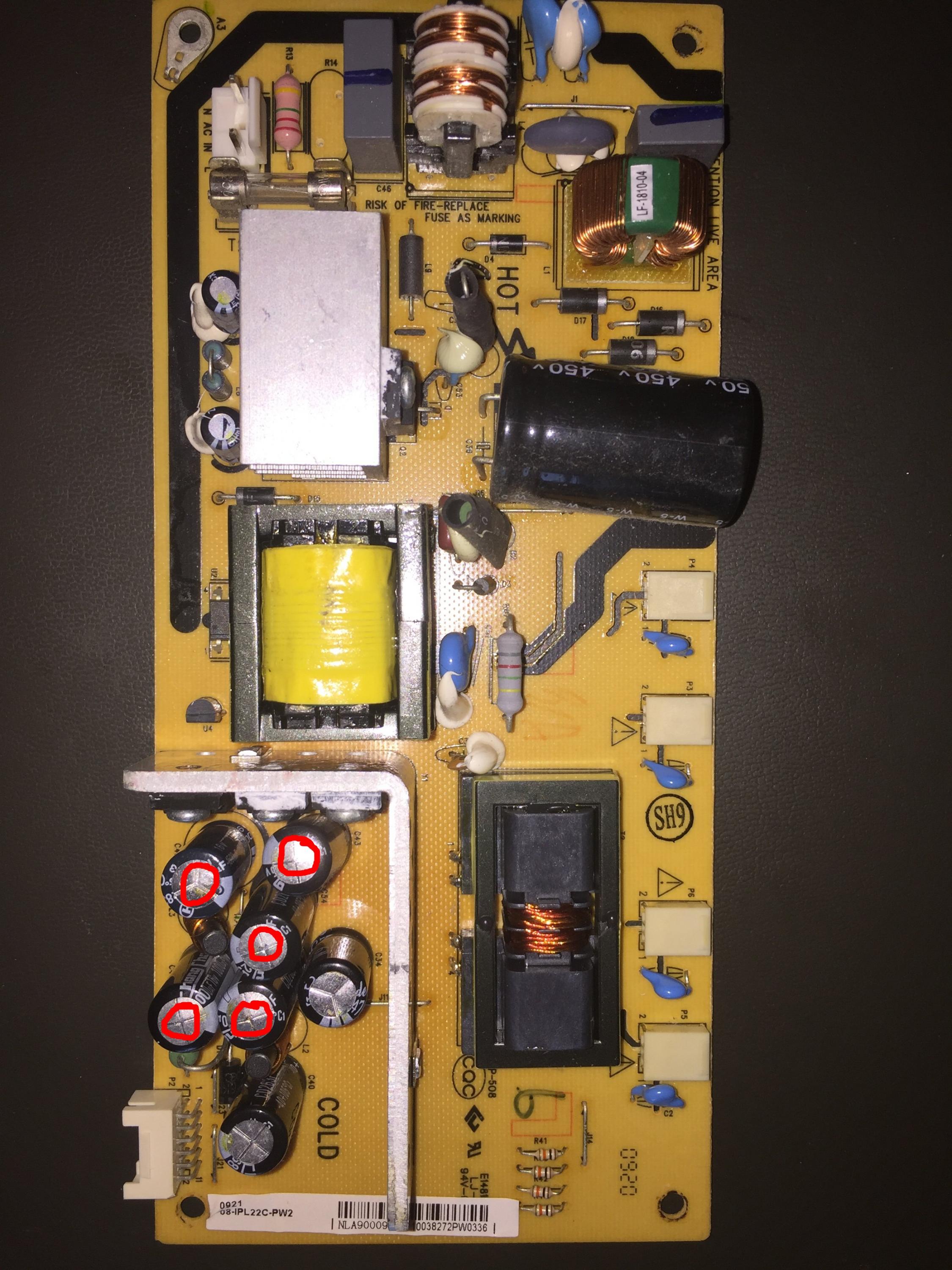

RCA L22HD41 totally dead (fixed)
  • CapLeaker
    Leaking Member
    • Dec 2014
    • 8112
    So got today a small RCA L22HD41 that appears to be totally dead on the bench. No LED, no nothing. After I opened it up there were 5 capacitors on the PSU looking pregnant! Fuses, diodes, Fet, all good. Changed three 25V 680uF, a 16V 1000uF and a 16V 1500uF in the secondary and the puppy is rolling once more!

    Re: RCA L22HD41 totally dead (fixed)
    To easy
      waay to easy. ;-)
          I usually get more stuff, but I don't post everything I have on the bench. It does take time and time is is a rare occurrence these days for me at least. I am sure some have noticed.
