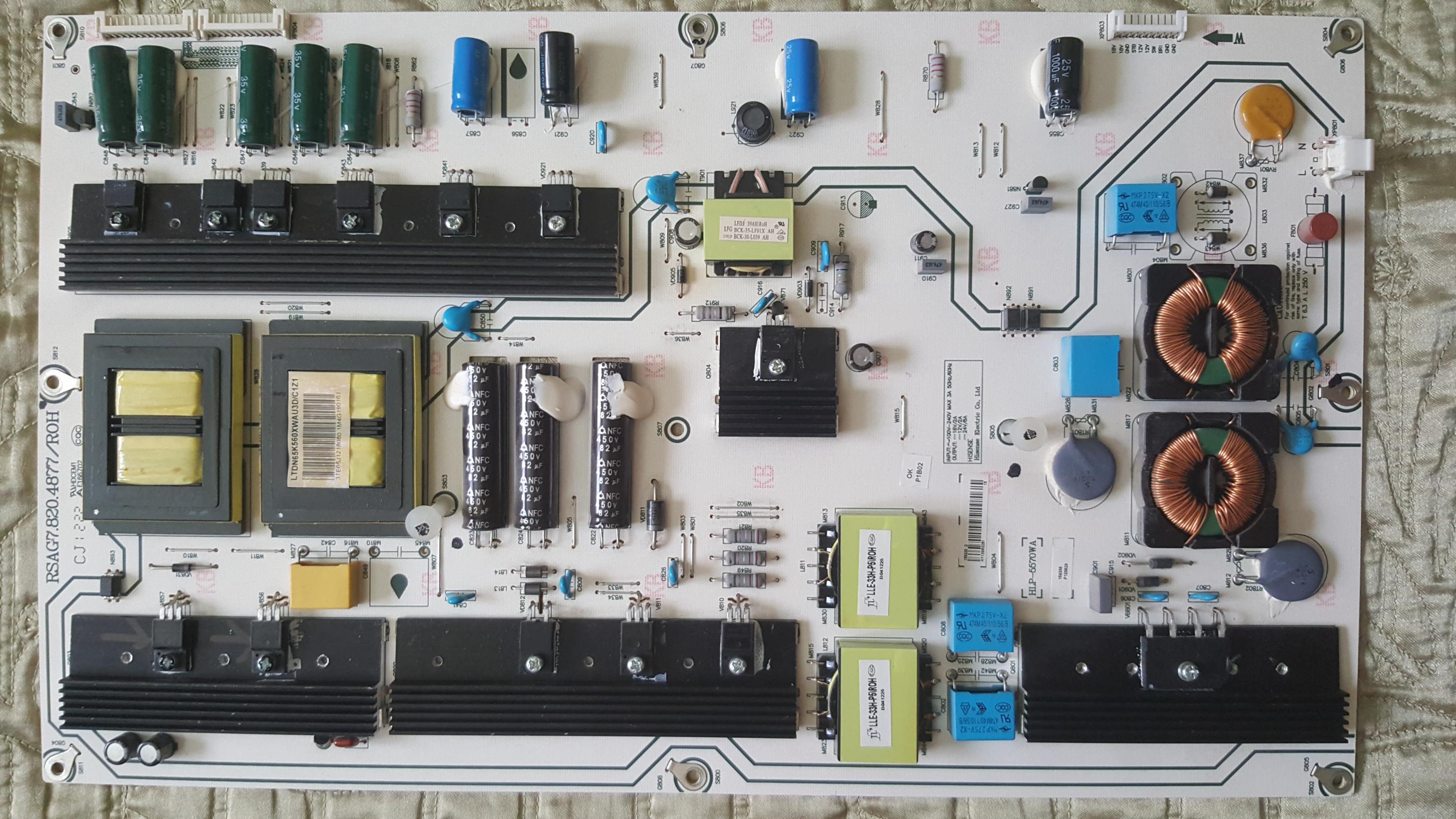

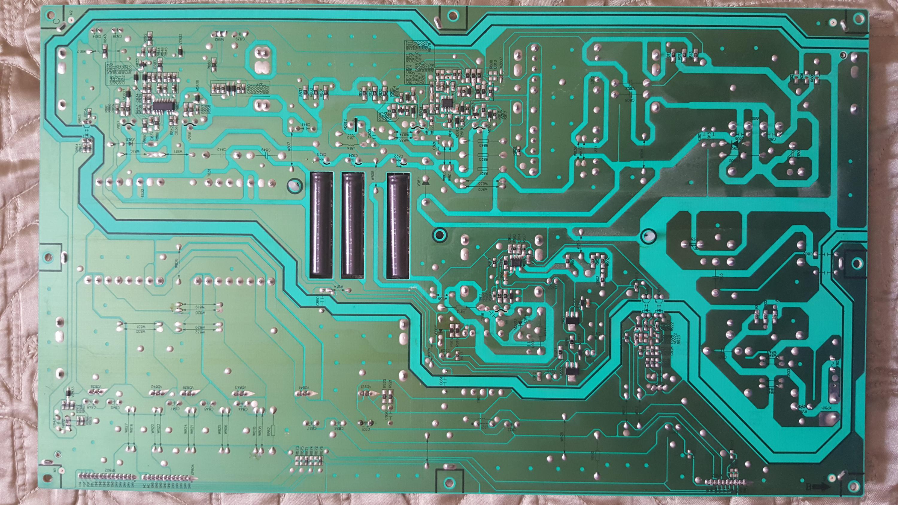

    Hi guys,
    please help, got it from a friend and I want to fix this TV so badly.
    It's a 65" smart 3D tv.
    The red light blinks once in a second and doesn't stop.
    Checked volteges on the connector and I don't get them.
    The fuse is fine. no bulged caps. I measure 315 VDC on the rectifier, is that OK?
    PLEASE guys I want to fix it soooooo badly!
    THANKS IN ADVANCE.

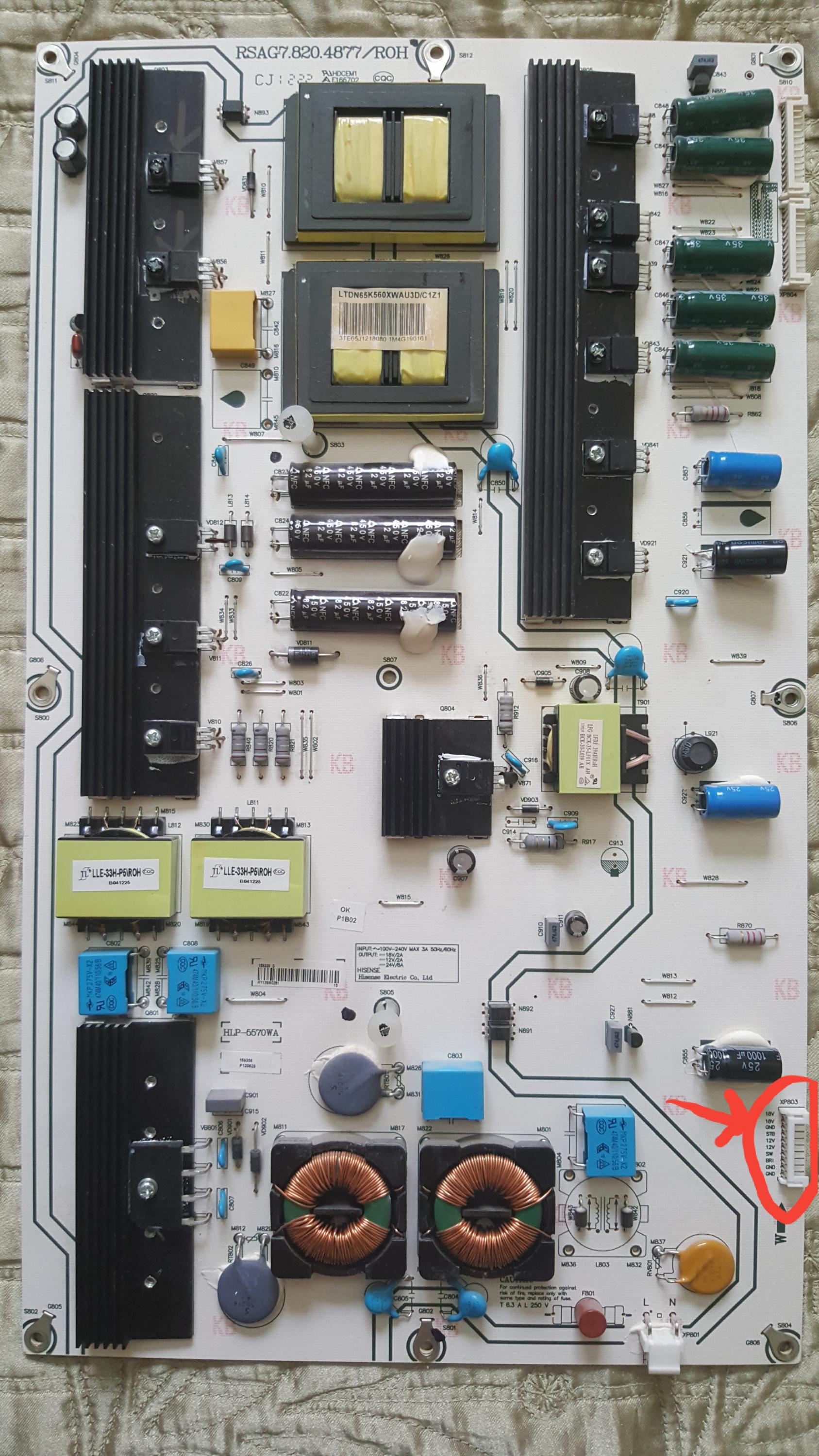

    Re: HISENSE LTDN65k560XWAU3D red light blinking
    The connector is circled in red
      what voltages do you have on xb803, in standby and when you try to power it on.

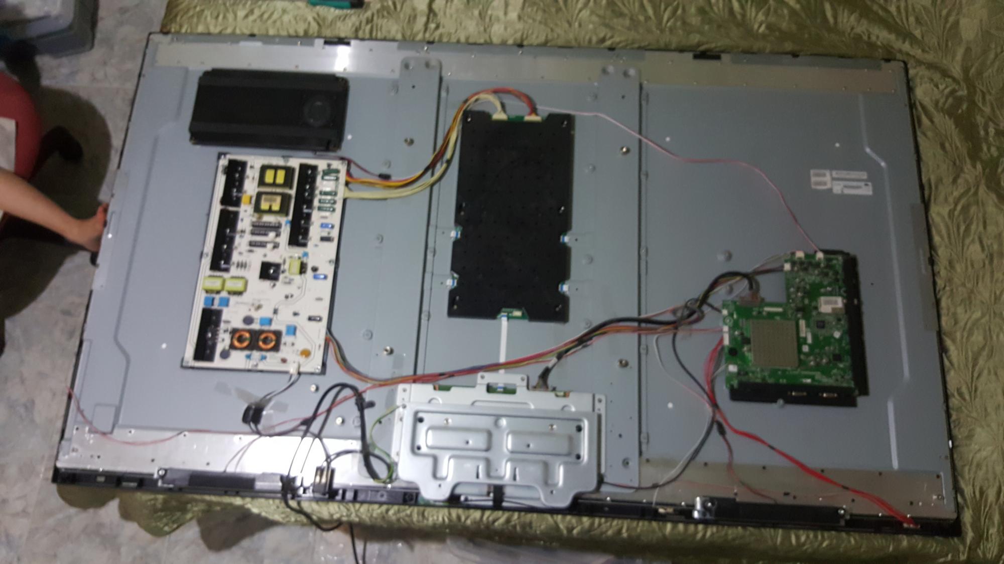

      a pic of the entire back of the tv would be nice too.

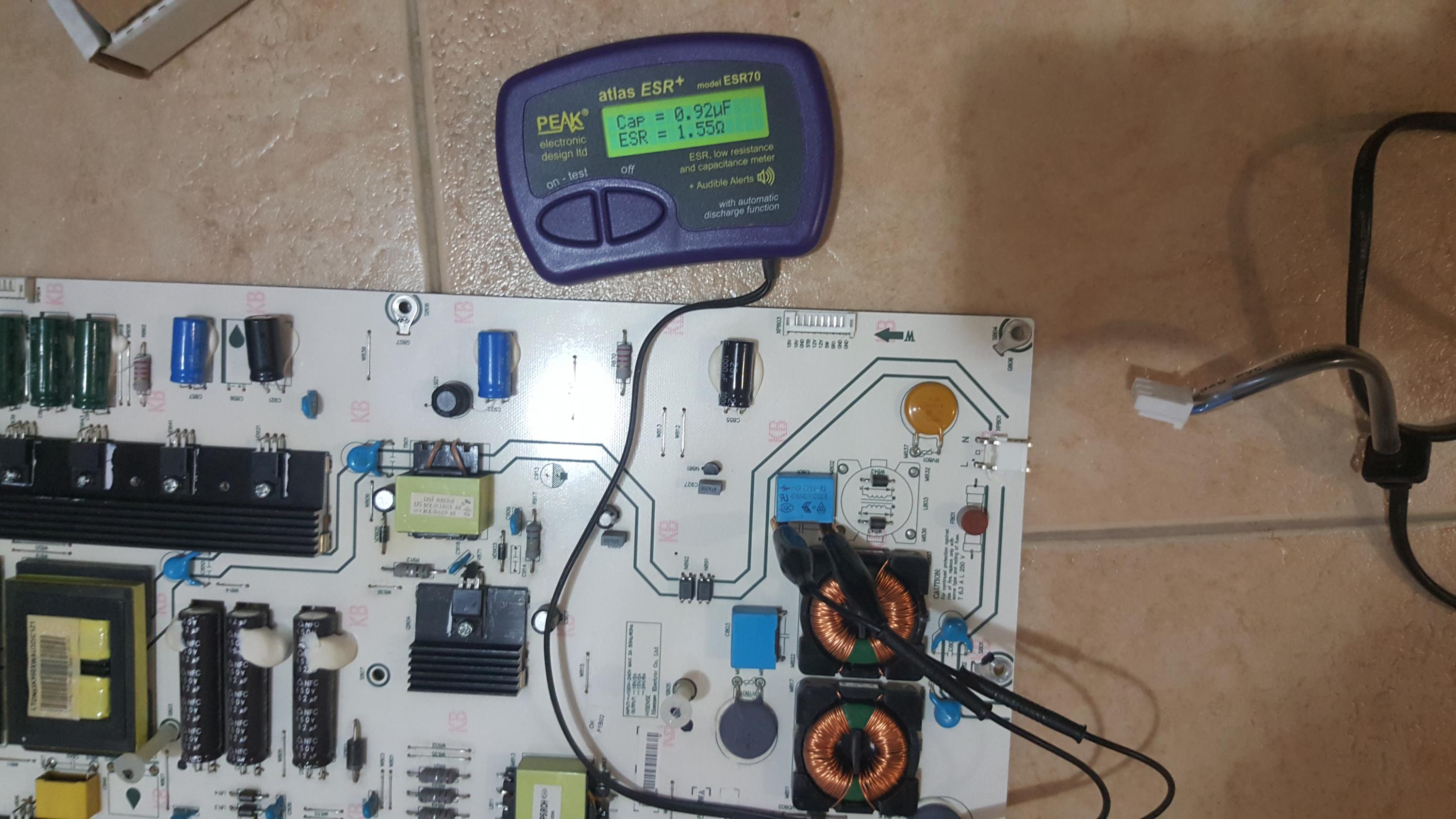

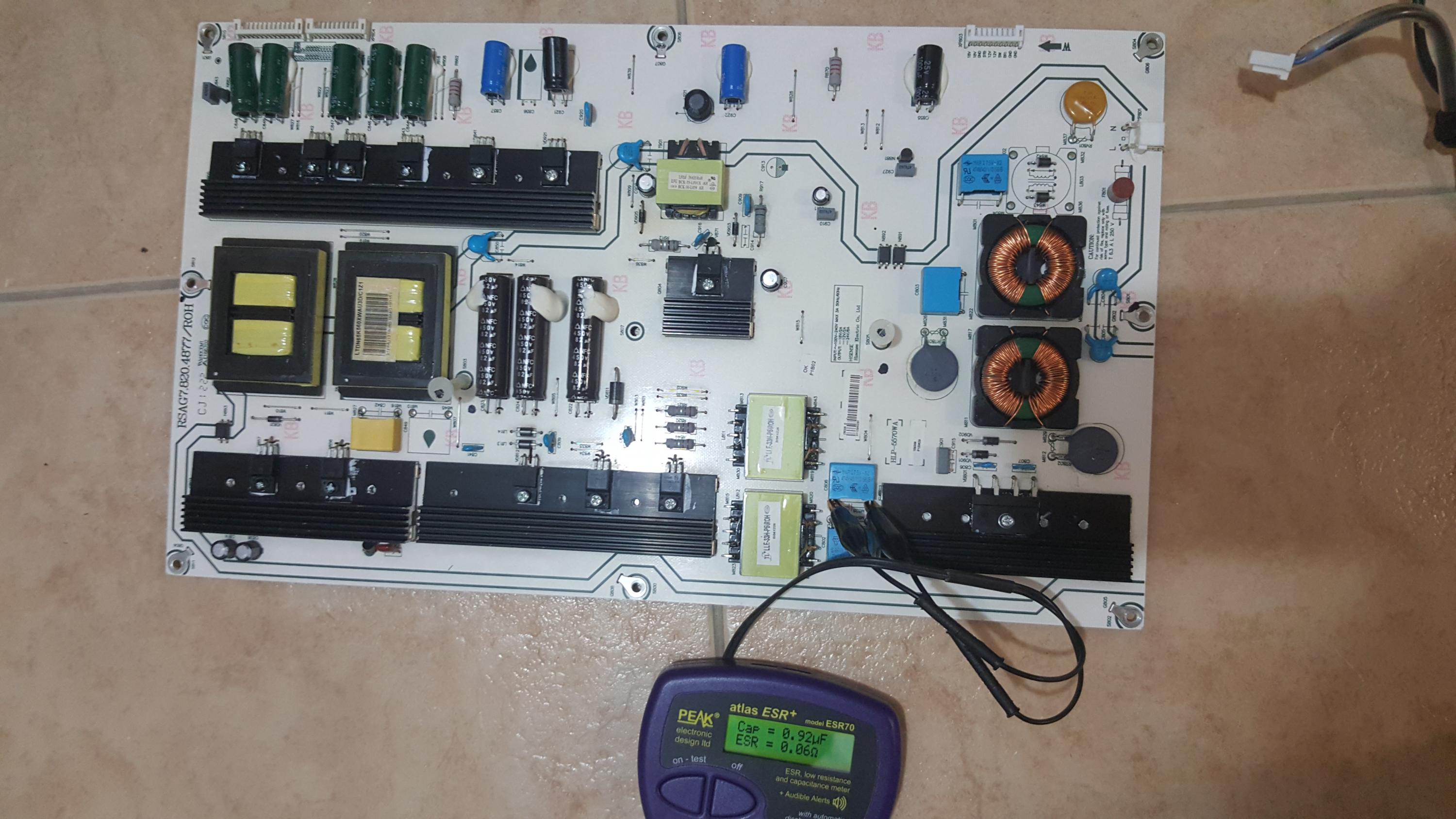

          First, here are two picture while I am measuring capacitors with my ESR meter.
          I have 2 different measurements. Is that OK?
          Second, on XP803 connector I have the following volteges(with connectors XP802 and XP804 disconnected, only the AC plug connected):
          18V-0
          18V- 0
          GND-0
          STB-0
          12V- fluctuate fast between 11.37-12.2
          SW-0
          BRI-0
          GND-0
          GND-0
          On connectors XP802 and XP804 the voltege fluctuate fast between 3-77 volts on the 24V pins. (with connectors disconnected).
          On pins I01, I02, I03, I04 it show 0 volts.
            Do not bother to check those two blue safety caps.
            What DCV do have on the blue lytics cap (C922) laying on its side next to inductor L921 when measured right between the two legs of the cap?
            So what DCV do you get at the STB (PS-ON) when power switch is activated?
            BTW, do not try to test ESR when the cap is still in the circuit due to the fact it has other component connected in parallel the cap being measured, and the ESR meter is not made for that kind of caps anyway.
              disconnect both socket xp204 & xp202 , check the 12 volts on the socket xp605 i think, the one connected to main board , it could be high to 13Volts. tell result
                  When you press button to turn tv on what voltage do you get on STB pin?
                        Here are the findings.
                        First, with all connectors connected the STB voltege fluctuate between 0.3-1.8 volts.
                        When press the power switch nothing happens and the voltege on the STB continues to fluctuate.
                        second, if XP802 and XP804 disconnected then the voltege on the XP803 connector on the 18V pin show zero but, if the XP802 and XP804 are connected then the voltege fluctuate on the 18V pin.
                              On back of board what number is on N85?. Right of main caps
