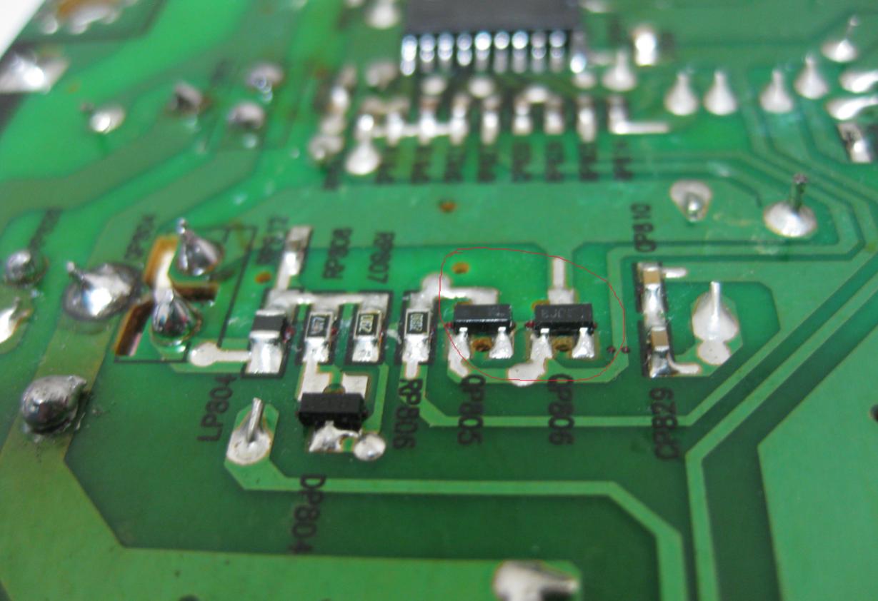

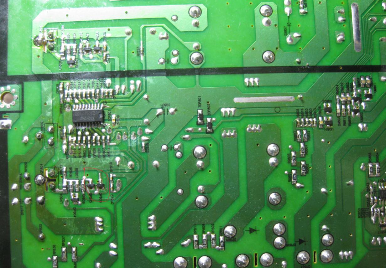

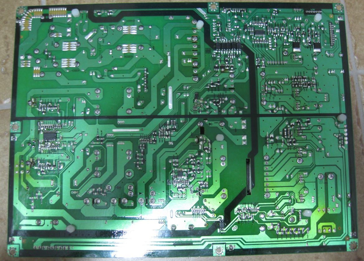

    This power supply is from Samsung PN59D530, the fuse T10A250V burnt, QP802,QP804, IC CP801,QP804,QP806 all shorted.
    I can see the parts# except the QP805,QP806, this two smd small transistors only show BJD 2A and BJD 2E, not sure what they means, couldn't find the datasheets.
    Anyone know what the real part# ?

    I found this thread, level #24, he did replace the QP805,QP806, but couldn't see the part # clearly.
    https://www.badcaps.net/forum/showth...t=QP806&page=2
