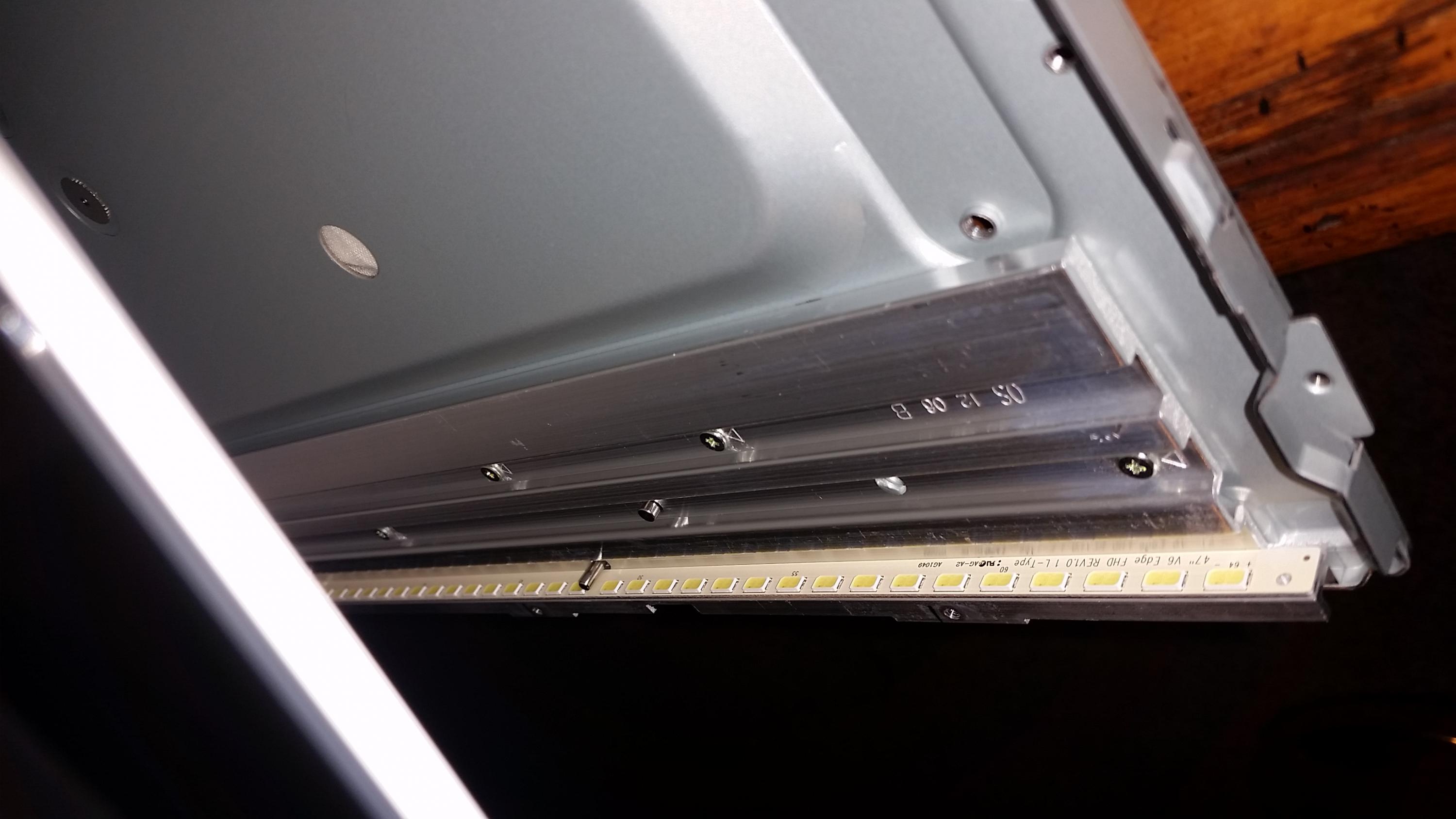

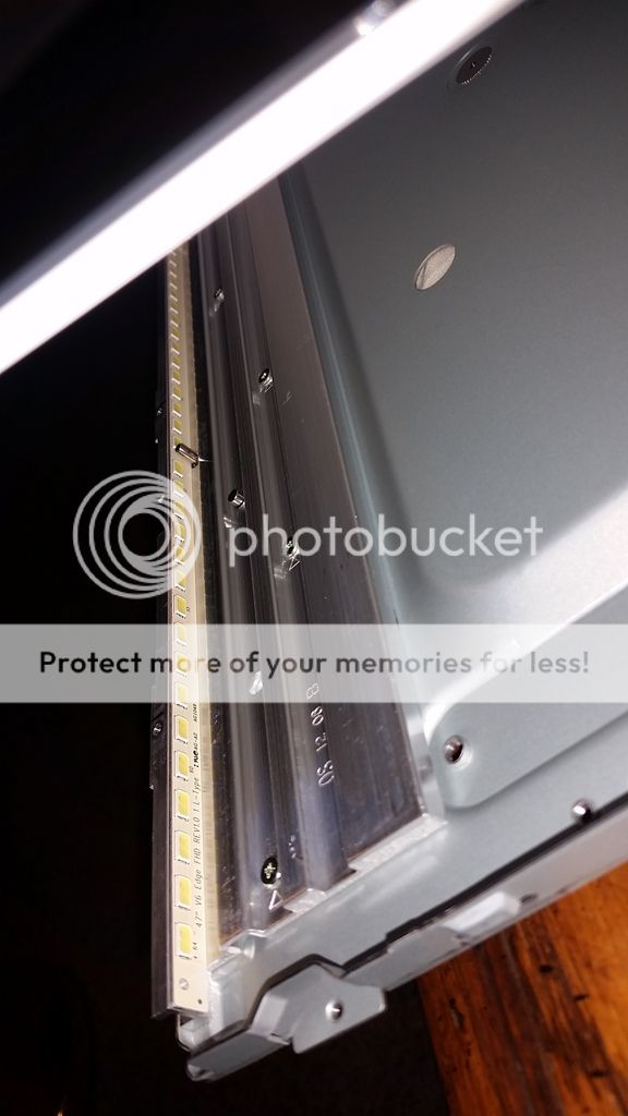

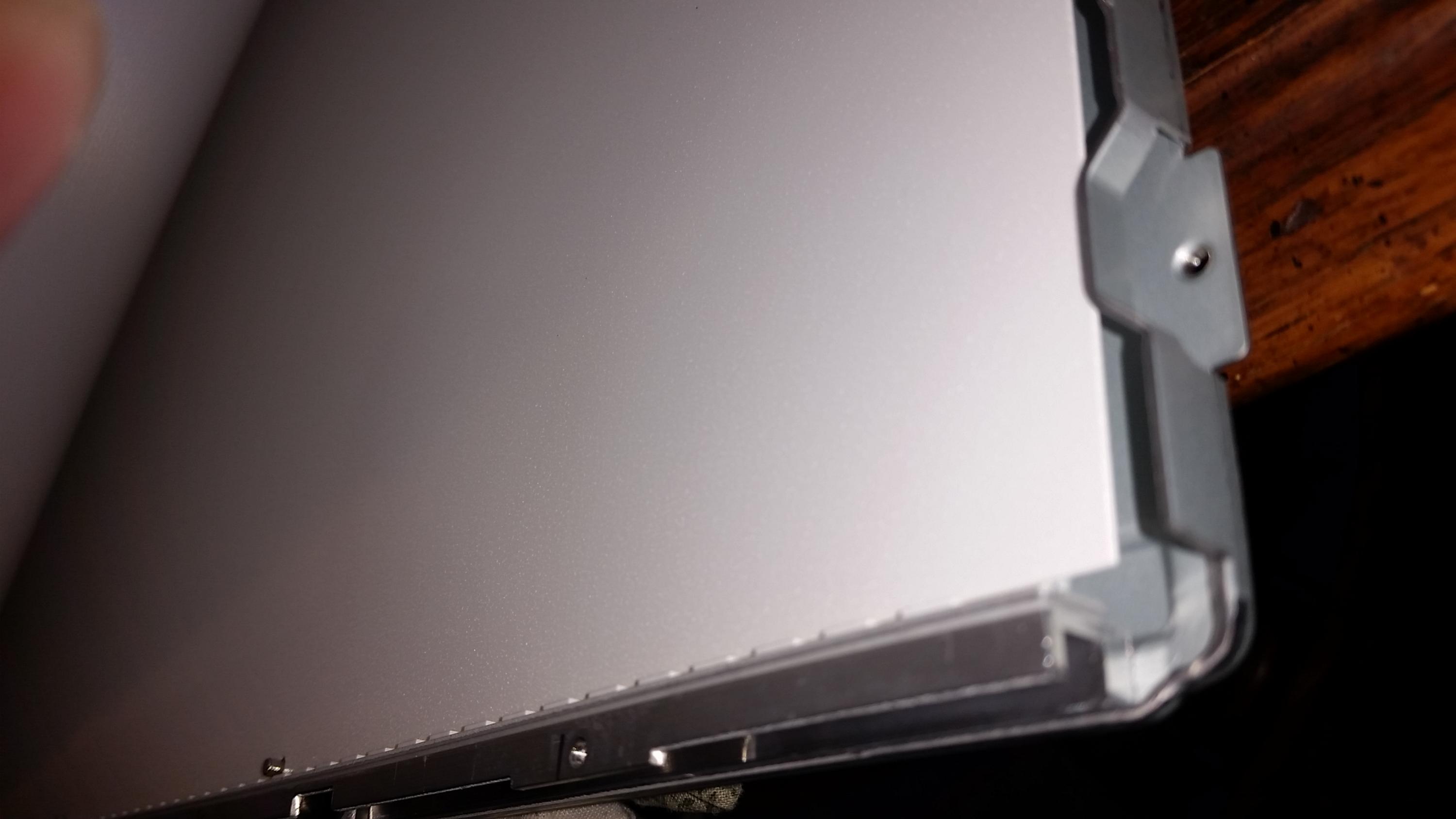

                          • Lawdawg79
                            • May 2017
                            • 28
                            #33
                            Re: LG 47LW5600 Has picture, No backlight, then I made it worse :-)
                            Thanks for the tip...here ya go....oh and that makes 2 of us, i didnt even know they made em like this lol.
                            • attainteddragon
                              • Apr 2013
                              • 764
                              • australia
                              #34
                              edge lit led's are not that bad to change out. it is getting the right replacement led's that is a bit trickier to get.
                              first you need the right voltage led's,
                              then you need the right footprint,
                              then you need the right anode/cathode configuration.
                              with testing, these may be dual 3v led's, so you need to make sure both halves light up.
                              you can just test each side with your mm in diode mode. orientation can change half way through the strip.
                              hot air is the easiest way to change them in my view.
