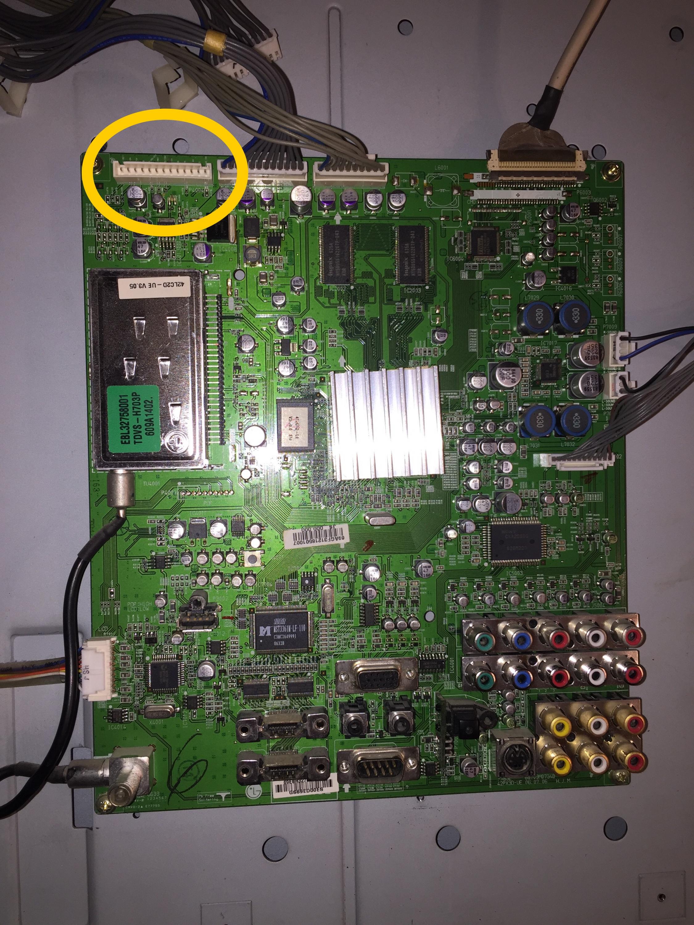

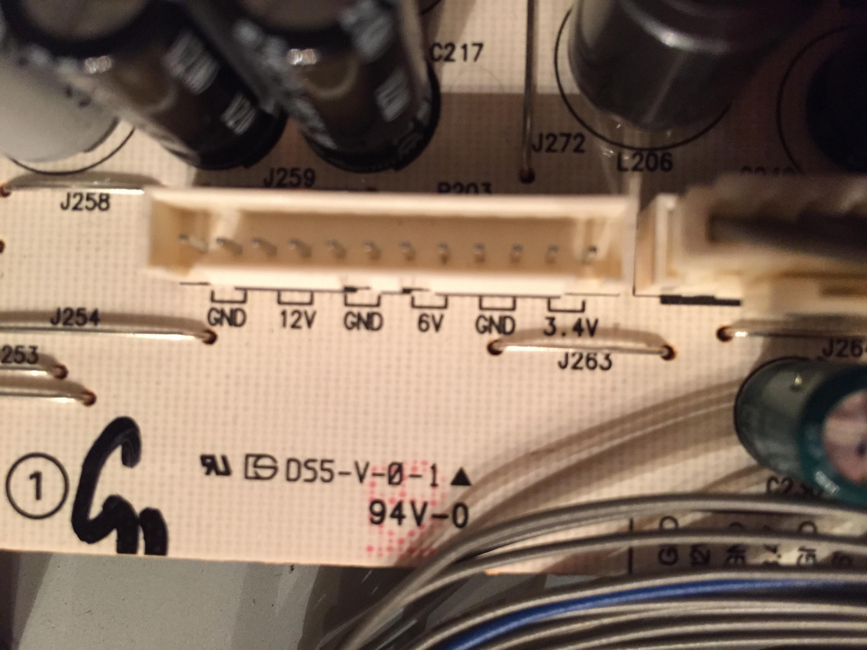

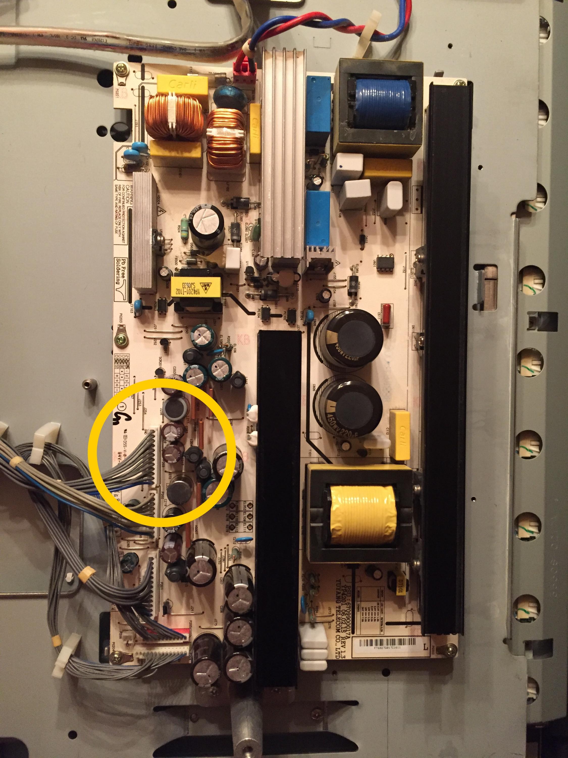

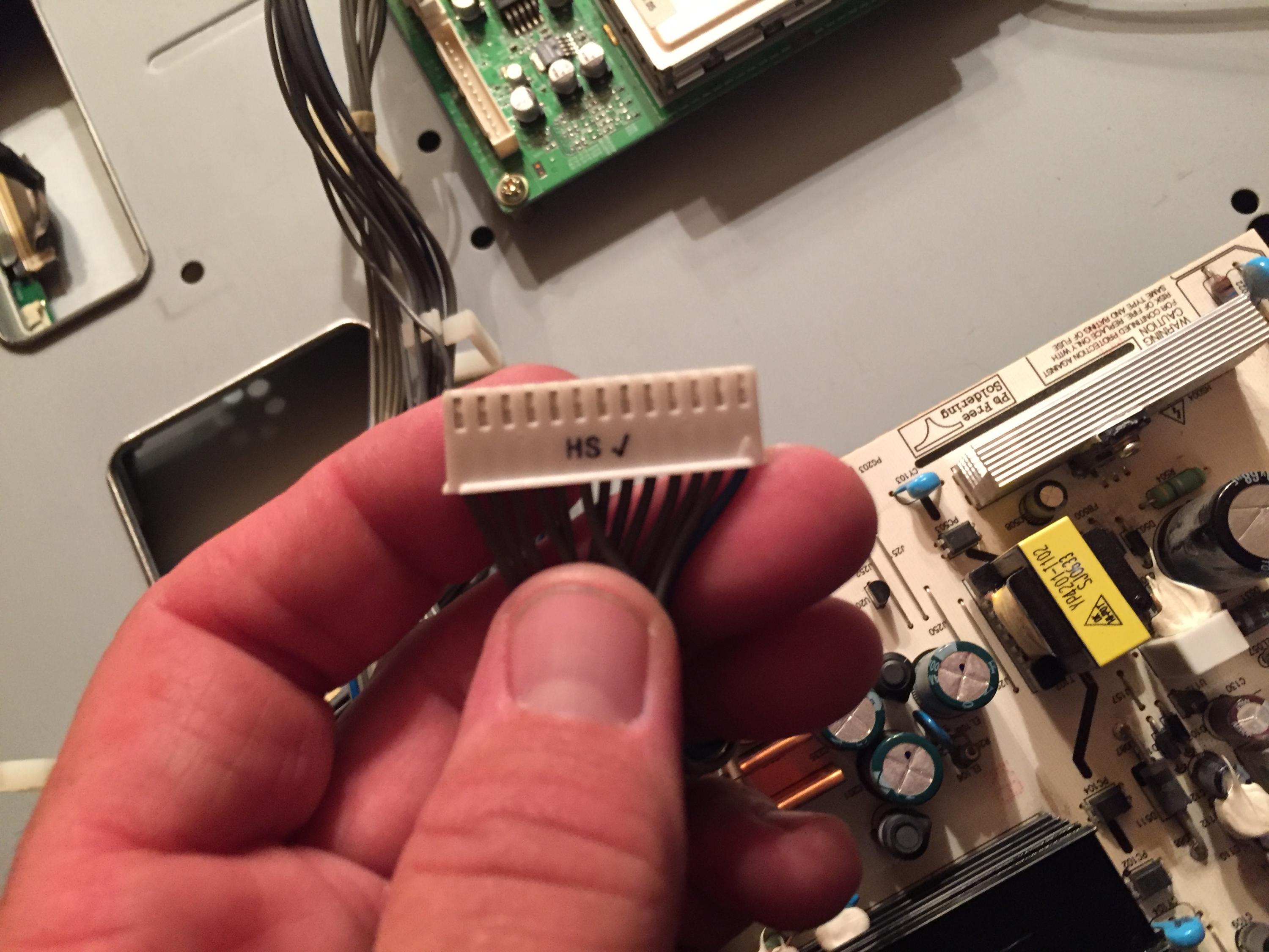

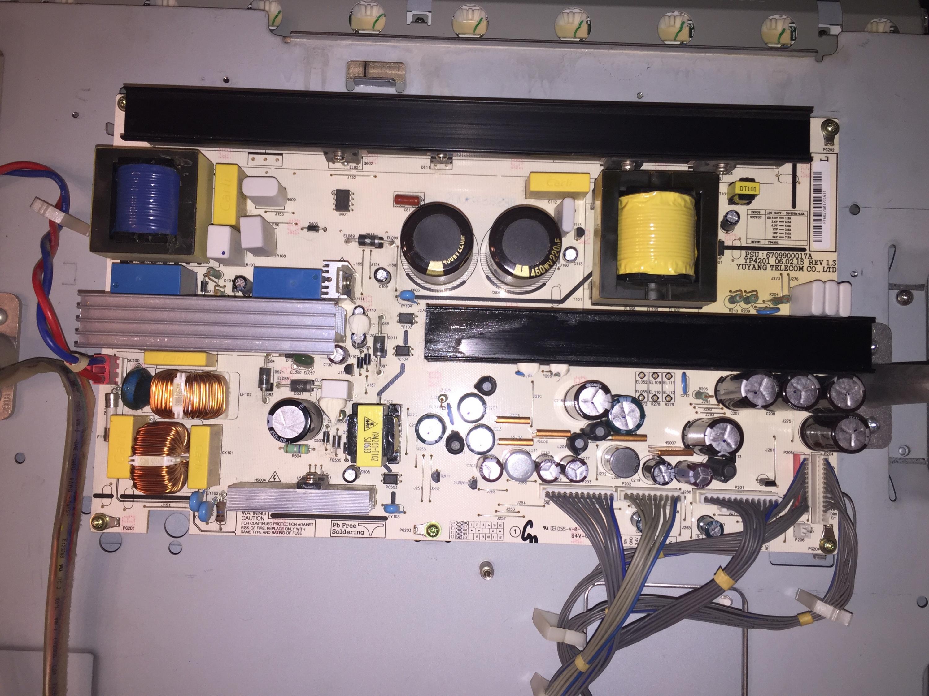

    I have an LG 42LC2D tv that recently lost picture. When I turn the unit on I get a click, the red standby light blinks green 12-14 times and then turns solid. When I press the power button, it takes several seconds to turn off. I have replaced several caps including one visibly blown one. The unit is still not working. I started disconnecting wiring harnesses. When I disconnect the 13 pin harness, the unit will power on correctly, but still no picture. With the set still on, I reconnected the harness and I have video. The pictures included have the harness I am talking about circled. Any ideas? Thanks in advance.

    So what DC voltages do you have on that harness when it is connected to the mainboard and you have no picture?

      I took these readings this afternoon. The second 5V pin was steadily dropping. When I first took the reading, it was showing almost 1.5v.
      AC DET - OL
      RL ON - 1.85v
      ST 5V - OL
      GND - 0
      INV ON/OFF - .012v
      5V MNT - .072 dropping
      POL/INV - 1.112v
      ST 5V - OL
      GND - 0
      PWM - .118v
      6.0 V - OL
      GND - 0
      LIVE ON - 1.476v

        What is the meter DCV range set to, it should not be showing OL on ST5V for example. You need to retest those Voltages again, also need to look for the Inverter power supply Voltages.
        Right now you are saying you do not have pictures, which you will not see the pictures because the Blacklights are not on for you to be able to see the image on the screen because the main board is not sending the INVERTER ON (BL-ON) signal.

          Sorry. I must have had the range too low.
          AC DET - 0v
          RL ON - 1.85v
          ST 5V - 4.98v
          GND - 0
          INV ON/OFF - 0
          5V MNT - .08v
          POL/INV - 1.112v
          ST 5V - 4.96v
          GND - 0
          PWM - .10v
          6.0 V - 6.13v
          GND - 0
          LIVE ON - 1.476v
          It looks like the inverter power supply voltages are all above 24v. Thanks for your help.
