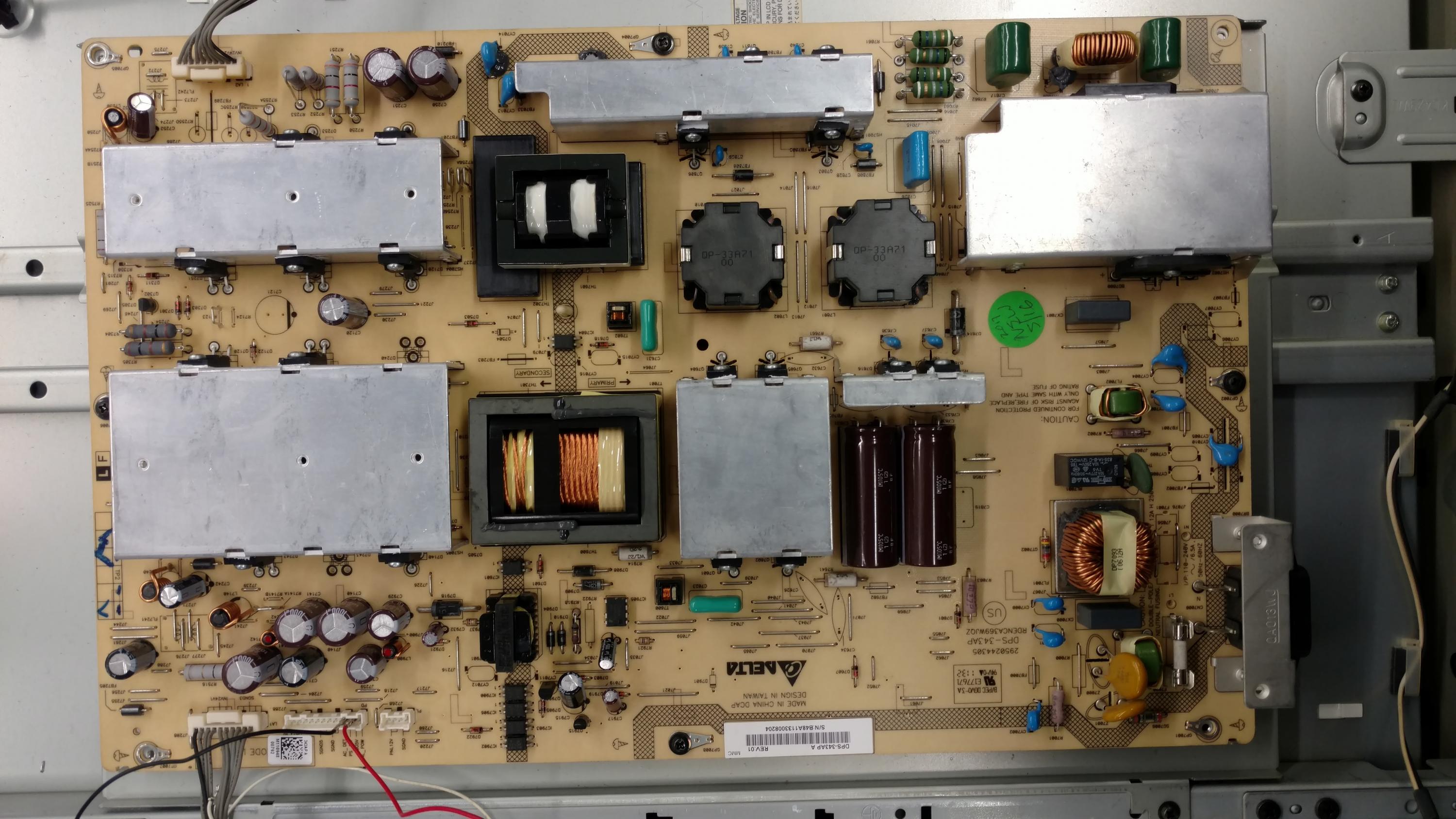

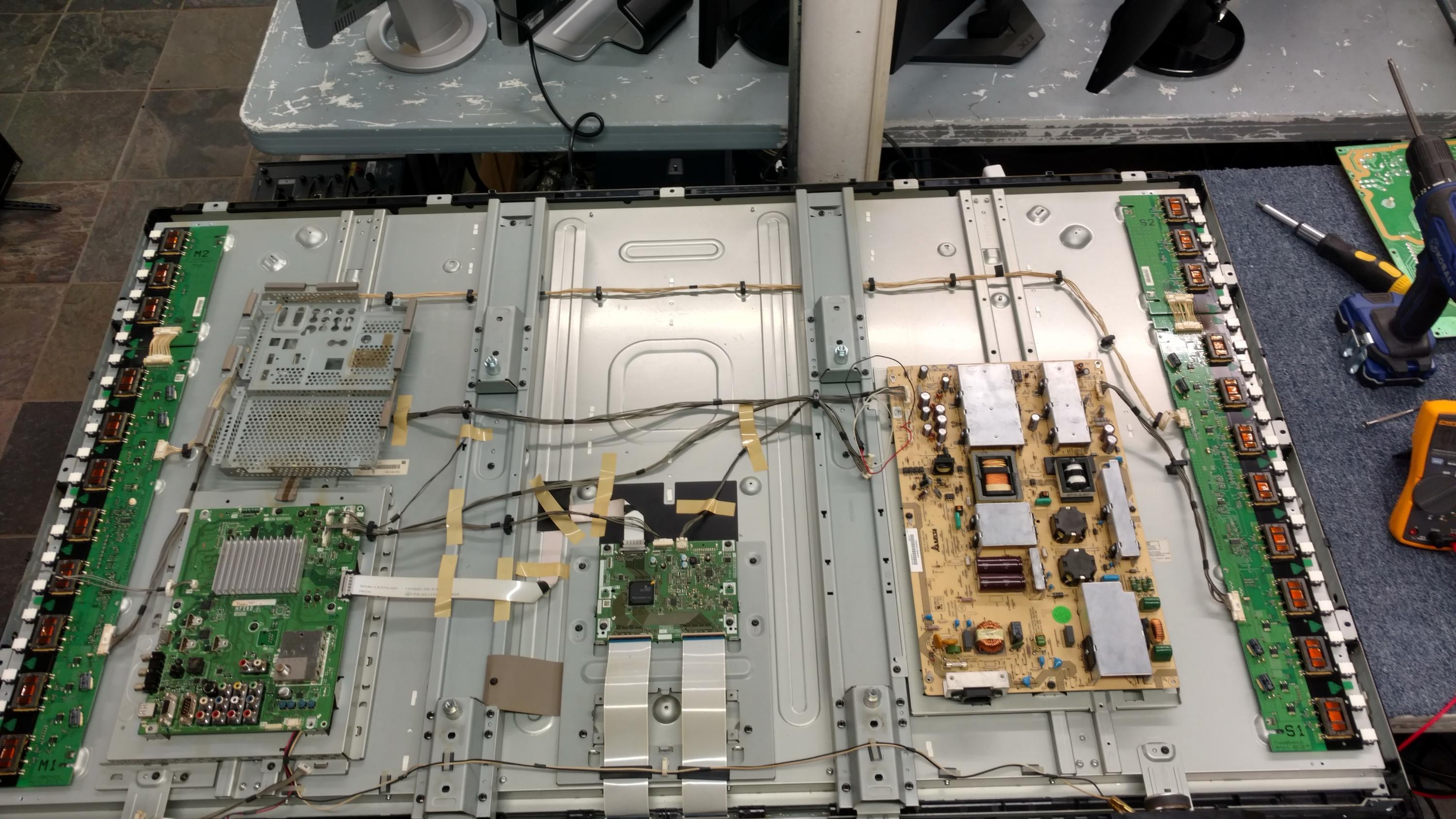

    I have a Sharp LC-60E78UN and here's what I've done:
    Had a bad power supply (no standby) and found a cheap one on ebay. Now with the good supply, I am getting blink codes OPC/Power one blink, Power two blinks and then it repeats the cycle.
    The power supply tries to turn on before I get the blink codes. If I force the power supply on with a 1k resistor between pin 11 labeled BU5V on main ps connector and both the PS_ON and PNL_POW, I get good voltages but NO BACKLIGHT. Here are the voltages:

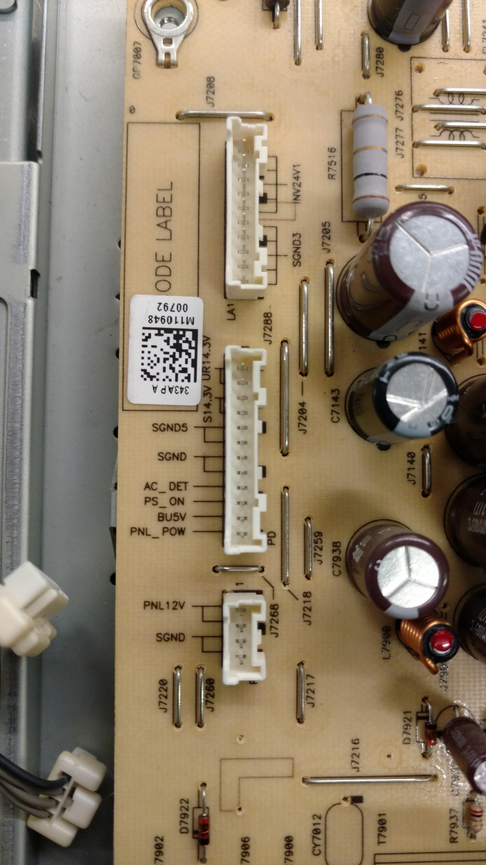

    LA1
    Pin 1-5 INV24V1 24.43
    Pin 6-10 SGND3 0
    LA2
    Pin 6-10 SGND3 0
    PD
    Pin
    1 S14.3V - 14.34
    2 S14.3V - 14.34
    3 UR14.3V - 14.34
    4 UR14.3V - 14.34
    5 SGND5 - 0
    6 SGND5 - 0
    7 SGND - 0
    8 SGND - 0
    9 AC_DET - 3.2
    10 PS_ON - 4.6
    11 BU5V - 5.03
    12 PNL_POW - 4.6
    PL
    1 PNL12V - 11.99
    2 PNL12V - 11.99
    3 SGND - 0
    4 SGND - 0
    I checked the transformers on the inverters. All are 6.3k +/- 2%.
    So I'm leaning towards the main but don't have the schematics.

    What are you getting on pin 10 and 12 when you power it on
    • fcisolutions
      • Jan 2017
      • 205
      Re: LC-60E78UN No picture, backlight, no flashlight
      Pin 10 -- 2.86v
      Pin 12 -- when the relays click, it hits .4-.8 and
      then fades to .15 even both in normal condition
      and with the t-con disconnected

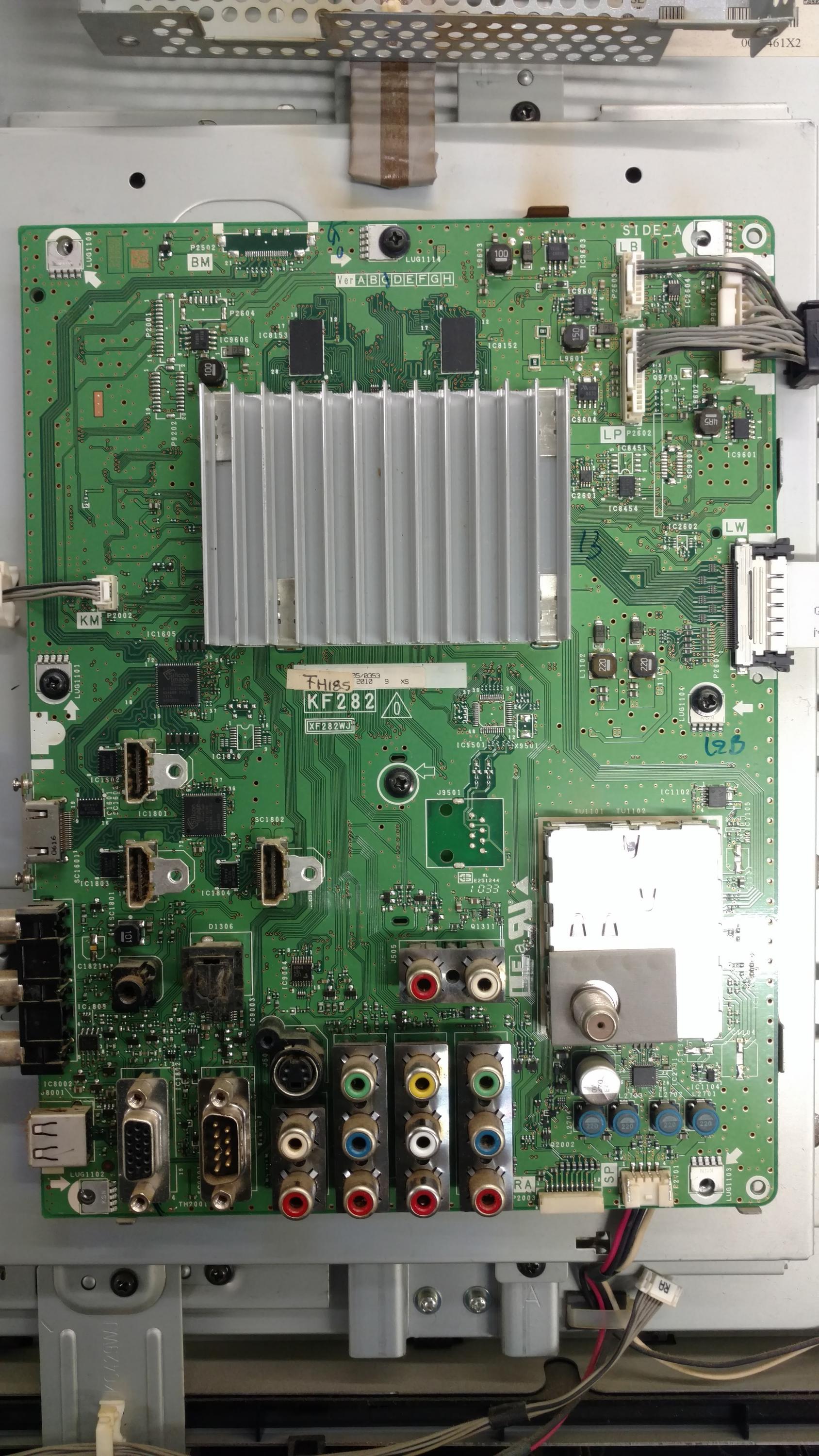

        i'm not saying that you don't have an issue with your main board, but if you jumped your ps on and you had all voltages present, but no back lights, then you will have an inverter fault. there should be a fuse on the inverter board just near the connector. check it to see if it is open.

          "12 PNL_POW - 4.6" That is not for the Backlights on/off, it is for switched 12v for running the T-CON board.
          The BL-ON and Dimming signals are not routed through the power supply, it is connected directly to the left inverter board directly from the main board, you can see a connector on the main board with only 2 or 3 gray wires on that connector that goes to the Inverter board.
          BTW, we need good clear pictures of the inverter boards, especially around the connector. There should be some fuses on the inverter boards too. Did you already check those connectors that link the inverter boards together?
