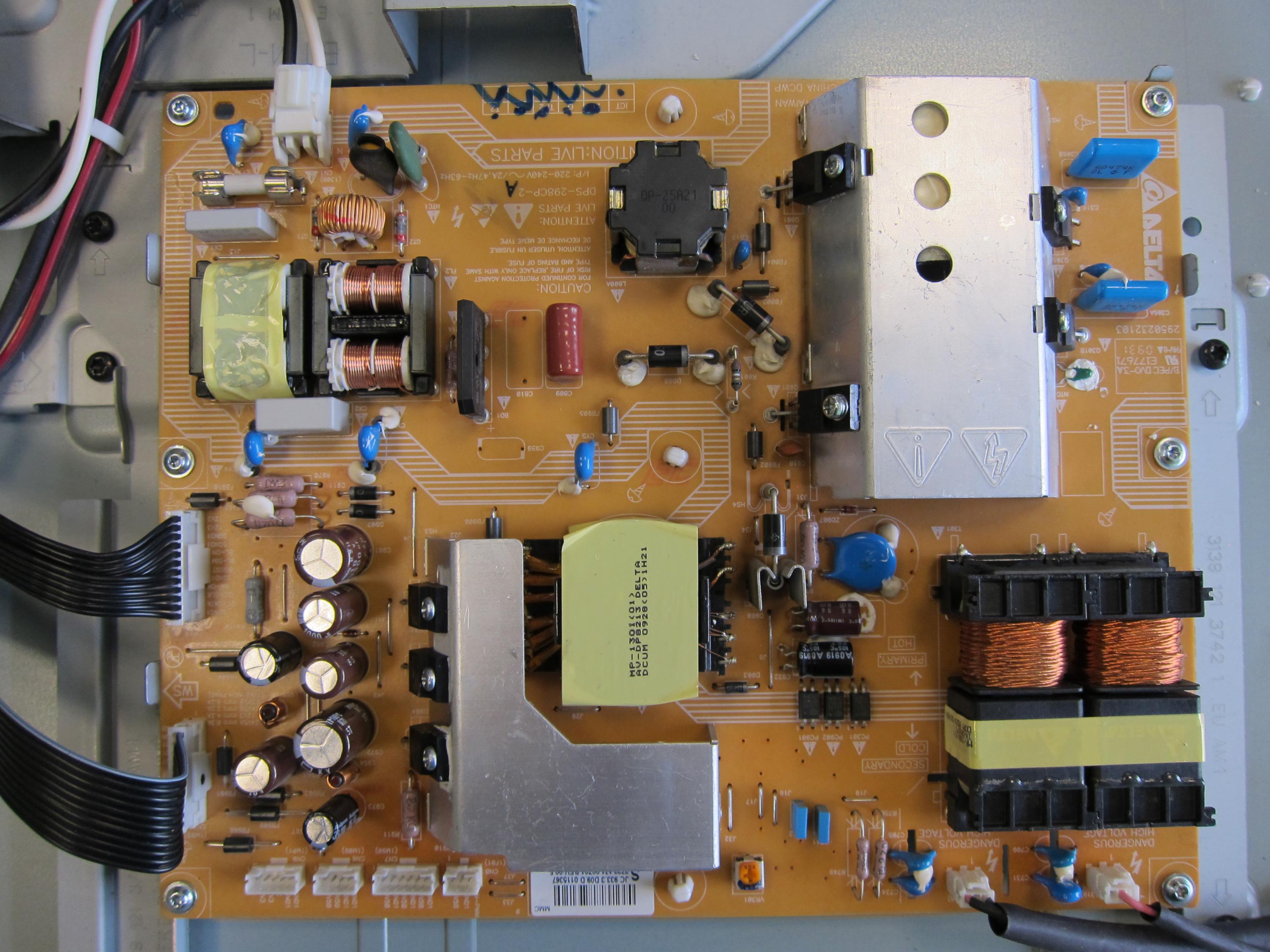

            Need good clear straight on pictures of back of tv with cover off and each board.

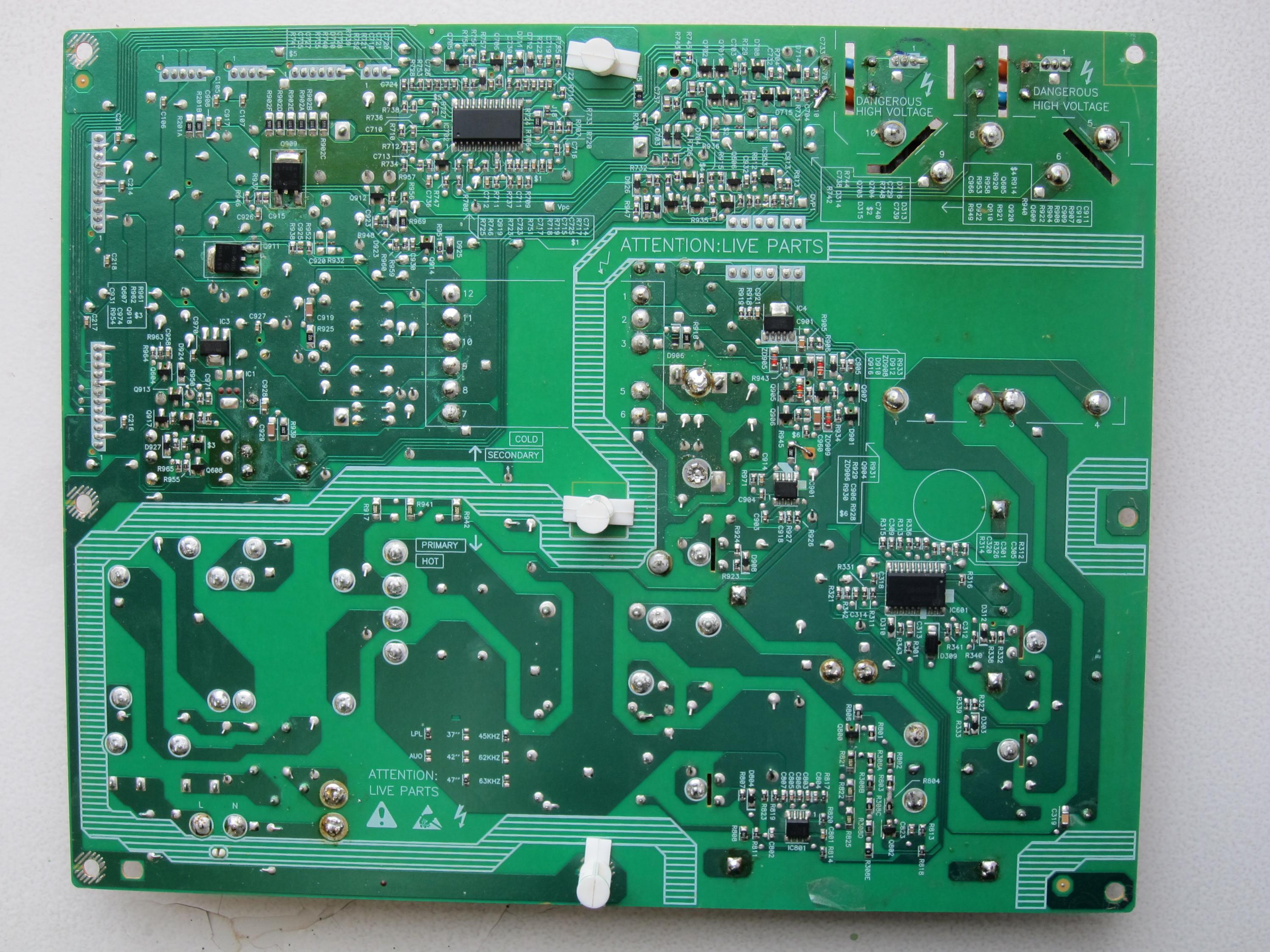

                Attaching picture of back of the board(little bit messy as resoldered some parts for testing)

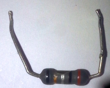

                      Ok, tested Q301A and Q301B they are shot. Also R344(1 ohm?) is open.
                      Will replace and check then.
                      Resistor is 5 band but can't verify it's value. Is it 1 or 0.1ohm?

                        The burnt-out resistor indicates a short circuit of Q301a(type P6NK60ZFP), and resistor maybe goes defective when one of the capacitors C306A/C306B is no longer in order?

                          R344 acts like a fuse between the B+ and B+++ It went open because Q301A & B shorted, IF they shorted from drain to the Gate, D303/312 or R333/338 could be bad OR the IC601 could have been damaged.

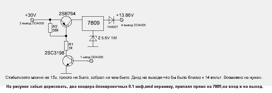

                            IC4 is DDA005
                            Its counterpart is DDA005 = M29150 Link
