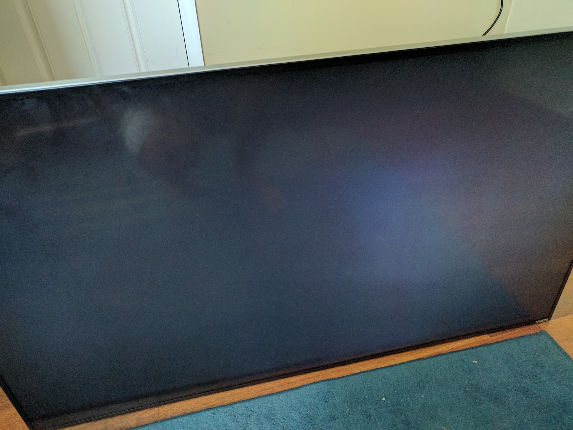

    I have a Vizio M50-C1 and initially, saw the back lights turn on but saw nothing on the screen. I went through the process of replacing
    -Power Supply Board
    -T-Con Board
    -Main Board
    Nothing changed. Lastly, I replaced the LED Driver board and I at least now have some type of picture but it still doesn't show picture properly. What am I over looking?

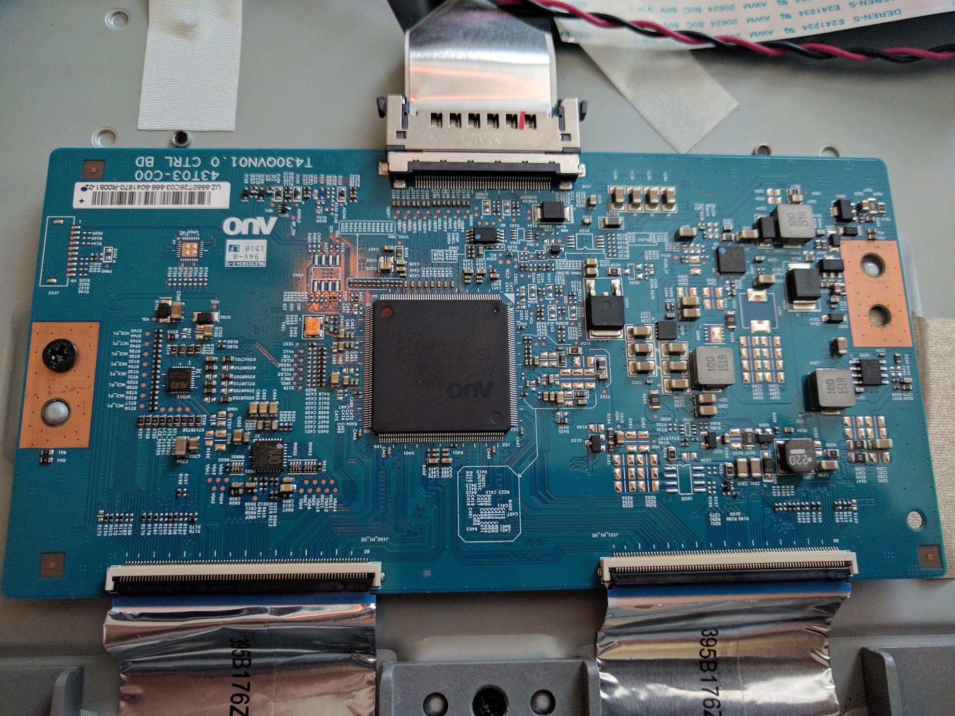

      I feel like an idiot but when you had me look at the t-con board I noticed the 2 t-con ribbon cables weren't secured in to the board. I latched them in and turned back on the TV. I actually saw a fairly OK image but it still was not 100% clear.

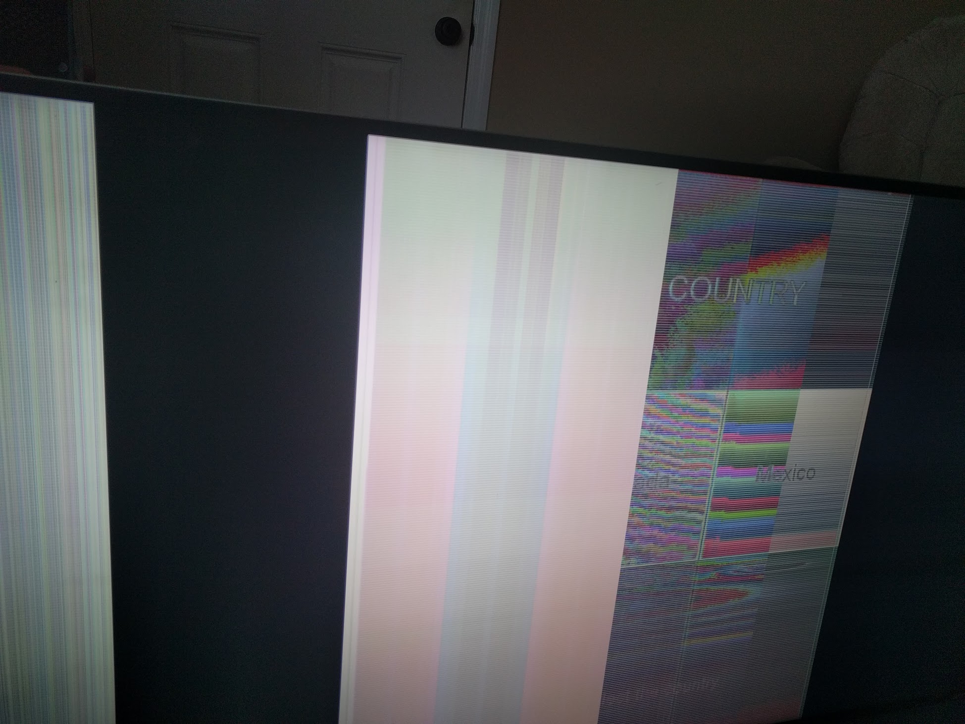

      I then matched up the old t-con board and main and received the attached image. I then put in both the new t-con and main, same thing. I then tried to do old main and new t-con, same. I was so close but now can't seem to get back to where I was earlier with seeing any image.
      Attached is what I see now when I turn the TV on. Any ideas?

        Did you put ribbon cables in there original positions.
          Re: Broken LED TV? Vizio M50-C1
          Yes this is how the ribbons look now on the t-con

              Those ribbon cables do not look as though they are fully inserted.
              You lift the black plastic tab up carefully with your finger nail and then fully insert the ribbon before closing the black plastic tab back down.
              Do with care and don't use force or the black plastic securing tab could break off.

                  I agree with Dick.... those cables don't look seated properly. They look like someone tried to force them in without "delatching" the clamp down. The corner side "guides" should be further in when properly seated.
                    +100 Hope you didn't damage the cables' fingertips that make the connection.
