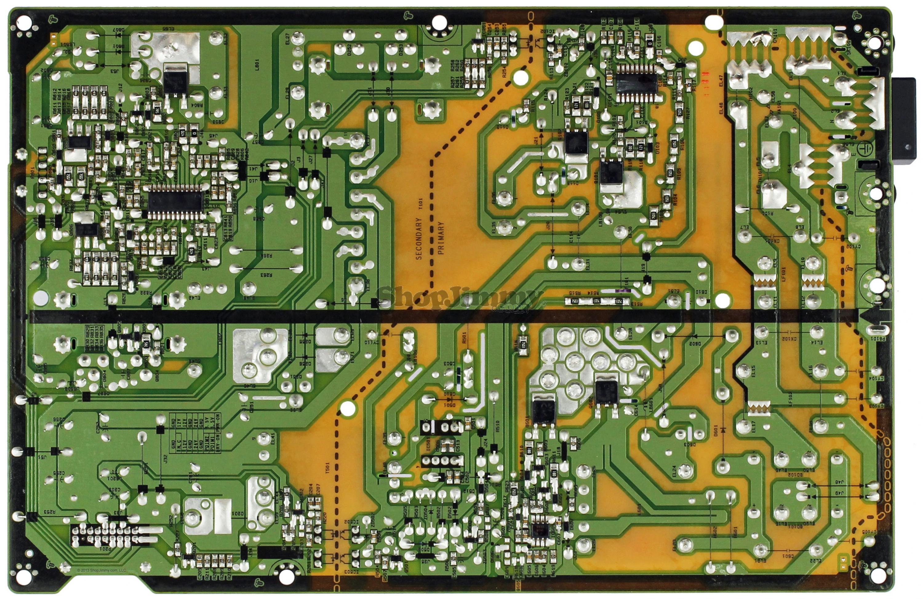

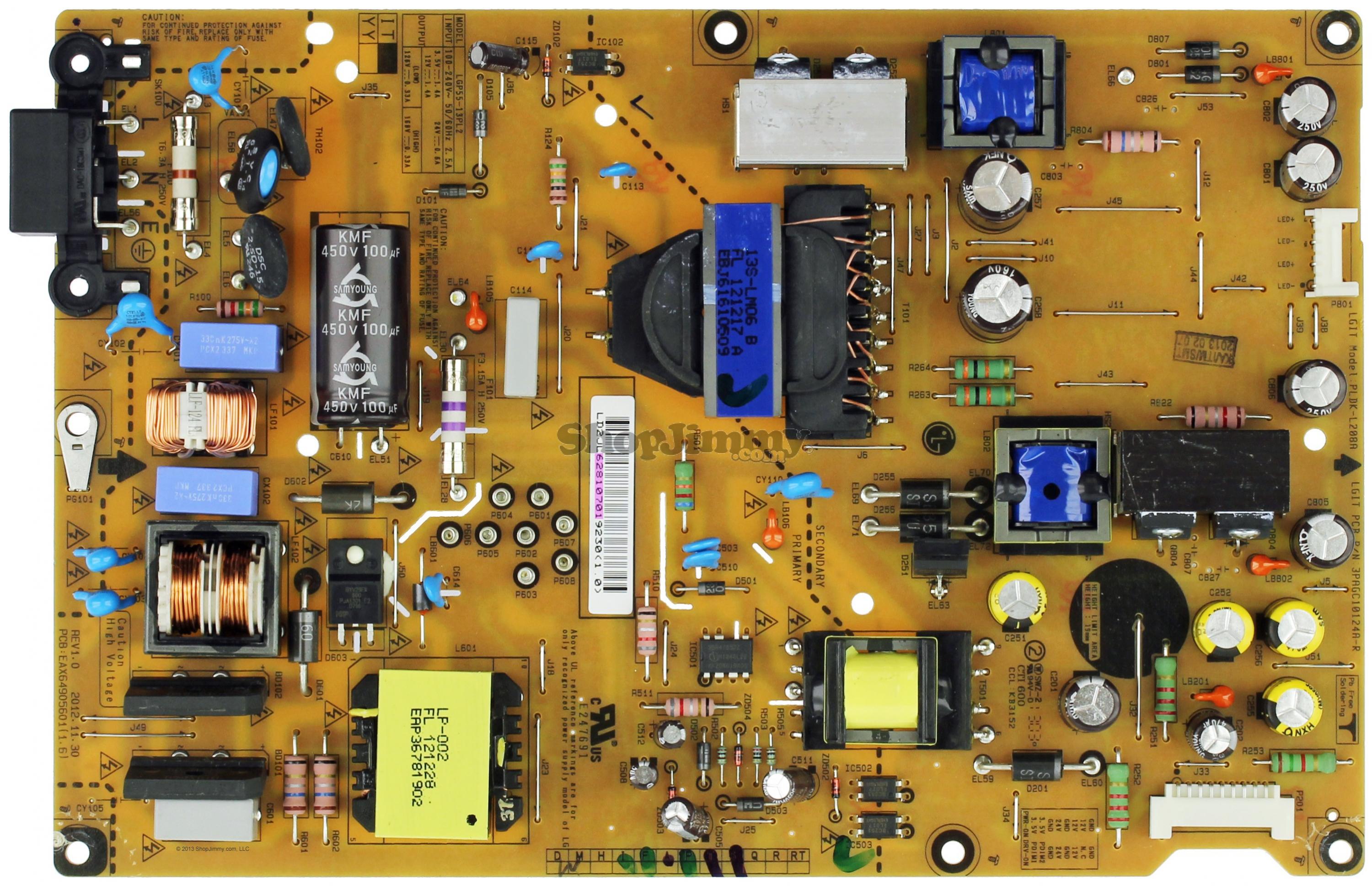

          So it has two LED strings, the output Voltage for the LED strings is over 100 Volts per chart printed on the board.
          So follow the instruction on post 2 check DCV @ the LED + as instructed and the control signals. Your meter should be fast enough to catch over 100V swing.
          We will not be surprised if it has bad LEDs.
          LG EAY62810701 (3PAGC10124A-R) PS.
          Connector P201:
          PWR-ON = PS-ON
          DRV-ON = BL-ON
          PDIM1 = PWM Dimming 1
          PDIM2 = PWM Dimming 2
          Pictures provided by shopjimmy.
