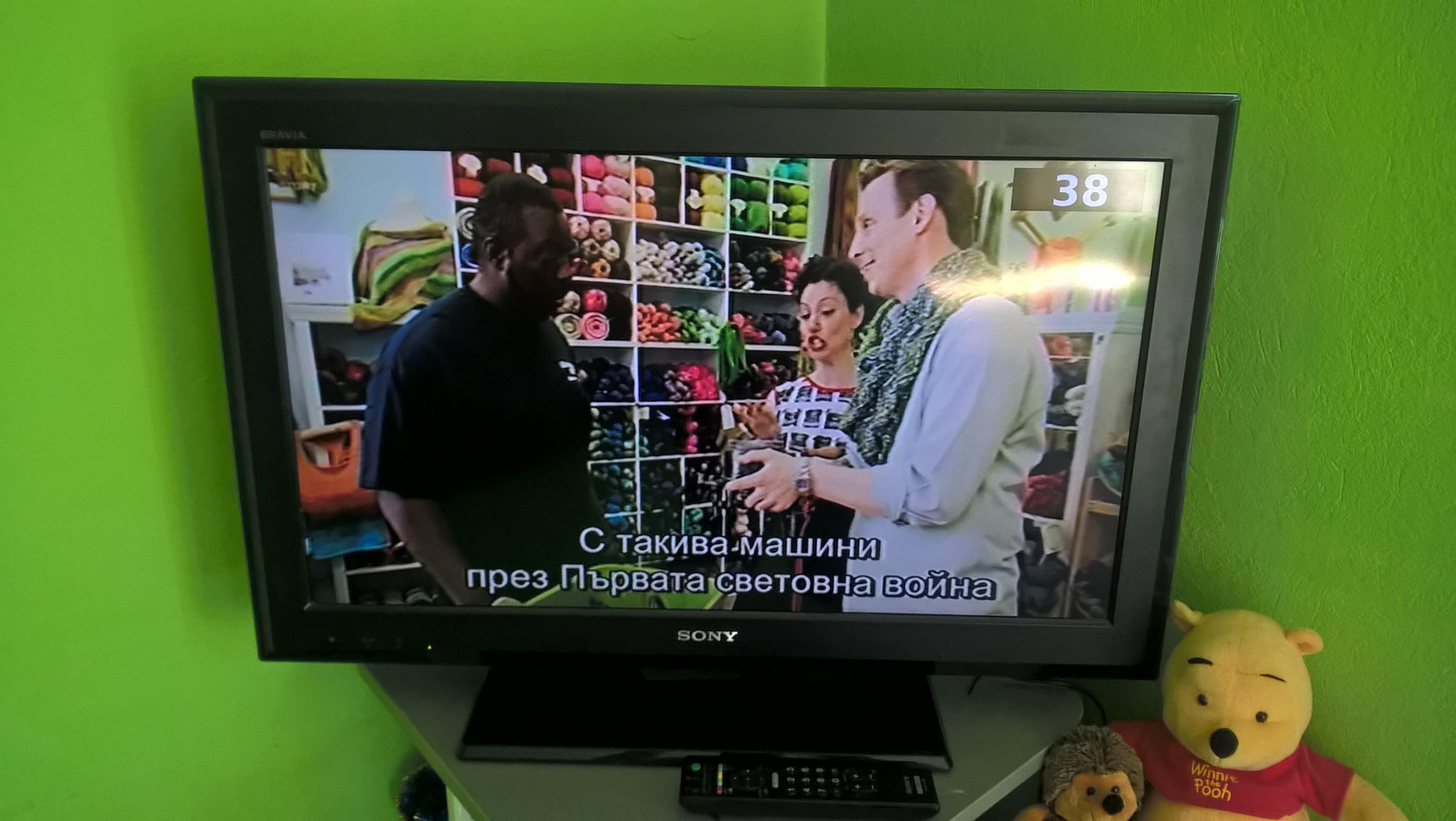

              Re: Sony KDL-32S5600 stuck in stb by /relay click/
              TV now work. The problem was nand flash. I upload all perfect files on your link. If you can please edit topic to''solved''. Thanks.
