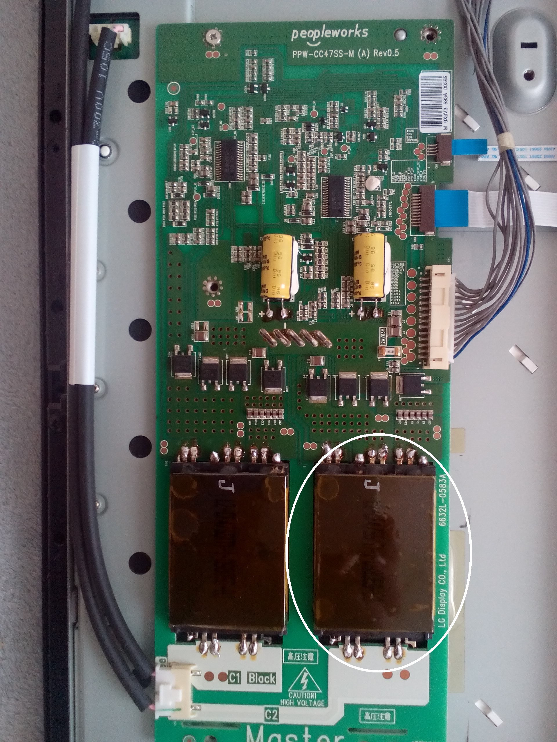

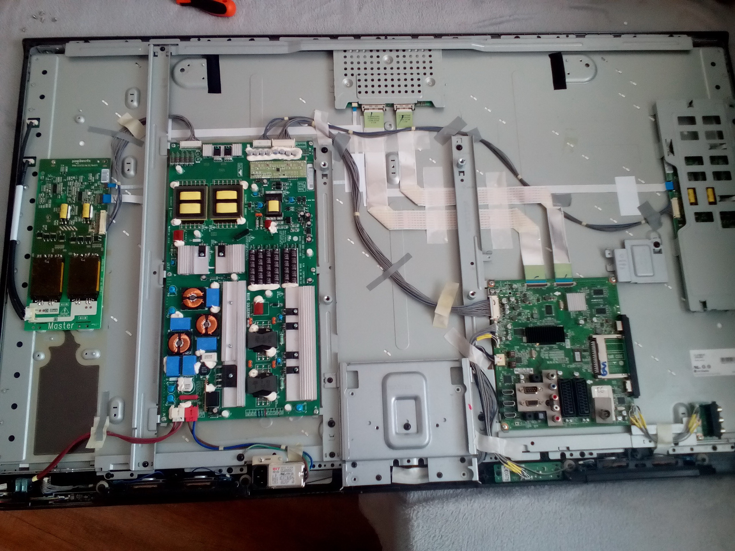

    Hello,I buy today BIG LG 47SL8500 ,and problem is
    tv turn on on 5-6 seconds and turn off.
    I will upload pictures soon

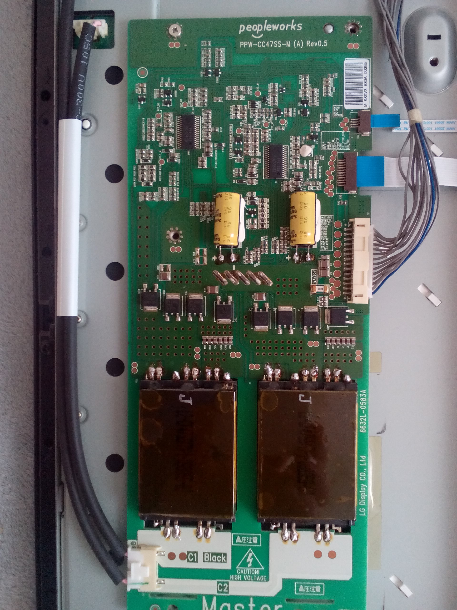

    Re: LG 47SL8500 bad caps?
    uploading pictures
        ok I hear some sound on Master inverter board when I turn on tv.
        sound like Welding

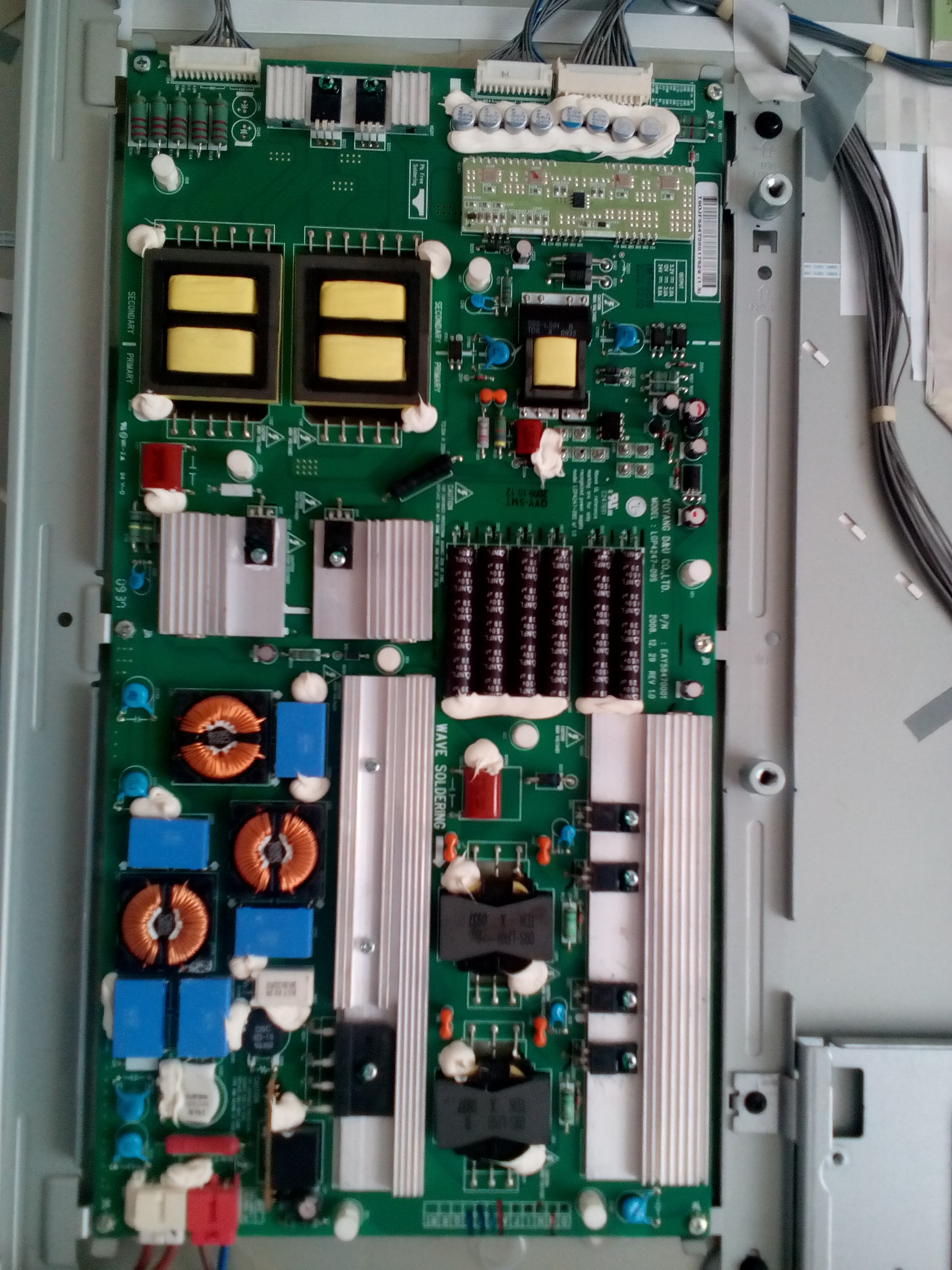

          when I disconnect MASTER and SLAVE inverter boards still turning off tv ,voltages are ok . hmm
              sound like Welding
              there are a few threads where these inverters have failed the noise you are hearing maybe is the winding shorting out on that transformer dissconecting them may not prove nothing as the set will detect a error as there not connected
                I observed that the Primary side of the Inverter transformers soldering looks disturbed. My gut feeling is that one of these transforms, if not both, are the culprits. Take resistance readings across the pins of each transformer and compare if they match.
                  I have same resistance readings from Master and Slave inverter boards.
                  tranformers are L2-CF47SS

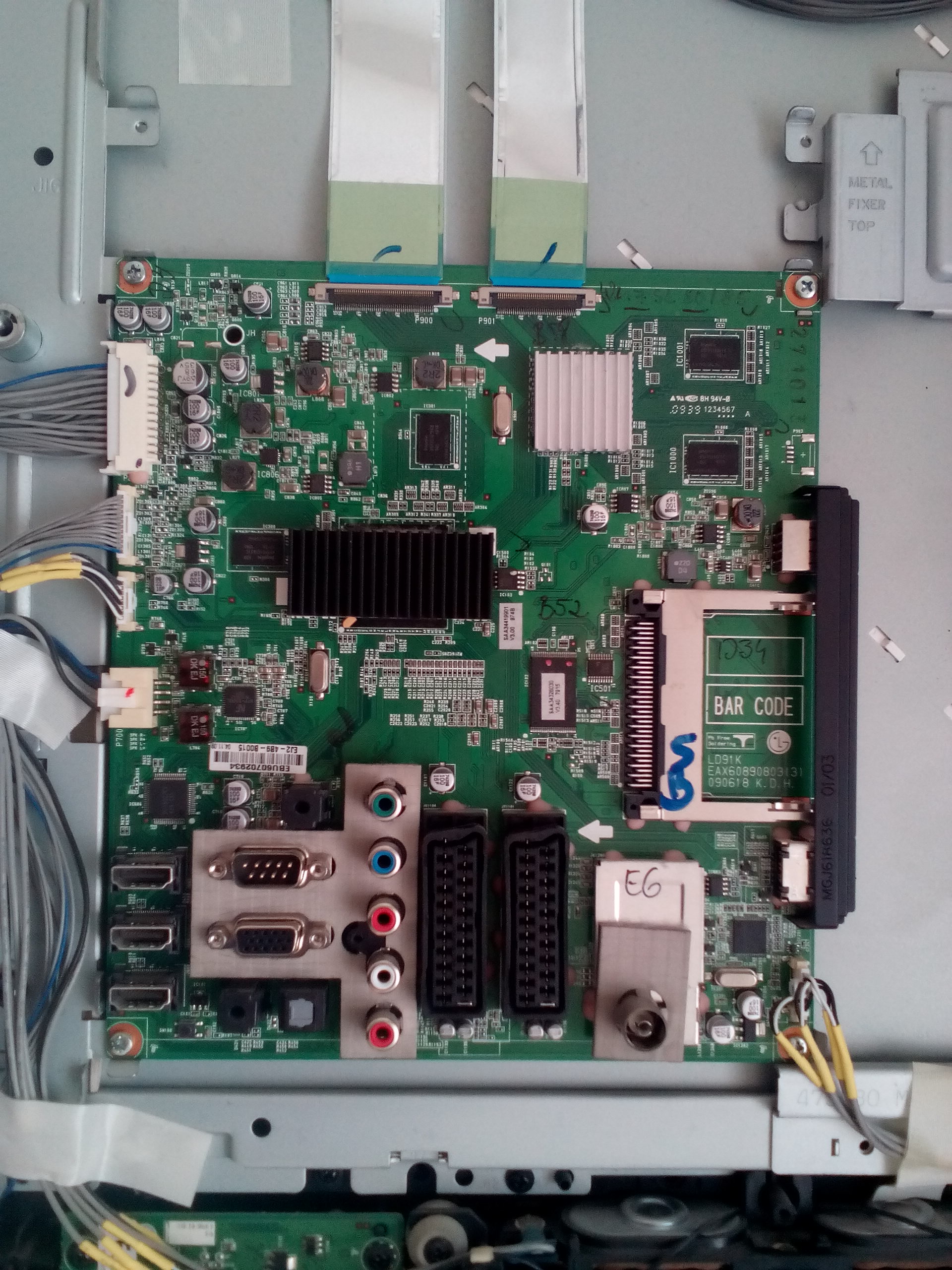

                          All these LG infinia tv's ( 8500 series ) have bad mainboards. You won't find a replacement unit cheap because its a common problem for these sets. Cheapest will be around 250/300 USD.
                          The problem is bad BGA solder under the cpu , reflow the cpu and you will see it stays on for a longer while. Do NOT bake the mainboard in the oven , there are also small components on the bottom of these boards that will fall off.
                          These sets also have bad HDMI chips.
                              I will try to reflow cpu
