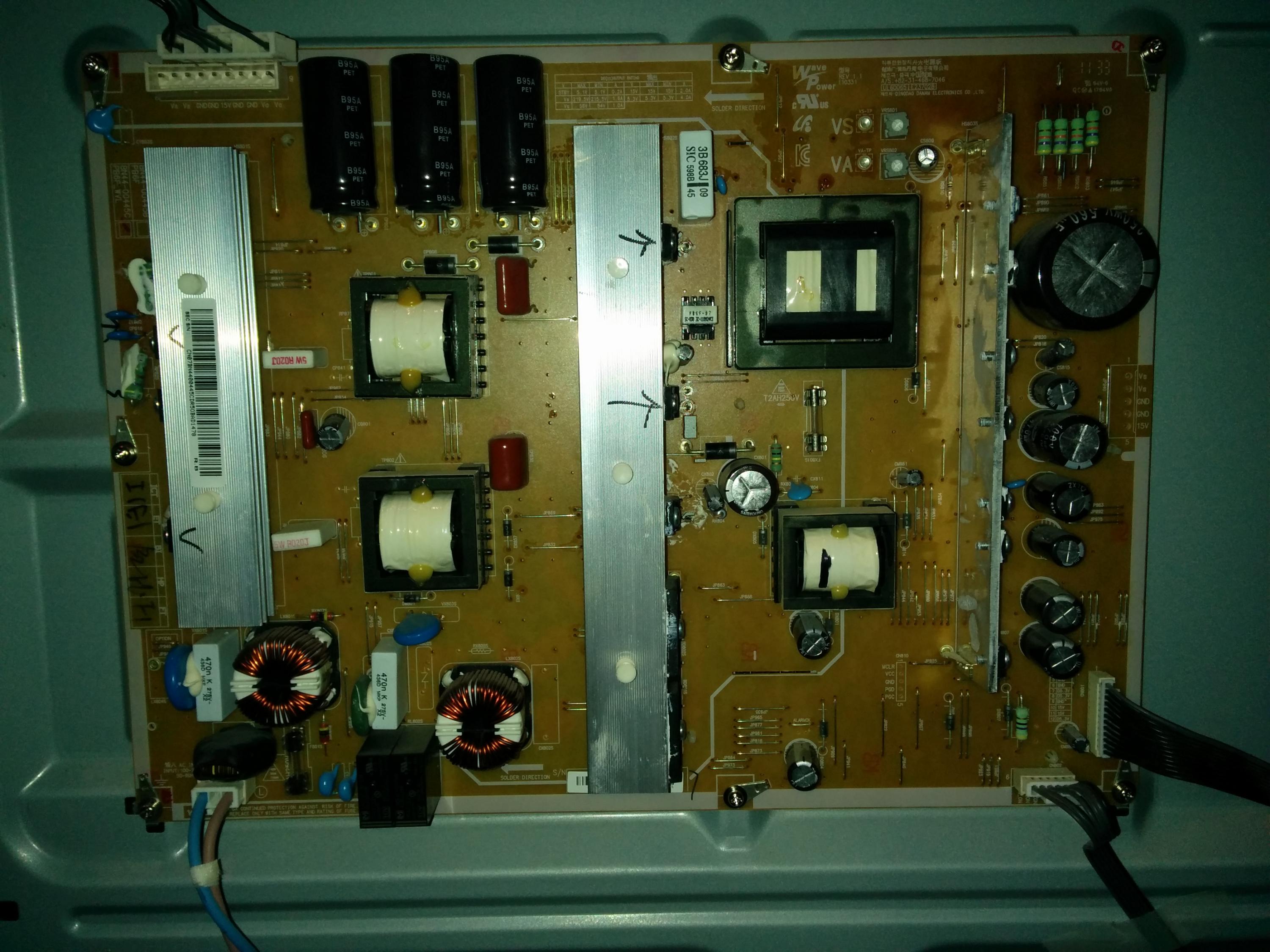

    This tv was dead when i got it. the power supply had blown fuses and a few blown transistors.I bought a power supply repair kit from SHOPJIMMY that included the transistors that were blown--plus a few others. I replaced everything that came in the kit.

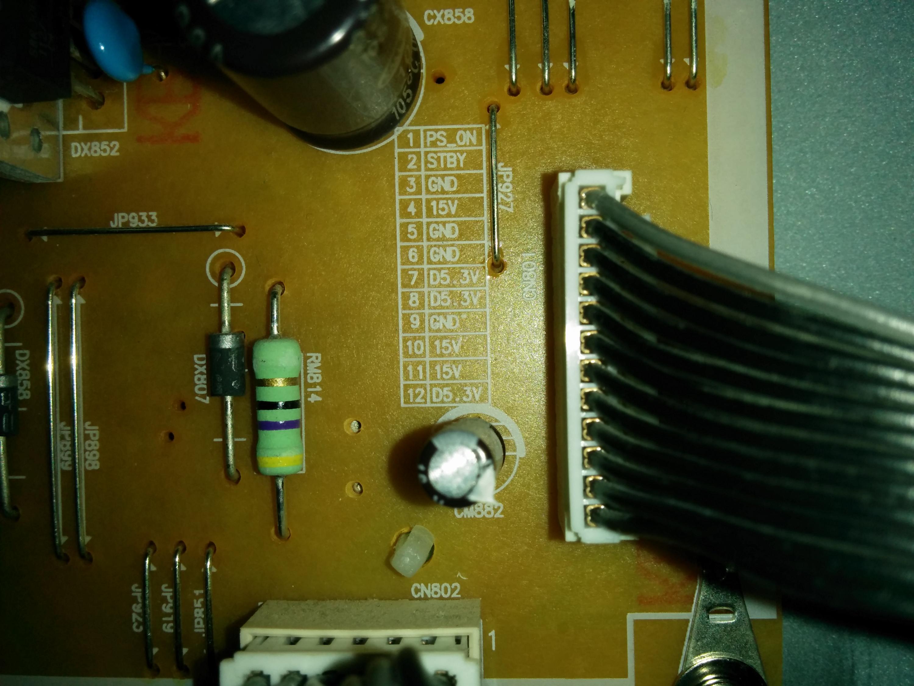

    Now when i plug it in it clicks for a second the red standby light comes on and goes off for a few seconds and repeats.I have 72V at the three caps.
    at the CN801 is the only place i have power
    pson-4.27 and drops to .082
    stb 5.29
    there is no power going to anything else--no VS,VA
    if i disconnect the buffers there is no change.
    anyone suggest what i can test next ?

    anyone have an idea of what i should be checking ? different pics ? more info ?
    thanks ,cheech3629
